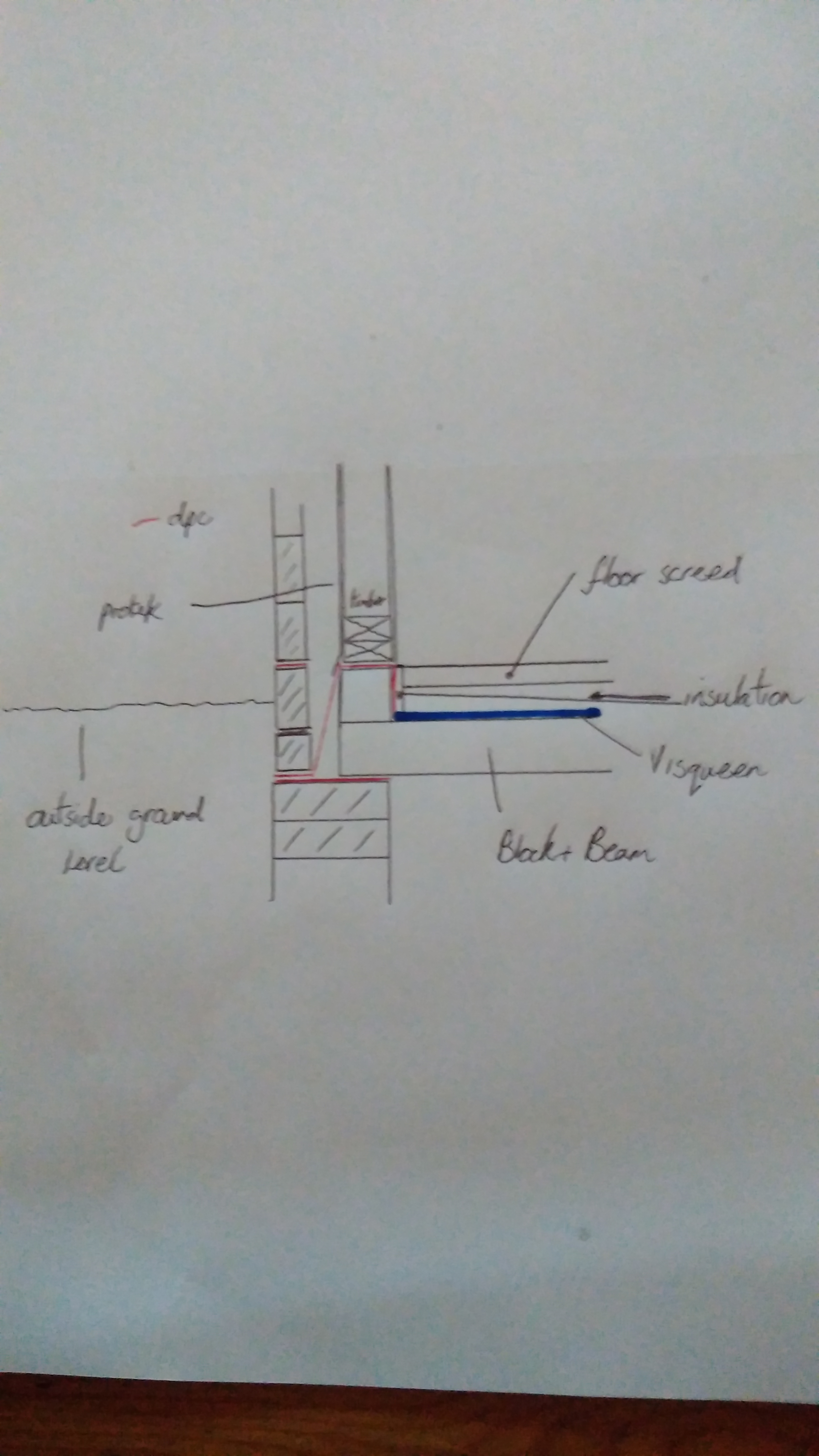

  9. Hi Just sorting out the dpc layout, what's your view on this make up. John

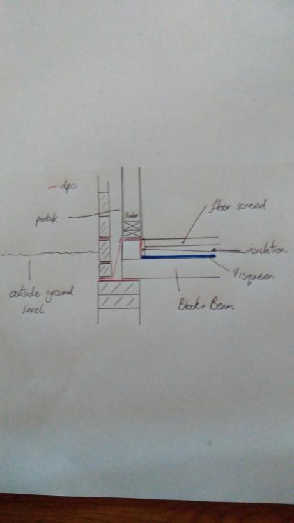

  17. Hi 100mm block work 50mm cavity and 140mm stud sitting (as it stands) 165mm of block make up which sit on beam floor which in turn sits on trench blocks Hope this makes sense

  19. Thanks for the earlier replies, am now using block and beam on trench blocks, looking at reducing. thermal bridging under sole plate of timber frame Thanks
  20. Started on Monday which is good,on Tuesday have changed the ground floor design due to soil type
