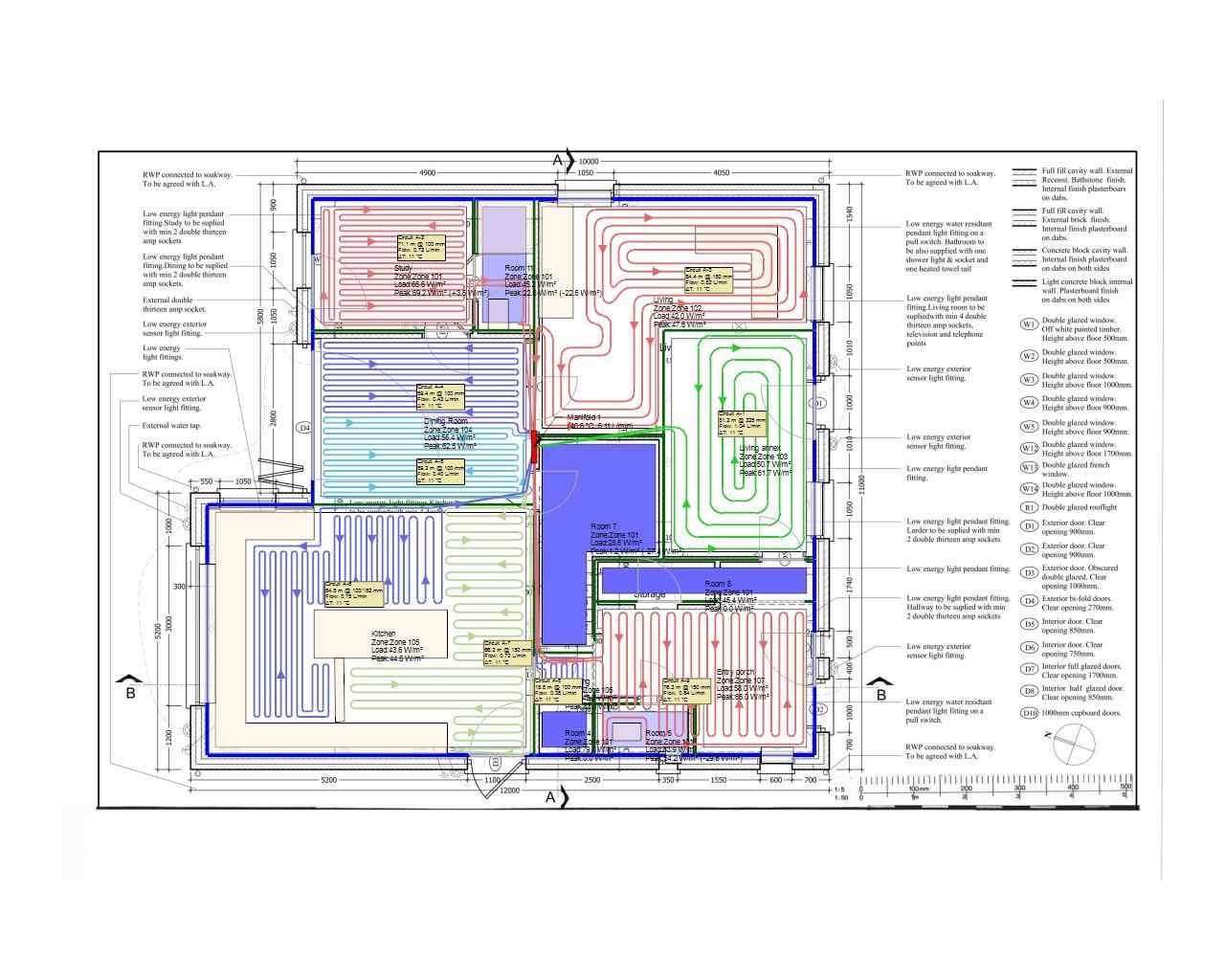

  2. It may be that the design of the UFH does not permit any greater heat in the downstairs rooms, in winter. Supplementary heating might be the answer, or turning up the water temperature as @Declan52 said

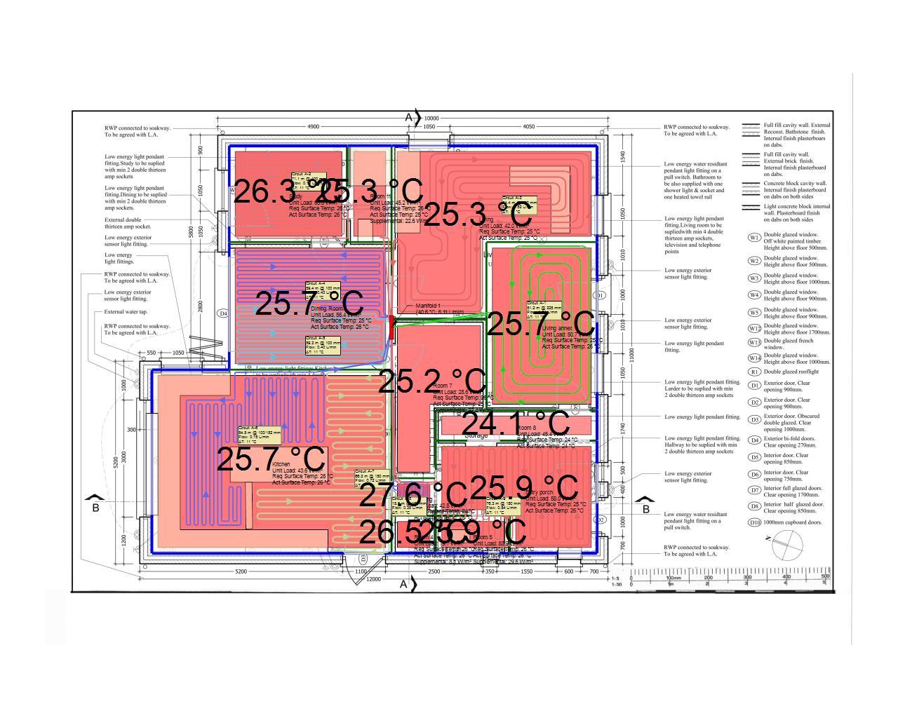

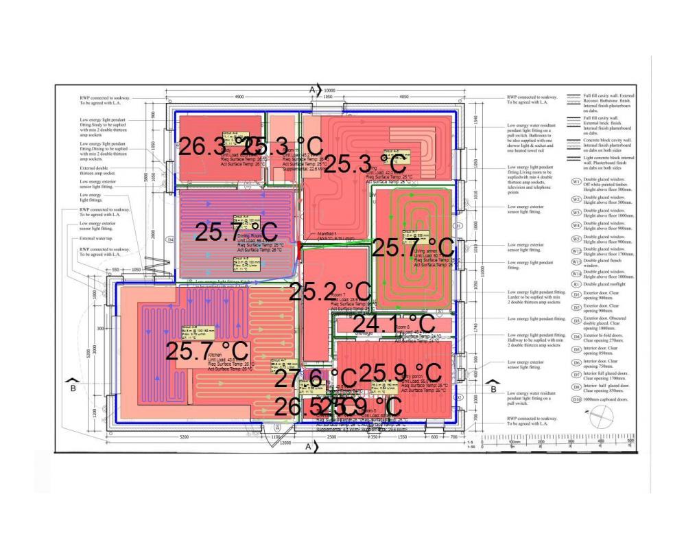

  4. Scrapped all heating from first floor (except bathrooms). Took on board comments. Now UFH downstairs design looks more normal. Landing at foot of stairs is its own zone in case need heat to go upstairs. 7 zones, 9 circuits. Temperature of water 41 degr C. Design to take 0 degr C externally, maintain 20 degr C internally. Any obvious problems?

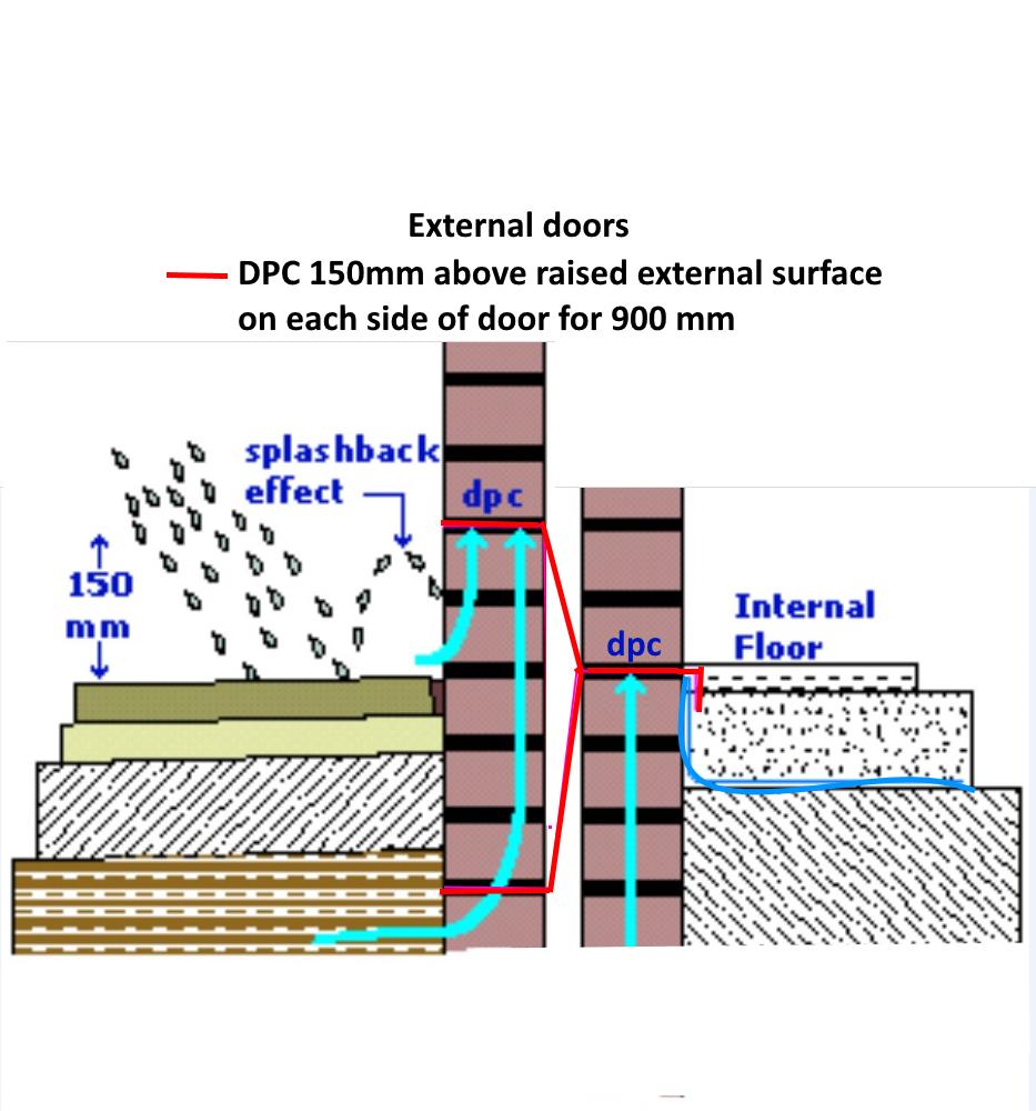

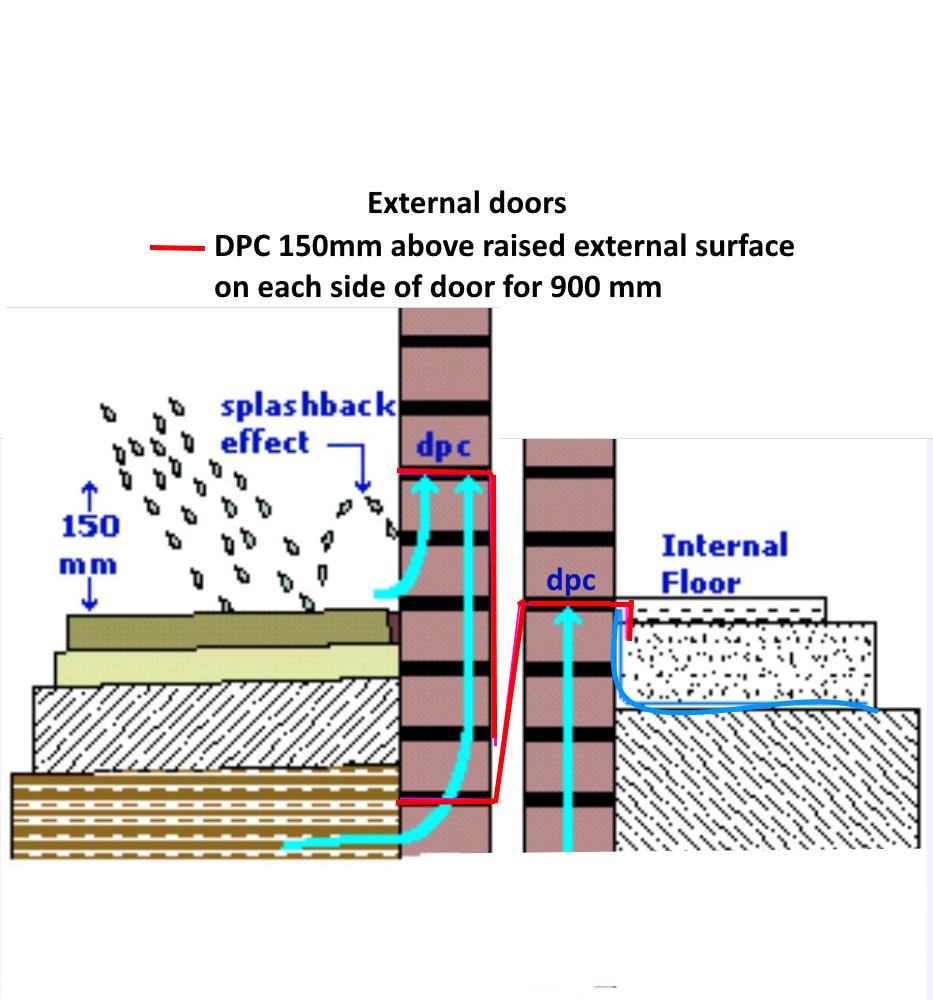

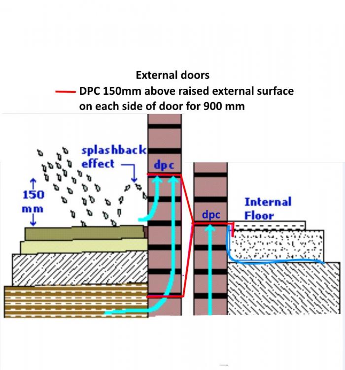

  10. Is this second DPC on the outer leaf only?
  11. "DPCs to be set at least 150mm above external ground level and second DPC to be set 150mm above this to 900mm either side of entrance door accesses." Why is this second higher DPC specified on either side of external doors?

  18. External face. Still worth asking for pointing (perpends)? PS Celcon plus 630mm long
  19. Understood. Anticipating kitchen/family room will have most occupancy. Don't mind having cold rooms, using thermostats, if nobody is in there. Not very nice for guests, I know, unless they go into the kitchen.
