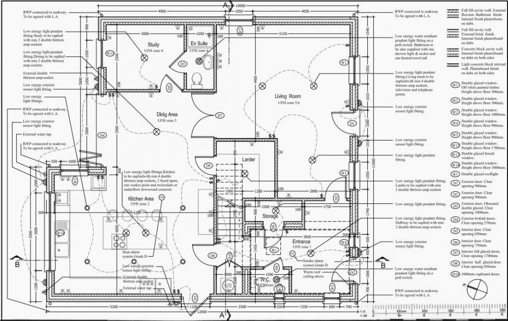

plan view. Problem areas marked in red. Unfortunately column is in already. Cannot undo without vast expense. But can try to squeeze something in the very tiny spaces around the column. -
SE specified steel column in cavity wall, with an internal steel beam resting on it. Blown in bonded EPS beads will be the cavity insulation. Yet to be built. Only the steel column (100x100x5) is installed so far, but walls going up quickly. Steel beam will be 203x102x23. How to minimise thermal bridging & draughts around that area?

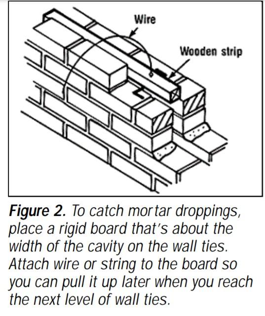

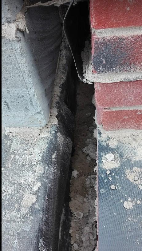

Pls say how these can be made/used? Plenty of mortar droppings happening daily. Worried that a) the weepholes will be blocked up b) the insulation will not extend low enough in the cavity (bonded EPS beads blown in) And how does one clean out mortar droppings, now that every 4th brick has not been omitted at the base (Brickie's brilliant idea)? Can one knock out bricks from the base of a wall that is already over 1.8m high? PS At right, note also the external leaf of the doorway. DPC turned up rather than down. What will that do to any rain that bounces up above the second DPC? Or is the >150mm height of that enough to allay any concerns about bouncing rain? -

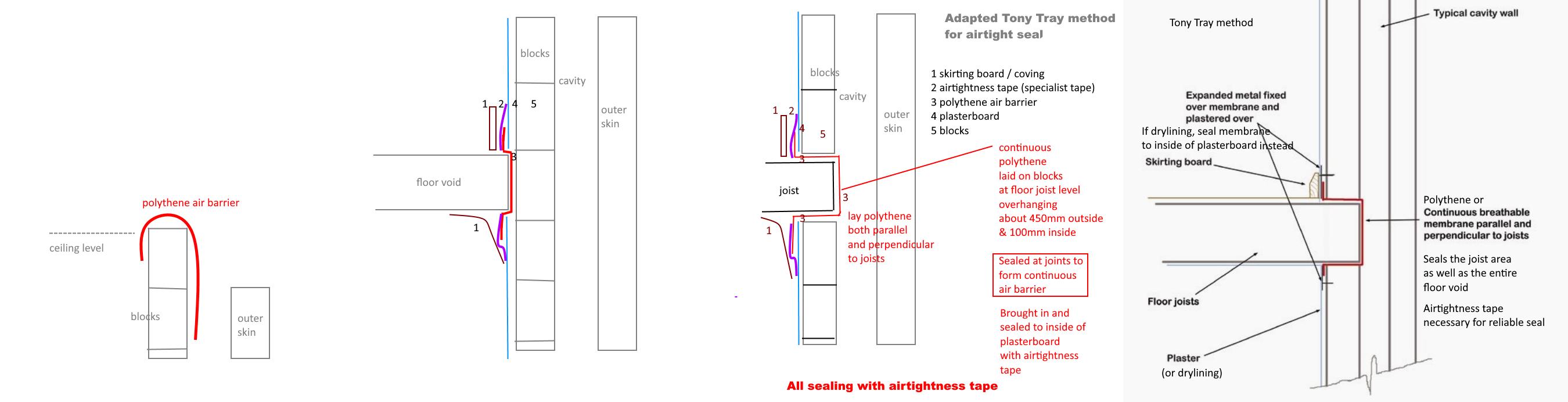

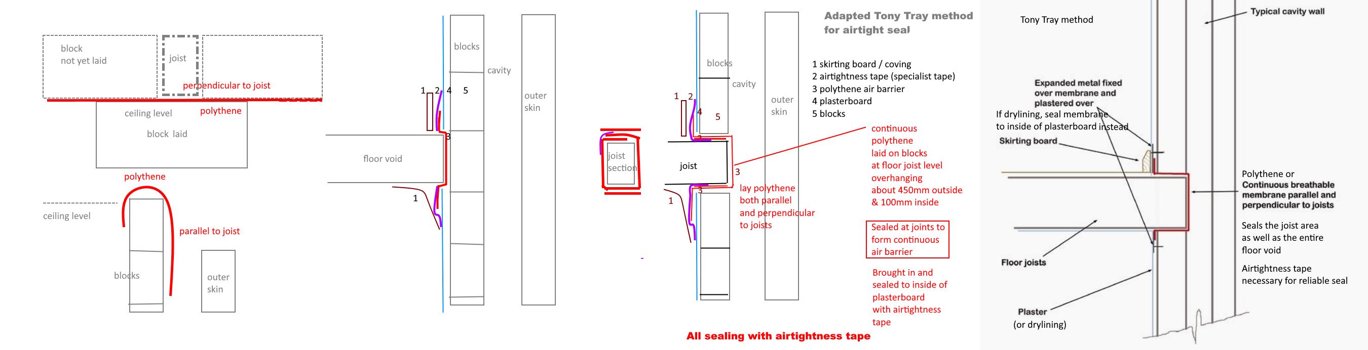

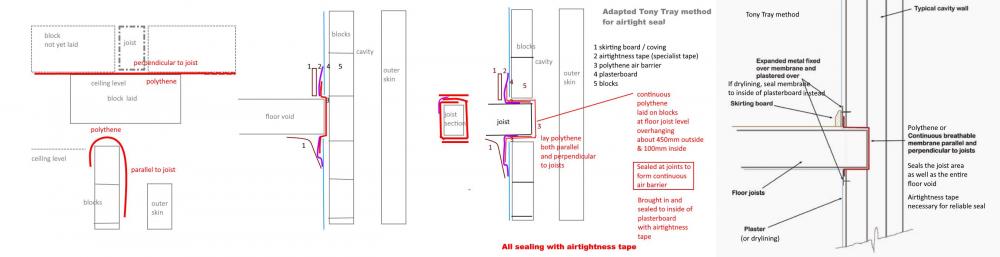

Plasterboard with taped junctions intended to be the airtight barrier. Tray taped to plasterboard.
For various reasons constrained to use drylining of external walls. Trying to achieve as much airtightness of first floor void as possible, on a budget. Apologies in advance to Tony for taking liberties with a perfectly good concept. Qus: 1) How can the Tony Tray concept be made to work with plasterboard on adhesive frame? Builder not familiar with this approach. Trying to draw polythene version for him (see pic) 2) How does the polythene airtightness barrier cope with the weight of blocks above? (3.6N aircrete holding up large roof trusses) 3) How would you draw the junctions between the polythene in the joist openings and the polythene over the infill blocks? 4) Is a DPC used below and/or above first floor joists? If so, below or above the airtightness barrier (visualising piercing of the polythene by rough mortar)

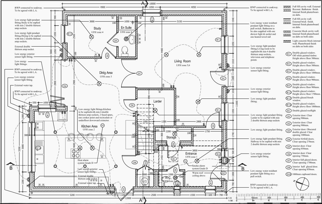

Brick and block. 110mm cavity to be insulated with bonded blown EPS beads. For penetrations (eg extractor fans) what is the sequence of installation? Blown beads last? How is the thermal bridge reduced, if at all, when there is such a huge penetration through the insulation? Context: limited budget. Keen but not desperate about thermal efficiency

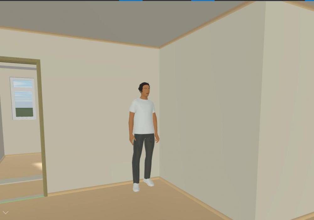

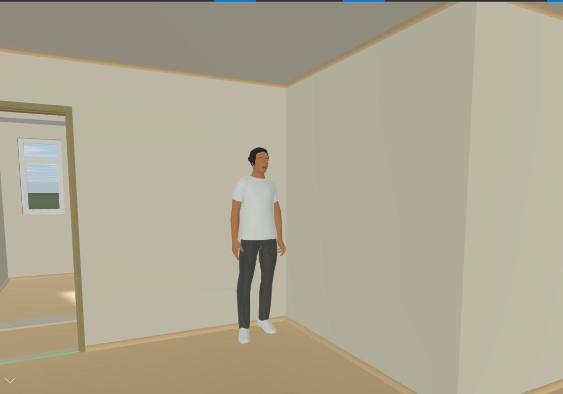

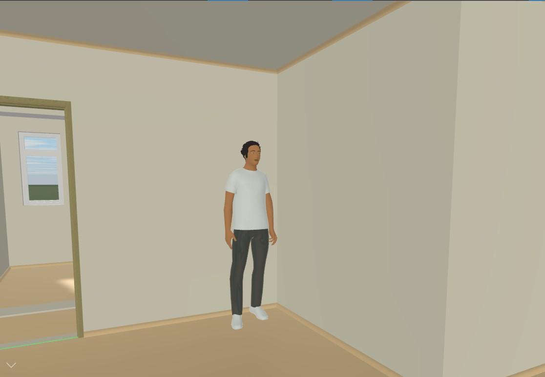

Mockups of 2500mm floor to ceiling vs 2600mm Trying to decide how much more wow factor comes with the additional 100mm

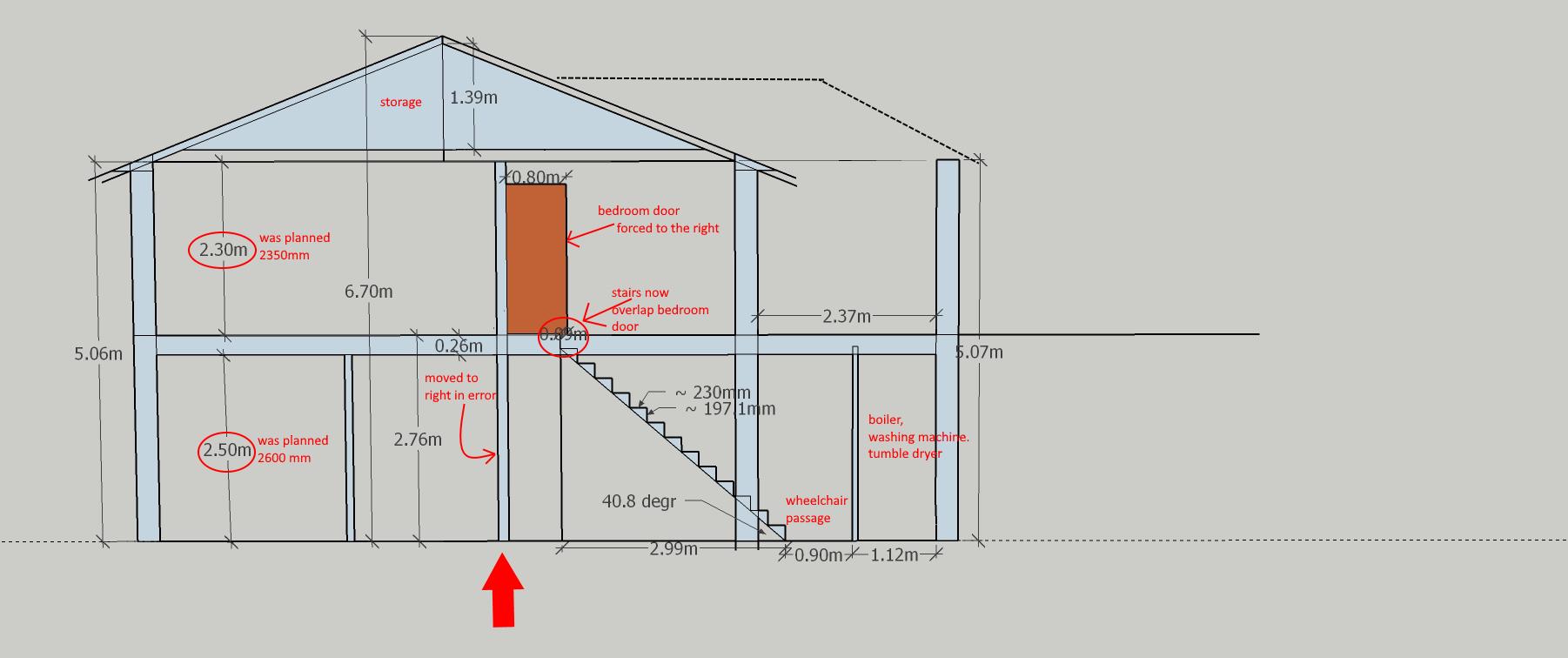

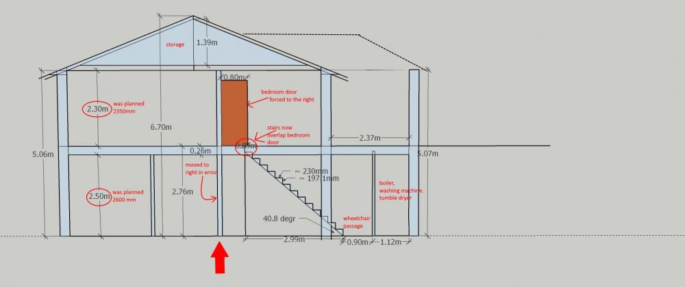

Yes, foundations are in place for the wall that has the double doors. Structural wall moved by 180mm from plan. However, 40mm of that is attributable to the increased width of the blocks from 100mm to 140mm, as agreed. Of the 140mm remaining error, 100mm has been clawed back by another error. So, on looking carefully again, there is 40mm shortening of stairs required. 14 stairs in all incl landing Original plan ground floor to ceiling 2600 (above 100mm Celotex & 65mm screed, hard wood flooring) Flooring to flooring 2830mm in original plan (over 14 stairs)
Structural wall, holds up joists. So probably constrained to avoid studs.
Might never get permission, so only 50% chance of it happening Using the loft storage as a summer bird's nest is a point in favour of reducing ground floor height to 2500mm. (Trying to find silver linings for this cloud)
That particular wall is in 140mm wide blocks, to allow the option of an additional storey above.
Plenty wide footing.
One wall (fat red arrow) moved in error by builder during internal setting out. Goes down to foundations (concrete slab on hardcore on trench fill). Has consequences, as highlighted in pic. Esp stairs vs bedroom door. Brainstorming for options to set things right (short of digging up slab and redoing the wall). That internal wall is still only at finished floor level, nothing atop DPC yet. For various reasons, digging up would be the very last resort. Suggestions?
