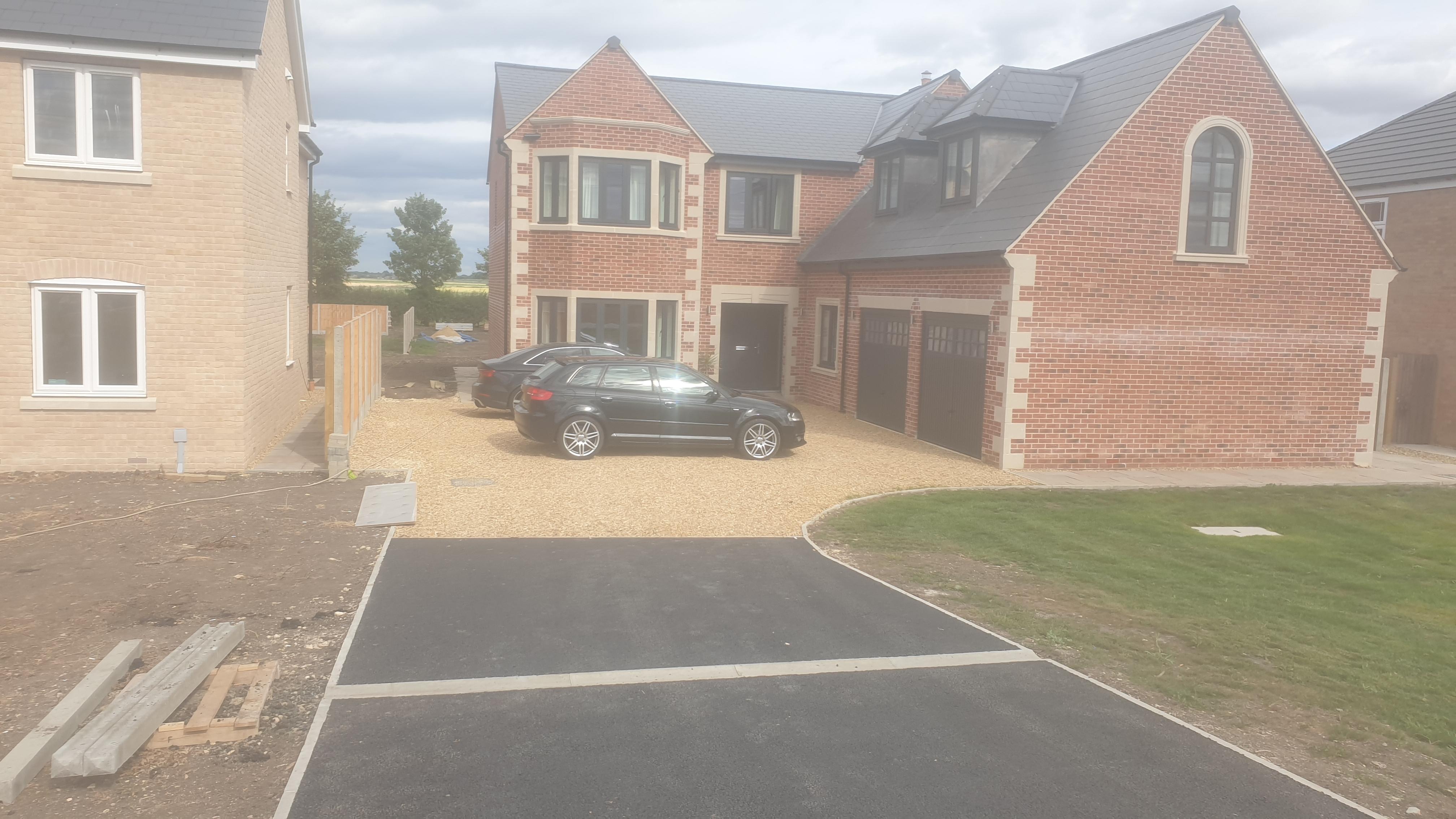

  8. This was mine all done - did the one between the other 2 plots too.
  9. Just did 85 sq. m week before last - 20mm chip base course and 10mm chip wearing course. Asphalt cost around £2.5k and £750 for the bods to lay it. Problem is (depending how far you are away from the supplier) is how much of it goes off in the lorry. We probably lost over 3T and it didn't come far!
