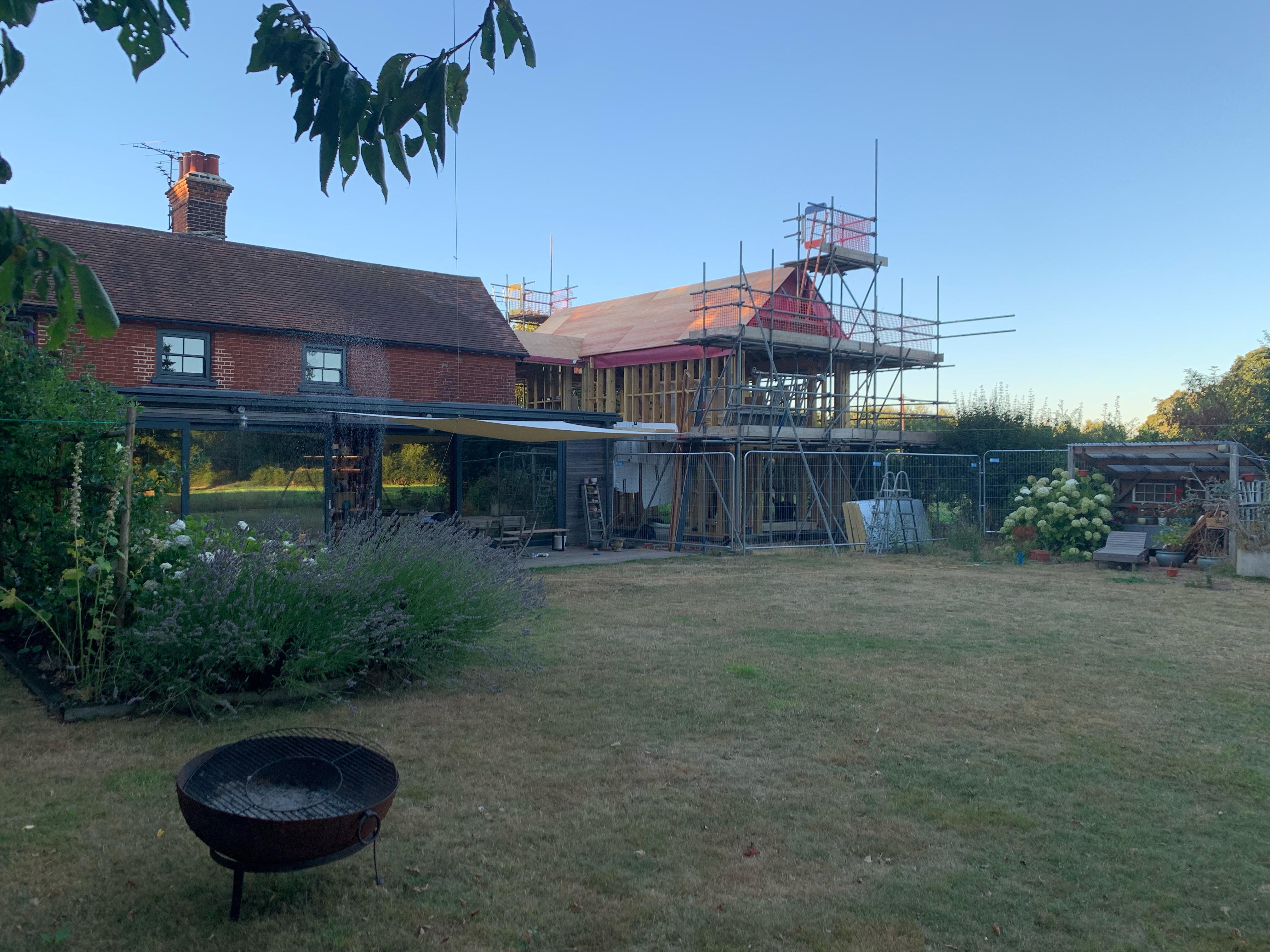

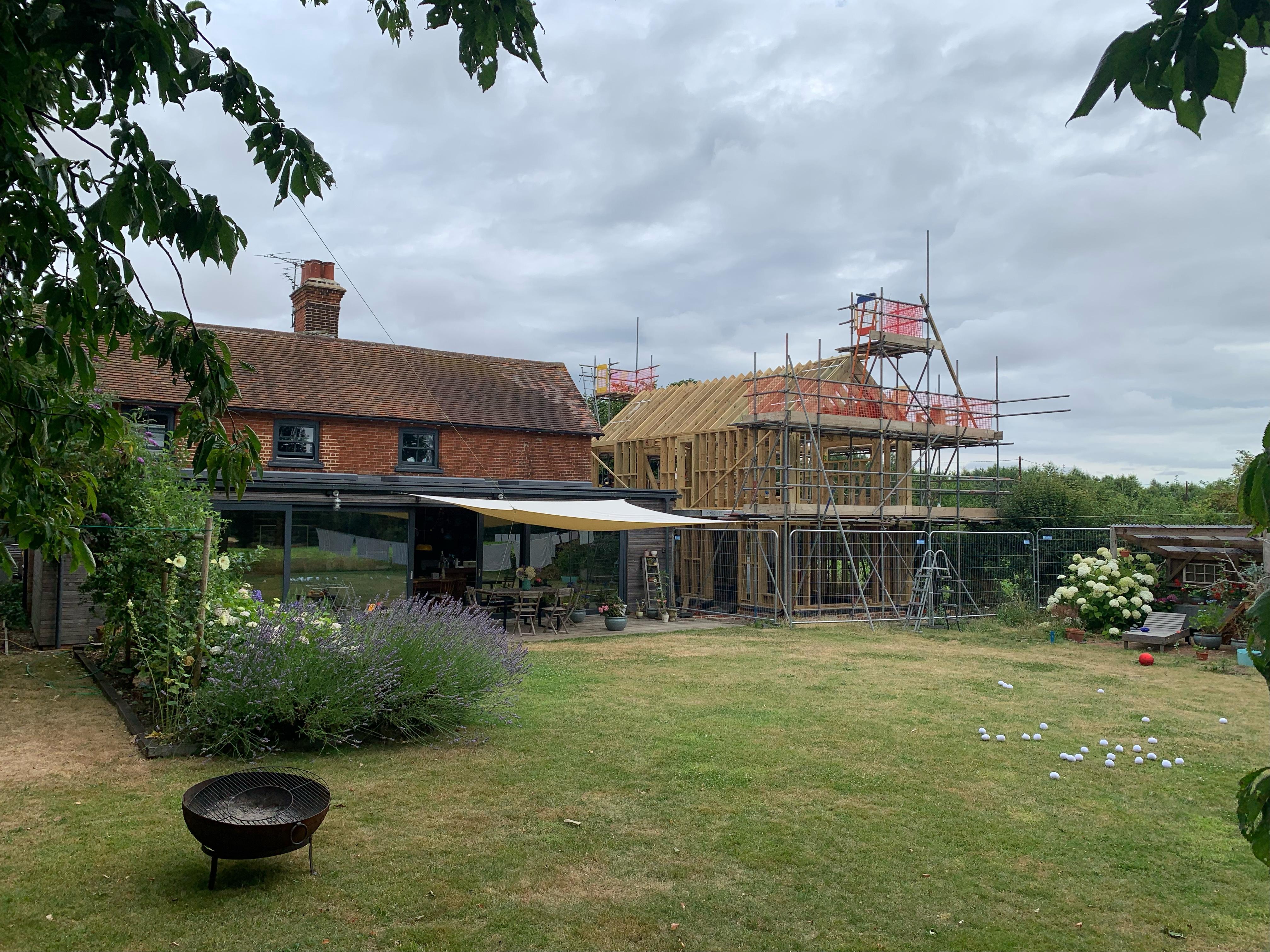

  5. Hi all, Apologies in advance for a long winded thread. The architect on our project designed us a two story side extension where the ridge runs at 90deg to the original house. There is an adjoining roof that runs on the same line as the existing house, but will join below it. See attachment. He told us at the time that it took a bit of designing to get this junction to work but he had solved it. We have plan, elevation and section drawings featuring this roof. All with figures dimensions. Now, with the main extension built it turns out that that adjoining roof as designed does not fit with enough clearance to allow for required flashing to existing. After much wrangling and discussion it has had to be lowered by 300mm to fit. The new door opening has been lowered so the head height is not an issue, but the issue is the glazing which runs on either side of this section. Those windows were ordered off plan once the extension was started and layout had been done. There is of course tolerance there to allow for site conditions, but no where near 300mm. This has resulted in us having to reorder one of the windows at the cost of £3k (twice price of original due to small order size). The other window we can lower and form a box gully in porch roof to fit it, not ideal but we worked with it. The architects drawings have stated disclaimers: "All dimensions and level must be checked and verified prior to any ordering, manufacture or construction." "Figured dimensions must be taken in preference to scaled dimensions. Contractors and suppliers must verify all dimensions on site before commencing any work or production of shop drawings" Question: Could the architect be considered at fault here, perhaps due to general negligence? Do we have a claim for the £3k and he can keep the window? Budgets are tight to get us dry before winter and I really could do with not swallowing this £3k. Many thanks for reading Tobias RoofSection.pdf
