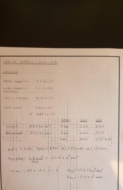

Hi Temp, yes I did realise about the odd meters done at the same time, but that still sounds pretty tricky (and expensive). We had a ground condition / contamination report carried out as a pre-planning condition and a phase 2 done as a post-planning condition, both by the same company. We knew we would have to underpin as the existing foundation a about 8" deep, but we were led to believe that these would be about 1m. The SE also said that the building was structurally sound as it was. Over the last week I have had a number of conversations and email exchanges with the SE. The first thing we did was dig a trench the length of the wall, all 25m. About 1/2 of the length was sand, then about 10m of loam, then at the end about 2m of clay. I sent pictures to the SE and asked him to come back and inspect again, but he is adamant that this makes no differenced and if we dug deeper we would find that it was all sat on clay. This is some of the comments from him. As you can appreciate the boreholes undertaken in the contaminated land investigation were for the purposes of collecting samples for chemical testing and establishing the depth and composition of any made ground present and were limited to 1.0m depth. So, even though this didn't show clay he said that it will be below this. Next The minimum depth of trench fill foundations is typically 1.0m deep when soils are not subject to the influence by vegetation. The foundation design needs to consider the soils beneath the foundations to ensure they are not subject to volumetric changes which would in turn affect the structure above. For example, if clay soil is encountered within 2.0m below ground level and trees are present it would be necessary to design the foundations to reduce the risk of heave. About 5 years ago the power company had all the trees topped so there was no risk of them affecting the power line. They subsequently all died so we cut them down for wood. Since then the area has become bushy with some old roots growing. We always intended to remove these as they are not attractive. This is the vegetation he mentions. When we dug the trench they were some roots in the top 30cm, none thicker than 1cm and nothing below that level. Bore holes undertaken indicate clay soil below the sand and gravels extending to at least 1.5m below ground level where the borehole was terminated. At this relatively shallow depth the soil will be influenced by the water demand of the vegetation . All vegetation has been removed and we always intended to build a retaining wall so we could move the back further from the back of the house. The trees along the South West Boundary have the potential to influence the soils. The foundation depths have been designed in accordance with NHBC chapter 4.2 based on the current tree heights of the existing trees which are to be removed and the trees which have been previously removed. So here he does accept that the trees will not be there in the future and that we removed some previously. The long and short of it is that we have no choice as things stand, but to underpin to that depth. -

The SE report, bit of it above included, says 1m foundations, which was received by the planners prior to planning being approved. So, that suggests that they read this and know, but probably not. I've been trying to get hold of planners for a while to ask a few things, but to no avail. Since we got our planning 2 years ago, the local planners have approved a lot more class Q conversions than they used to, suggesting that things have relaxed a bit. I feel stuck between a rock and a hard place. If I can't do new foundations then I may be able to do piles. I shall talk to the SE on find out what he knows. Another barn near here was approved under class Q and then last summer they got planning to demolish and rebuild, in a different place only overlapping by about 3 feet. So, I am going to see about that as an option, and also an extension on time as it should be done by the end of next year. Not impossible, but does depend on external parties. -

Thanks everyone for you comments and insight, here is some info to fill in some of the questions above. 1, We are in East Suffolk. 2. This is the sight, the conversion is an L shape at the top of a slope. The house at the bottom is an existing home. 3. This is the drawings done by the SE on their first visit to check if the barn could be converted. 4. SE comments re soils for planning, this is obviously not the whole document, just a bit from it. 5, Walls 6. Floors 7. conclusion So, the first report, bits above from the SE did not raise any issues. They do mention trees, but these have been cut down and all the roots removed except a few still waiting to be done. This is the only remaining trees, which I will cut down if necessary, but I would like to leave a couple just to hide the electricity pole. The back edge was like this before we started, not a lot of trees, even then. This is what it looks like now. Every tree that has been removed we have dug out the roots. We have also remove the retaining wall mentioned as we wanted more space along this side of the building. The plan is to terrace the bank, eventually -

These SE's have dug 2 trial pits, one when they first inspected for planning and again before producing the above. This is a single block wall barn, no steel involved, but we assumed that we would need steels for the roof, but no mention of that. If we do it say, room by room, will we be able to do 1m foundations, do you know. This is our current plan / hope. Also, out of interest, if we do this how do you 'join' the different foundations in a straight line. No BC yet, this report was to get the architect do do BC drawings. -

As my hubby said this is the low end of the building with a flat roof so it will be taking the majority of the weight. I'm also going to talk to the SE about steels to support the roof, which don't seem to have been specified. No basement, just a single storey build with a flat (12 degrees) metal roof. -

They are a well established and locally well respected SE company. My only thought is that most of the work they do is commercial rather than residential so maybe they are used to deeper pockets. They did the original ground survey and raised no issues with the ground, I'll dig out the report and see what the exact terminology was. The site is as good as flat, maybe 10 degrees. The building is at the edge of the site, but I can't imagine that the ground changes much in 9m, the distance between the back (2.4m) and the front (1m) Anyway, talking to them today so I'll have more details then. -
