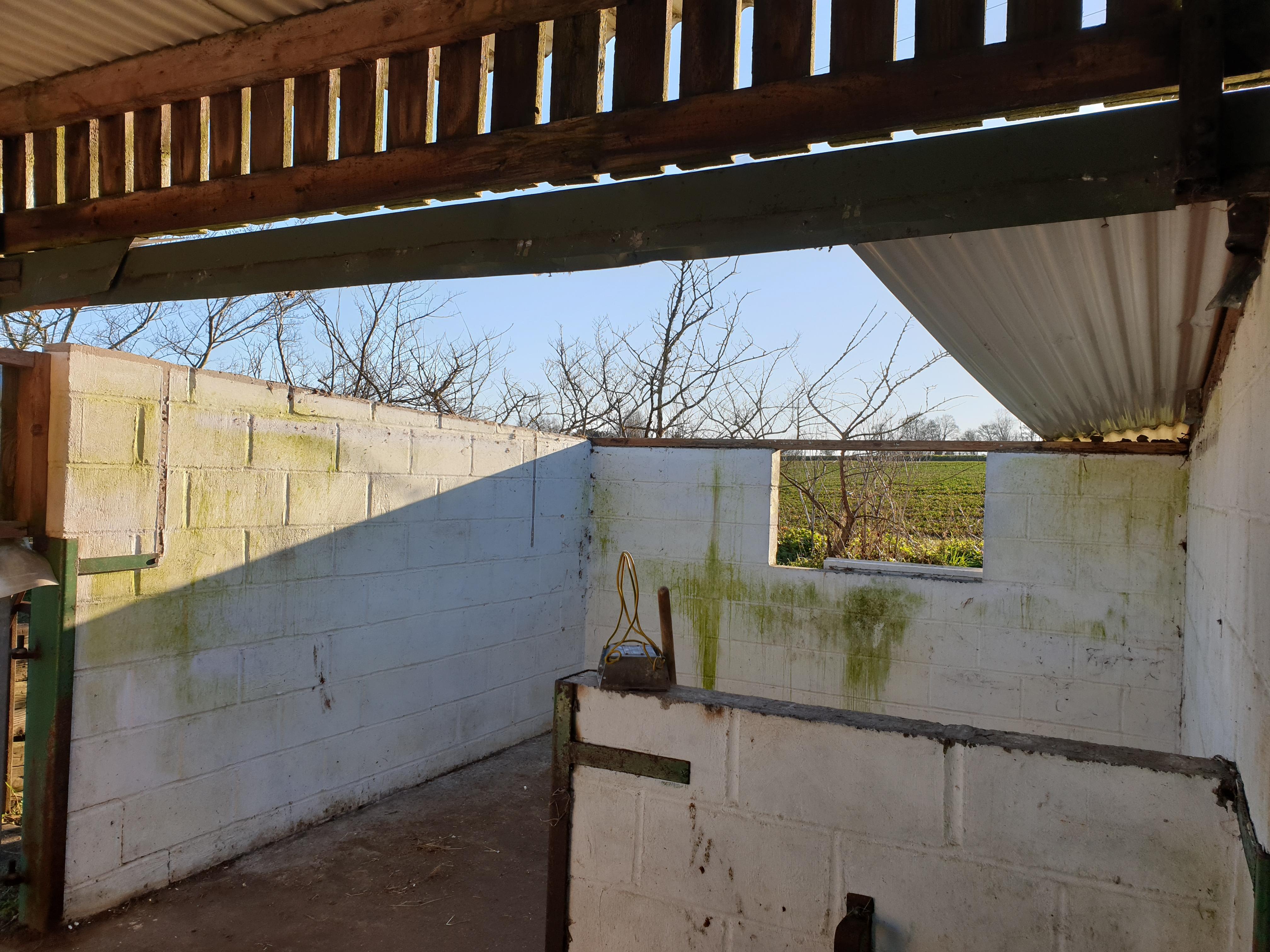

  10. I know, but UKPN are asking me what KVA I need and although I've looked I don't understand the calculation to get this. I asked my sparky, but he's a bit slow on answering.
  11. Hello Our electric board UKPN has asked for our KVA requirements to complete their quote. I may have posted this previously, but I can't find the answer. This is for 2 * 32amp EV charging 3 * power showers 2 * cooker hobs 4 * ovens 4 bedrooms office with 6 computers plus 2 x printers 3 * TV's plus DVD etc Solar PV, 10 - 12 panels ASHP MVHR Cart-lodge / Garage / Large workshop Water Treatment plant 120m drive with lighting and electric gate at road side We have asked for 3 phase, which is available, but they want to know the KVA needs TIA

  14. Thanks for your suggestion, but we decided on EWI because of how much space we would lose internally.
  15. Thanks, good idea to try it out and see how we get on. Current walls are block, no brick at all, but some of the mortar joints are not very good and there are definitely some parts of the wall that need to be reduced to about 1m and rebuilt due to some sort of metal support frame that has rusted. I think this frame was the fixings for the pig pens that were in there. Old barns have limitations, but we have to use the walls as part of our planning.

  18. Hi, it's DIY and the above is how I understand it needs to be. I was happy with the render path, I just wasn't quite so sure about the cladding as I was worried about the join between the insulation sheets, but you seem to be saying that it isn't an issue. The build is an L shape so 6 walls, 3 are render and 3 cladding so the join will be corners, there will be cladding to cladding, render to render and cladding to render, and I haven't yet thought about joining, makes my brain hurt ? Suggestions welcomed, it will be a year or slightly more before we are doing this, I'm just planning it out at the moment. Our planning permission just agreed with our statement of 'render or cladding'.
  19. The instructions we have been given are to attached the insulation with dot and dab adhesive and 5 screws per board. We have not been instructed to tape the board joins as the adhesive & render will stop any cold bridging. Obviously we can tape if we can attached the battens direct to the insulation with very long screws through to the block. I was also wondering about DPM / vapour mesh (breathable) The insulation is Kingspan K5 external wall board 70mm thick
