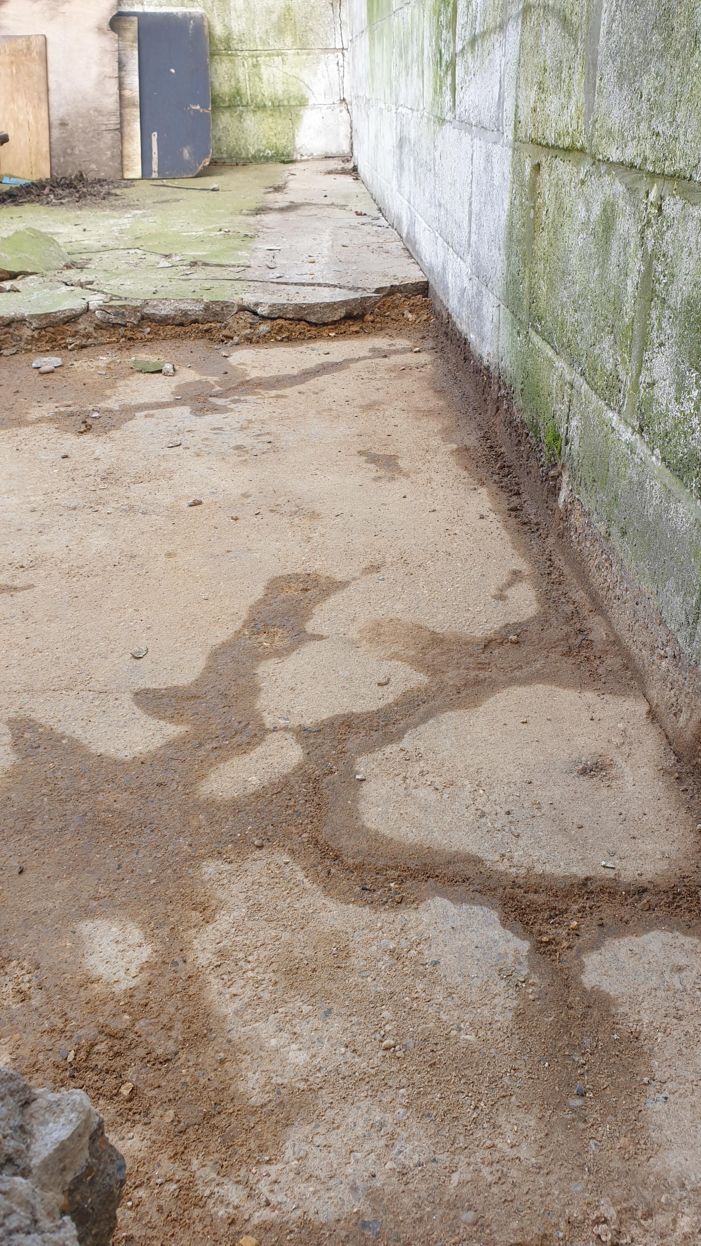

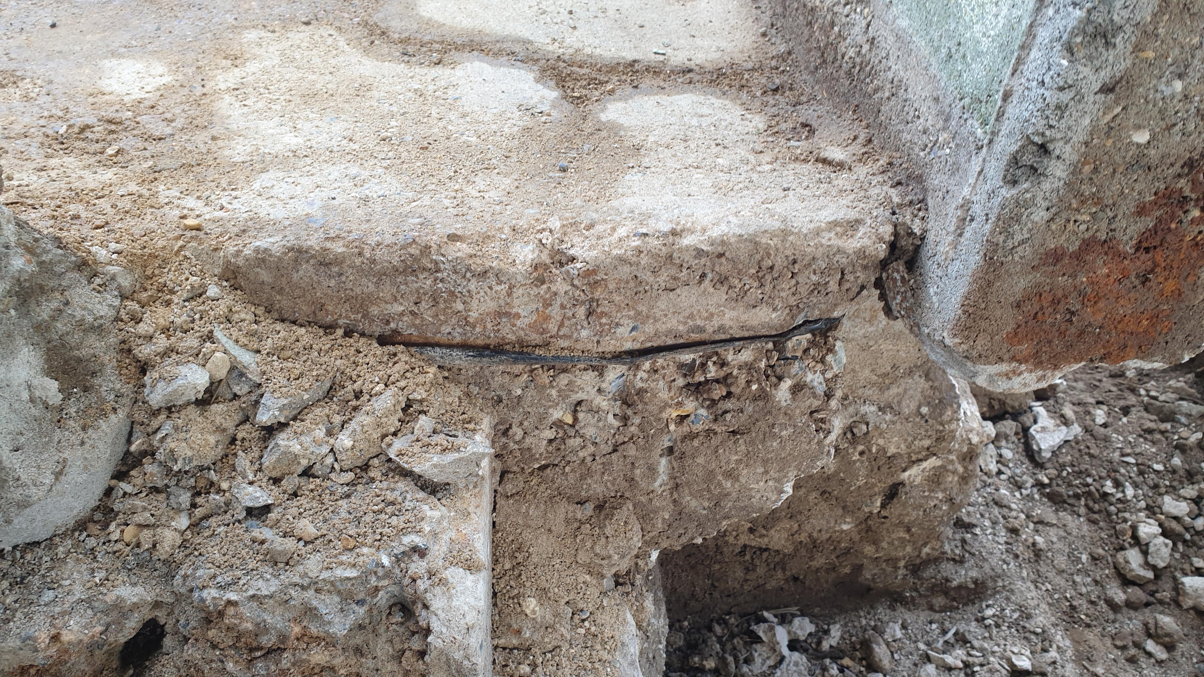

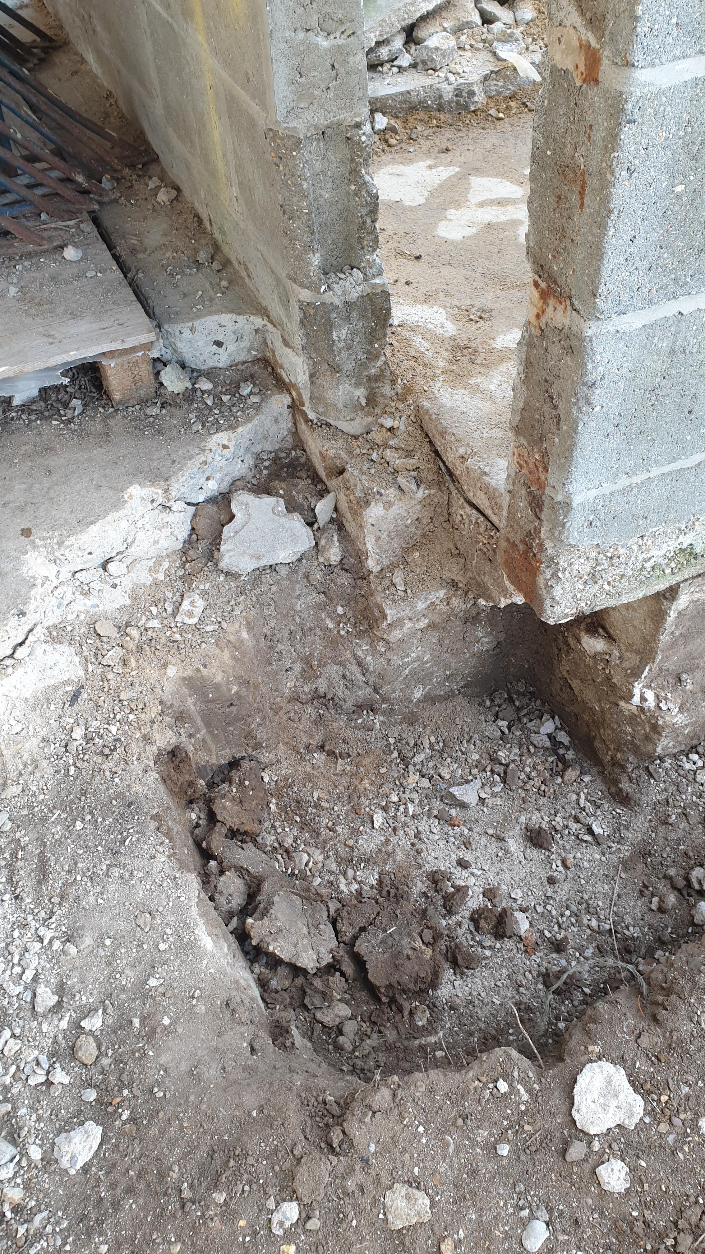

Hello Next question. On Sunday we started digging out the floor of one of the areas of the barn to investigate further the underpinning requirements. The existing floors are concrete on concrete on concrete on and on. We were planning on removing all the existing floors to put in new ones with insulation and UFH. But, we have now found the below. On the first picture the wall that needs underpinning is showing the end, a new block / block wall is going off to the right from there and this wall will have EWI on the outside or possibly a 2nd skin with cavity. We have to keep this wall. This picture shows the top level of concrete we are removing, about 3in with ballast below, breaking up very easily, not attached to the outside at all so no idea why they needed this for the piggies. Wall is 6.6m long, the wall facing is an internal wall that is going to be knocked down and is no longer attached to the outer wall except by a couple of rebars. The wall above the DPM is also not attached. this shows where we removed a large lump of concrete with a steel post above, not attached to the remaining wall to the right. Attached to the internal wall that will be knocked down facing. The existing foundations are about 50cm and we have to go down to 1m. The wall is stable at the moment. Question is; are we likely to have to keep this floor and DPM, if we do then we will need to step up into this room (snug) as the rest is lower. We are concerned that if we remove it that the wall will become unstable when our plans say that we must keep it, but underpinning, even at 1m at a time will be much more tricky if we don't remove. If we keep then we will add insulation and screed as the floor on top of the DPM is not level because of the previous use and the requirement for drainage. The BCO is coming out soon, but wanted thoughts before I discuss with him. Thanks J
I watched the episode yesterday building a big extension, they showed the trenches, almost entirely in clay, yet only 1m. We have been told we have to have between 1.6 & 2.4 where we have clay. Original house had already been underpinned. Also, the concrete they poured had a very high (or is it low) slump, looked like water, and then said it could be built on in 2 days which I was surprised at. But, this program, in my opinion is much better than some of the others as they do talk about some of the building bits.
I totally agree, but will leave for HID (building) to discuss with BCO as that's beyond my expertise. Got slightly more complicated now as digging down yesterday to expose some of the existing foundations we have found a DPC across the whole floor of this 'room' which, as it's nominally a conversion, we may be required to keep which will lead to multiple levels in the dwelling. We were planning on underpinning then when the walls were stable digging down to start from scratch. There is no insulation so that will need adding which will raise that particular level from the rest quite a bit. None of the other floors had DPC when we dug down.
