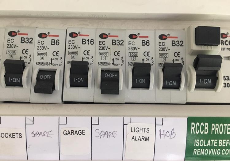

  8. Hi Mark. The 16a feed from the consumer unit to the garage is a single 2.5mm cable going to 1 double outlet. I was under the impression there was no restriction on adding extra sockets to a radial, but happy to be corrected I have misinterpreted against what can be done and what can be done without notification.
  9. Back in 2014, not long after moving in to our current property we had an electric shower installed which required the consumer unit to be upgraded. I didn’t receive any certification and it completely slipped my mind. Fast forward until recently when I had my garage extended and I remembered the lack of certificate. Contacted the electrician who did the work in 2014 and he couldn’t find record of the installation and stated as it was over 5 years it wouldn’t be valid anyway. He came a couple of months ago to do a test. Whilst he was here I asked about some changes to the electrics in the new garage so he decided to not finish/produce the test and do so when the works in the garage were done. After chasing for the quote 3 times I have given up and have no certificate. I suspect when we come to sell (not for a long while) certification of some sort will be requested. Would an EICR produced in the near future post garage electrical changes, or nearer eventual resale retrospectively by another electrician confirm the consumer unit change was done competently assuming it passes the tests? The changes I wish to make to the garage are: Increase the number of sockets on the 16a radial. Change the single batten light for six LED panels on a 3 gang switch. Change the single outside light spur to two outside lights. As these changes are to existing and not new, outside of the kitchen and bathroom, I believe I can do these myself as non-notifiable minor works. Would subsequently appointing an electrician to do an EICR confirm my connections are correct and draw a line in the sand for our records that the consumer unit and works were safe as of 2021, at least.
