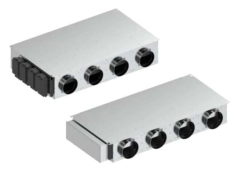

Two sorts of fan coils for ASHP a wall mounted unit, that heat and cool, something like this - one needed per room Or a multi room unit. Which you would duct to rooms similar to MVHR, but everything is sized to suit heating and cooling Install depends but no more complicated than a radiator. To heat pump you determine heat loss, how you deliver heat has little bearing on size of heat pump. I wouldn't size for cooling only heating, which is more dominant duty. -
