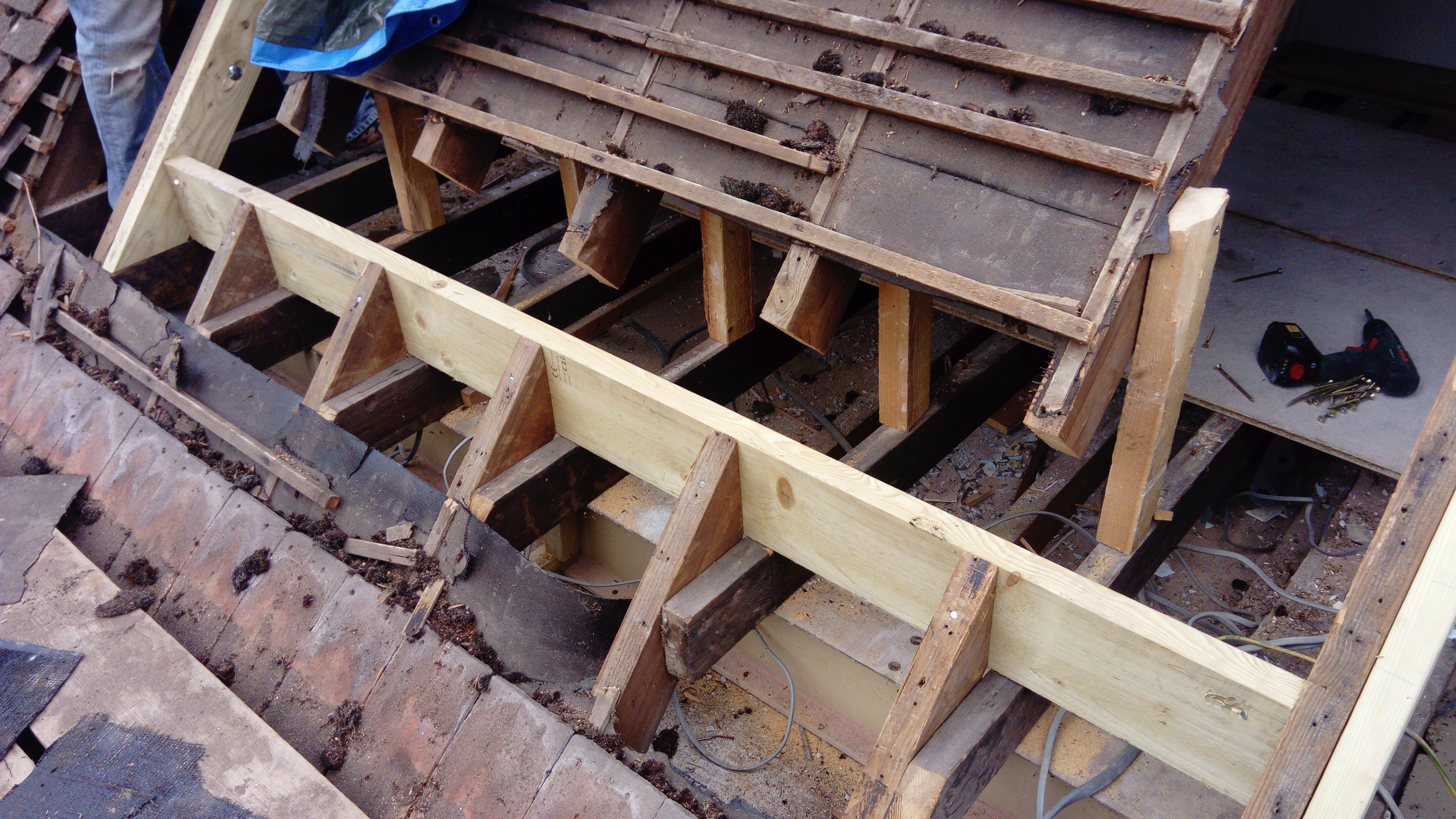

  1. Yes, using 6x2 for the ceiling joists There is a blue brick wall that separates a bedroom from the room that is being created by adding the dormer, The rafters that have been cut at head height, rest on the purlin in the attic above.... I cut them at the bird mouth notch that sat on the wall plate. . . . . . . . ( bedroom wall) Does that make sense or am I confusing everything? I'll post a picture tomorrow

  3. @Simplysimon. We've done everything you did upto bridle joist? Could you expand on that please ? BI suggested cutting existing rafters off at top, vertically at bird mouth notch so they sit flush with front of wall plate, then some fixing for peace of mind. @ProDave. I'll post pictures tomorrow... Got too tired wrestling with huge tarps that have a mind of their own!

  6. Yes they will be cut off but ran out of daylight. Roofing square, yes. Technical drawing experience, no. This is the first project that is truly beyond me so it is husband who drives this one.
  7. Upper end supported on brick wall with wall plate ontop (into attic) Did a bird mouth notch. See your point on rotating top timbers 90 degree, Haven't glued anything until BC have been to look NB... We bought the house with planning already granted so we're going with what we have, there are no sectional drawings of any great detail

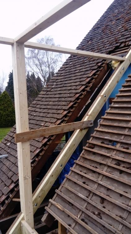

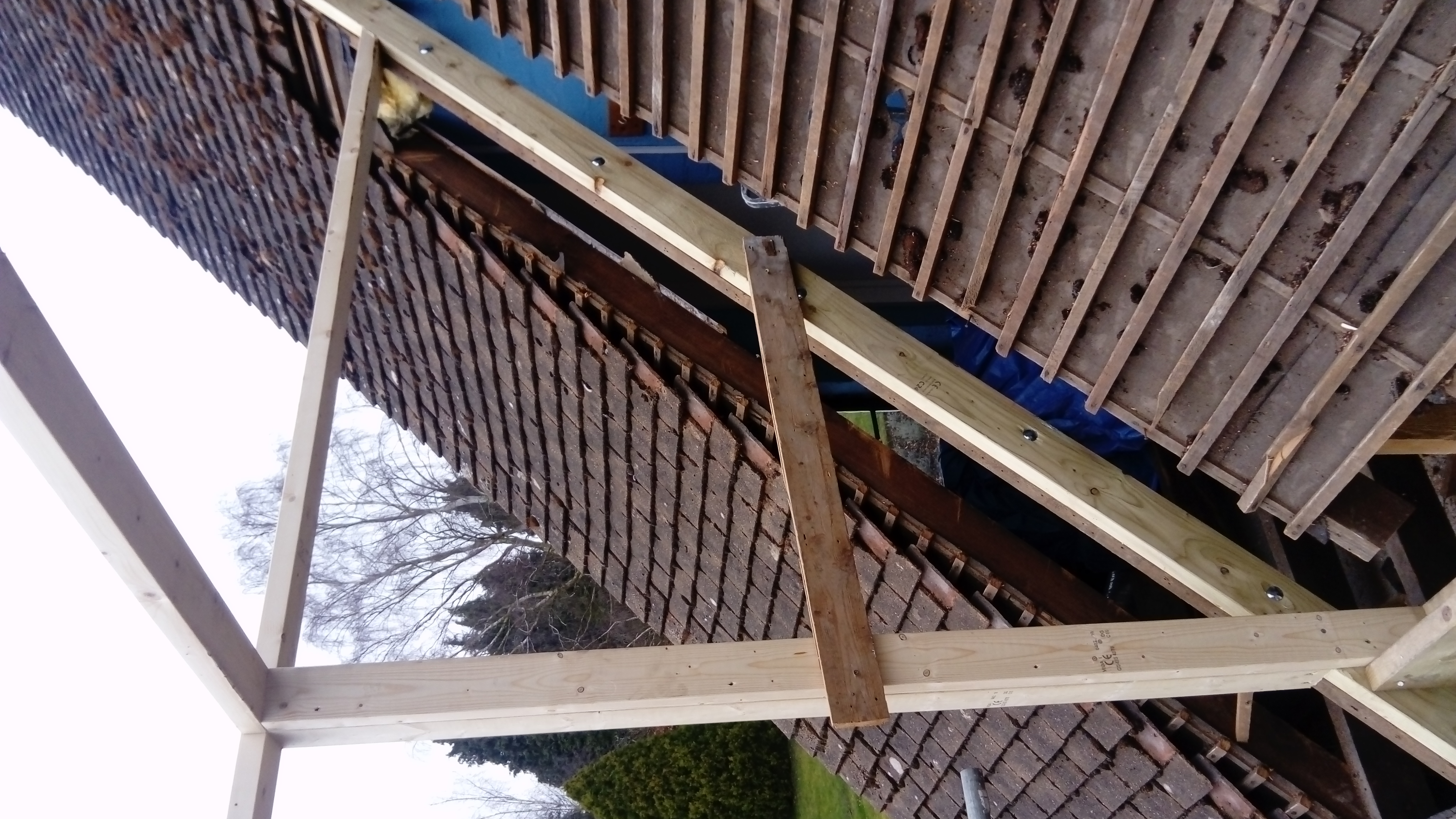

  8. Top front horizontal in the photo is 2x4 but another one to go on top..... So will be 4x4. On the cheek rafters is a temporary brace.... is that what you mean? The front elevation is 2.2 with a 920 aluminium window and all that front sits on the steel you can see in the other photo. The corner posts are made of 2x4 and another at right angle Feel free to put me right! Top front horizontal to on the weekends progress. I'm getting building control intomorrow for his opinion before we go any further.... If anyone spots anything wrong
  9. A quick update photo on the weekends progress. I'm getting building control intomorrow for his opinion before we go any further.... If anyone spots anything wrong or missing then feel free to comment....
  10. I happen to have lying around some 50 x 250....is this too much.... I could cut it down.....Thank you and Good morning!
  11. What size timber should the header be? It's 2.4 wide.

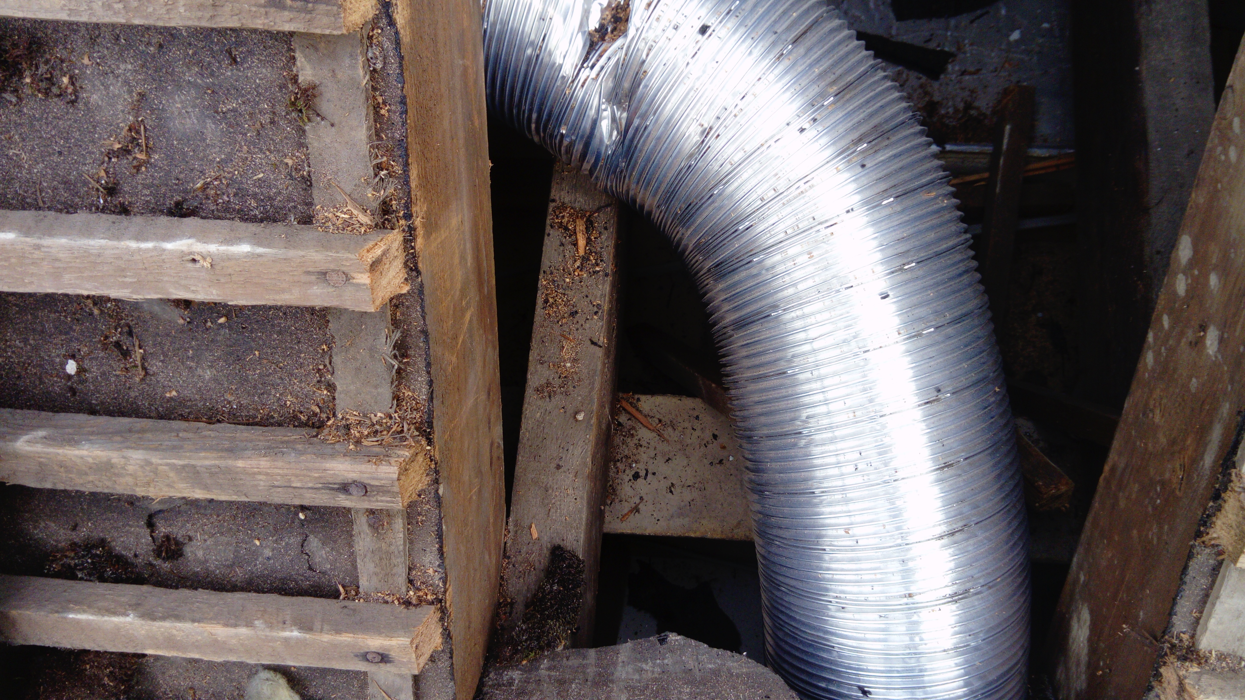

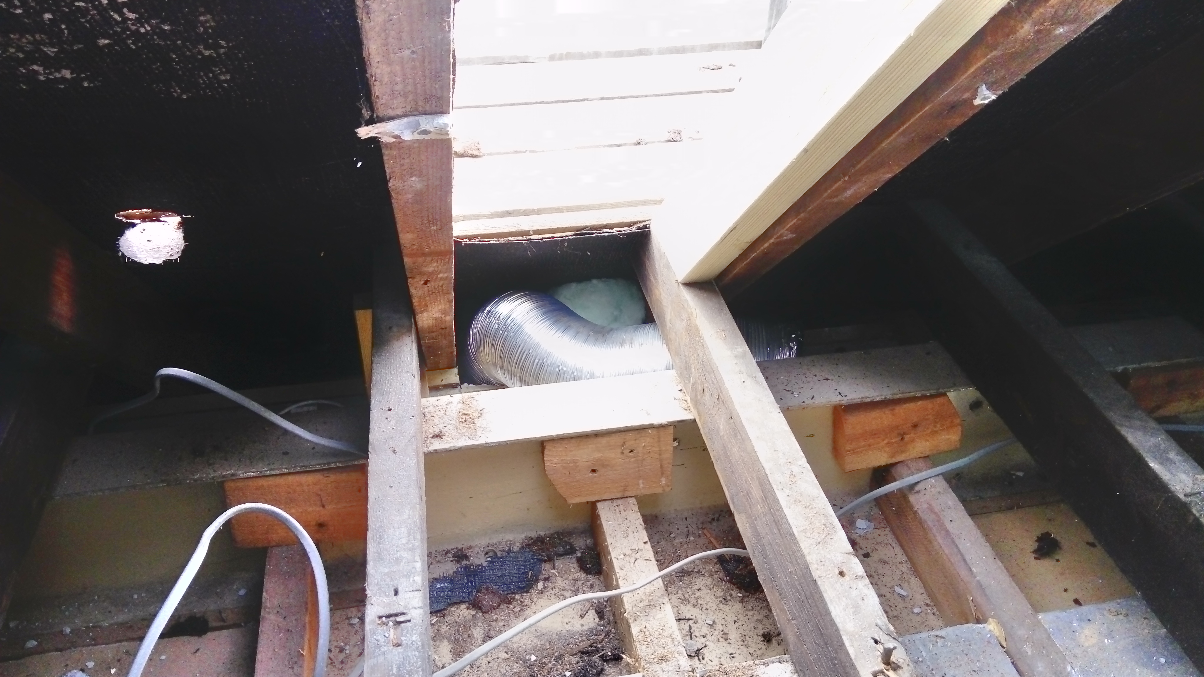

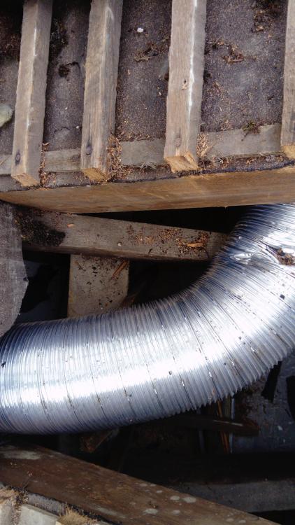

  14. Yes it is a extractor flue but I can redirect it

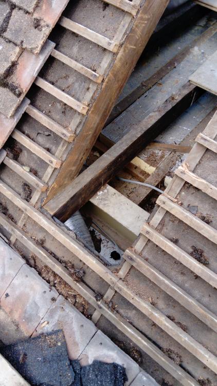

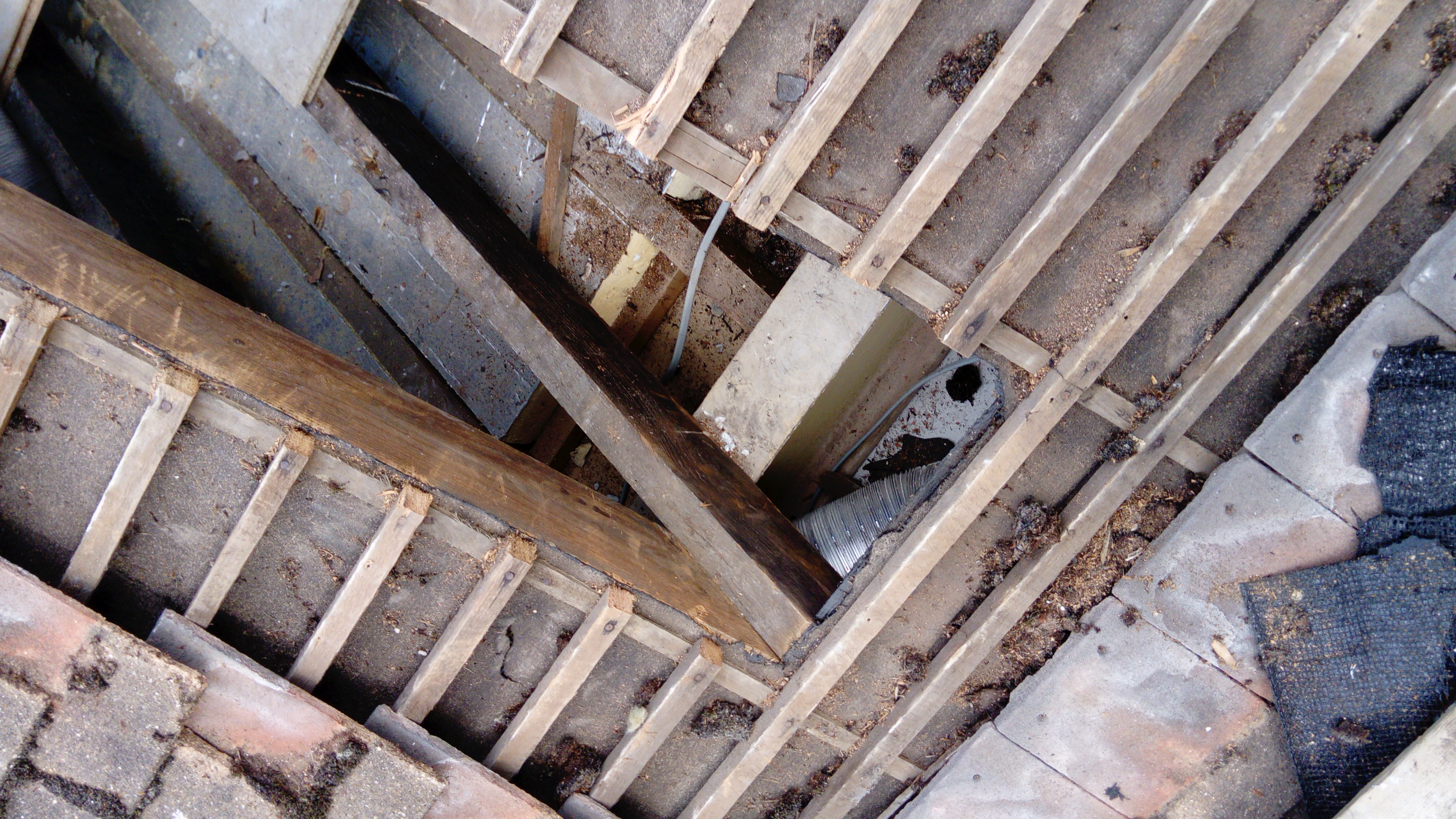

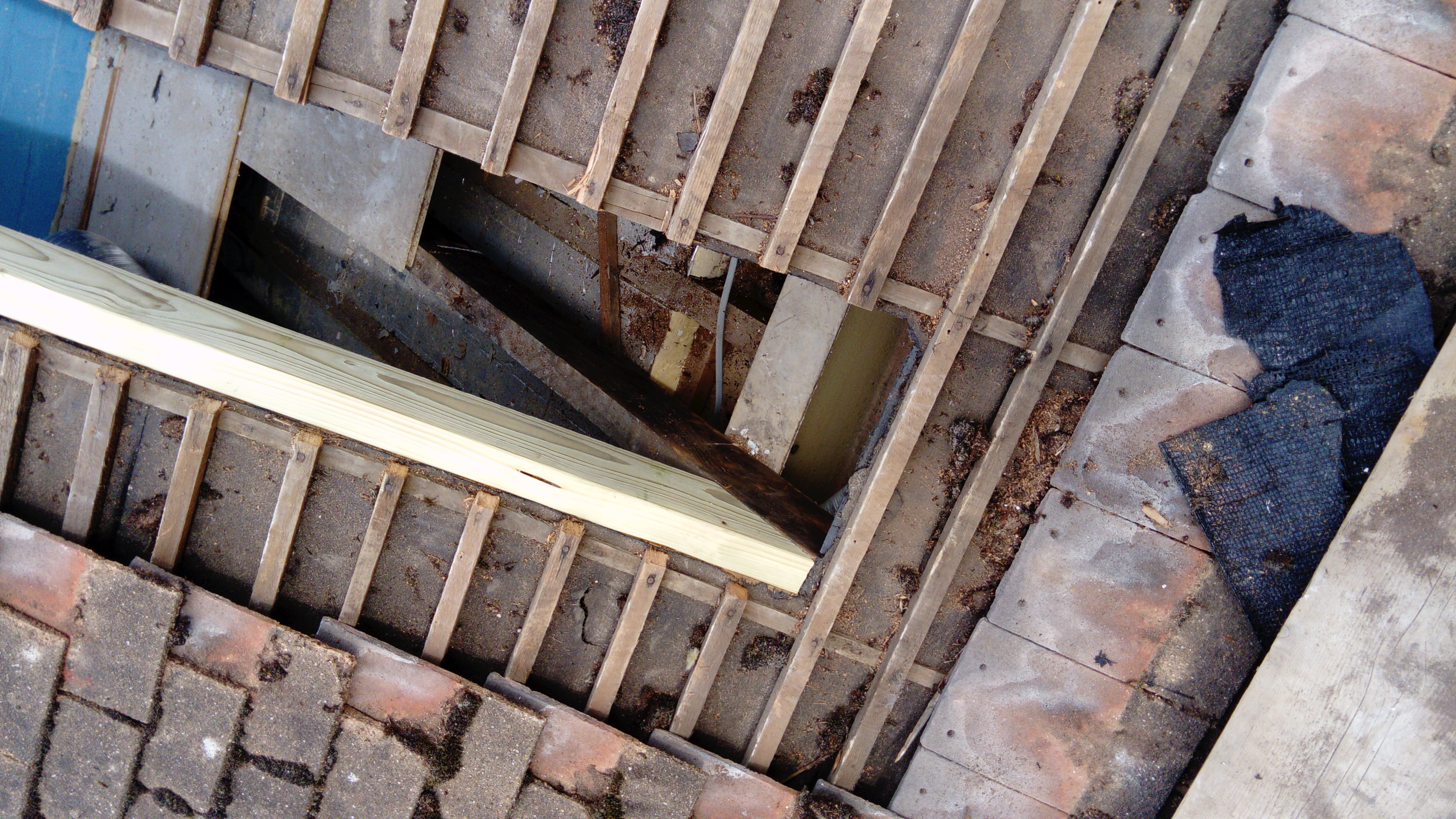

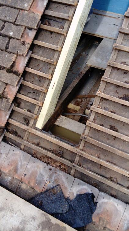

  15. First issue uncovered.... See image The new rafters will sit on the right of the existing but there is a joist in the way.... However the joist sits on a steel so will it be ok?
  16. Thank you ? I have to overlap the new rafters that sit alongside the old as it's 6m, how much overlap would you suggest?
