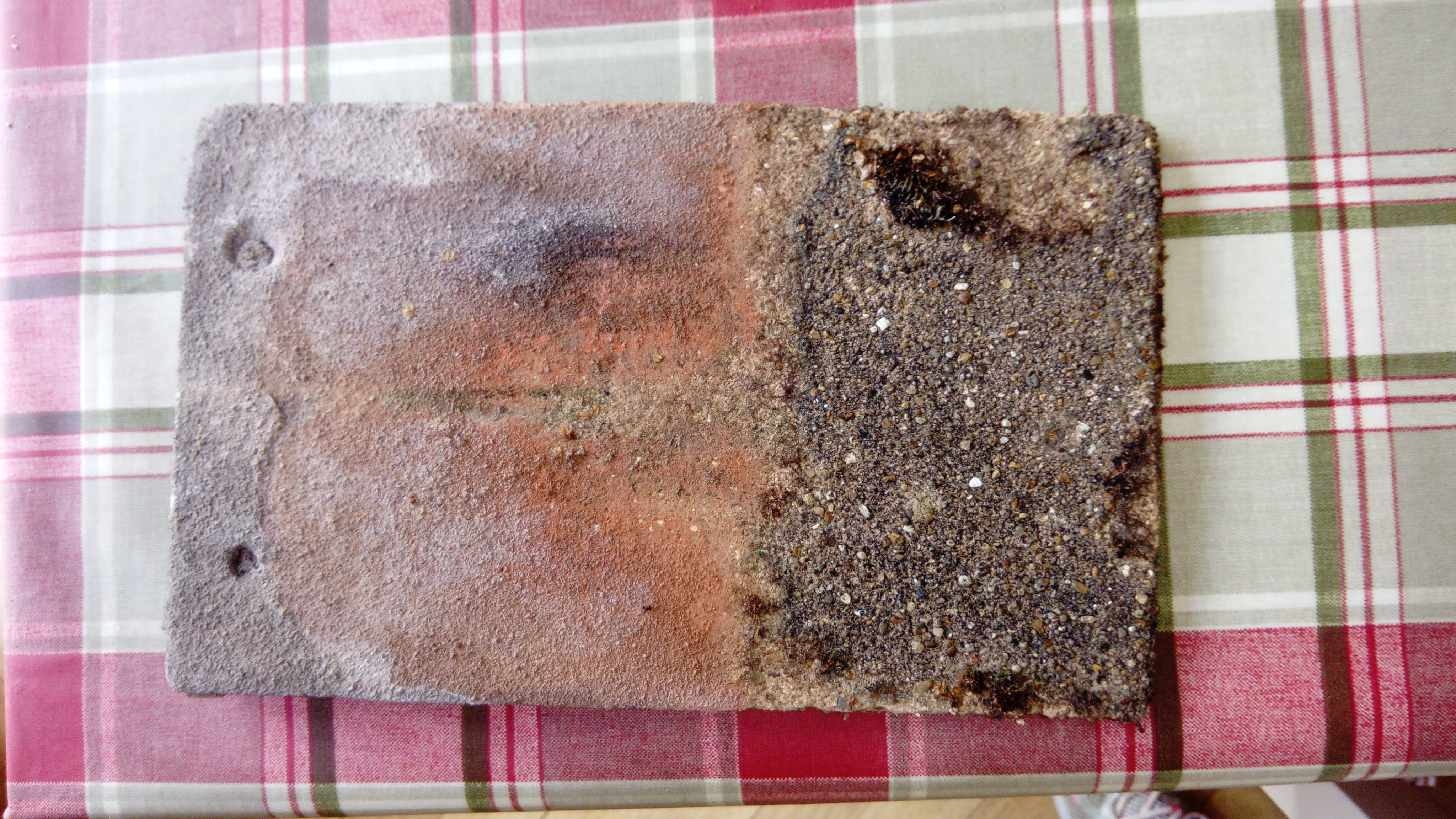

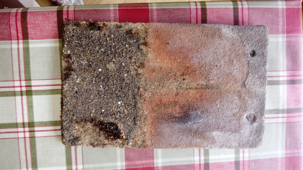

  3. Managed to find 11 tiles from 3a roofers in Copdock (thanks Nik) so I'll consider your suggestion @bassanclan @Steptoe. The photo is very accurate, tge tile started life terracotta /red and now all the colour has gone its just grey beige... Where are you located? Hope to start tiling this weekend so I'll have a better idea.

  7. Cannot find reclaimed concrete plain tile and a half for love nor money.... Exhausted all avenues..... Are there any work around or alternatives DESPERATE!!!

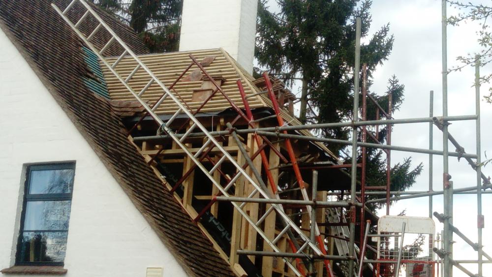

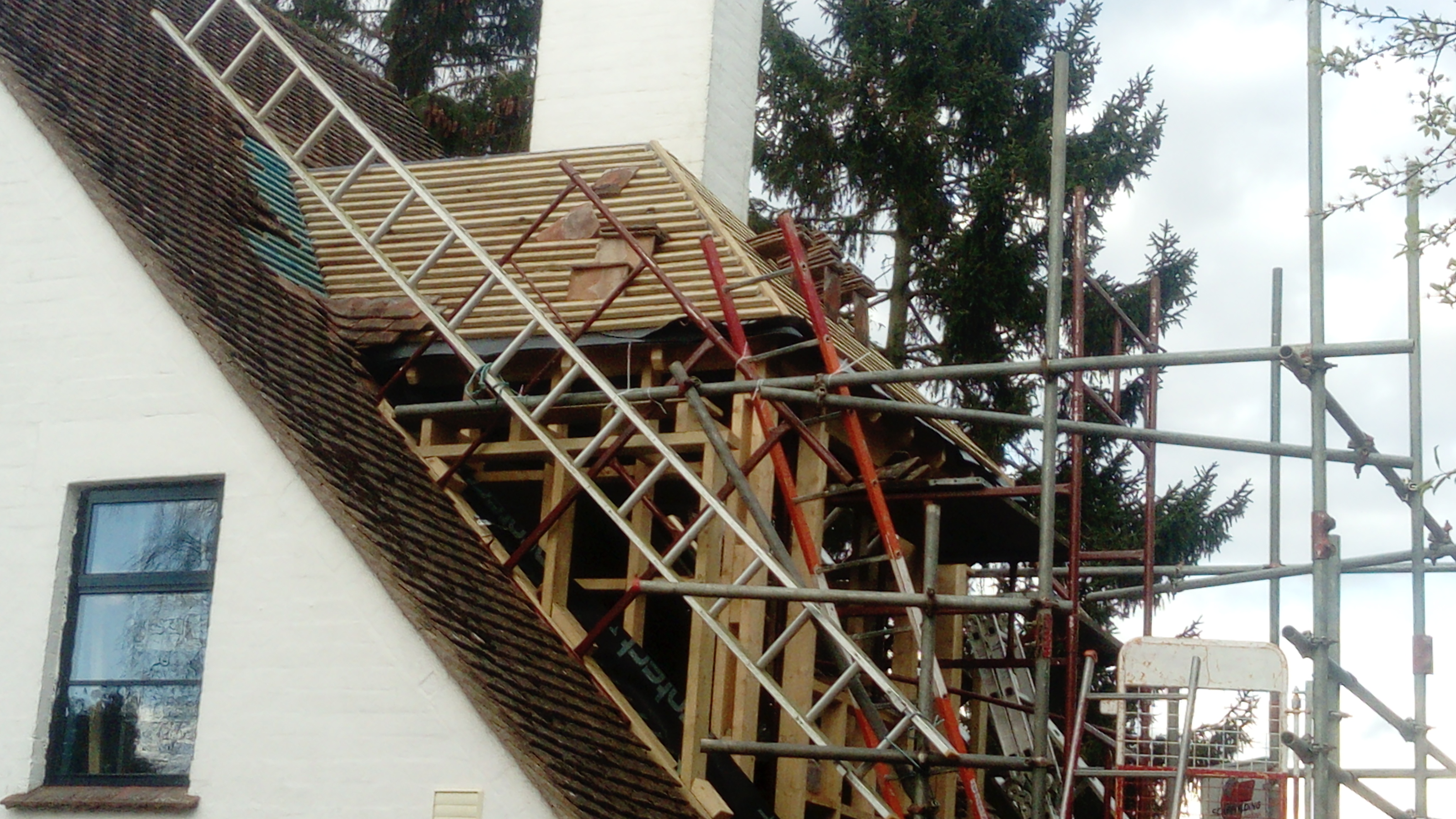

  11. Now the real fun starts with roofing...A challenge indeed Do you know anything about Roofing @PeterW?

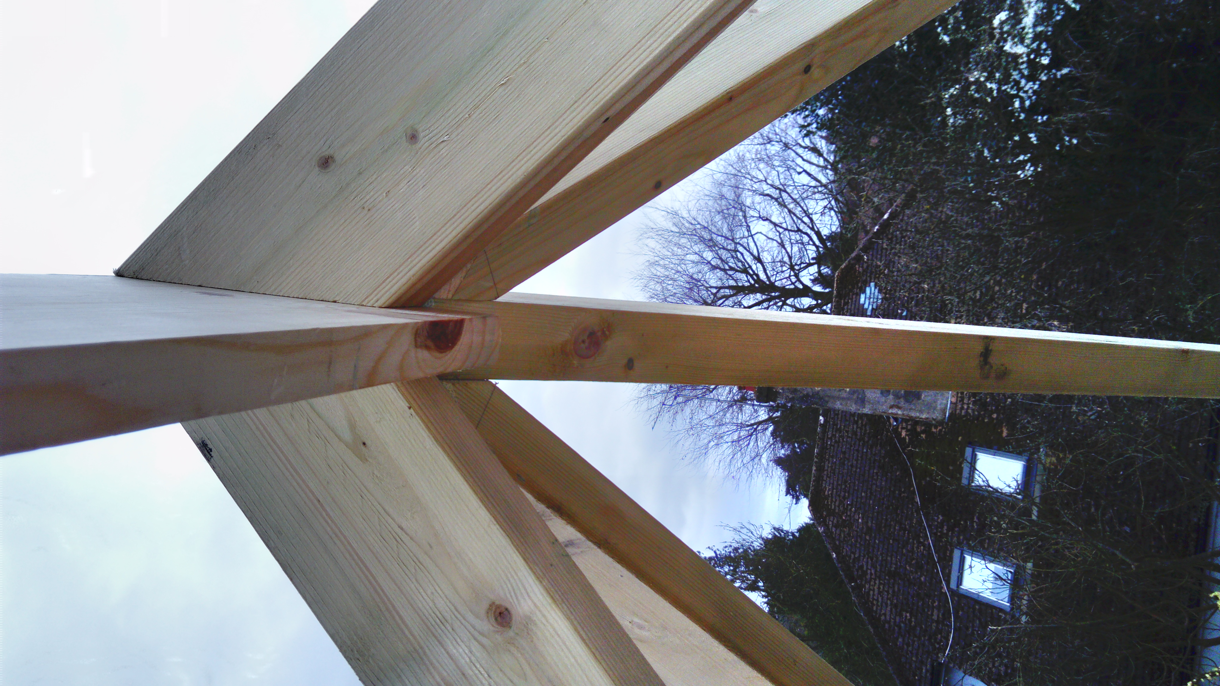

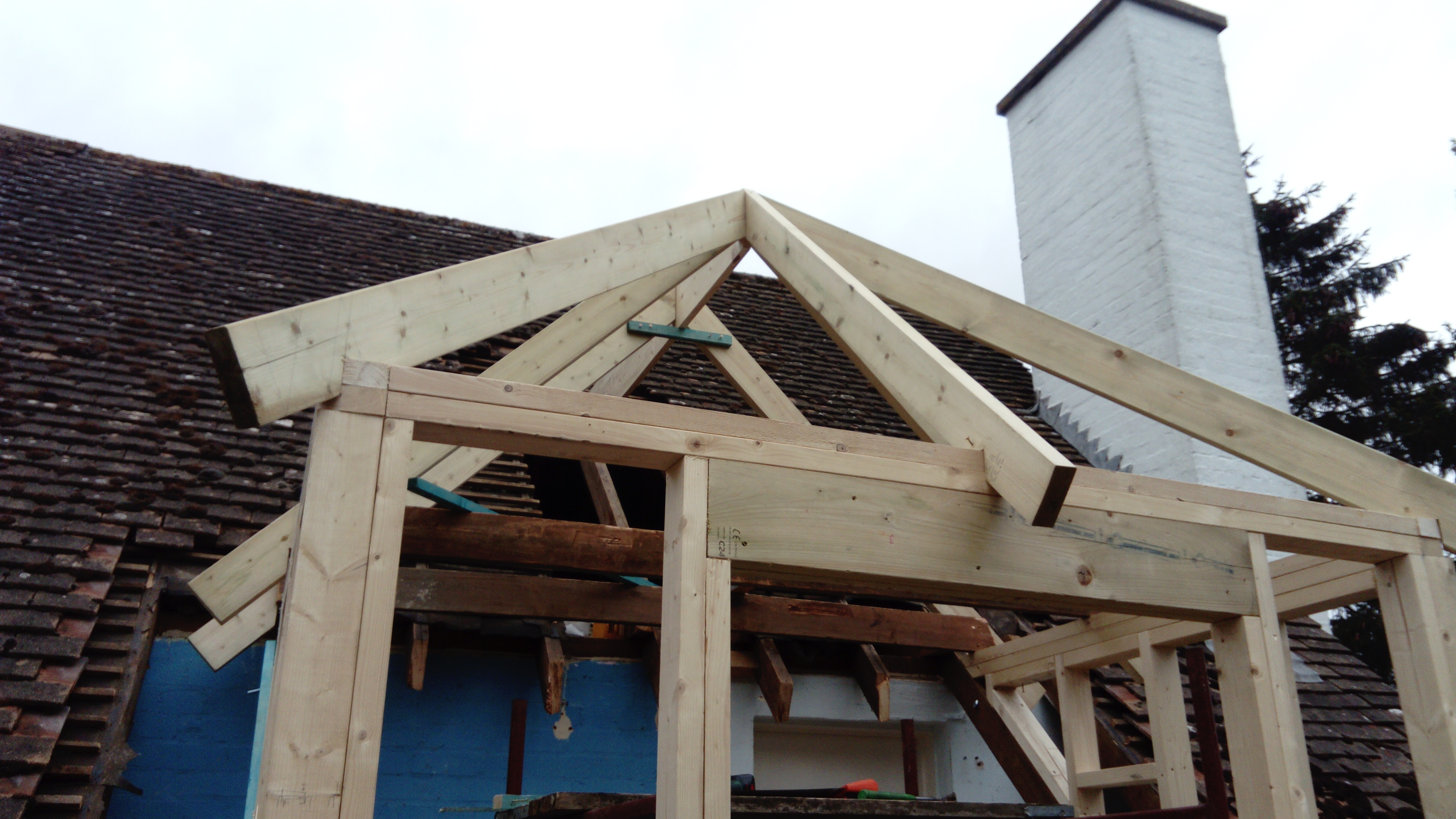

  15. Brief update...the bones of the roof up in a day.. And not one duff cut! It was fun putting the tarps over in gusty wind and rain ? Any obvious mistakes?

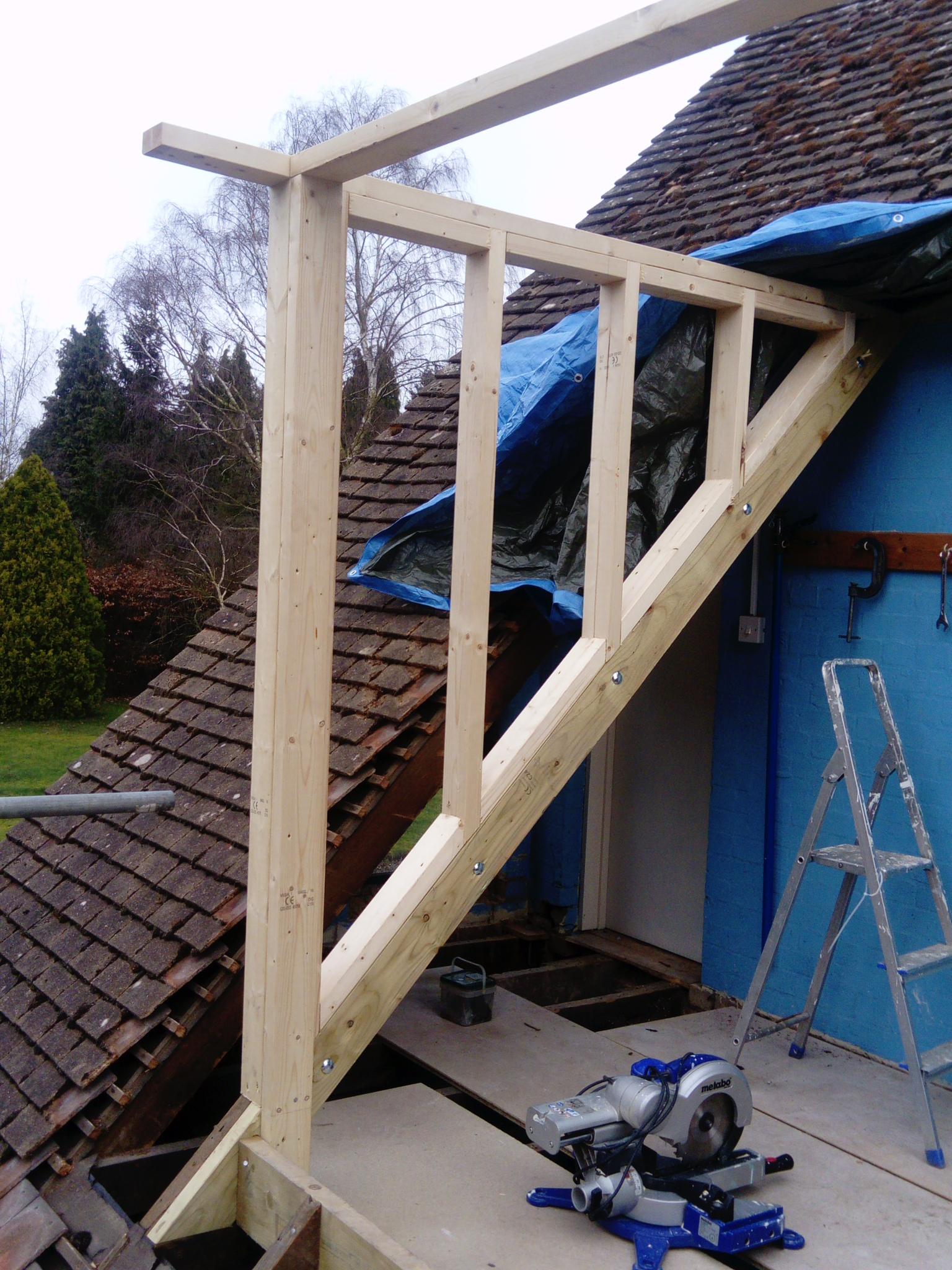

  16. Discovered a chuffing big steel running exactly under where the front elevation sits so what you see in this picture all the weight will bare on the steel....?
  17. Discovered a chuffing big steel running exactly under where the front elevation sits so what you see in this picture all the weight will bare on the steel....?

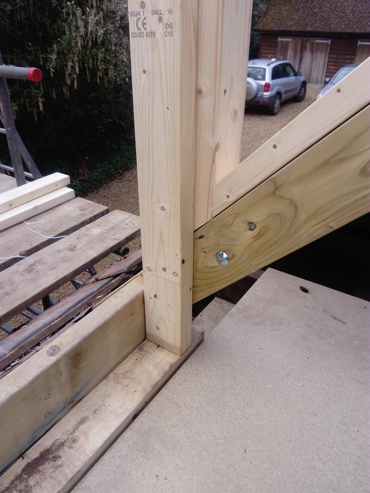

  18. The top timbers will be doubled up but I've run out and awaiting delivery of more on Thursday so will be 100x100... BI was happy with that. Also he suggested a lintel but I'm with you on that one so I've gone with two 50x175 on edge to keep him happy ? wWe bought the house with planning already in place by the previous owner. We modified the plans somewhat but as we have yet to have the project signed off I'm going with whatever the BI suggests! Excellent idea on the strap hanger... Picture please if you have one?

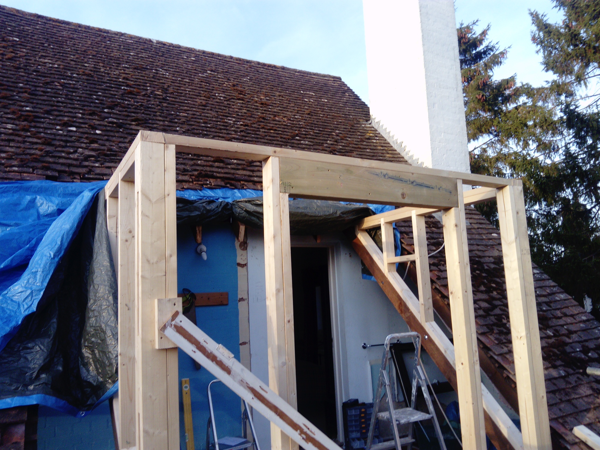

  19. Today's progress, cheeks up, lintel in and the start of the front elevation.... Noggins to go in but I'm waiting for scraps. Tricky getting it square and plumb but managed it!

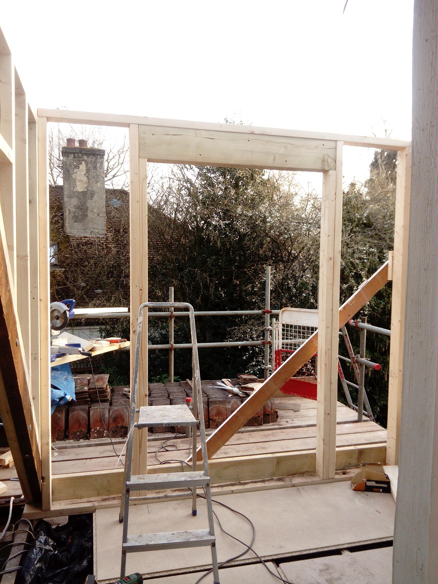

  20. I'll get to the front elevation this week but I'm unsure how to deal with the window surround. I have an aluminium window 1000mm wide, I know how to create the carcass opening but how do I 'dress' the opening when the window is in... I can't visualise it... I'll be using hardi lines weather board to clad the outside... Sorry for so many questions!

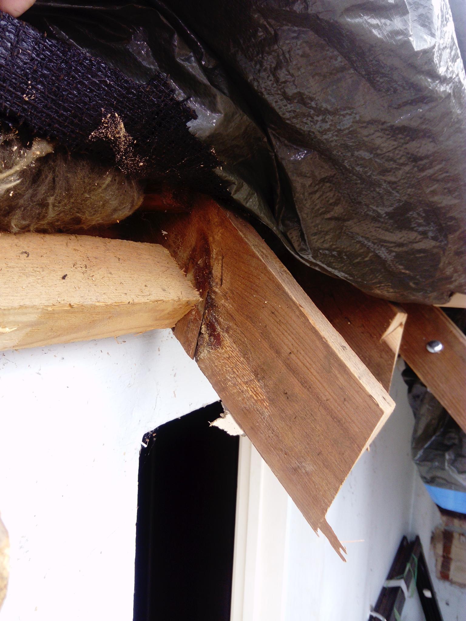

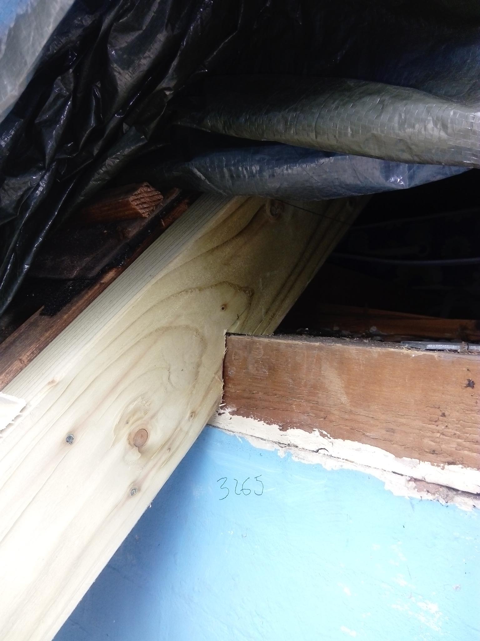

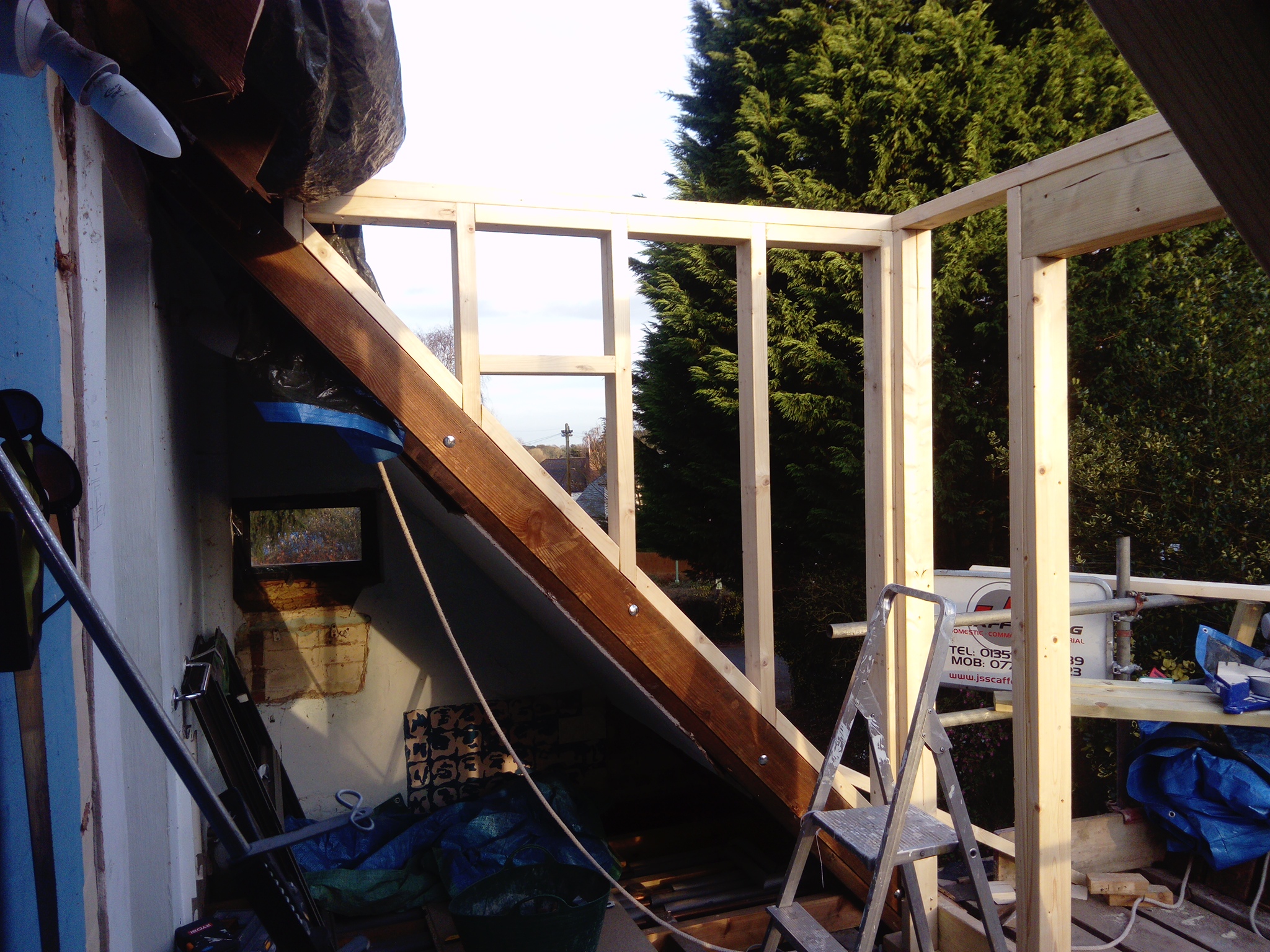

  21. Quick update with photos..... The old rafters are yet to be cut flush with the wall plate as per BRegs chaps suggestion.
  22. I'll get to the front elevation this week but I'm unsure how t deal with the window surround. I have an aluminium window 920mm wide, I know how to create the carcass opening but how do I 'dress' the opening when the window is in... I can't visualise it... I'll be using hardi board to clad the outside... Sorry for so many questions!
  23. Yes, using 6x2 for the ceiling joists There is a blue brick wall that separates a bedroom from the room that is being created by adding the dormer, The rafters that have been cut at head height, rest on the purlin in the attic above.... I cut them at the bird mouth notch that sat on the wall plate. . . . . . . . ( bedroom wall) Does that make sense or am I confusing everything? I'll post a picture tomorrow

  25. @Simplysimon. We've done everything you did upto bridle joist? Could you expand on that please ? BI suggested cutting existing rafters off at top, vertically at bird mouth notch so they sit flush with front of wall plate, then some fixing for peace of mind. @ProDave. I'll post pictures tomorrow... Got too tired wrestling with huge tarps that have a mind of their own!
