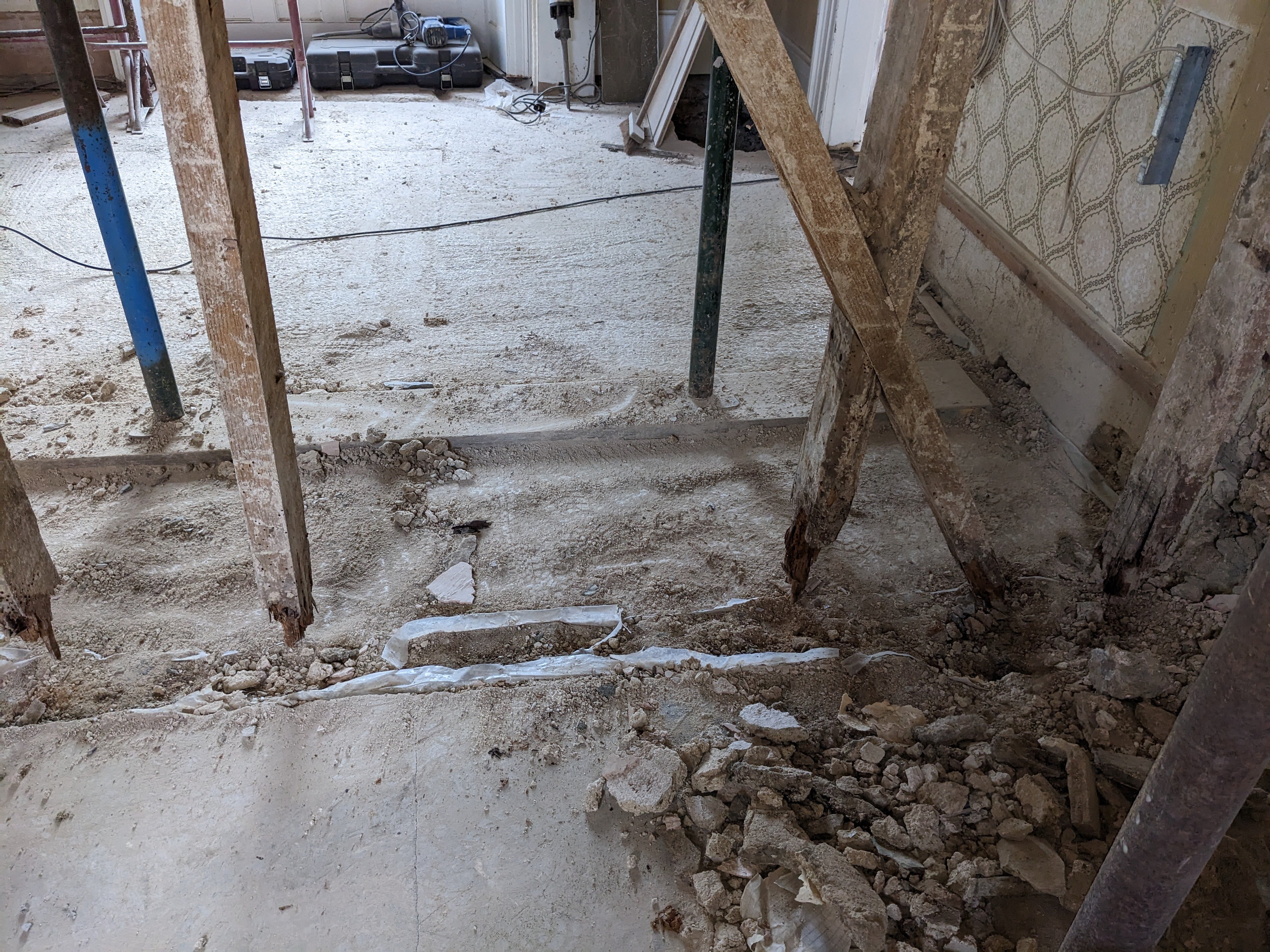

  6. Just outside of Callington. We've moved into the barn as well.

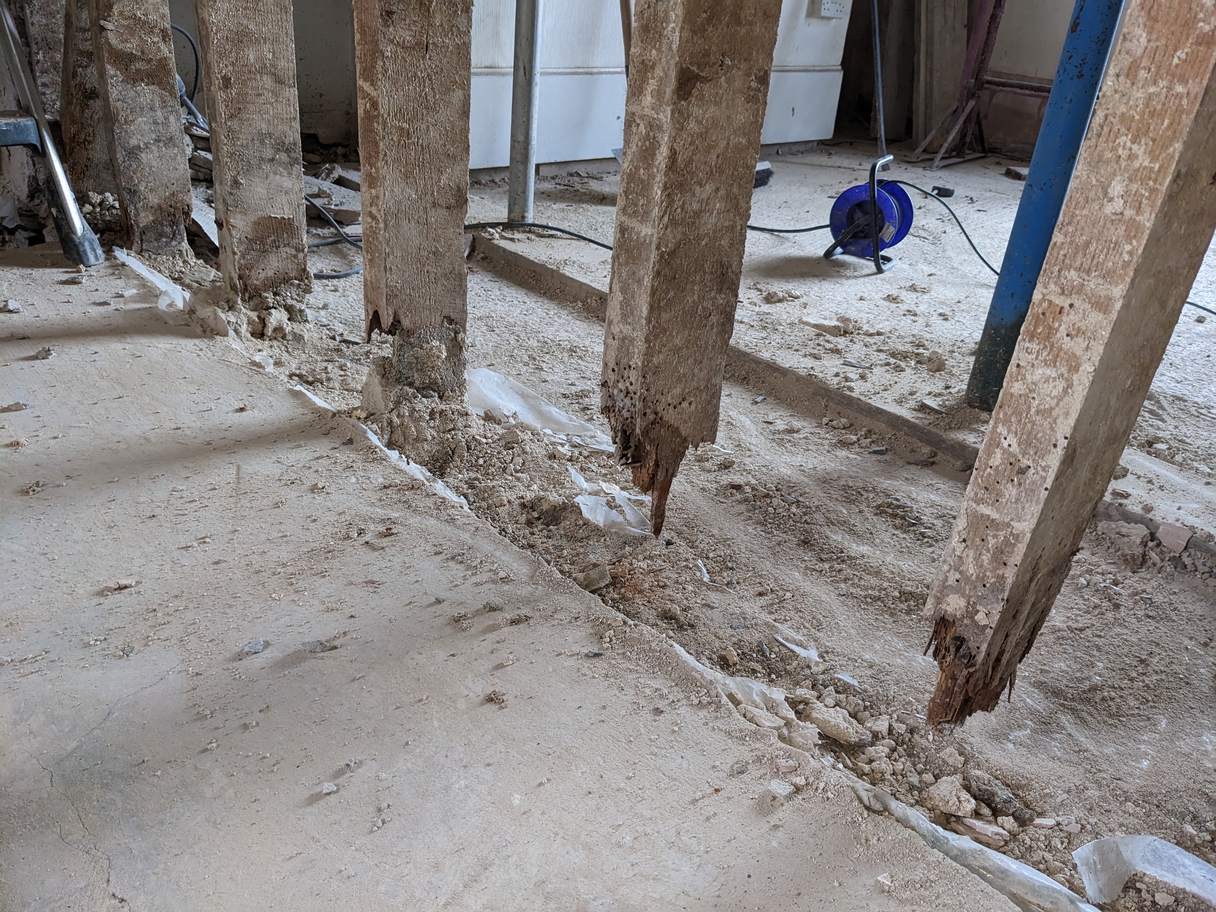

  11. In fact, what we did was to cut away the rotten section, screw in a stud, put a temporary shutter around it and then and then cast a new concrete 'foot' to support it - seems like a good solution to me.
  12. Boarding over definitely (or retaining existing lime plaster and making good).
  13. Renovating an 1850 stone built house. We are removing a stud partition with with slatestone infill wall between kitchen and dining room. We hired an SE, so we have a spec for steelwork etc. (We will also be digging up the floor, insulating it and laying a new slab with UFH). Upon removing the infill, we found rot at the bottom 200mm - 400mm of the studs (overall 2750 long by 125 x 50) and again: So here's the question. While this wall running EW will be removed, two other walls running the width of the house 6m NS (enclosing the entrance hall) will remain. We werent going to touch them, but it seems highly likely that they will have exactly the same problem, and if you are digging up floors, that's the time to address the problem. So how to remediate? These timbers might be 175 years old, but the upper 2.3m (say) appears in good condtion still, so it should be possible to keep the majority of the wall and to repair the lower section only? Suggestions please?
  14. Its 1851 built, in E.Cornwall. Slate (rubble) stone construction. Walls are about 530mm thick. We've dug down to about 500 and not reached bottom of the footings, so should be no need for underpinning. However there are two internal stone walls - don't know how far down they reach.

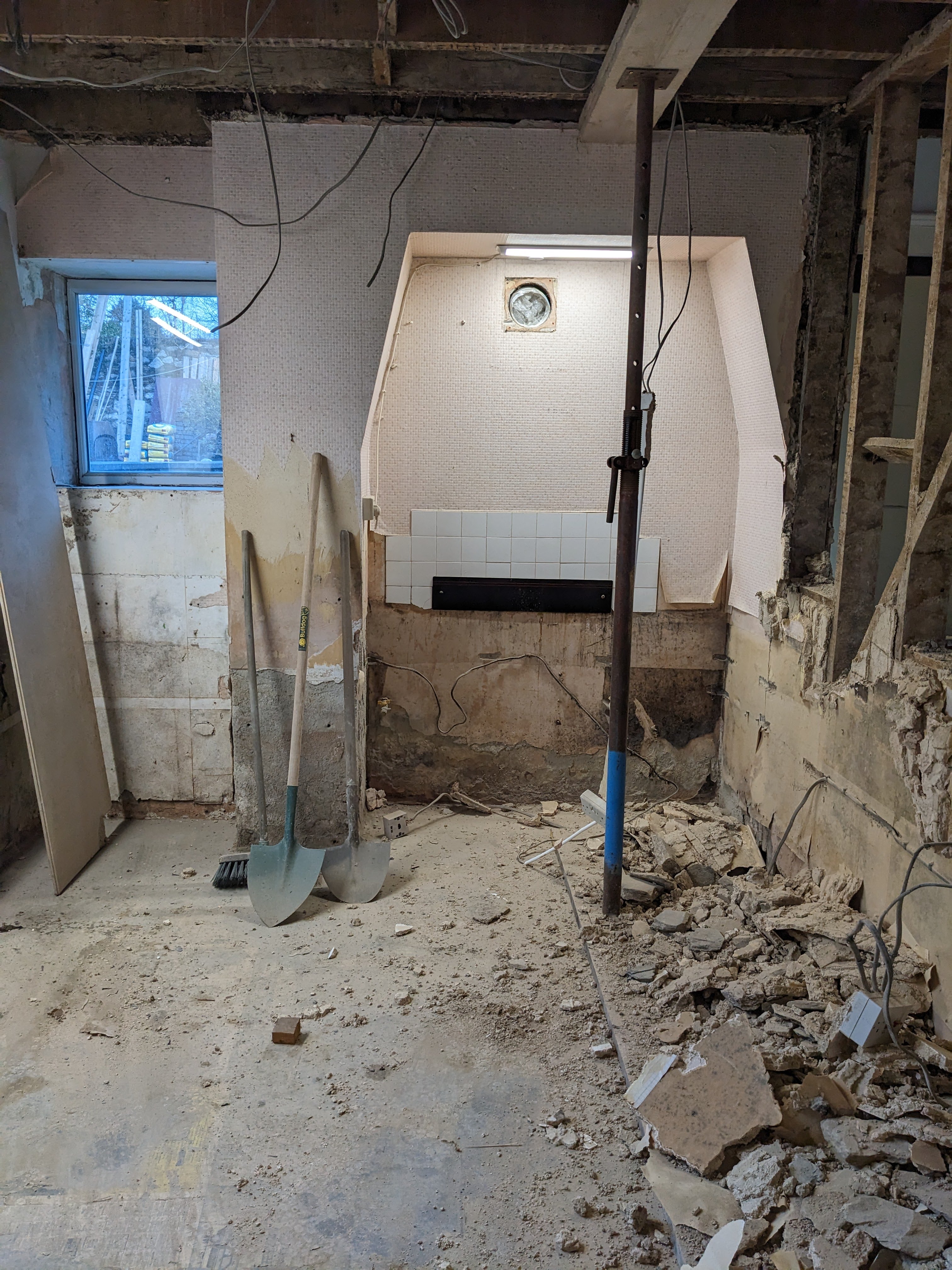

  15. This is a refurb of an 1850 building. We want to install wet UFH (and impove damp control), which means that we have to get (say) 150mm PIR minimum under the UFH pipes. So the 1970's uninsulated concrete slab (which replaced rotten wooden flooring) has to come out, and then the dirt underneath it scraped away to provide sufficient depth, after which we reconstruct the floor with membranes, PIR, slab. The approach @Chanmenie took appears to require the least digging out(and clearly because we are working in an existing building, the less digging out the better 😊 (Really useful discussion btw).
  16. I might have confused matters further here ... Back on April 30th, I thought you were agreeing with @Chanmenies post namely "put the slab on top of the insulation". Then you later described your floor makeup, which was concrete slab below insulation. My point was "did you have a strong reason for putting your slab below the insulation when you did your floor?". (I think some people do it one way - others the other way. Completely take on board your suggestion to use 100 concrete with fibres, And your suggestion to estimate costs and use that to support the revised proposal is also a very good one. If this were simply my decision, i woouldn't have a problem - but I will have to convince my SE of the merit of using a thinner slab, and possibly even pouring the slab on top of the insulation).
  17. back on April 30, in response to "Why a slab and a screed ? That’s like doing it twice", @saveasteading wrote "That is 2 of us think that then. I cant see what the bottom slab is meant to be doing other than provide a prepared and clean surface." and then yesterday, wrote "To summarise, we laid sub-base, dpm, 100 concrete, 125 pir, more dpm, 60 poured screed. The latter was by professionals." I've probably misunderstood something here, but that seems to be suggesting one thing but doing another - so there are clearly other factors in play here ! 🙂 We are taking the old slab out in order to lay an insulated new slab with UFH. (It probably does not make sense financially, but thats not the point). We are also constrained as to how deep we will be able to excavate without requiring underpinning. Our trial pit shows we should be OK with removing 300mm, so by limiting my slab to 100mm, pouring the concrete on top of the insulation and setting the UFH pipes in the slab, I can squeeze more insulation in, and avoid an additional screed. I'm sure there are some downisdes/risks with this approach - I'm just not sure what they are 😟
