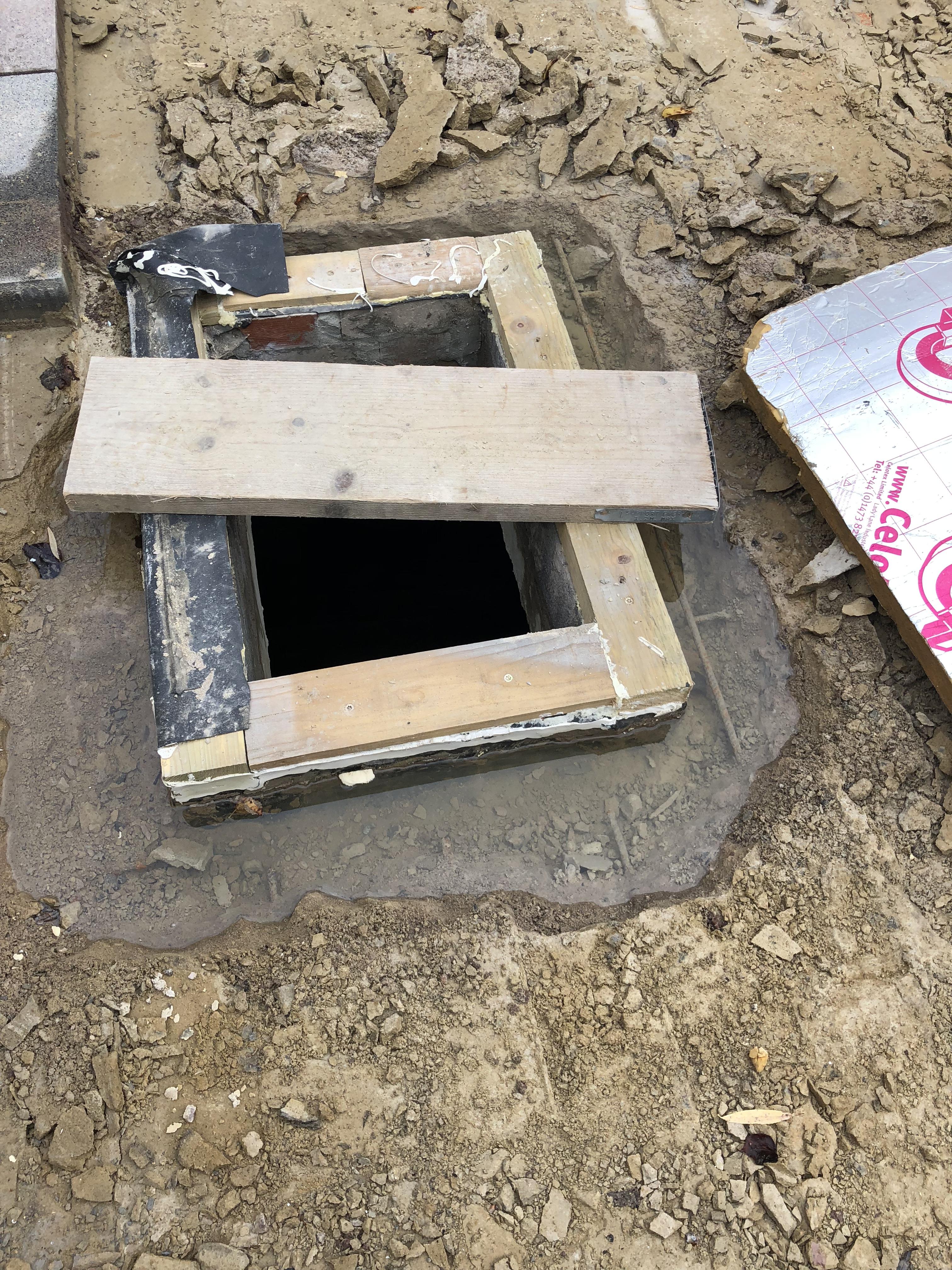

  6. Here’s a pic As you can see the double glazed unit siits down in the hole . The structural part of the glass sits on the ‘T’ frame . So no access to anything internally . No access to under edge of ‘T’ frame externally ?
  7. Can’t . frame is ‘T’ shaped so you can’t get to the edge outside . Glass itself just sits on rubber packers - sat in turn on the frame ( I was told to do it this way by the supplier ) . Only way is glass out so I can ct1 again under the frame .

  12. Ct1 on the upstand then screwed in place . I wasn’t keen on this because there’s no way of knowing if it’s a perfectly tight seal all around . Im tempted to cut the structural silicone out around one piece of glass . Remove it . Then re do the ct1 between upstand and frame . But I’ve still got no idea how perfect or imperfect the seal is until I put the glass back in and silicone again . Also the largest glass weighs 130kg - so not much fun ....
  13. Lol Nope ! i did wonder if it’s just a ct1 everywhere job . To get under the lip will be difficult . Will post photos tomorrow. Really need a ct1 expanding foam type mega product . Actually how do I get ct1 under it ????

  16. Maybe. Kind of discussed it here a bit ....
