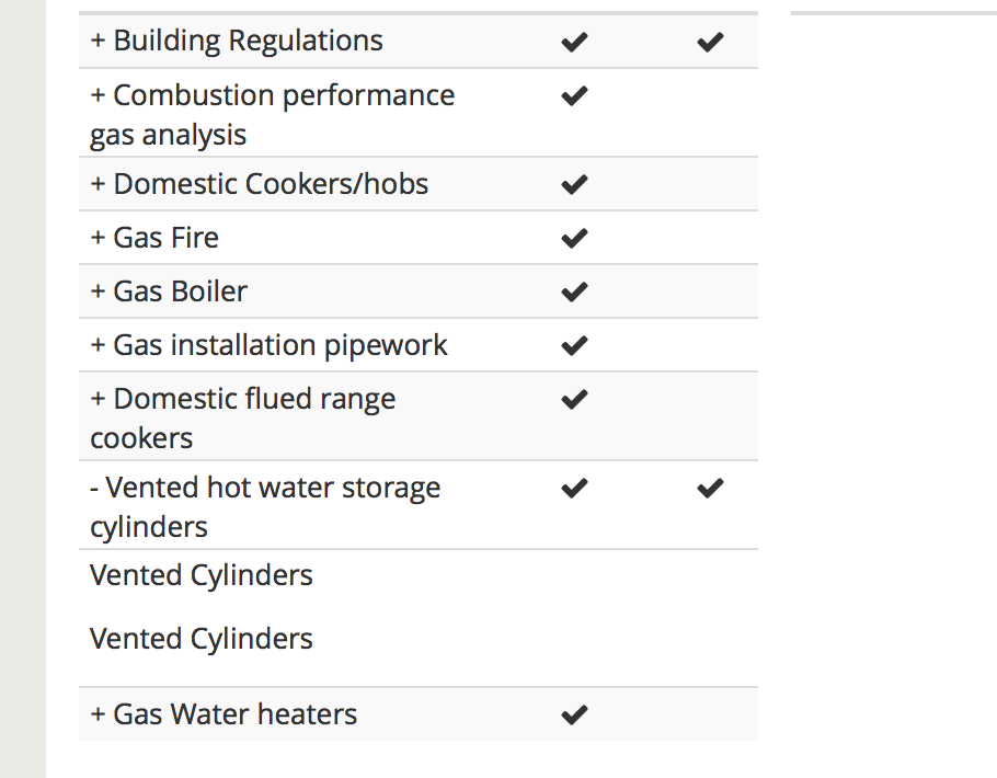

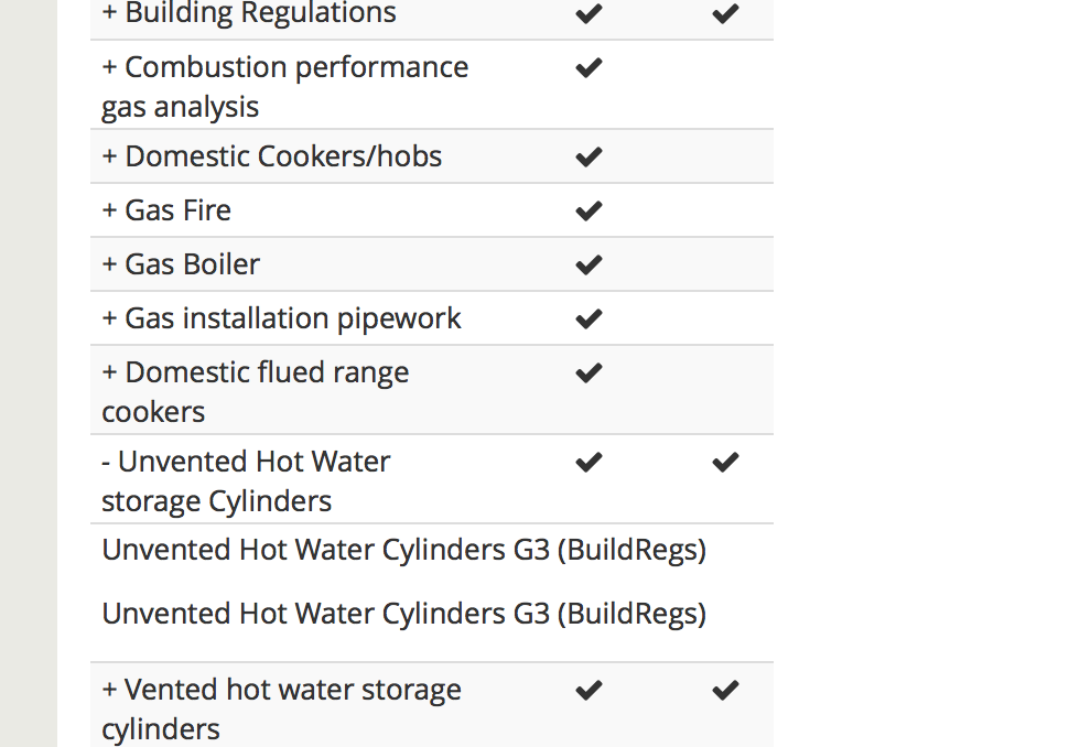

Right!. I've just spoke to Gas safe and as usual I'm given the run around. G3 doesn't exist he said ? But you can have a certificate to say you are qualified to install UVC but not be G3 EH?!!!!; - EHHH!!!
Sorry @PeterW you are going to have to explain that in precise detail. But first is he G3 or not???? ( I'm guessing not compared to the other random search )
I can taste blood now!
Ohhhhhh, sent me his license number !!! Place your bets G3 or not? I bet he is!
Installer has replied saying it doesn’t need to be registered as it electrically powered not gas . Asked him 3 times for his license number ...... All getting messy now - like it always does
