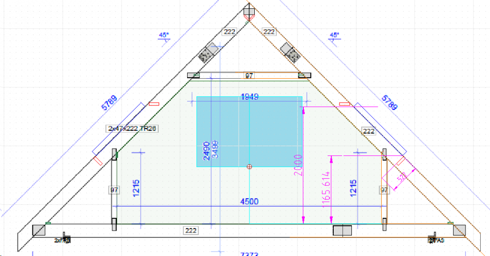

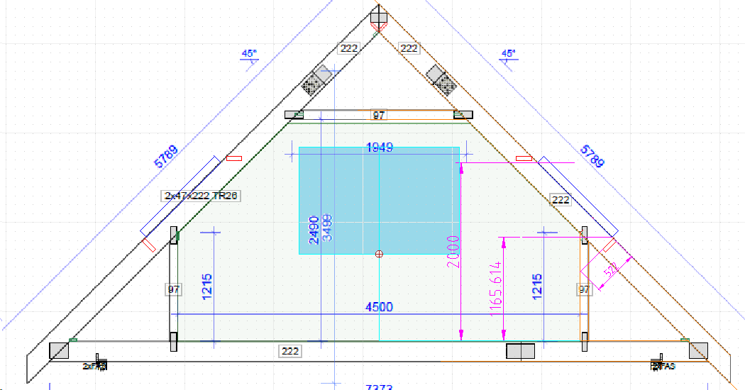

The truss designer is talking about doubling up the whole truss, but I don't understand why the whole truss needs to be doubled rather than just the rafter part. Doubling the rafter can be done on site with the benefit of time whereas doubling the whole truss requires a lot more thought -
I was thinking of incorporating Dormer window provisions into a roof truss design to allow for future conversion, but have changed my think on that in large part because it needed too much input at the truss design stage. Another reason is that it made for big gaps between some trusses. I had thought I could simplify matters by using Velux windows instead. It normally seems to be simple to fit Velux windows by doubling up the rafters on each side, adding purlins top and bottom and then cutting out sections of any rafters in the middle. I spoke to the truss designer and he said for attic trusses it wasn't that simple. I don't understand why. Is it because attic trusses have bending moments on their members rather than just the tension and compression loads of a fink truss? Even then I still don't see why it's anything more than doubling up the rafters either side rather than the whole truss.
