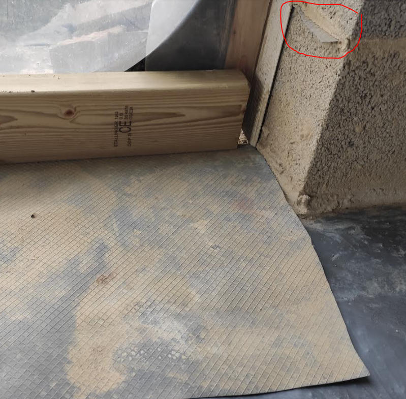

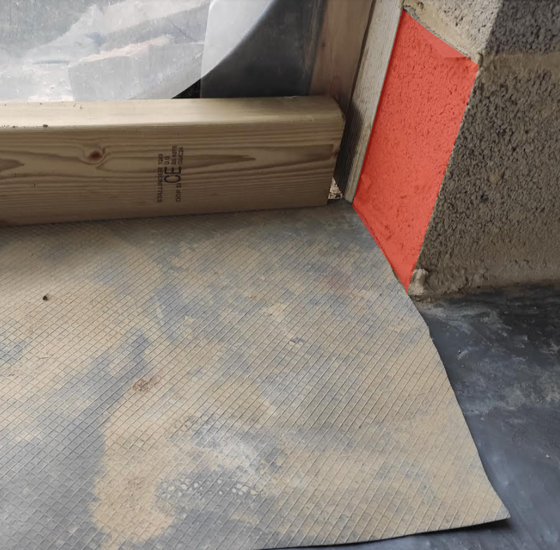

Stud wall construction for sound insulation (and cost)
MortarThePoint replied to dnb's topic in Sound Insulation
That works on the side without the Resilient bar, but what about the side with the bar? Just a whole skin of Plywood or OSB3? Without: With on RB side: -

This is what I have been planning and I think it achieves an STC of around 53. Wasn't overly sure what to do with the coupling to blockwork but 2x2 should be strong with the anchors. Notice only 50mm of Mineral Wool insulation. This looks similar to some I have seen, but would welcome opinions on that. -
