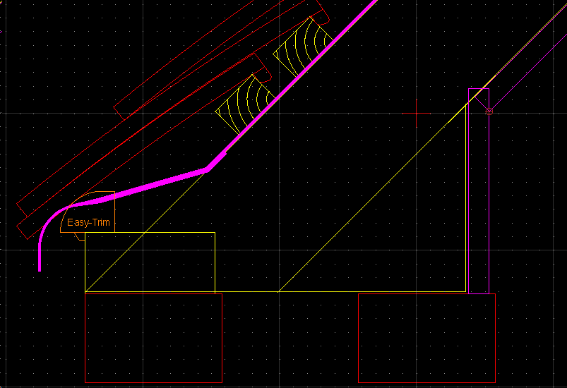

I have 222mm rafters and need to leave an approx. 50mm air gap so was planning to use 175mm of insulation between the rafters and 75mm under the rafters (all Mineral wool). Here are some example build ups: 75+100+75mm Rafter Roll 32, R=7.81 cost £35.75/m2 90+90mm FrameTherm 32 and 75mm Rockwool 38, R=5.63+1.97=7.6 cost £21.09/m2 [NB: RockWool not Formaldehyde free] 180+70mm Rockwool Flexi 35/38, R=5.14+1.84=6.98 cost £12.23/m2 [NB: RockWool not Formaldehyde free] 90+90+90mm OmniFit Slab 35, R=7.71 cost £12.15/m2 90+90mm OmniFit Slab 35 and 75mm DriTherm 32, R=5.14+2.34=7.48 cost ~£14/m2 90+90mm OmniFit Slab 35 and 60mm PavaTherm 38, R=5.14+1.58=6.72 cost ~£16.50/m2 90+90mm OmniFit Slab 35 and 50mm EcoTherm PIR 22, R=5.14+2.27=7.41 cost ~£14.60/m2 120+50mm EcoTherm PIR 22, R=7.73 cost ~£22/m2 If I were to do it again I would 100% use counter battens outside the roofing membrane and fill the rafters. Improving a U=1.3 area by 0.1 saves approximately 3p/m2/yr with an air source heat pump. [dT=13C, U=0.13, 6mo-->7.4kWh/m2, E=£0.05/kWh --> £0.37p.a./m2] -

I'll leave space for a piece of plasterboard and plaster at the top of the brickwork of the inner leaf. One reason to not put the outer rafter in the cavity is to allow a second timber for the angled plasterboard to mount to. Crazy, but I may end up with three rafters as I am keen for the Brickies to have a line to follow with their outer leaf brickwork.
