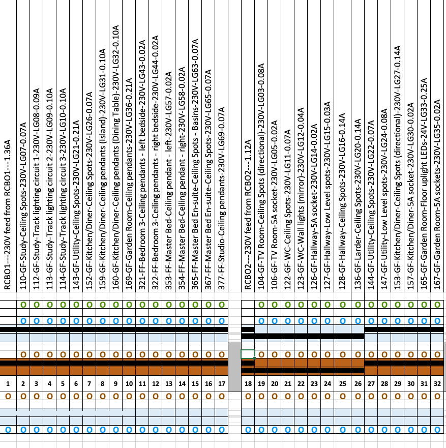

  1. I have a magic spreadsheet that calculates all that for me. πŸ˜‰ each RCBO for mains lighting is max 2A. the RCBO for UFH and towel radiators in the bathrooms has max 5A the RCBO for the external blinds has max 7A I'm using 1.5mm tri-rated. I'm sure that's fine for those max currents but will double check with the electrician. things get more complicated when I need to work out the total current for the 24V circuits as they're all coming from the PSUB. those 24V circuits are currently showing as 42A max if all were on full power. the total of the PSUB is 40A so I should be within that as there's no way all those 24V lights will be on all the time and I will be restricting the power on a number of the circuits anyway. looking at the PSUB data sheet I see this: so that to me sounds like a peak current of 7A but I need to work on 15A inrush current. so, a 16A RCBO for that one and, most likely, a 2.5mm cable but, again, will check with the electrician as (I'm sure you're aware!) my electrical knowledge is...............errr..............limited. πŸ˜‰

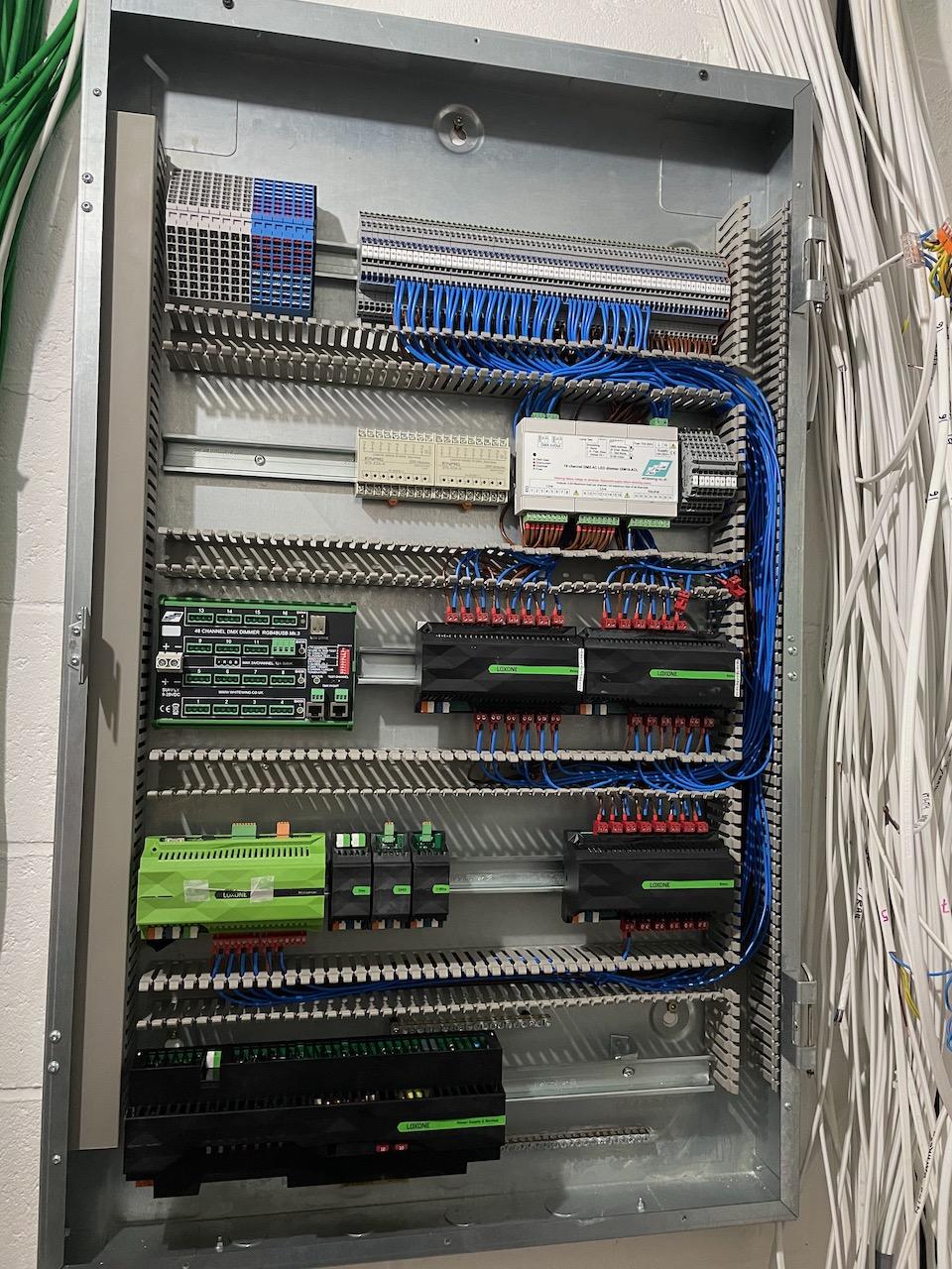

  3. i forgot such a thing existed! πŸ€¦β€β™‚οΈ don't suppose you have a photo of this do you? although, i probably haven't got space for that as i have nearly 50 relays. lovely. thanks.
  4. ok. that makes sense. only issue i can think of is that i'd have to fit 2 x bootlace ferrules into the Loxone relay ports as it loops through the extension. on the plus side it would dramatically reduce the number of cables i need to feed to the terminal blocks from the relays!
  5. it's very possible but it's no problem at all! these things happen on a journey of discovery and mistakes will be made but as long as we learn from them then it's all good. so, let's look at a solution for my current predicament by working backwards. i want the RCBOs to be in the cabinet. i want a single cable from the CU to an isolator/MCB in the Loxone cabinet that feeds RCBOs that feed lighting circuits and the Power supply and Backup for 24V. can i do that with the Wago connectors i already have? if so how? i would rather not have to buy 70 odd new 3-way terminal blocks as that is quite expensive but if that's the only solution then so be it.

  8. have I simply run way too many blue cables? could I just jumper the neutrals on the lower side of the terminal block and run a single blue cable back to the RCBO? if so that would leave a lot more room in the cabinet as the number of blue cables would be drastically reduced! no, hang on. that can't be right as I have to take 2 cables from the Loxone relay outputs. so both of those have to go to the terminal blocks.
  9. hey. so I could very easily have ****** up here! it is me after all. 🀣 here's a screenshot of my spreadsheet showing some of my din rain connections what isn't yet installed in the cabinet are the isolator and the RCBOs that will feed the terminal blocks. the isolator will be fed from the CU and will then feed the RCBOs. these will go on the bottom rail next to the Loxone power supply and backup. it was my (mis)-understanding that the live and neutral from an RCBO would go to a terminal block, e.g. terminal block number 1 above which will then be 'jumpered' across all the way to terminal block 17. and then on the top side of the terminal blocks 2 - 17 the actual T&E cable from each lighting circuit is terminated with the live at the top corresponding to the live, neutral and earth on the bottom which connects to the din rail. the reason I ran blue cable from the relays is they enter the second level of the terminal block which is where the neutral wire of the T&E will terminate. is that not correct?
  10. the electrician is coming round tomorrow so I wanted to get my Loxone cabinet on the wall so he can run the feed from the CU. it's not fully wired yet but I've done all the mains voltage lighting so I can make a start on configuring Loxone to get some of the lights working, then I can work on the 24V lights after that. one step at a time!
