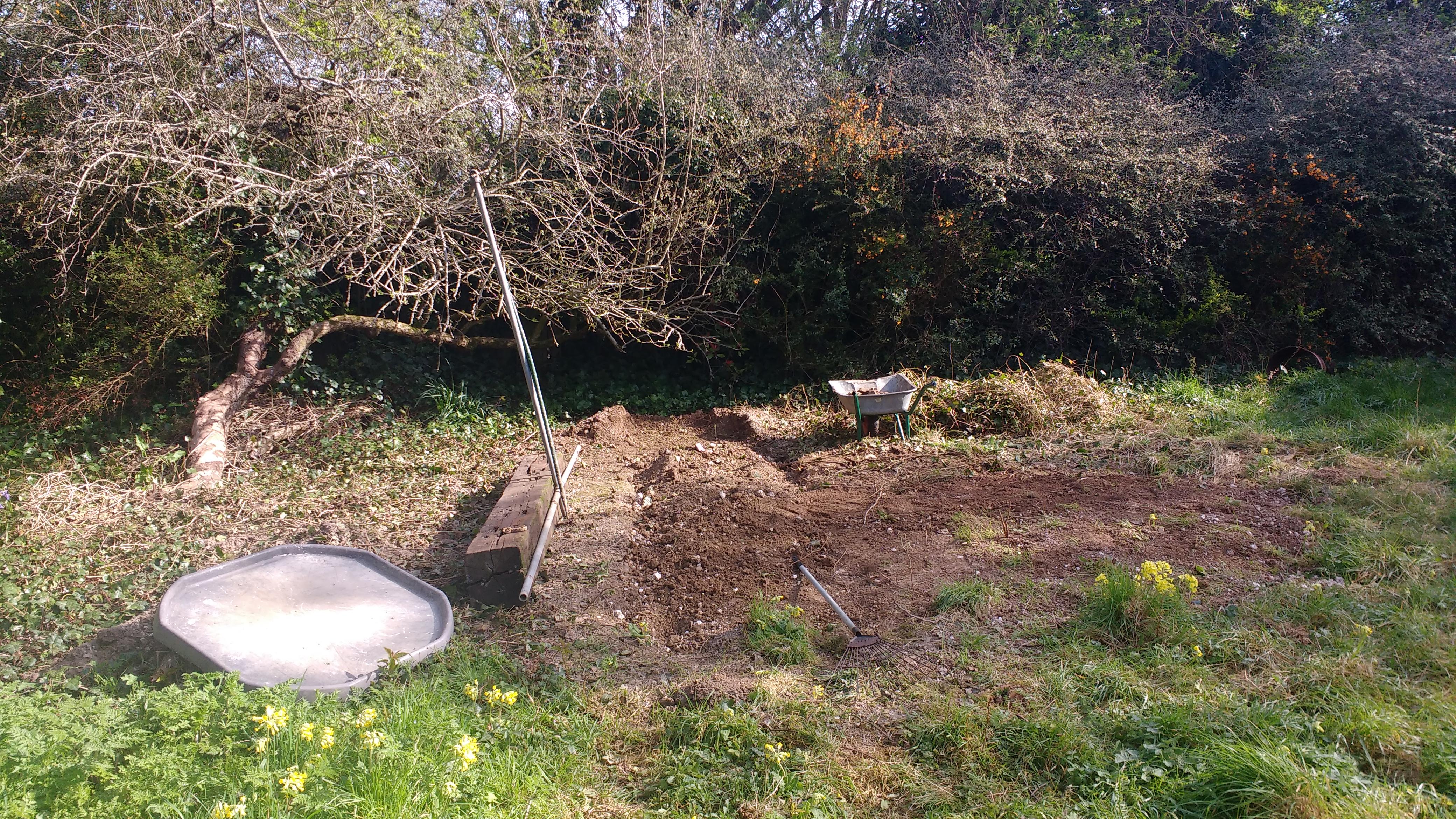

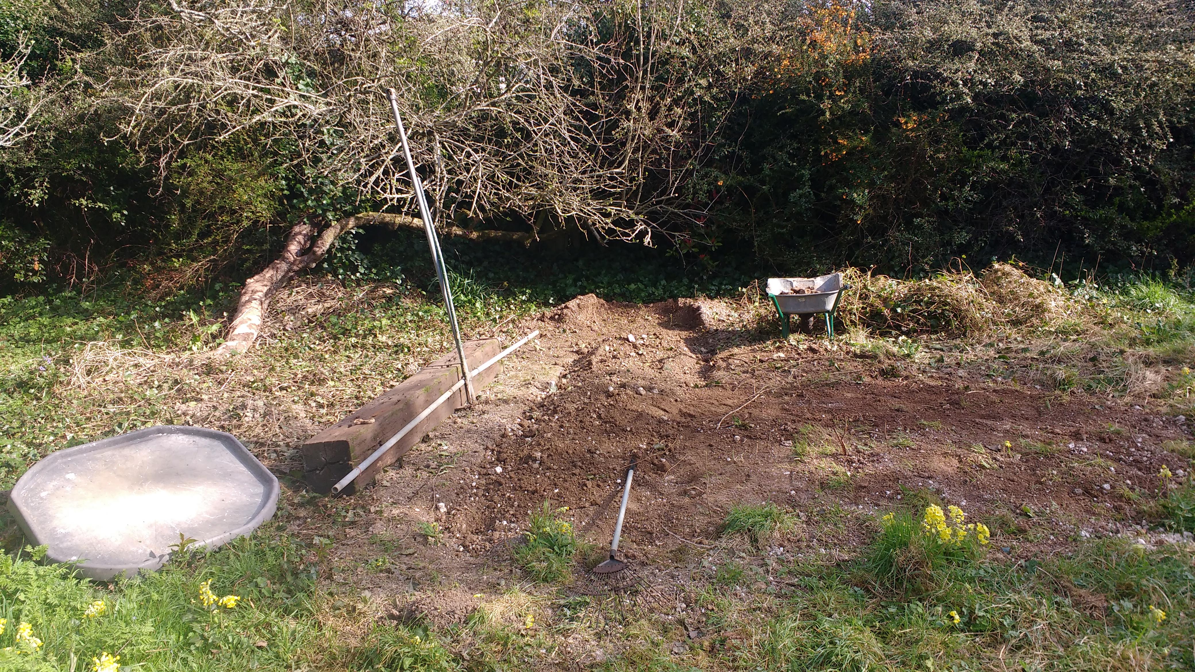

Trench dug through the ivy covered top layer with 3' wide bucket. Down to the clay. Not quite 2' deep, 18" maybe and the length of the frame. Bunged all the hedge and branch trimmings in and set fire to it. Nice bit of wood ash! -
