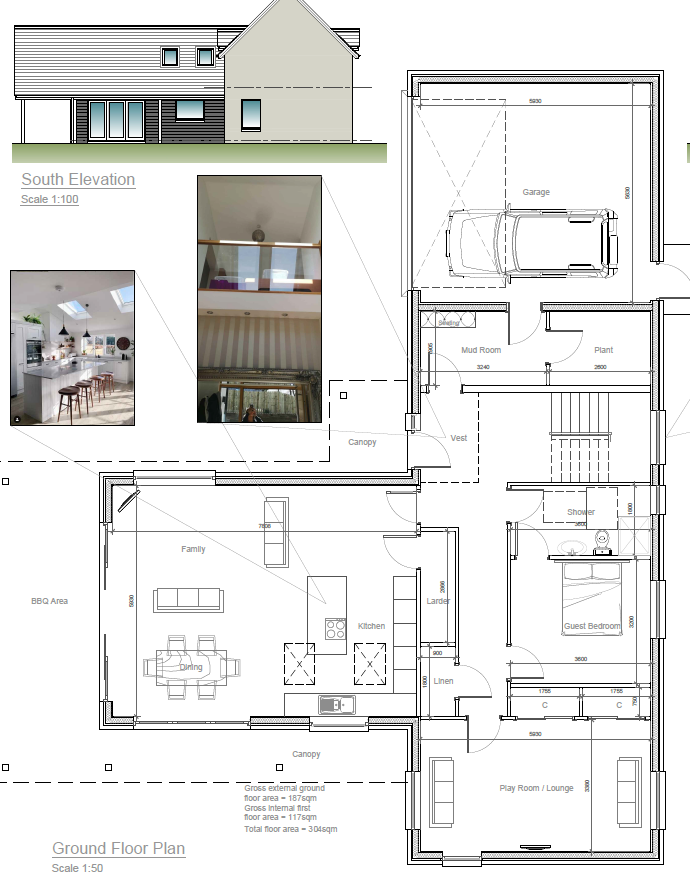

Not sure if this is the right section, but house construction didn't seem to cover it. so please move to appropriate place if required mods, thanks. After numerous iterations we have nearly finalised on our layout. (See below). It made sense for us to move the master bedroom above the garage to aid the flow of the house and we really like the layout. I had however previously avoided this because I assumed we would have issues with being inside the thermal envelope and air tightness and so forth. It will be a timber frame or SIPS build and I am hoping to achieve high levels of air tightness, is there anything I should be looking at or concerned about with our master being above the garage and obviously the garage will be outside the thermal envelope and not very air tight at all. Will the floor construction need particular attention? . any other thoughts.

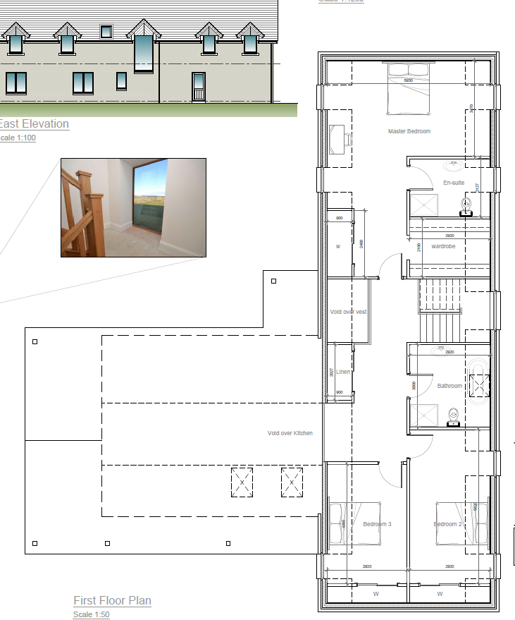

All, I thought I would give an update to help any others in the future, we have now updated the design and here's where we are currently (see below). We have peace with the open plan area and now made it fully vaulted inside and moved the master bedroom, which has helped with the overall flow and proportions. There is still some tweaking of the larder length and door into that area, the void area/ balustrade overlooking open plan area will be removed. I'm also doing a bit of a cost vs benefit on the dormers. But getting there! In great news though...the huge BBQ canopy stays.. as obviously now it doesn't affect the view from bedroom and also will help with solar gain. Thanks to @AliG @Ferdinand @ProDave @Temp @AnonymousBosch @Roz for the input. -
We are now homing in on our final design. We have pushed the roof up so it is 1-3/4 storey and have a number of dormers (8-in total!) see below. The house is about 50m^2 bigger than I had hoped (which i underestimated, and now want this size) hence I am in a bid now to simplify construction where possible but retain the size ( not because i want it to be big, but because it is the right size). The dromers look not bad, and I like the idea, but i know they add significant complexity and hence cost. Would it be better if these were simplified to Velux style that cross the wall/roof threshold? (picture below) is it a cheaper option?

@Temp good idea with the walking behind I might check it out and the key info on furniture size. @AliG fantastic input and it's been the main point I've been trying to get away from walking through areas, in my head I wanmted to retain exactly what you were saying on walking into the room and seeing the whole view unobscured. I will have two sets of bi-folds/sliding doors and a big picture windows so I want all that outside view to come in. I'd also planned to move the larder up and was heading that direction with units. We actually are hoping not to have doors leading in there, just a wide opening (I haven't checked building regulations yet...)as I felt that immediately linked the vestibule to this open area and made it feel bigger. Great shouts on the couches too, thanks for the input it is very helpful. @AnonymousBosch @Roz once we finalise layout we will get it in 3D to check it all. I'm ok with it as I spend all day reading/ doing 3D and 2D drawings. thanks for the tips. @Ferdinand The L shape is a good idea and I did see a nice layout which may work too, defo like the idea. The future input is good too as maybe in 50 years I'll be living in that guest room. Although In my head ultimately one of the kids would get this house and we would build another on the site all on the level for us. Really great input everyone and has helped significantly to get some further input, I'll try a few layouts later in autocad. much appreciated as always. -

@ProDave thanks for the feedback. I had considered moving the stairs. But it would kind of mess with the double height area right above you as you walk in. The guest bedroom is a complete PITA, I want one so people will visit and stay but it's not big enough upstairs to accomodate it. It's only just next to the living room they are currently separated by cupboards? (Assuming you're saying the snug is the play room/living room. Did actually like the windows at the end but might make it bigger so you see right down the hall from.the entrance to outside. Was planning a big TV in there. -
We have the architect coming for a meeting on friday, he has done some initial designs and we are just going through iterations but currently facing a conundrum we are finding it hard to resolve. See layout below, we have a very large open plot and hence can position our house anywhere, layout also included below of house position on plot. We are ticking most boxes but we are struggling with our open plan area. The brief being - nice big open plan area, but when we are sitting in the living room area of the open plan area - we don't want to feel like we are in the kitchen. The First revision looks like below, which was not bad - but we want to modify it as I want the island located right next to a set of bi folds so I can float in and out while bbq'ing without feeling like I'm walking through the living room. I had completed this - see second and third layout, but still struggling a little getting it to feel right. We are trying to add a partition to mount a tv and split the room up slightly and zone the areas, as we feel this is what we need, but everywhere I put it seems like a hindrance. I can't make it bigger again as the house has already went from 200-260 m^2 (eek!) So I'm not really sure what I'm asking, possibly real world experiences of a completed build compared to when you were doing the design?. Will it still feel cosy if I don't zone the room up and we are worrying too much about it not feeling cosy and it'll be fine! any other advice? Other thing I should add is that the shape needs to stay as this annex gets sun all day in winter and summer and works really well for our view, its just a difficulty dividing it up. Hopefully once this is done I can get the full design up in a week or two and show you all. Also FYI, it's a standard height room so not double height or anything. Layout 2: Ignore weird line between the island and wall its a dimension between the island and the wall units (which stop just at larder door) Layout 3: Site layout: orientated to north, so annex points to SW (or SWW if you're really looking hard!) Overall design: Still some changes to be made, but pretty pleased with the architects work against my design brief so far.
