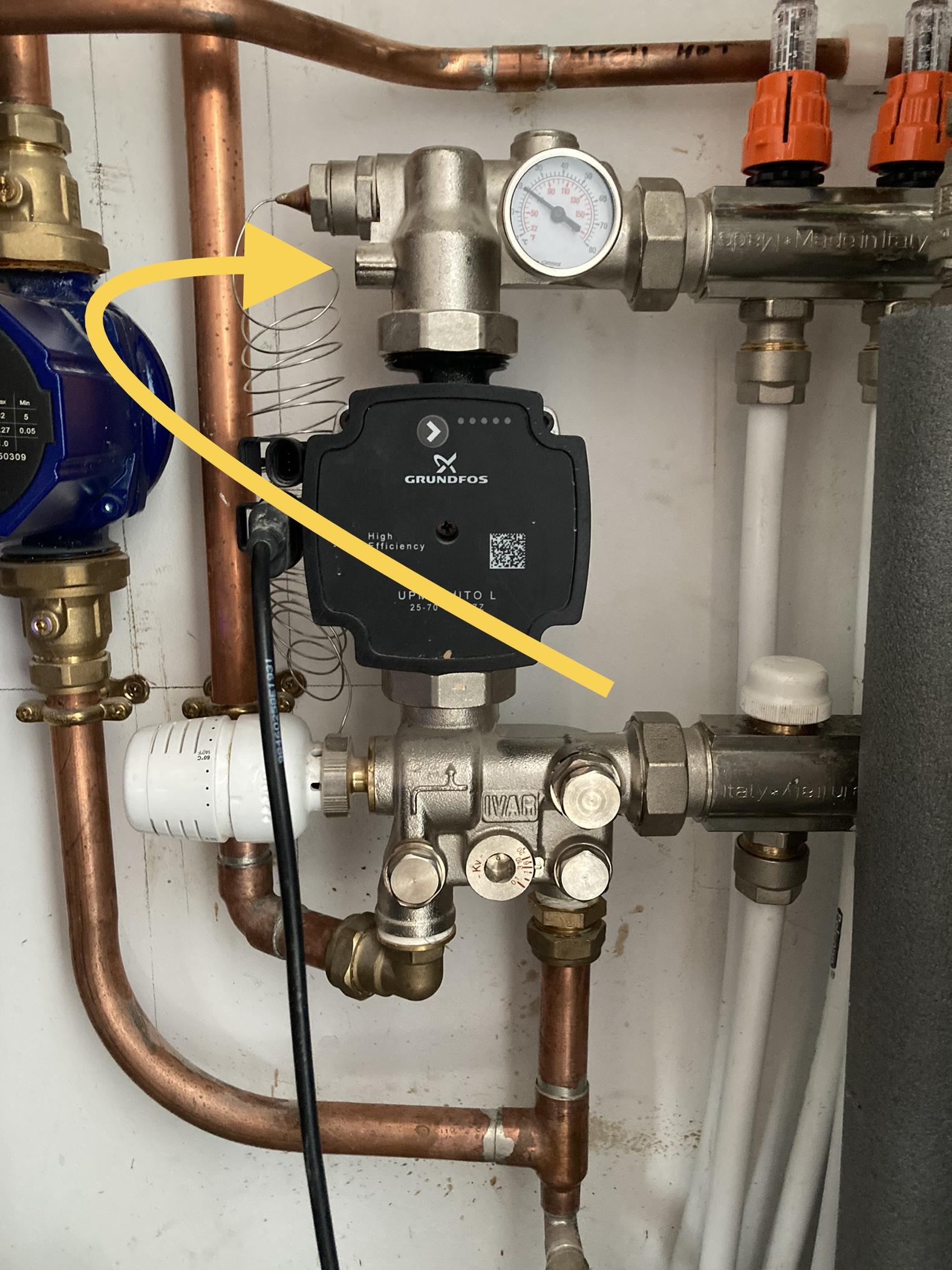

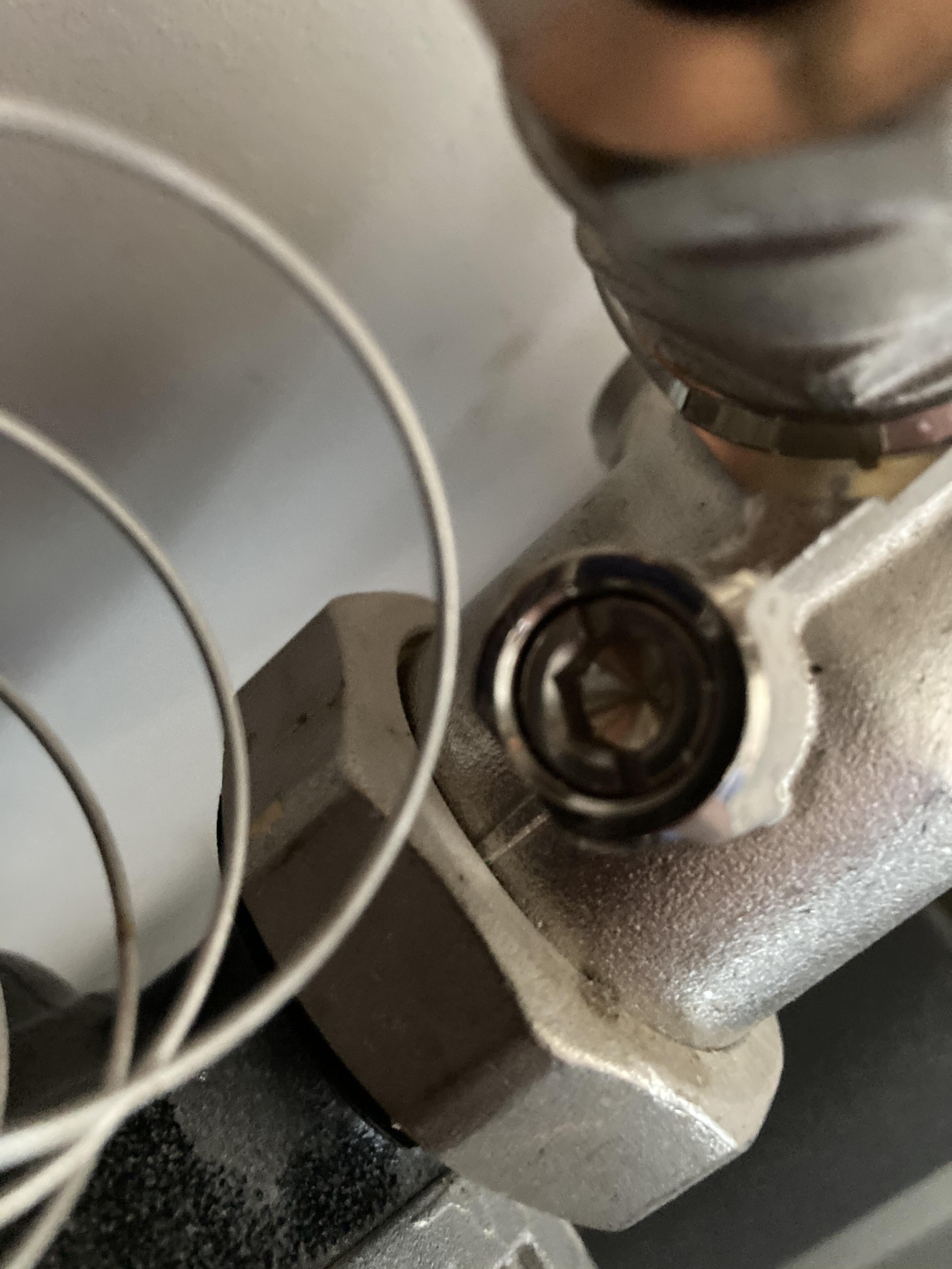

@dpmiller thanks again for posting the link to that Iver thread. @andy top, top tip. My quarter turn isolation valve was closed. Its now open and the flow rates are epic! In the words of the plumber that installed ours... "...Not checking pump / gate valves are open is 1st year apprentice error. I’ve not had one yet which has caused any issues." Feel free to put ours down as No1 if you wish. ?

@dpmiller thanks for that link, I didn't't see that post when I was searching. I'll check... @ProDave The problem is, I can't achieve any flow rate of any significance.

i don’t have those design flows or any idea how to calculate them. Is there a rule of thumb? A short distance above the blue Salus pump are the twin Willis heaters. The blue pump is the return from the manifolds into the bottom of the Willis heaters. The black Grundfos pump is between the supply and return manifolds of the UFH as you can probably see from the picture. No, and I’ve put the Salus pump back into ‘Auto’ as the ‘HD2’ setting made not a jot of difference. Any idea why it’s doesn’t seem to be handling it in my setup? My two shorter runs which by my (probably incorrect) calculation require 0.75l/min are set to about that. The other 9 loops which require 1.75l/min and more are fully open and barely registering 0.5l/min.

With all 11 loops open my flow rates are way below 1 litres/min and I'm trying to get 2.25 to 2.5 litres/min on 5 of the loops. Is it that our pump isn't up to the job or has the pump not been set up correctly? Or is there something else going on?

The black Grundfos pump is set to ‘Constant Pressure 3’ which is the highest it can be set to. However the displayed 1 green and 2 yellow LED’s in the picture show that it is on ‘medium low performance’. I have no idea how to get it to 1 green and 4 yellow LED’s (high performance) which may be all I need to do?

@Radian thanks for confirming that. Ive got 11 loops. The longest being 98m which requires 2.5l/min flow, the shortest 28m so 0.75i/min. With all the loops open fully I get barely a reading on any of the flow gauges. If I close them all except 1 loop I can get up to 2.5l/min on the only open loop but the rate quickly reduces if I open up another loop. I think the pumps are set up correctly but what is the correct sequence for setting up the flow rates? If it's just 'turn it on and adjust the flow rates' then I'm stuffed. If there's more to it than that what is the correct sequence?

Our Willis heater based UFH doesn't seem to be working as advertised. The problem as far as I can see it is that the flow rates through the various UFH loops are nowhere near high enough and I can't get them any higher. We have a total of 11 loops and as I understand it the flow rate through the various UFH pipe loops should be 0.5 litre/min per 20m pipe, so for example one of our pipe runs is 90m long so it should have a flow rate of 2.25 litres/min. First question, is the above correct?
