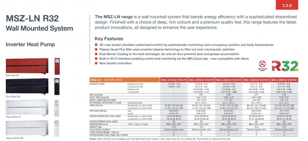

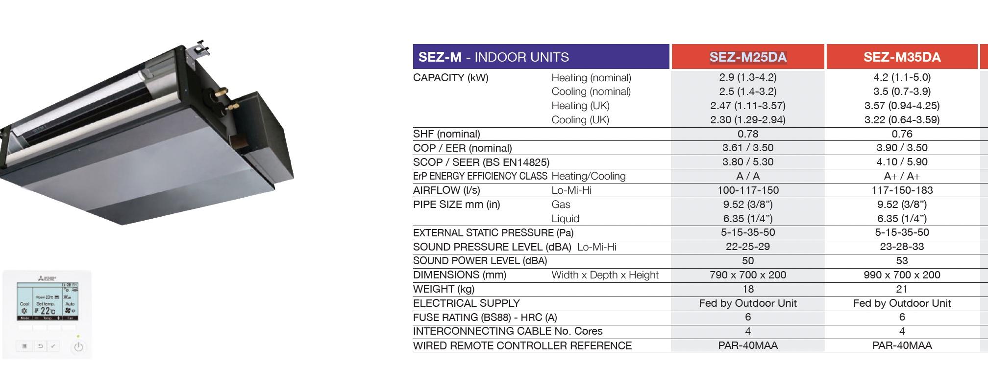

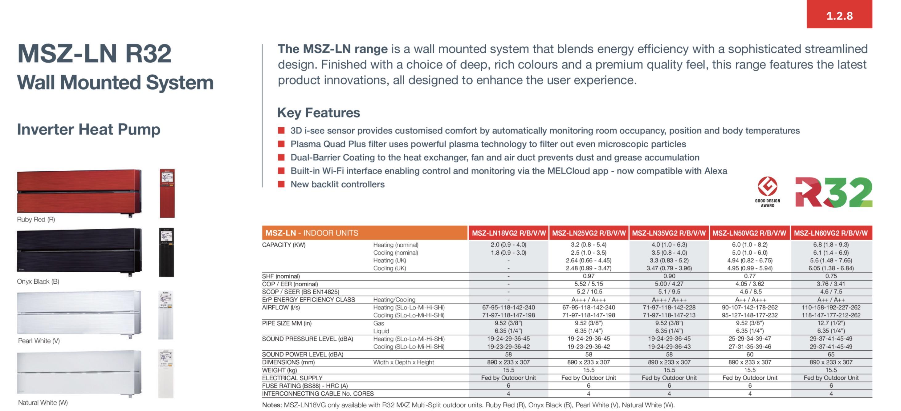

Update - I think I'm starting to figure it out - the ratings are "sometimes" (man this flyer is confusing) based on some random indoor device with a random outdoor device paired. So they just picked different devices for the different indoor units, wildly varying the final rating of two comparable units. Instead i think both efficiency ratings are somewhat close. OK - that makes that choice a lot easier. Or am I mistaken? -
So we're converging on a Mitsubishi Multi-split system probably the 10.2kW device (max 5 indoor devices) - MXZ-5F102VF because it's the most energy efficient, uses R32, and quietest indoor units. The question is about those indoor thing In the one corner, we have the ducted (hidden in ceiling) SEZ-M R32 (page 66) - in particular the 2.5kW SEZ-M25DA, featuring: - Airflow (medium) 117l/s, 25dB - Efficiency: SCOP: 3.80 SEER:5,30 ErP class A In the other, we have the MSZ-LN R32 (page 20) - in particular the 2.5kW MSZ-LN25VG2 - Airflow (medium): 118l/s, 29dB - Efficiency: SCOP: 5.2 SEER: 10.5 ErP class A+++ The 'in ceiling' one of course is a lot harder to install smoothly, but certainly doable. I guess I prefer the in-ceiling for aesthetics but the on-wall are OK too. The crucial part is the efficiency vs the noise. Efficiency: Sigh. How can one be A and the other A+++ ? Aren't they both just a cleverly shaped coolant expansion tube? And why does the selected outdoor unit much more relevant to the efficiency rating at the end of the day? Noise: both are fairly quiet but the ducted one is literally more than twice as quiet still. Eh. To save you some rummaging through the PDF I'll attach the images below.

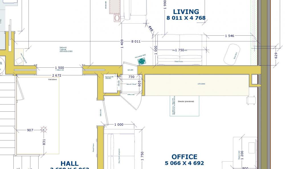

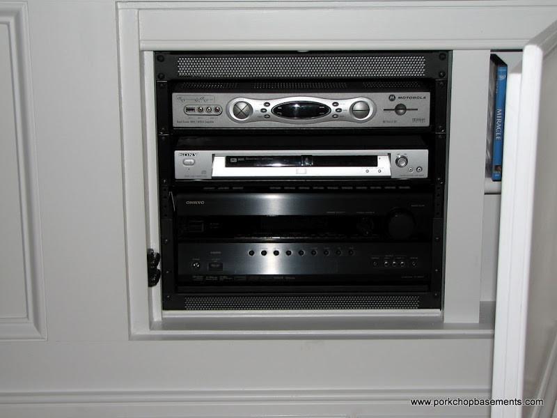

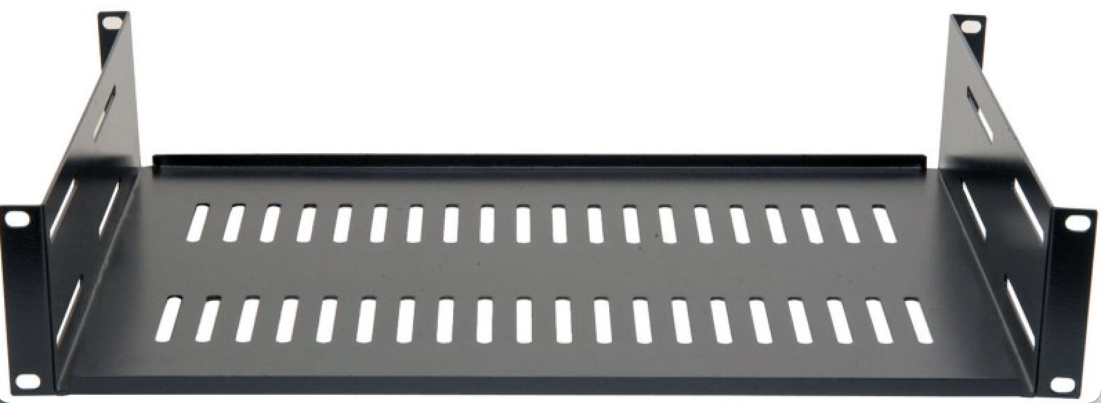

Correct, that's the idea. Well, you know this better than I do - but my understanding is: - that the networking gear will be facing 'ports towards the office, power plug towards the livingroom(a wall). - My PC will probably have to turn into a rackmount - get myself a special case. Will see, it's not an urgent need - Audio gear, main bunch of ports towards office, includes power, controls facing towards the door. And - it will perhaps even be standing on the floor or on simple rack shelves. Something like this: Should work, no?

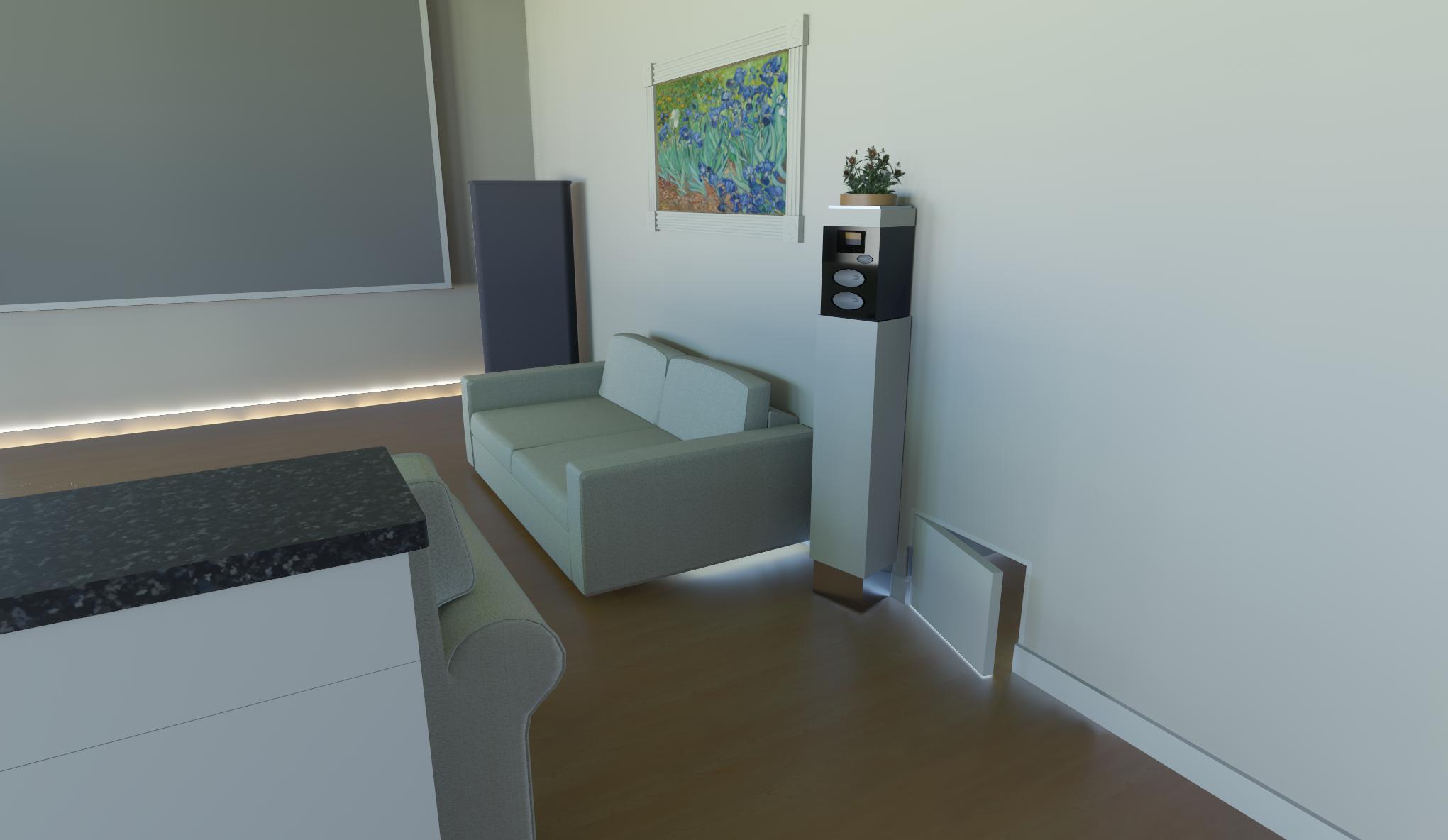

Huh. Not a bad idea, but I'm a bit worried about noise levels. But perhaps a painting with a serious backplate can be designed. Which.. kinda is just a door again I might just do both
Main reason is aesthetics, and Wife Acceptance Factor - having my amplifier and the media streamer hidden away is a good thing normally - so I'd almost want no door at all, but instead reality is that sometimes you want to just be able to punch the power button. So indeed a small door - something like 35x35cm seems great to access at least the main amp and with a bit of squeezing anything else. Second - with my PC in the network rack and my desk+monitor in office I'm normally ok, but I have a VR headset I want to use in the livingroom sometimes. Third - most amps come with room autocorrection - for which you need a wired microphone. Not a dealbreaker to extend the mic somehow I guess but easier this way.. Well, I do have full back access so most things can be easily wired from the office. The front I want as unobtrusive as possible.

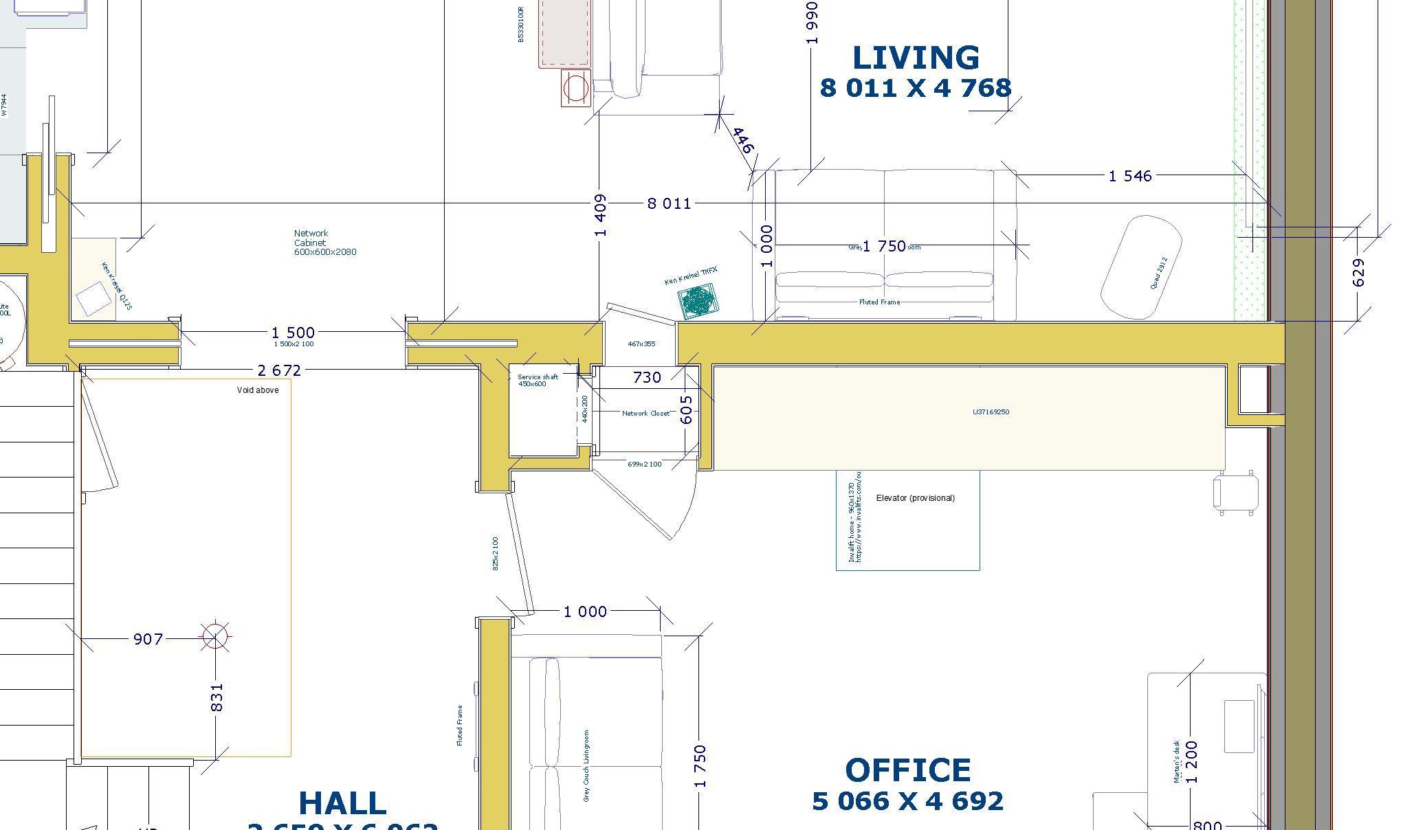

I'm planning a network and audio equipment rack built into my house. And as you can see it has two doors, one into the office, one into the livingroom. But, I want the livingroom door to be 'tiny' and near the floor, as invisible as possible. My program renders it this way But perhaps this picture is somewhat more illustrative: (of course in this picture, this is just some cupboard - I need to 'punch through a wall') How would you do this? Just cut a minimal hole and hope a joiner can insert a door properly? I don't need to service the equipment from this side (of course?), I can just reach into the closet from the back.
