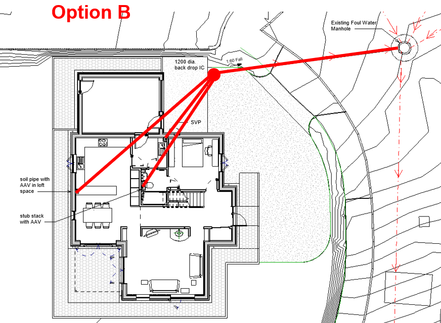

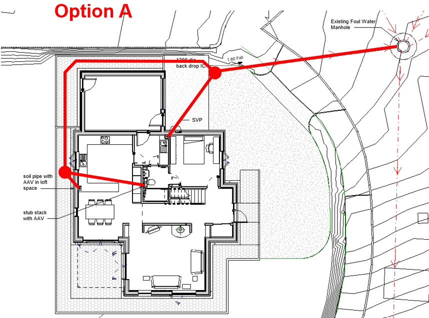

Thanks for the replies. So far we have one vote for option A (with extra chamber) and one vote for option B. Silly question perhaps, but one I can't find the answer to elsewhere: which stack is 'at the end of the run'? The one furthest from the connection into the sewer or the one that's closest to it? I have all the approved documents downloaded but I find Part H difficult to interpret in some places.
@Nickfromwales As a follow on question: do I have to have one of the stacks vented to outside or can they all have AAVs? If possible I would prefer to avoid another penetration of the thermal envelope. I find the wording of the building regs a bit confusing.

I would appreciate a bit of advice on drainage. I will have 3 stacks: 1 from first floor ensuite and down to pick up kitchen, 1 from downstair ensuite, and 1 from first floor bathroom and down to pick up utlity. Is it better to have as short a route as possible to outside the slab, then route them around the house to connect into the sewer, or shorter route 'as the crow flies' direct to a sewer? Both options via an inspection chamber to final connection to sewer. Option A or Option B? ...or something else completely?
