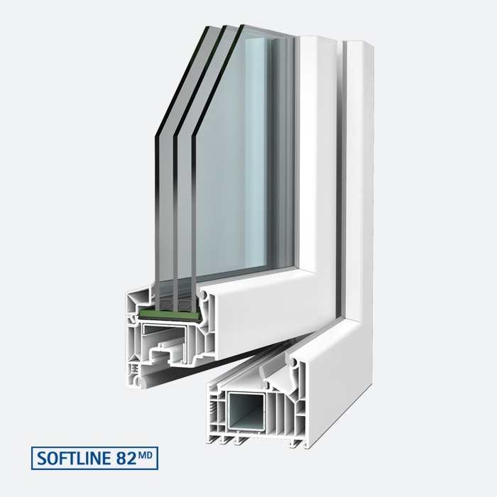

@Nickfromwales thanks, that's good to hear. @Adrock So these are marketed as Passivhaus standard. I have a quote from Precision (who are based near Glasgow but supplying to Wales) for Veka's Matrix FS70 triple glazed system, but I'll probably go for the more modern bevelled profile of the Halo System 10 or the Softline Passivhaus.
I'm considering Veka which appear to have three seals on their flush profile. I'd be interested to hear what the forum thinks of this brand.

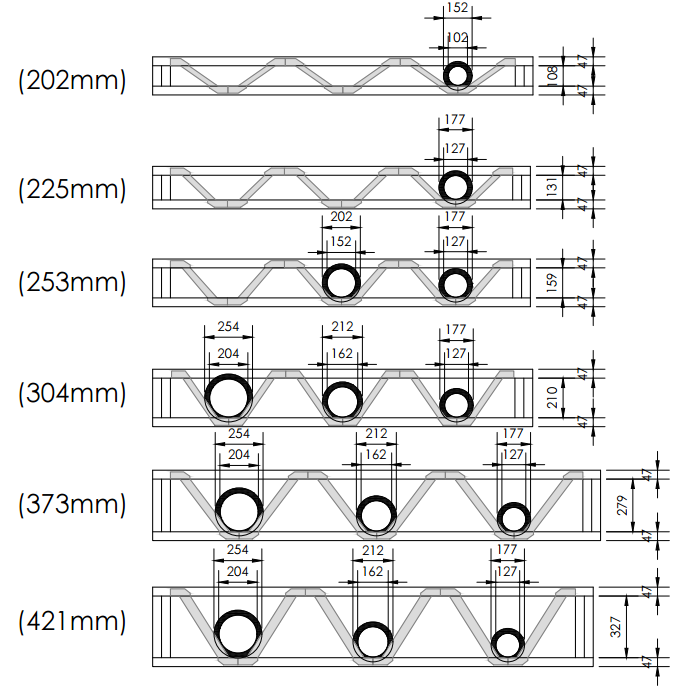

@flanagaj I used this online calculator to size psijoists roughly before getting the TF engineer to specify exactly: https://www.mitek.co.uk/span-calculator/span-calculator-uk/ If you are having MVHR then Total Homes specify an absolute minimum open web joist of 254mm to get 150 dia. rigid ducts through.

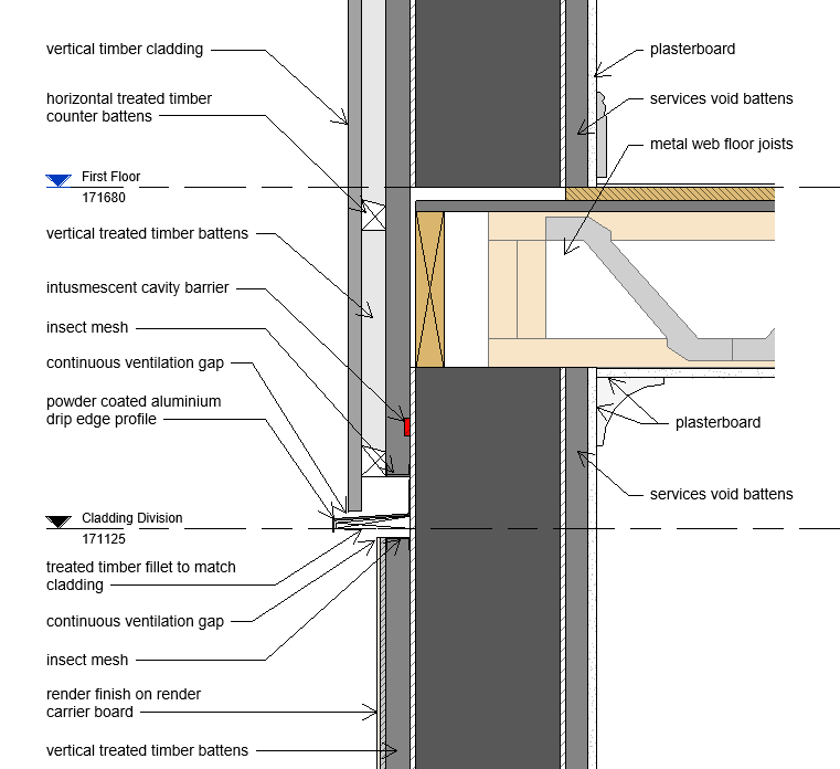

Don't know if this helps, but I'm currently considering this work-in-progress detail for vertical timber above and render on carrier board below. My understanding is that vertical timber cladding needs to be fixed to horizontal counter battens which are in turn fixed to vertical battens, whereas horizontal timber (or in my case render board) just needs to fix to vertical battens to maintain a continuous ventilation/drainage cavity. I've added a drip profile to help define the transition and throw water from the upper cladding off the cladding below.
