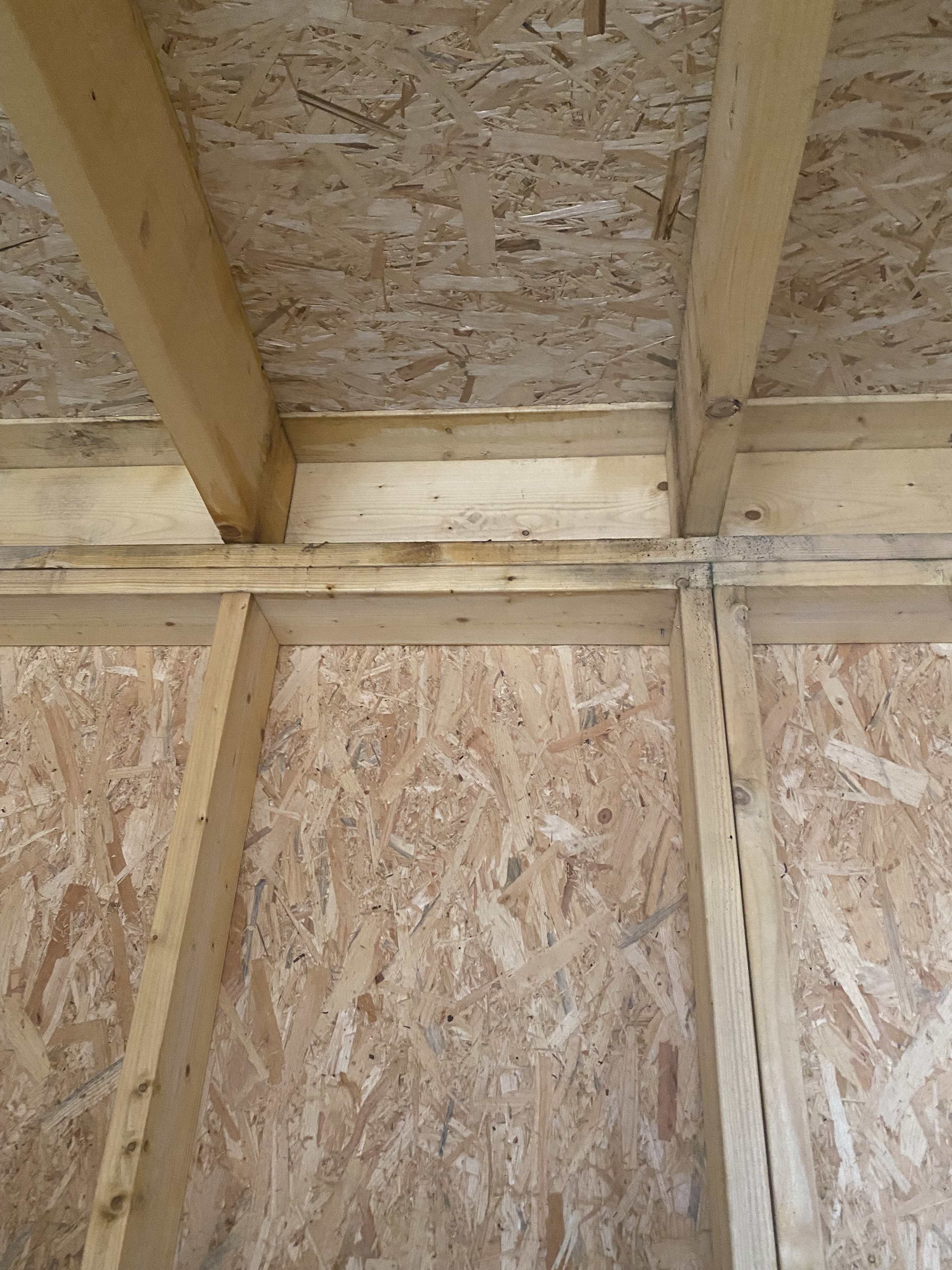

  3. Doing it for sound reduction in walls, heat insulation in the ceiling between ground and first floor. Internal new stud walls in a new build timber frame which has factory fitted PIR with an additional 50mm PIR which we fitted to all exterior walls, followed by membrane and battens. We can’t board one side first because we are doing rockwool ourselves and it has to be done first because of our timings.
  4. We’re getting a plasterer to board out the internal walls while we get on with other jobs. After some advice please on what’s the best way of fitting it within a stud wall so that it’s still in place when the plasterer comes to board out? Any top tips?
  5. We’re getting a plasterer to board out the internal walls while we get on with other jobs. After some advice please on what’s the best way of fitting it within a stud wall so that it’s still in place when the plasterer comes to board out? Any top tips?

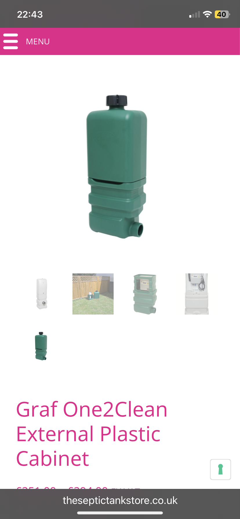

  9. This thing has been put in just 2m from the sewage treatment plant. It’s at the back of the garden ;about 10m from the patio) but is bright green and very visible. How have other people hidden theirs?

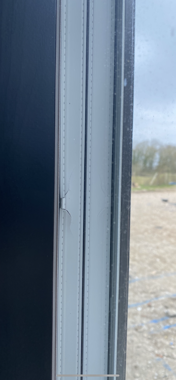

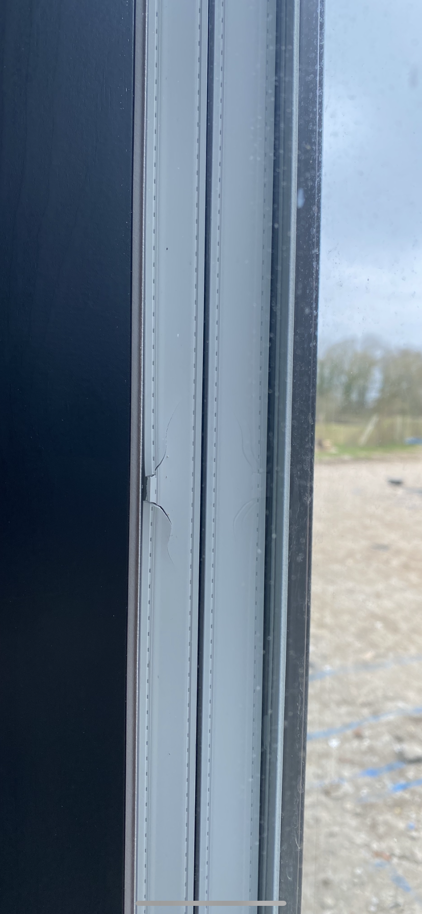

  18. @Nick A were any if your issues related to the internal pane edges? One of ours has failed just 4 months in, but we don’t know the cause. Two other Rationel aluclad windows have leaked around the seals since installation. Another issue has been the paint on the interior (wood) which has been badly affected by low tack tape. When I called Rationel to ask how to protect them they said they can’t advise on this.
  19. My ground worker reckons connected but not commissioned is fine for a few months if the tank is big enough and the house is under occupied - in our case 6-9 person STP for max 3 people to start with. It’s an interesting concept…
