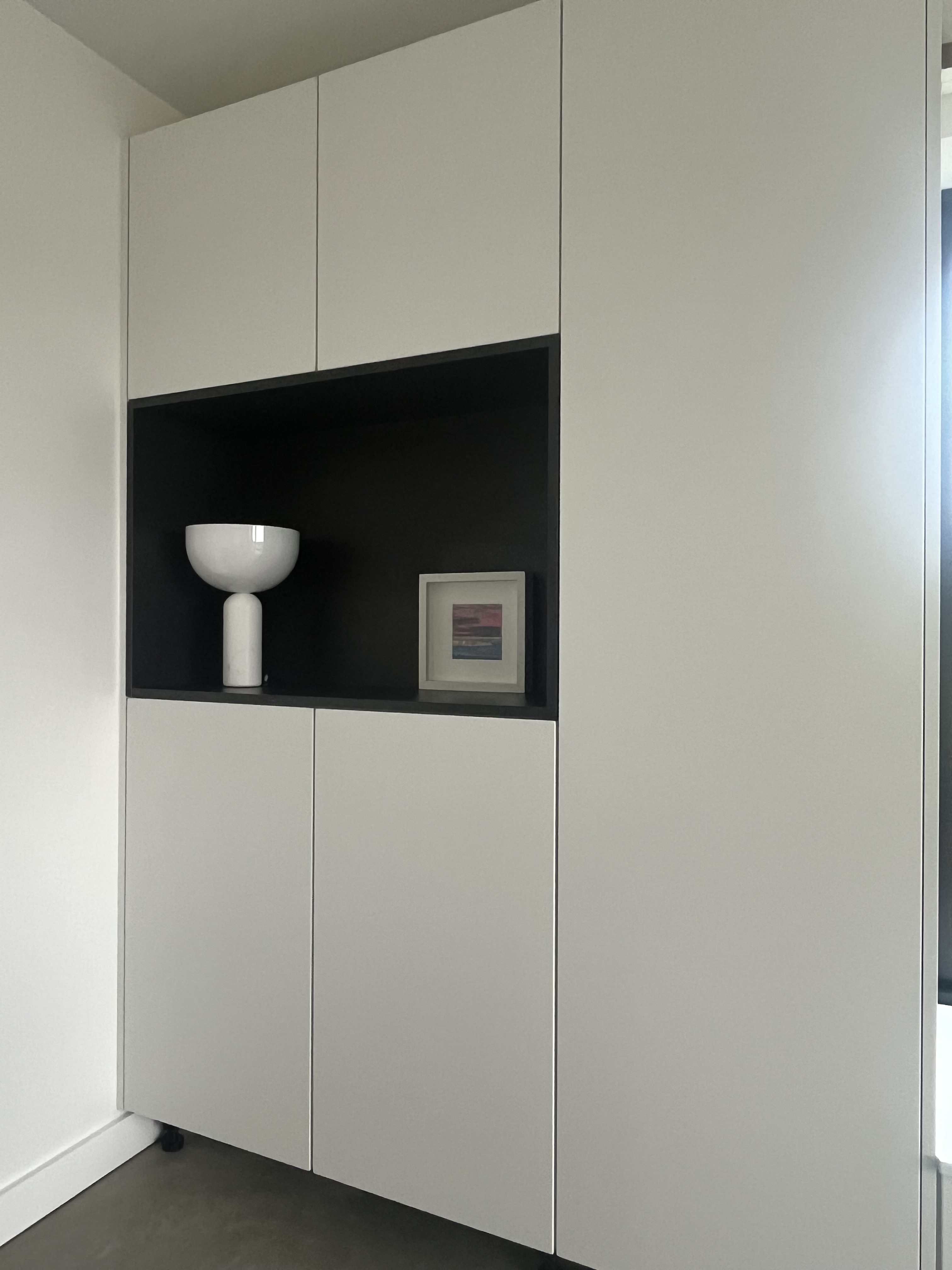

we are using a mix of Ikea where we need standard size white cupboards and Lark&Larks because the carcasses can be the same colour as the doors, so gives a nice finished look. Also they come built so big time saving, and can be custom sized and have matched coloured end panels for an in-line look. Not yet onto fitting wardrobes but pretty pleased with dining room although not quite finished.

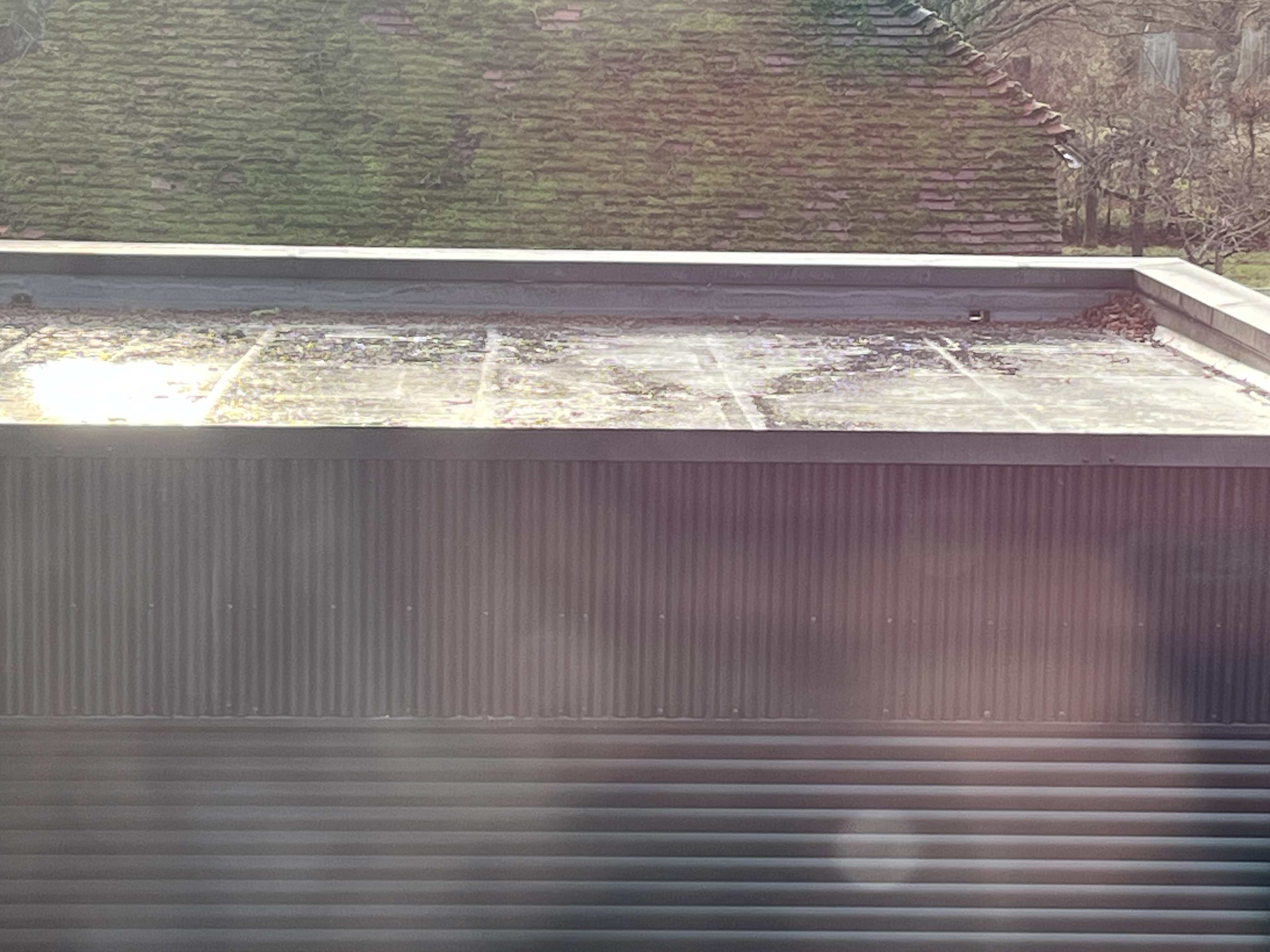

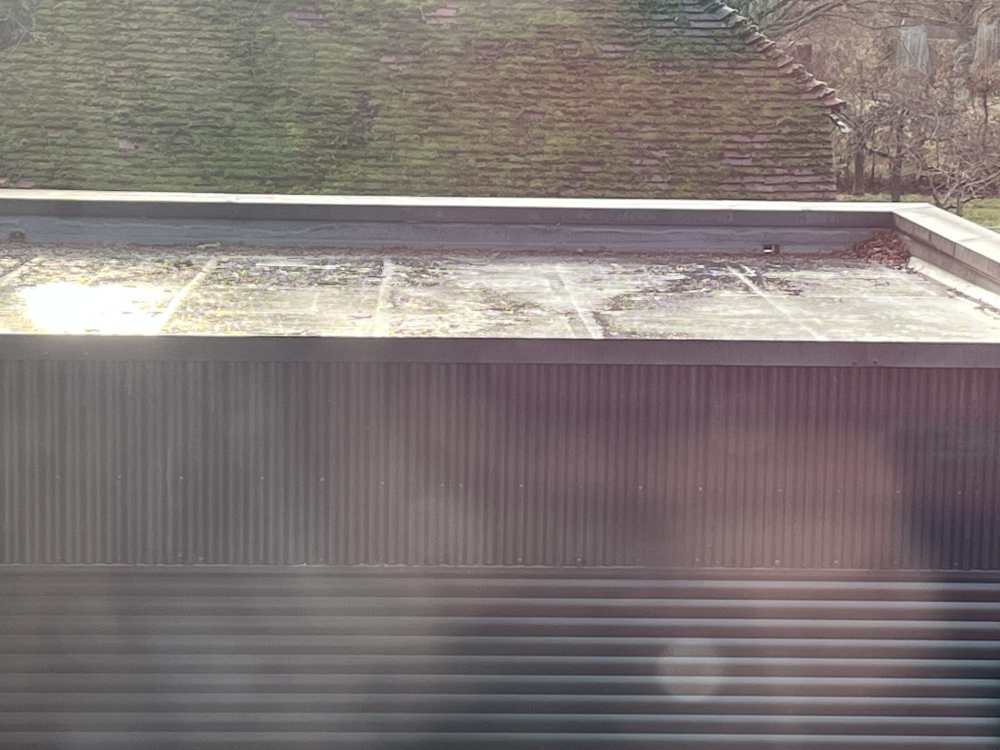

The leak is on the left hand side of this picture. I’ll go up and take some close up photos this week. The ‘pond’ is under an oak tree so we’re up each week to clear the leaves at the moment. The water was 1-2cm deep, so not coming up the sides. Hadn't considered the parapet panels but will have a good look there too, thanks.
Our fibreglass roof is leaking on the garage. In the morning light you can clearly see the joints and if we walk on it it makes a crinkly cracking noise. Getting the team back this week but they won’t be able to fix it in this weather. Does anyone have similar? Can you see the joints in yours? One opinion is they skimped on resin… would welcome others thoughts
