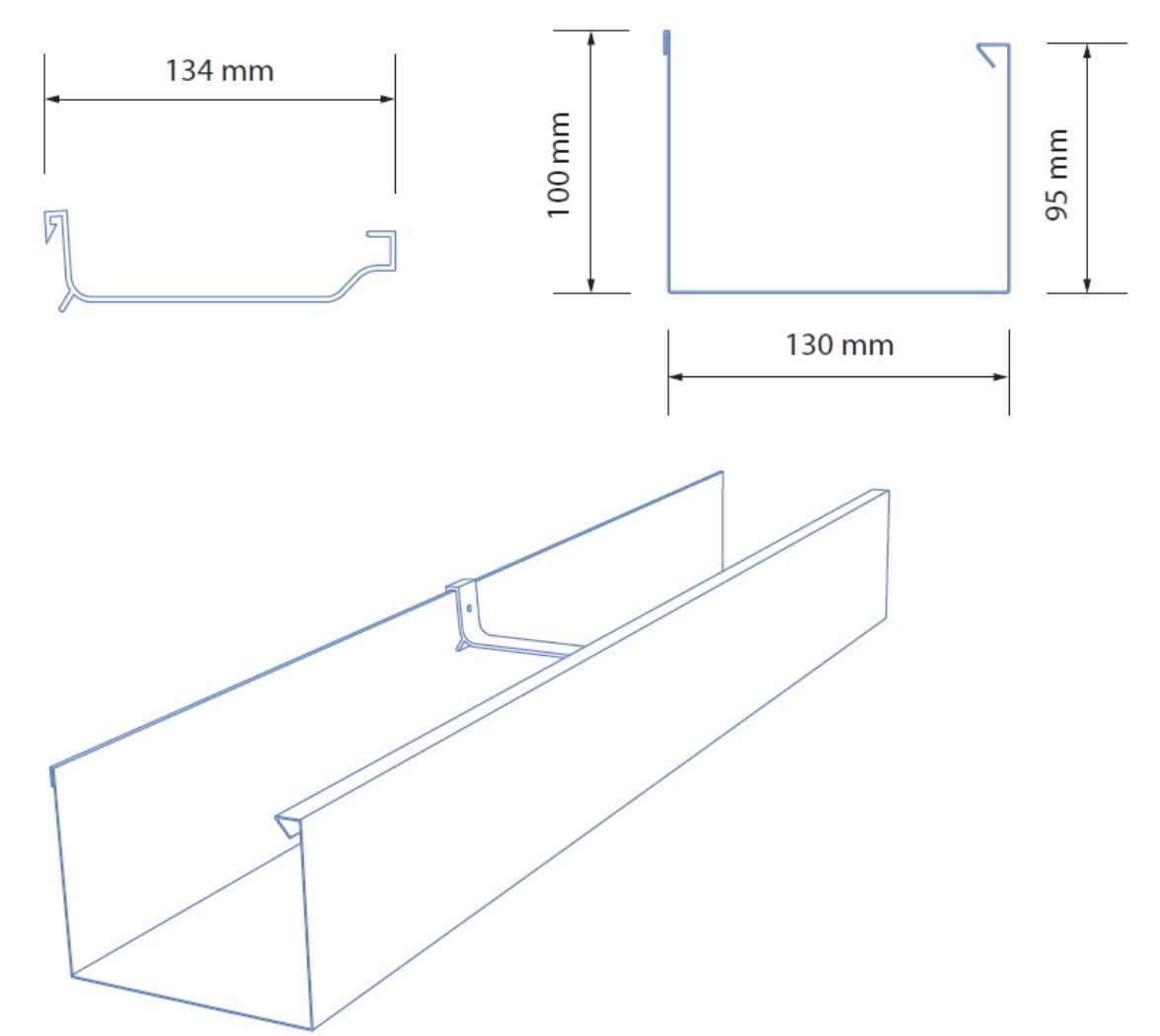

FYI, this is the gutter that Tata supply with their Catnic roof. I can’t make out from your drawing what is cladding, cavity etc. But my understanding is that they want to fix the gutter to the outside face of the cladding (or equivalent timber). I was told by our steel roof installers to bring the top deck of OSB3 out to the same projection as the external face of the cladding. They then make the overhang and drip edge with their metal eaves trim, and the gutter is fixed through the outside face of the cladding to the timber.
