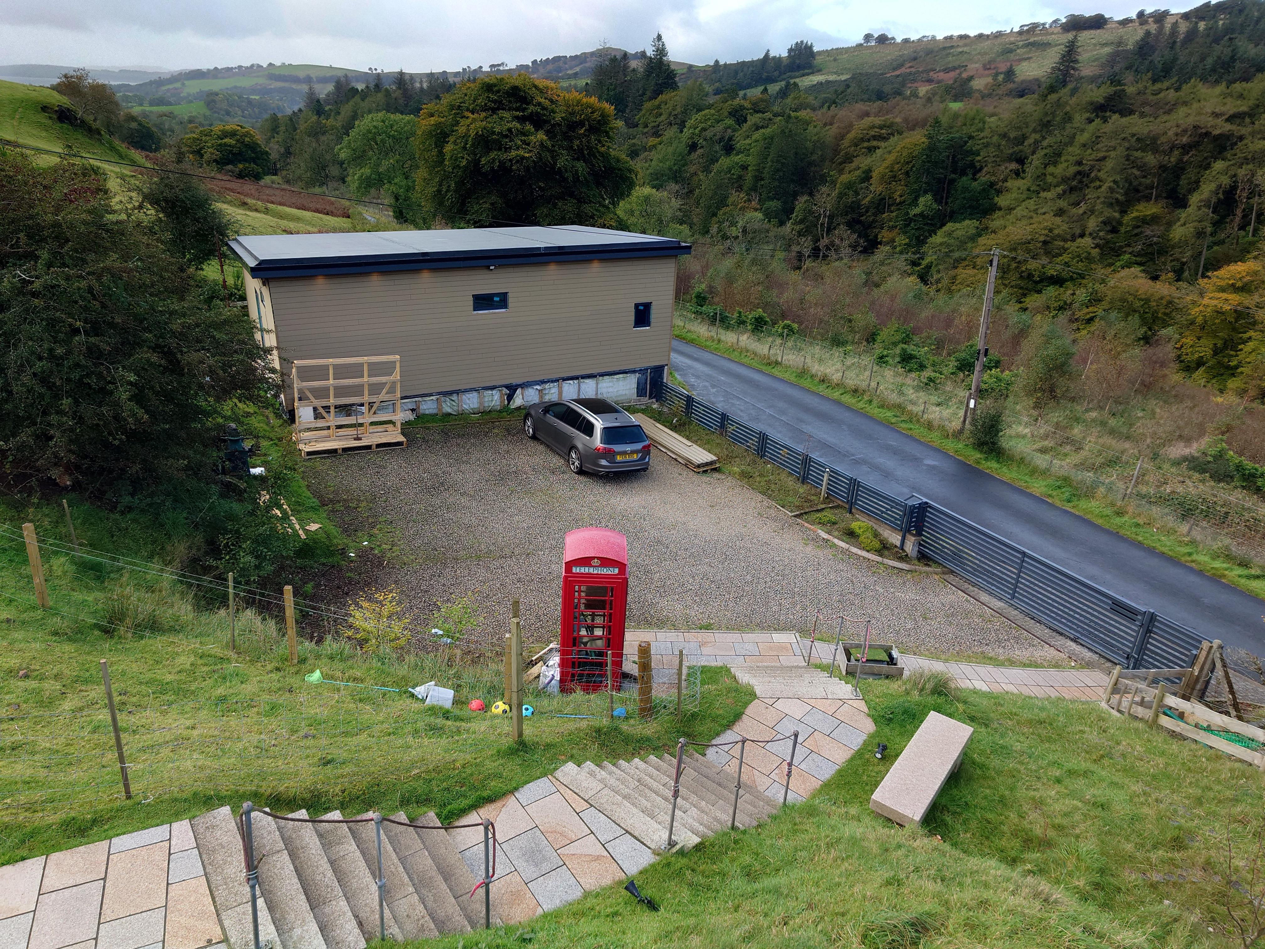

Holiday let house in top of garage - idea
jamiehamy replied to jamiehamy's topic in General Self Build & DIY Discussion
Bizarrely came across this topic just now...so we went ahead and finishing the exterior for winter then fit out for next year .. -
