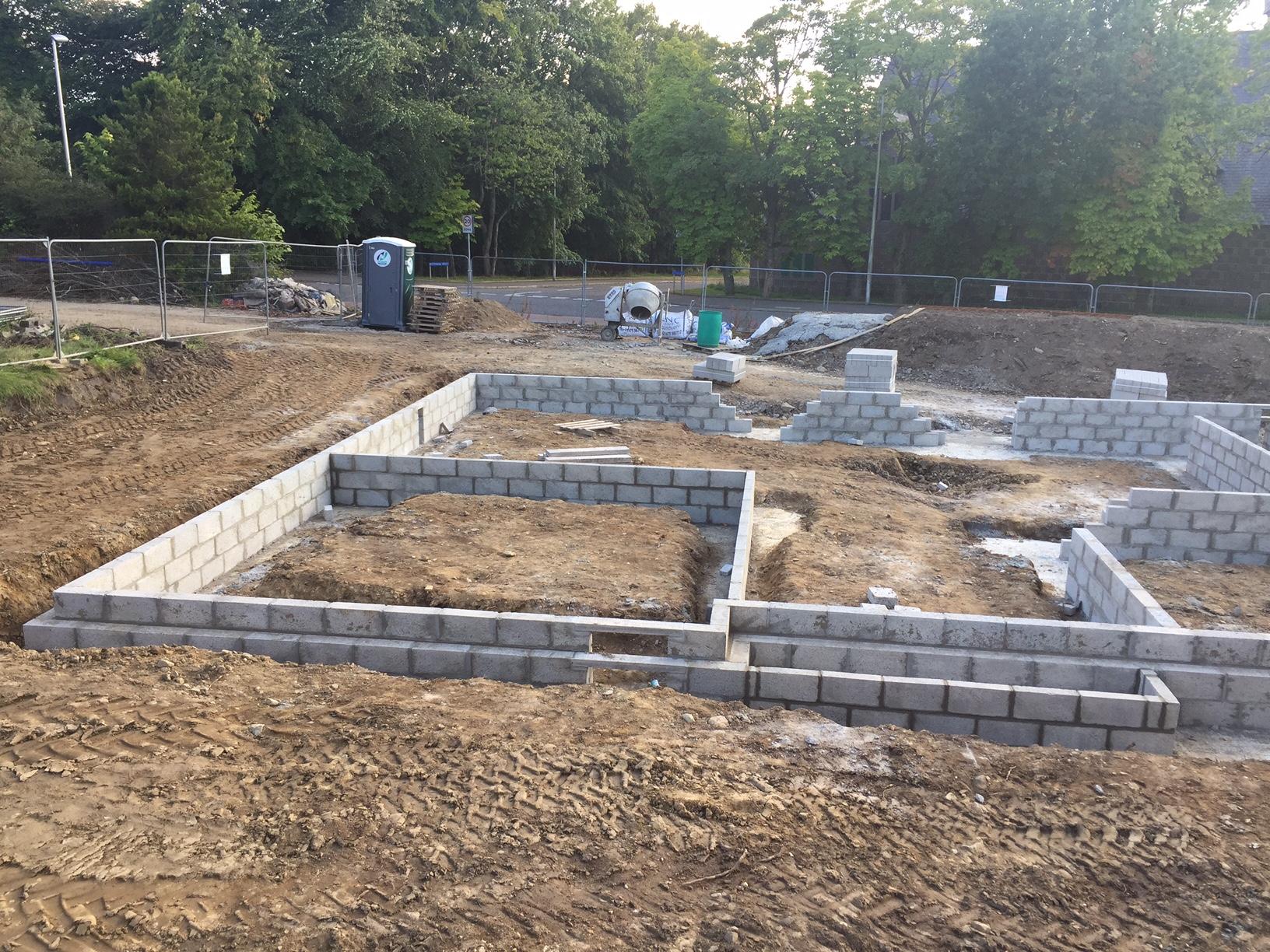

  1. There will be paving all round the house level with the doorways, however this is a change from the original plan. So maybe as you say they were originally for steps.

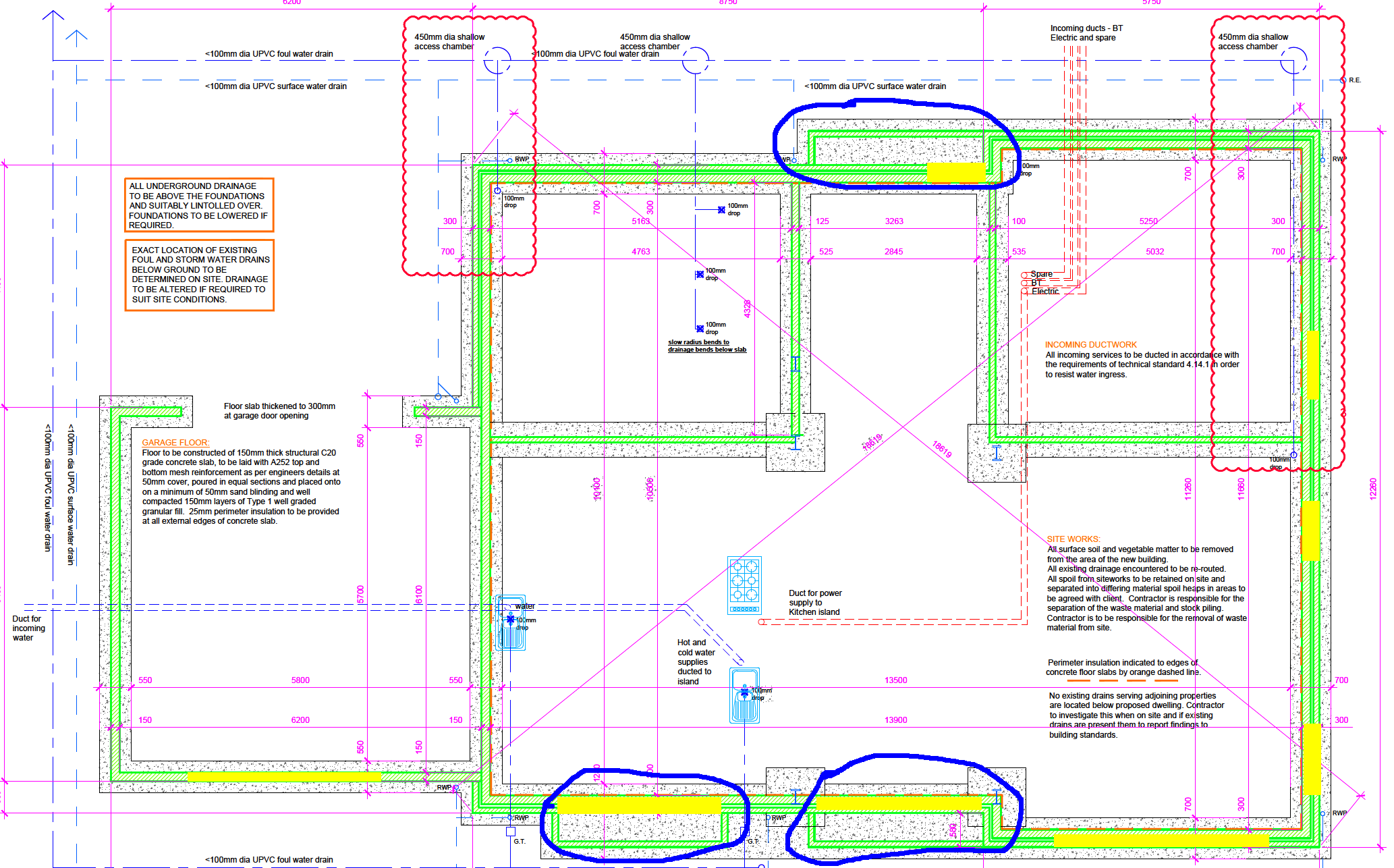

  2. The house has 8 external doors that I have highlighted yellow on the image below. Can anyone please tell me why do only 3 of the areas near a door have the extra protruding block work (circled in blue)?

  6. The builders are finishing our foundations today. I have asked them to put UFH and insulation in the garage floor as well, however still use just concrete rather than a screed. The builder has asked if I want the 2" fall in the garage floor to let water run out of the garage if there are cars parked in the garage. I will be using the garage as a gym so would never have a car in the garage, however if we sell the new owners may use it for a car. If I went with the 2" fall and at a later date converted the garage into a room would the UFH still be effective if the floor was then leveled (on top of the existing floor)? What should I go for, a level floor or one with the 2" fall?
