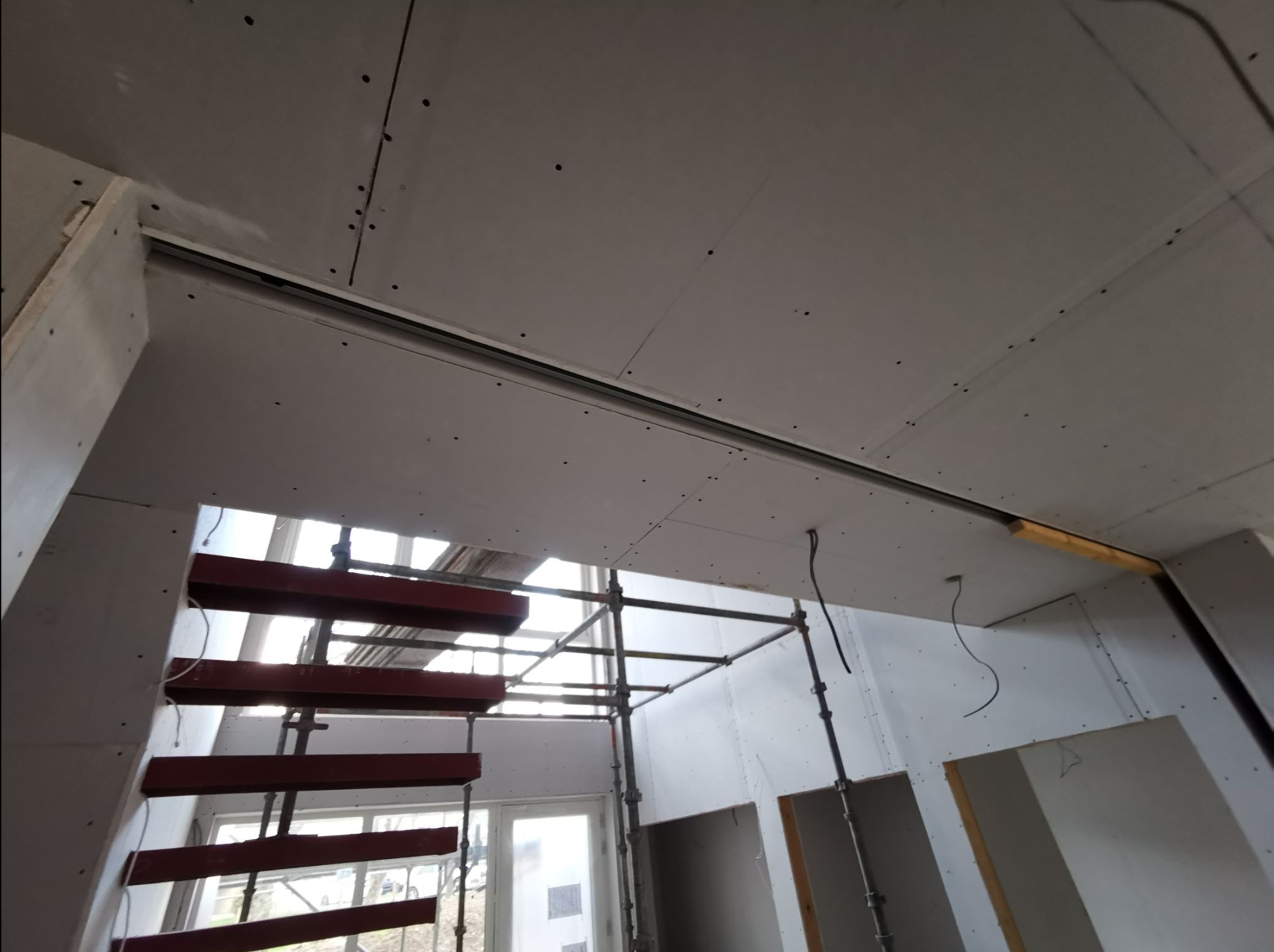

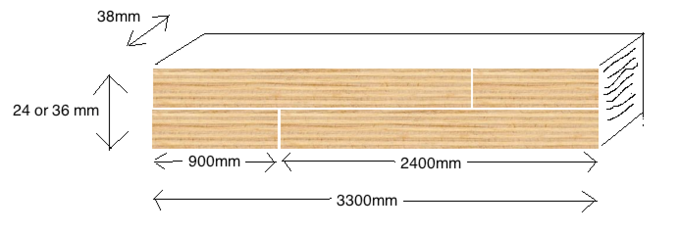

Last year I asked about how best to create a DIY large sliding door, 3300mm wide by 2650mm high, the consensus was the best approach was a stud.carcass timber frame covered by 6mm ply or MDF. This is what I was planning to do. However I had a cabinet maker in the house to quote for making the stair treads and he noticed the runner in place for the large door and asked when I was planning. When I told him, he said he would not use normal softwood timber for the carcass as it will warp over time. Instead he recommended cutting up a sheet(s) of birch ply length ways into battens and then gluing them together to make the carcassing timber. However I forgot ask him to specifics. Can anyone recommend what thickness I should go for 2 x 12mm or 2 x 18mm ply. What depth should I make the ply battens, I am thinking 38mm (the door needs to be around 50mm, including the 6mm covering sheets) Is it ok to glue all the strips of ply lengthways in the same direction/orientation? Do I need to use birch ply or would any hardwood ply be ok, since it will be covered by a sheet of ply or mdf What intervals should I have for the horizontal and vertical ply battens that make up the door, how about 660mm?

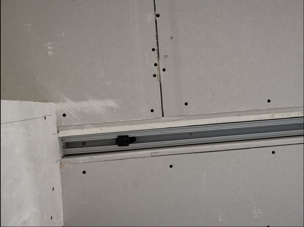

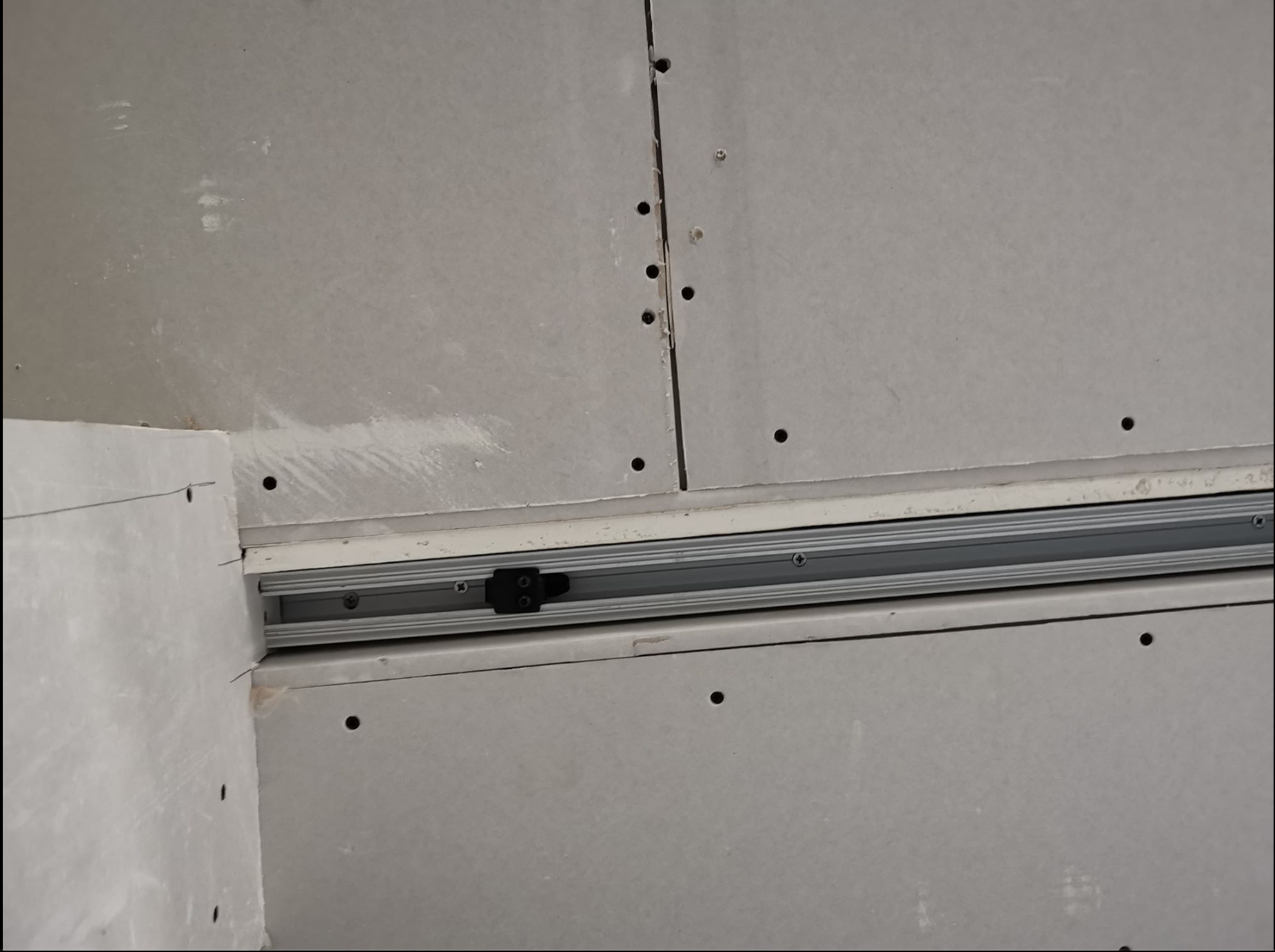

I have just had two of these fitted: https://www.coburn.co.uk/product/hideaway/ My joiner really doesn't like pocket doors and said this one is the best of a bad bunch (from his experience) The frame is encased in the middle of a 90mm partition and loos like 20mm. Obviously this approach takes up more space, however the wall is still fully insulated and feels very sturdy
