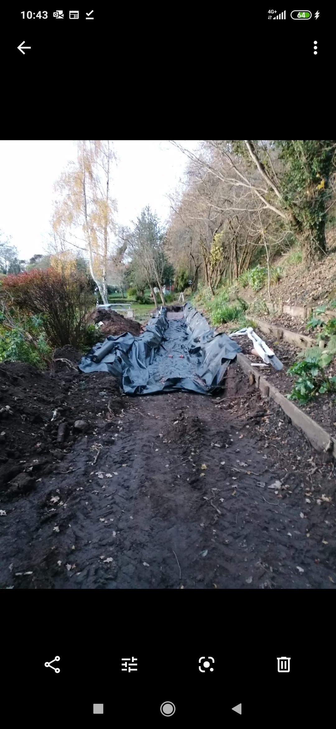

Yes concreted in. The bit to the right of the picture is the old railway embankment. Drain runs are down past the digger. Think I've got an old pic.
Unfortunately the option for gravity alone doesn't exist for us due to the site. It also explains why we had so many issues with our last septic tank (which was not pumped). On site now discussing.
Right ok, so I need to check if he is putting in a second tank which I don't think he mentioned, unless this is what he meant all along....
Isn't that sort of what I described or are you saying we should have two tanks? Our treatment plant is Ensign ????
Ok, spoke to sewage treatment plant guy. I'm hoping this will make sense now. So here goes.... They always knew that they would need a pump on the sewage treatment plant, which I've mentioned the tank above (the one that was on our drive). This is now in the hole and not on our drive (success)! The reason that it needs another pump is because the sewage treatment plant is higher than it needs to be because they hit the running sand and it isn't deep enough, and although they could look at moving it, it would be further away, and would be significant cost as there are trees/excavation work and potentially with the same issue with the ground (which is likely). They are going to fit a macerator pump in a chamber outside. It doesn't have to be a macerator it can be any pump but it needs to be a (something about a 2 inch?? - may have got this wrong).There will be two manhole which feed into the septic tank.
