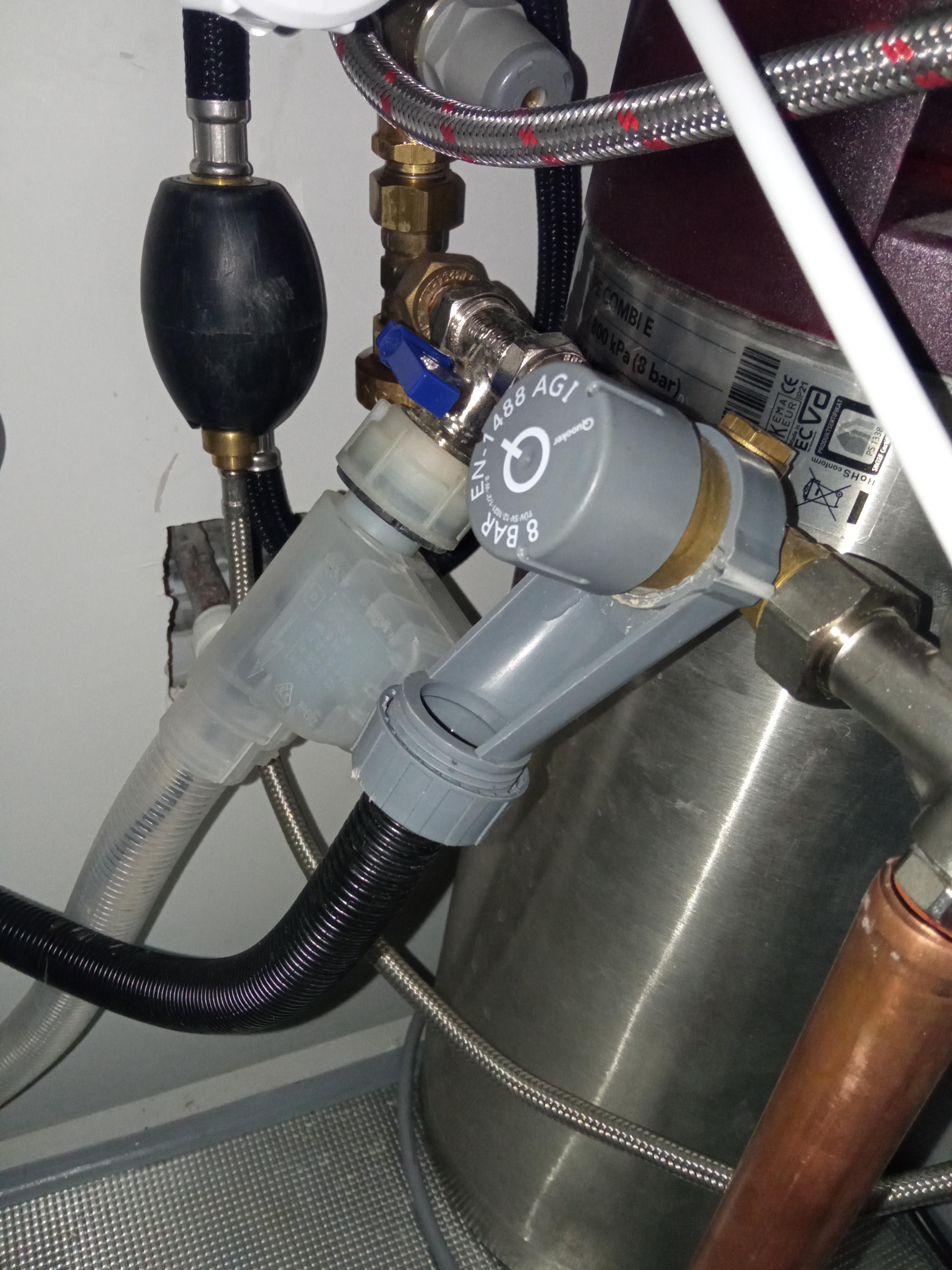

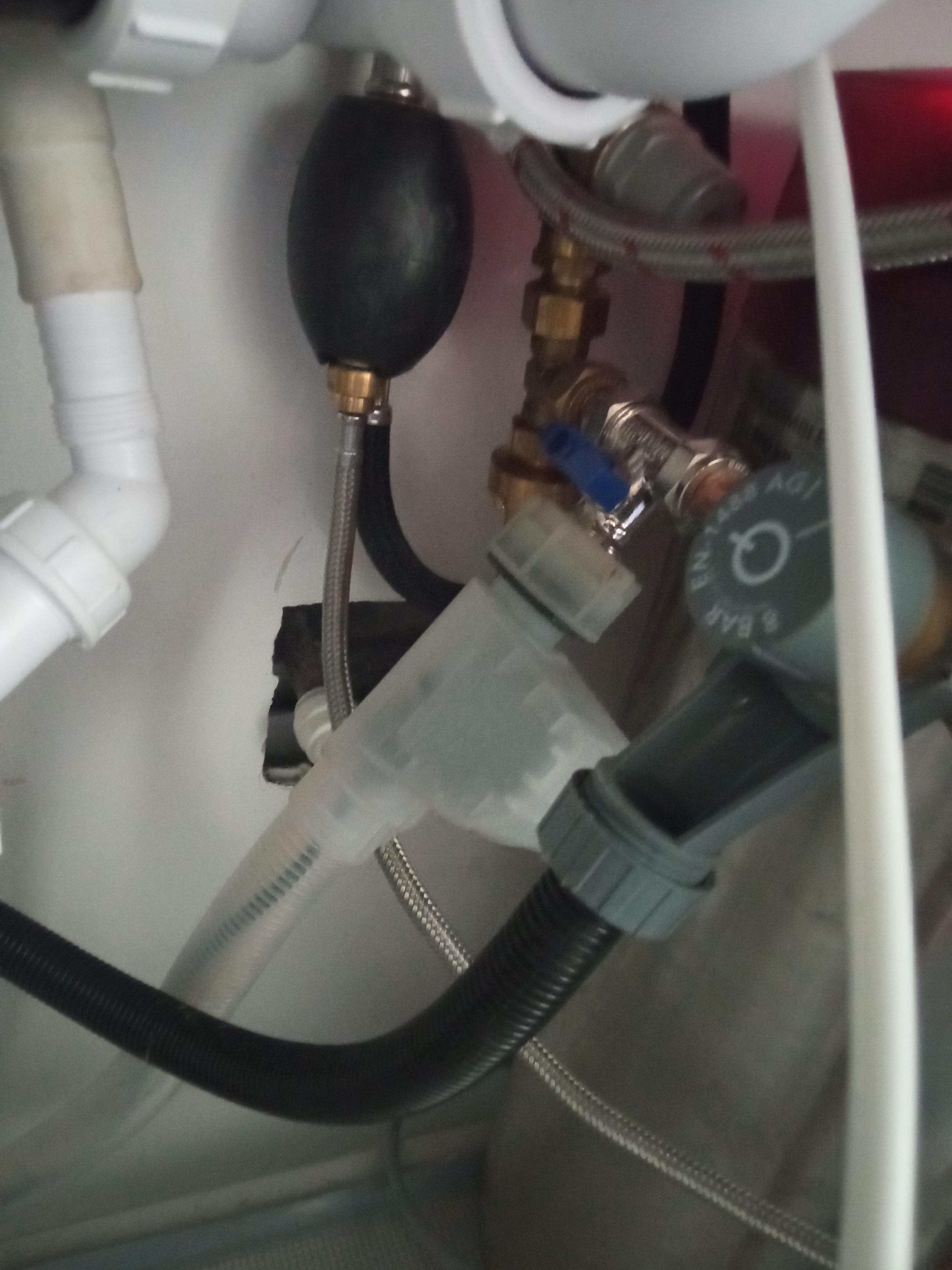

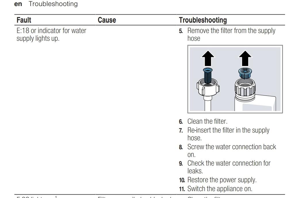

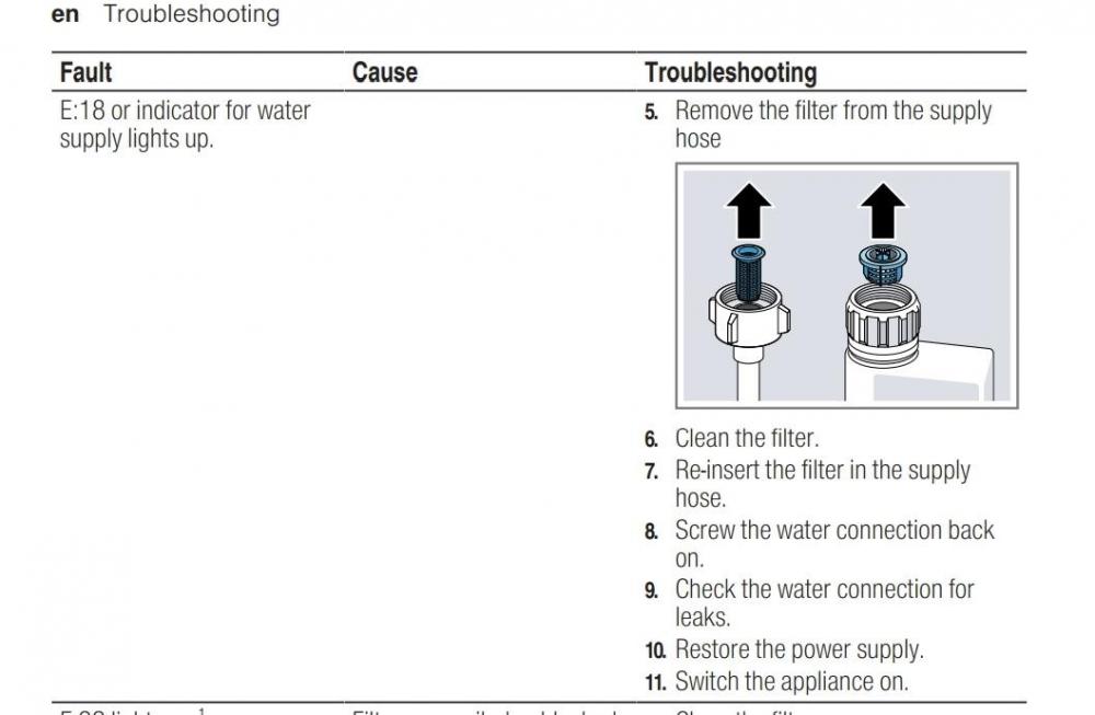

I need to be explicit to him and outline all the issues and give him a chance to fix them or say we will get an independent appraisal of his work. I wanted to take the filter out and check it's not blocked but I don't know what I'm looking for. Is that in one of the pictures I posted??? We can't lift the integrated dishwasher out ourselves so I'm hoping it is something that is visible in the cupboard. -

Can anyone advise what I should do to rectify the dishwasher error, if anything or should I just email the plumber and insist in the new year he comes back and does it -

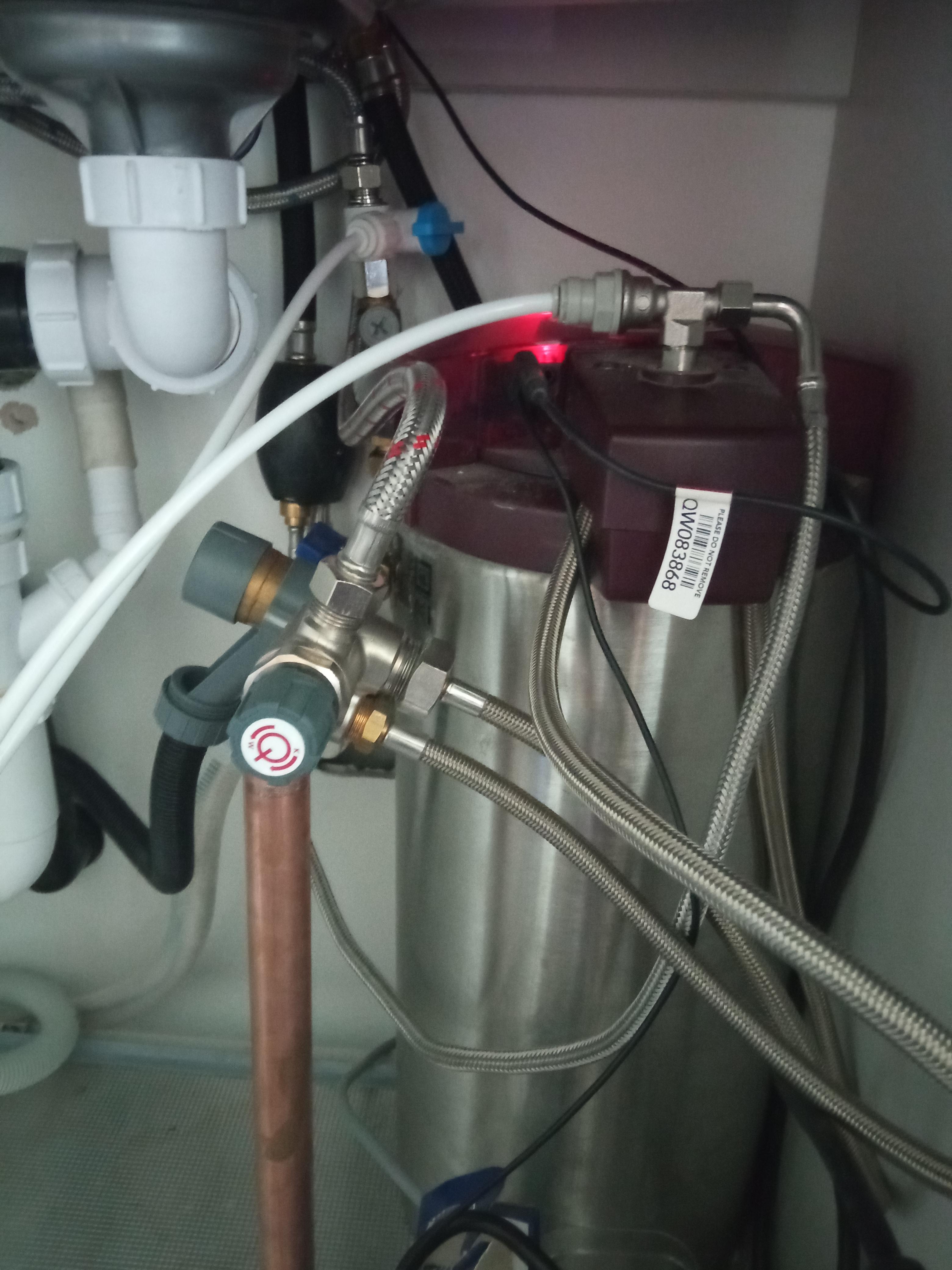

I'd taken the Cube out which would normally be on left hand side but to me there is still plenty of room. -

Yep, we are too. He's saying it worked (the dishwasher) and I think making excuses basically saying it's not his problem and blaming the equipment. Do I have grounds to not pay a bill based on this? I can't say well Buildhub thinks your work is shoddy as do we and the installation isn't neat.... His whole unit isn't big enough if he had installed it correctly and made the installation neat to me it wouldn't be an issue. -

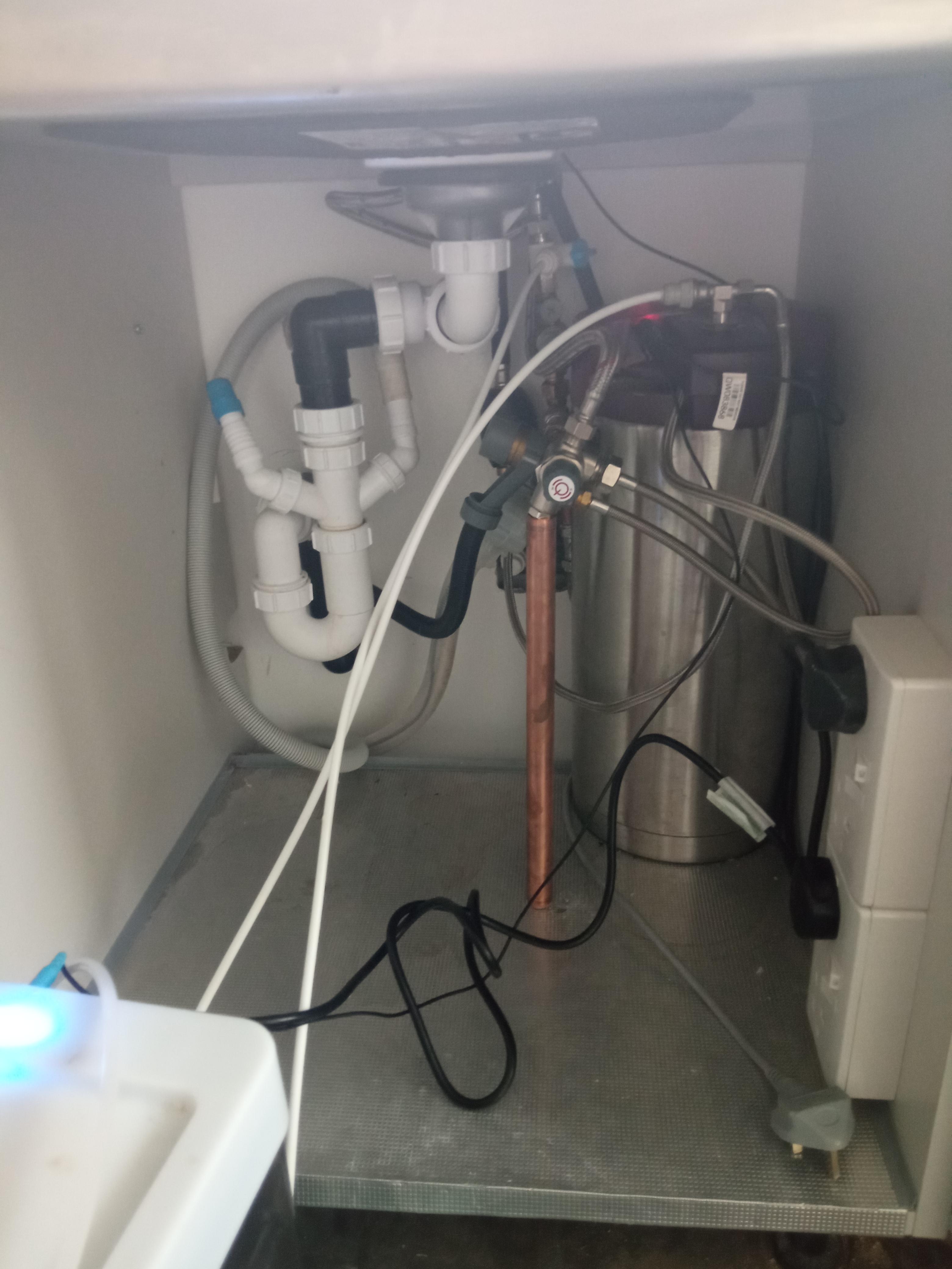

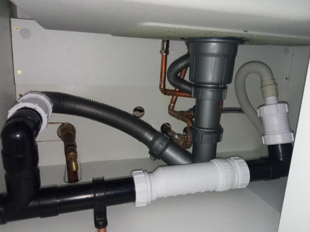

We have spent 48 hours in the house and our plumbing is concerning us. Yesterday we have come to use our dishwasher and it showed up with an error. The manual suggests this issue. The plumber is suggesting he tested it on a rinse cycle and it was fine. Granted the dishwasher did come from an ex display so had some use but it worked. When I messaged him he said "Yes did a full rinse cycle made sure it pumped out etc, no error code, check for leak in cupboard, failing that maybe a problem with the unit itself......" And "also for your info, last 4 installs of similar set up we had much bigger unit to fit it all in, and it did not come pre made up!! In my professional opinion it requires more space for this set up". Now the kitchen place had the exact same set up with the Quooker and dishwasher (which was functional) and managed to fit everything in their 600mm unit plus some cleaning products. I'm not sure what I'm looking for because everything is a mess. Can anyone help identify what I should do, if anything. He's indicating it's basically our problem. I've taken the Cube out and this is what we have. We also noticed in our utility that the washing machine and pipework all seems to be a bit of a mess as well. Perhaps I'm being over dramatic. You know we had issues with the Quooker tap previously leaking and since have advertised the copper pipe working was for support which looks a bit of a bodge and could be easily knocked. Still have issues where hose won't pull out. This is maximum we can pull it out but he has point blank refused to sort this basically saying it's as "good as it gets". Pressure for cold and sparking water is very low as is the hot water (via Quooker/Cube). We have had ongoing issues with leaks or things not quite right which have been rectified in the past week but now, whilst we await his bill we just need to know if we should be calling him back, telling him we aren't paying his bill til we are happy or getting someone else to do it. His excuse for anything is that it isn't right, wasn't new or didn't have instructions. We both have that little faith in his work we don't want him back but neither are we going to pay a bill and another bill from another plumber if he should be back to put it right. ???

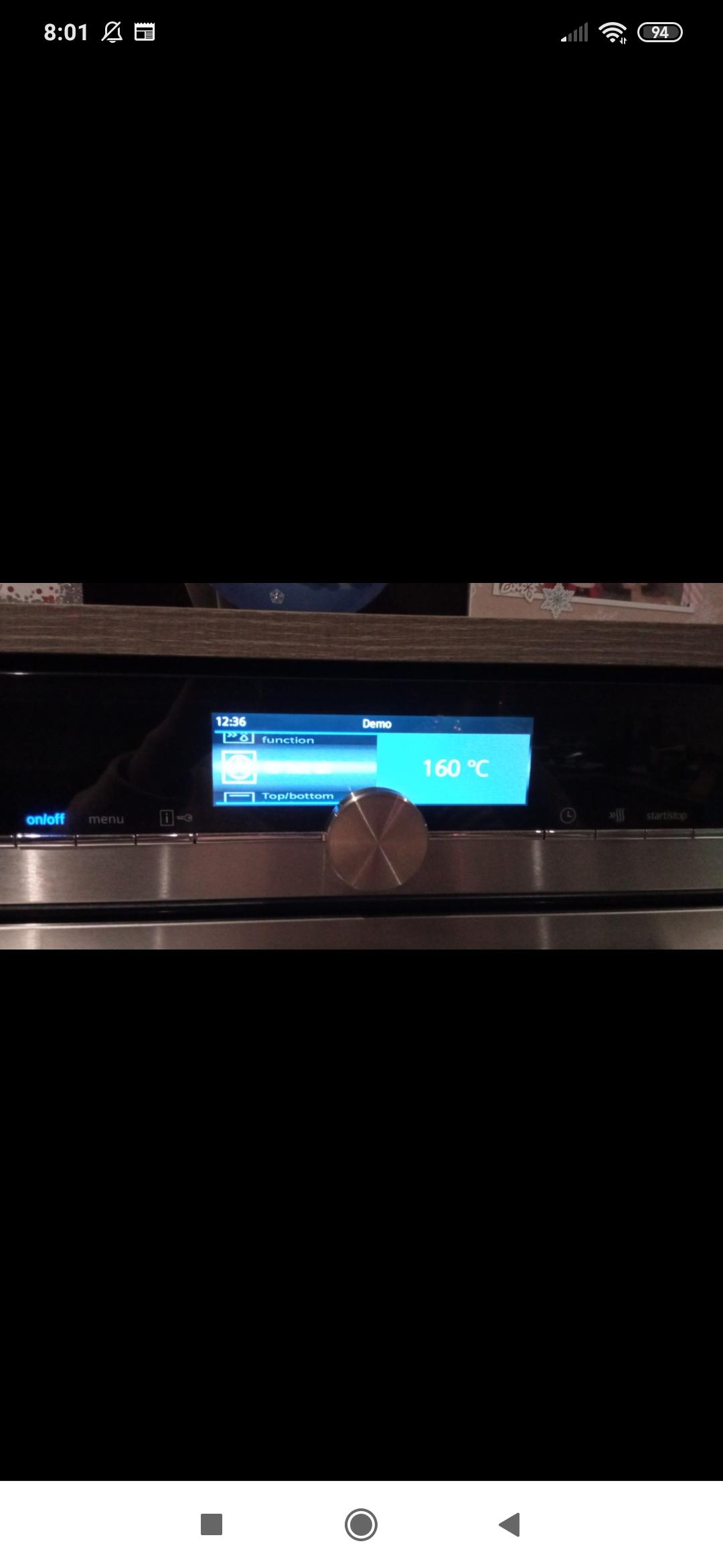

Help! Our ovens are stuck in Demo mode! The manual suggests there is a turn off demo mode in settings but there isn't anything in settings that mentions demo mode and we can't get it off and basically have no ovens to cook anything in! I spent the whole night trawling through manuals and Google and can't find the answer and Siemens isn't contactable til Monday.
