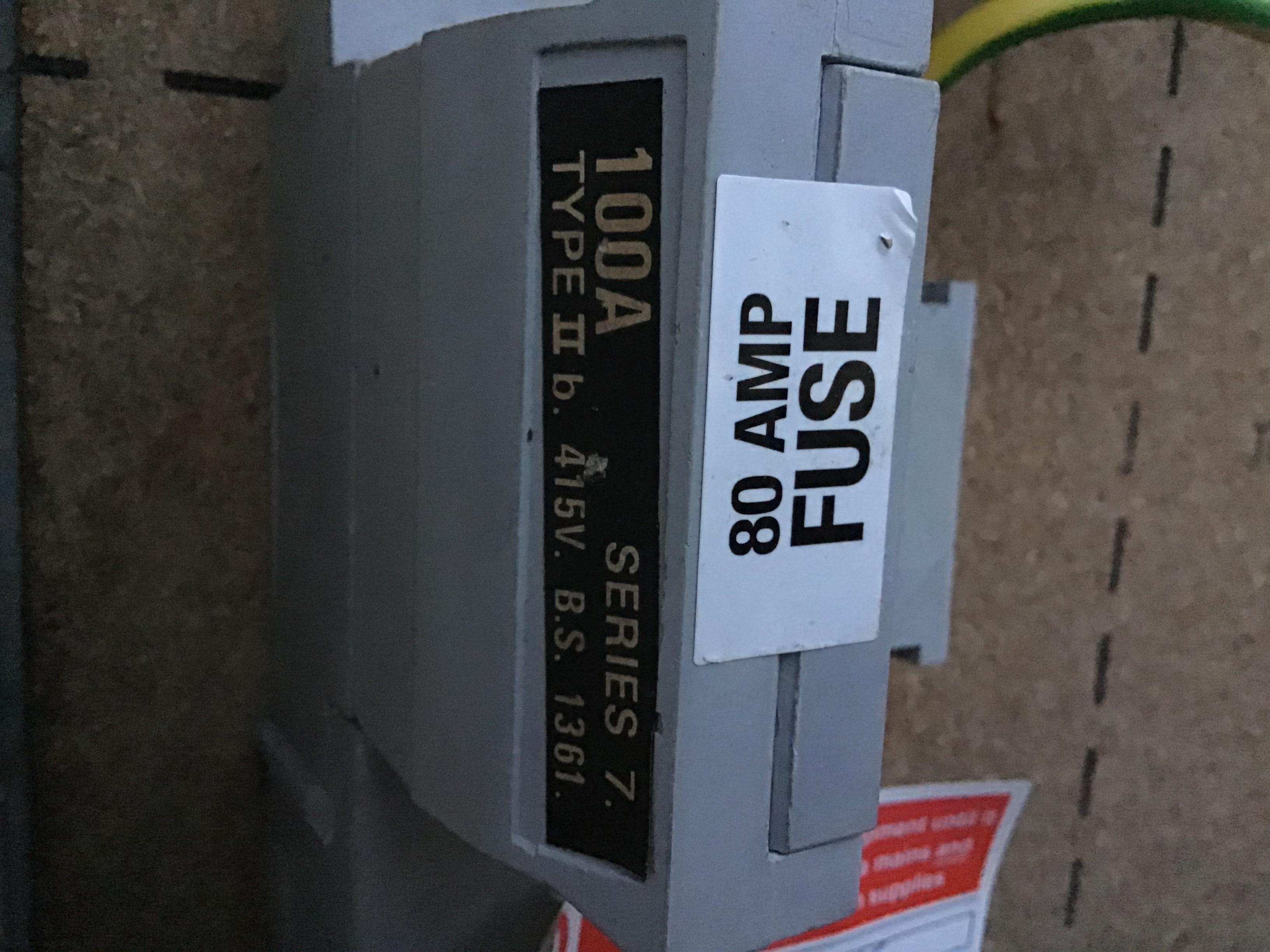

  5. So, just looked at the Main Fuse at the meter and its marked up as 100A and also as 80Amp by a sticker (See the Pic) We did have a new meter a few years back so I am assuming that they changed the 100A fuse for an 80A fuse. So should I ask the electrician to fit a 80A fuse or 60A fuse in the new switch?
  6. Thanks to everyone for your great replies and advice Could anyone advise on suitable master switches?

  8. Sorry its a TN CS (Marked up as P.M.E)
  9. Standard 240v mains supply. Earthing I believe is 6mm, it was replaced a few years ago.
  10. Hi All, Our current consumer unit (also the solar inverter) is in the garage , which will soon be converted to a bedroom, so SWMBO has asked if the consumer unit and the solar inverter can be moved into the utility. No problems with the inverter as its just a couple of cables, but the CU would be around 8 meters from its current location. I have not spoken to the electrician yet but wanted to try and understand what it involves / requires before I do so that I am better armed when I do. I have a few questions, and as I have only a basic knowledge that I have gained from reading threads here and the tinternet, so please feel free to correct me. 1, If moving the CU more than 3 meters from the meter then I need protection for the cable, which would be better, a fused switch or a RCD? (it will be housed in the external meter cupboard) or is either fine? 2, Some of the existing cables will probably not reach the new location and they cant be replaced, what would be the best way to join them (Wagos in a box, Junction boxes? something else?) 3, I was thinking of getting a High Integrity CU so that "Mission Critical" (not my term) appliances such as the alarm, smoke alarm, freezer etc would go on their own RCBOs with everything else split across dual RCDs. (I have read that some people put smoke alarms etc on the same circuit as lights so you would easily find out if the rcd has tripped, but I have had bulbs blow before that have tripped the RCD) - Any thoughts on this and what mission critical items to have on the RCBOs 4, Any recommendations or brands to avoid for the consumer unit etc (currently liking a Wylex NMX High Integrity Unit) 5, Apart from the height, does the CU need any considerations, for where it is mounted? Please feel free to add anything that I have missed, Thanks, Wozza.
