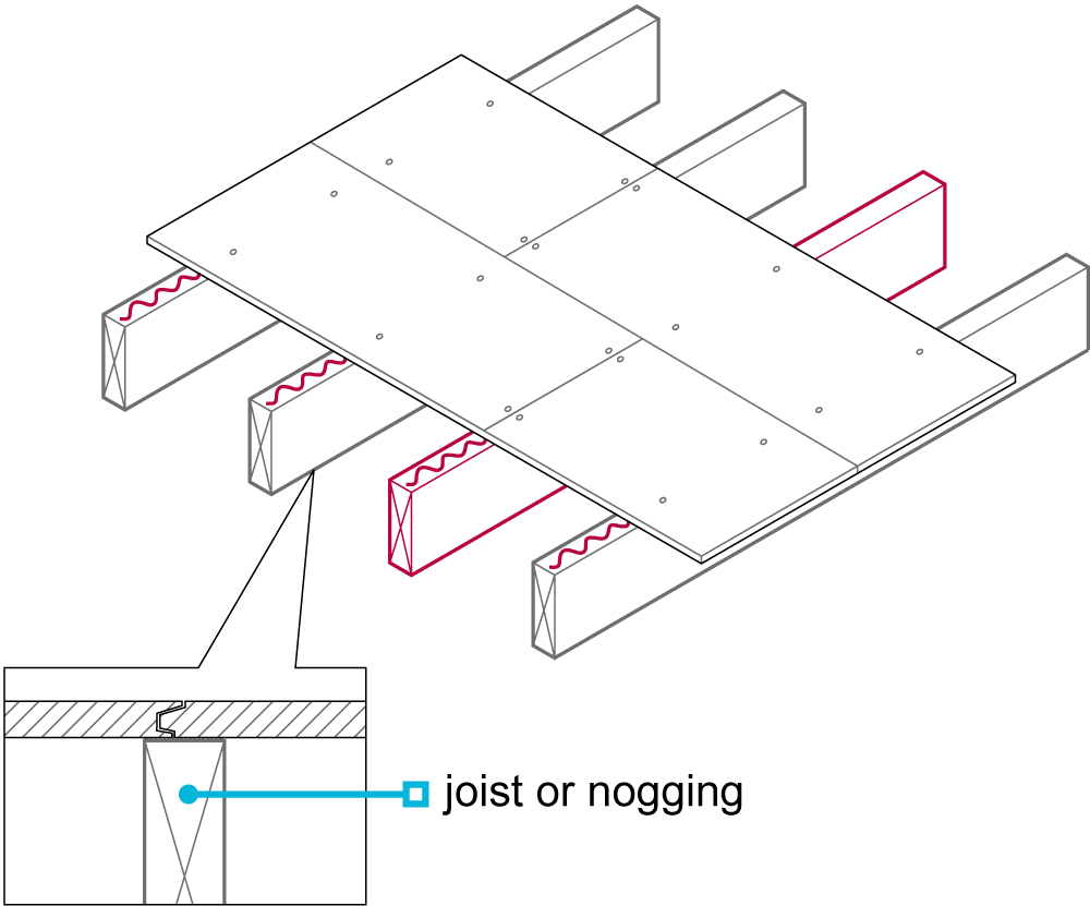

  3. The Egger fitting guide has this "All short end joints should always fall on the centre of a secured joist, including perimeter edges. Where this is not the case, please refer to the relevant building guidelines." Another guide has "All short end joints should always fall on the centre of a secured joist including perimeter edges. Where this is not the case refer to NHBC guidelines" And NHBC has

  6. 1 for, 1 against. It's like the voices in my head It will be 22mm board and the posis are at 400mm spacing, everything will be fully glued and screwed. @LA3222 It's more about keeping waste down rather than the cost saving. Though any extra sawing time saved is a boon. @nod Building control were happy with the joints in between the joists?
  7. I can see why an unsupported short end flying joint at a floor perimeter is bad, but one elsewhere, glued in between other T&G boards shouldn't be detrimental? I'm trying to think of ways to lessen waste from off cuts. Not cutting to have a joint on a joist would save a little. Do or don't do?
  8. I've recently put 20 posis in on hangers and aimed for the 1mm gap. I left a gap for the reason Temp mentioned. I'm expecting everything to lock up nicely when I put the boards in place.

  11. I was surprised. I expected Egger to say that it would be fine if, as you mention, plaster/drywall and skirting are added - reducing the gap. The reply I had was the BDA agrement and a quote from a section: "butt joints shall be staggered and supported by noggins or joists; the particleboards shall be fixed and supported on the perimeter edges of the short-ends by noggins or joists. Although long edges do not require intermediate support between joists, support noggings shall be fixed at floor perimeters where unsupported edges abut a wall" Along with "You are correct in what you say about the short ends falling on the joist, where this is not possible an additional nogging must be fitted to support the short end."
  12. I've just ordered the first set of posi joists - more visible progress :) I was planning to use Egger Protect for the first floor, so read the installation guide etc. Had a query regarding short edge support and joist overhang so emailed Egger. I'm going to end up with a 75mm gap between the end joists and the walls - like this snippet stolen from NHBC. Egger say that the short ends of all boards must be supported and have said I would need to install noggins for the gap. My google fu is weak and I can't find any examples on t'web for people doing this. Anyone dealt with this?
