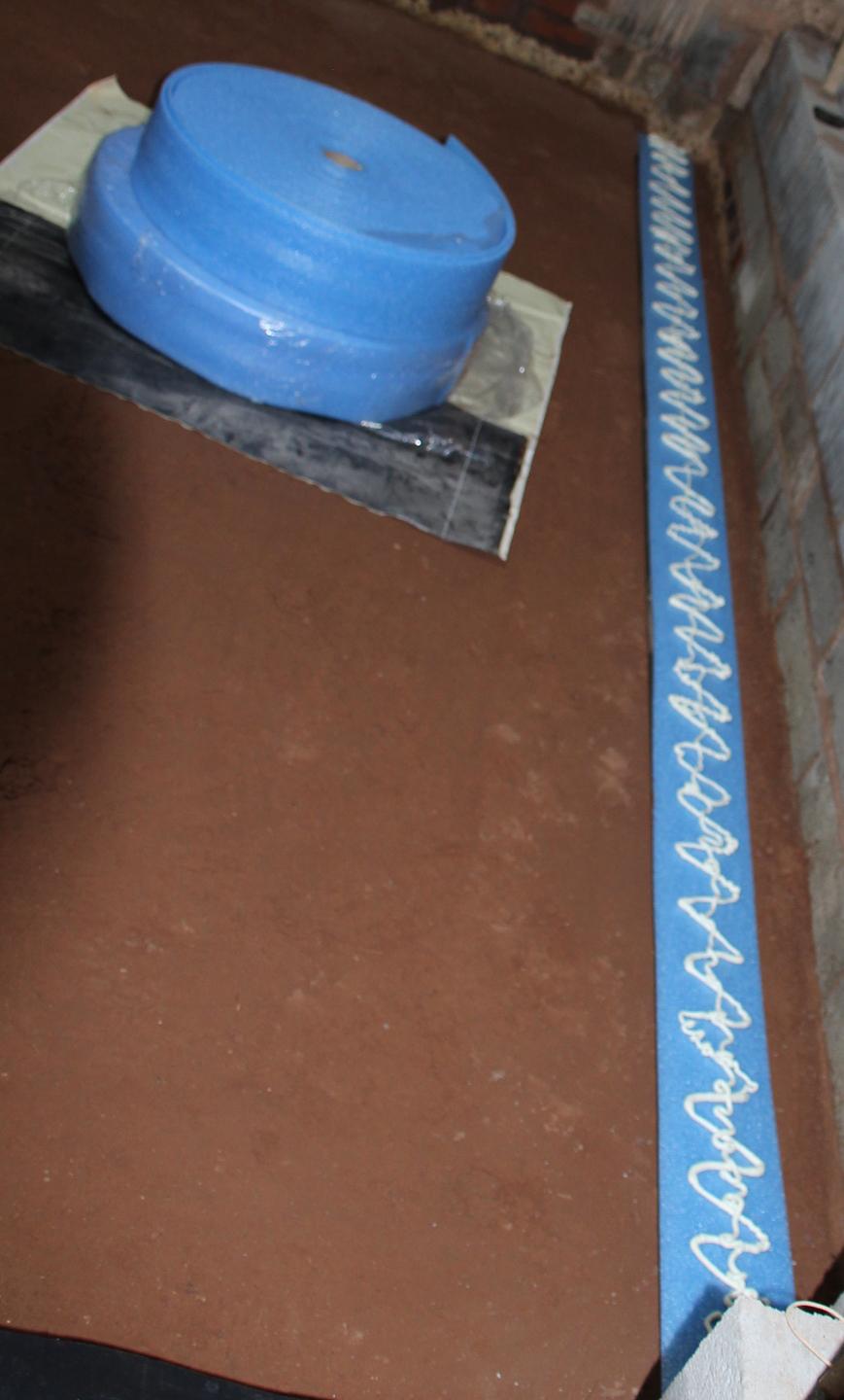

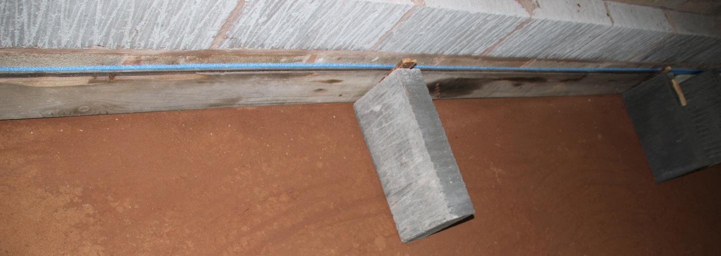

  1. Done some today. I think i've found something that foam doesn't completely stick to! It's grabbing well enough to keep it in place though, so good enough for me. Cleaned and wetted the wall, foam to back of PE and then propped a plank up with blocks and wedges.
  2. Excellent news. ? I've already got the soudal low expanding foam and gun. It's ability to stick to everything whether needed or not gave me the thought that it might work for the PE foam. Wetting will be covered, I was planning on spraying the substrate with water to remove the dust and whatnot beforehand. Did you leave the foam to go off for a few minutes before sticking your boards? Which spray contact adhesive did you utilise for the DPM in the reveal? I can see that being useful later on. Those coat hangers are, umm, novel.
  3. I'm at the point where i need to stick PE expansion foam around the perimeter ready for the DPM and base slab. I've got a few places where it will cover rough edged bricks and some broken concrete edges, so probably going to be a pain to adhere to. Will low expanding foam be suitable for sticking the PE foam in place or am i going to need to buy something specific for the job?
