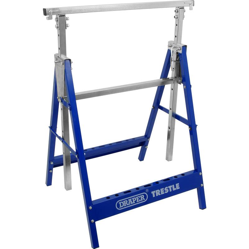

Thanks for all the info so far. I suspect i'll go for a combination of trestles and small tower sections. The trestles at toptower are rated at 450kg and the draper one I in my original post only 150kg. Not up to it. The 9 blocks an hour probably isn't too far off. I spend an age making sure the end blocks are square, level and to gauge. I'm at the stage where I still check everything far too many times and I remove and re-lay many blocks because i'm not happy with them. Returns and reveals also take me an age. Fortunately i'm not on the clock, so it all takes as long as it takes. -

I had spotted these and wondered if they'd be up to the job with planks. adjustable trestle They'd come in useful for other stuff too. -
I'm putting up the inner leaf inside my barn. I've almost done as much blockwork as I can without using a lift. I'm looking for suggestions for a platform. The longest wall is 4m and i'm thinking that I'll need to lay blocks to around the 2.5m mark from the platform. After that i install floor joists and then move platform up to the next floor - happy to be steered otherwise? What would you recommend I take a look at for a platform?
