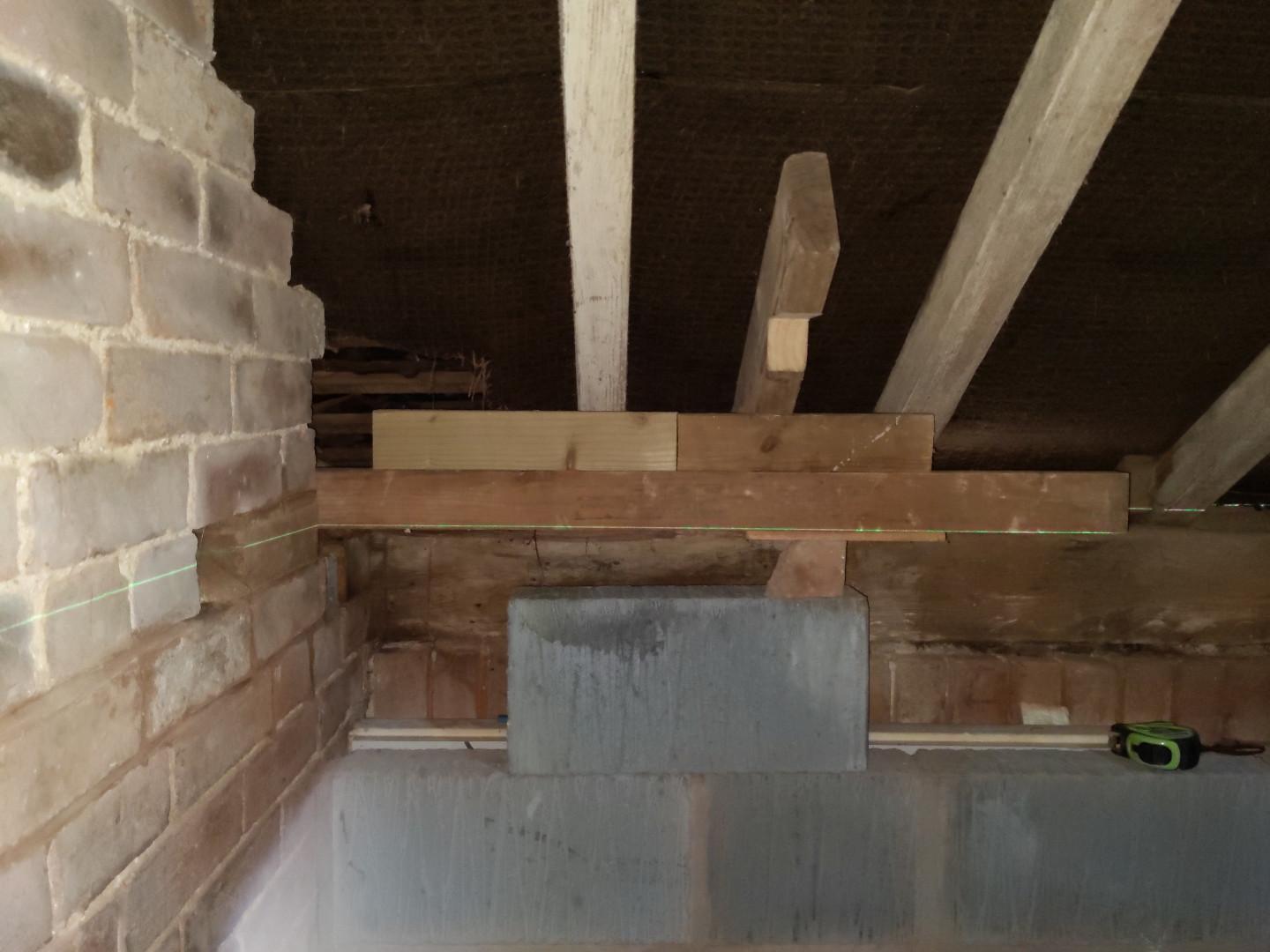

I tried searching for details of allowable overhangs, offset joints etc, but didn't find any wall plate rules other than minimum 38mm deep, must be lap jointed and the 3m/3 rafter span minimum length. If overhangs and offset joints are acceptable I'll experiment and pick the option that is the least offensive I'm going to be the chippie, I hope. The new inner walls are equal heights, but with the building itself not being fully square they aren't parallel. Only two birds mouth per rafter, but I won't be able to template and copy.
Hello everyone, I've been dry fitting wall plates and have one niggle to deal with. It's an artefact of my wonky walls When I built the new inner leaf it was stepped back from the existing walls to form the cavity. All of the other junctions are fine, but one junction across an internal wall has an offset of ~ 15mm. If I place the 75x100mm wall plate straight across here I get an overhang. What is the best way to deal with this?
Really? It would make my life much easier if I could use a small plate under the valley rafter alone and then step up to different level on the other side of the wall. The thing that steered me away from that is "Wall plates should be a minimum of 3m or extend over at least three joists". The valley rafter wall plate would fail all of those requirements. The small wall part might also fail those. I don't think I can get three common rafters on it at 600 spacing unless the first rafter is tight up against the wall.

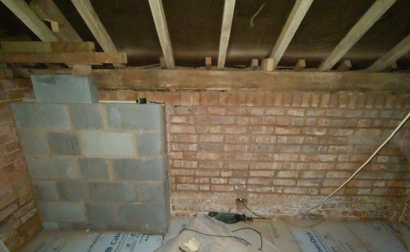

It's not clear from the images I posted earlier, but the block wall in the picture is short. It provides a cavity to the outside wall up to perpendicular wall of the single story room on the other side. I would get two or three common rafters on the double stacked wall plate and the valley rafter on singe depth end of it in the room to the left. New common rafters would continue in the existing wall plate position to the right.
Ladies and gentlemen of the jury, New internal leaf stepping back from original walls is causing a height difference between the west and east wing of our L shaped building. Is it acceptable to stack timbers in wall plates? In the mocked up example I have a stunt valley rafter sat on a 75mm wall plate in the outer corner of our L shape. The wall plate is around 1.6m in length and passes through to the south wing, and has another piece of timber above it to take up the extra space beneath my stunt common rafter. Laser level is set to the masonry top on the west wing.

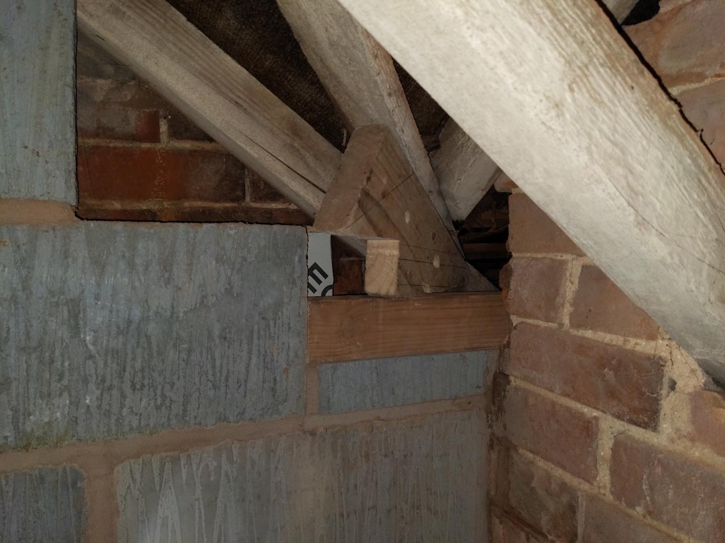

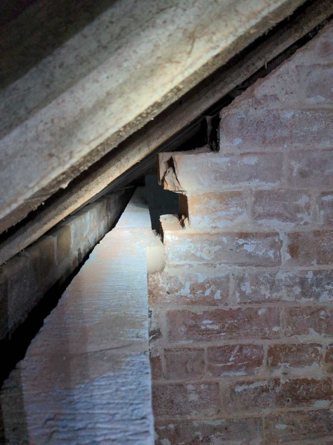

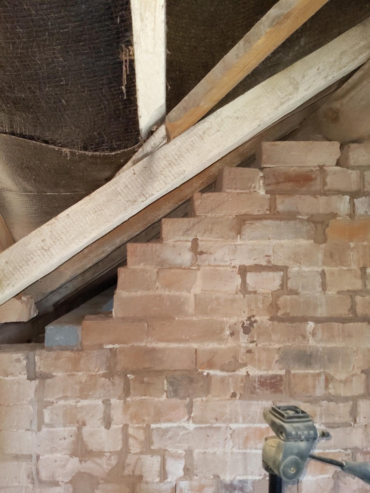

If everything was true the rafter position would be like this Hopefully the pictures show enough detail. This is the short side. The gap between the inner leaf and the old wall plate is 240mm. This is the longer side. The gap between the inner leaf and old wall plate is 305mm. The bits of new timber aren't in the correct positions, but are relative so will hopefully be a decent visual representation that the larger gap will cause the rafters to terminate much lower in the void behind the corbelling.
I have new inner leaf with cavity against an external 9 inch solid wall. When I fit the new roof the ridge will be level and the new wall plate on the inner leaf will also be level. With the rafters sitting on the new ridge to wall plate line the gutter line on the bowed wall will be quite a way off on some places - up to 100mm bow. The building has suffered roof spread in its past and some parts of the spread have been repaired. Structural engineer didn't seem too bothered by it so it is how it is. When re-roofing a building where the eaves, wall plate and ridge don't line up how does one tweak the eaves end of things? I'm making the assumption that I can't just make the wall plate cock-eyed and call it done.

To keep increasing the rafter height and lowering the ridge beam position, at some point I will need to start chopping into my new internal walls to lower the wall plate. I can carve the nose of the rafter to fit into the space behind the corbelling, between the external brickwork below and the tiles. -
