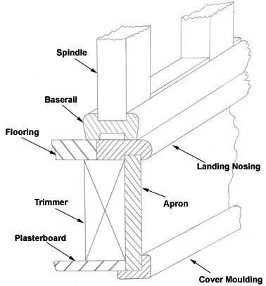

I've almost finished with the joists for our landing area and P5 is next. We have minimal detail for our stairs other than the opening size, turns etc., so have been looking around at landing construction. I'm still unsure if I should lay the P5 to the edge of the stairwell trimmer or leave a gap at the edge for landing nosing and the like?

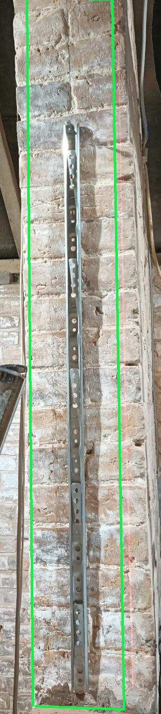

@PeterW Does the green outline I drew in the picture above match what you had in mind for the optimum line? -

Something like this? The blocks will pretty much start off at the bottom left edge of the wall and stop at , or close to the top right edge. -

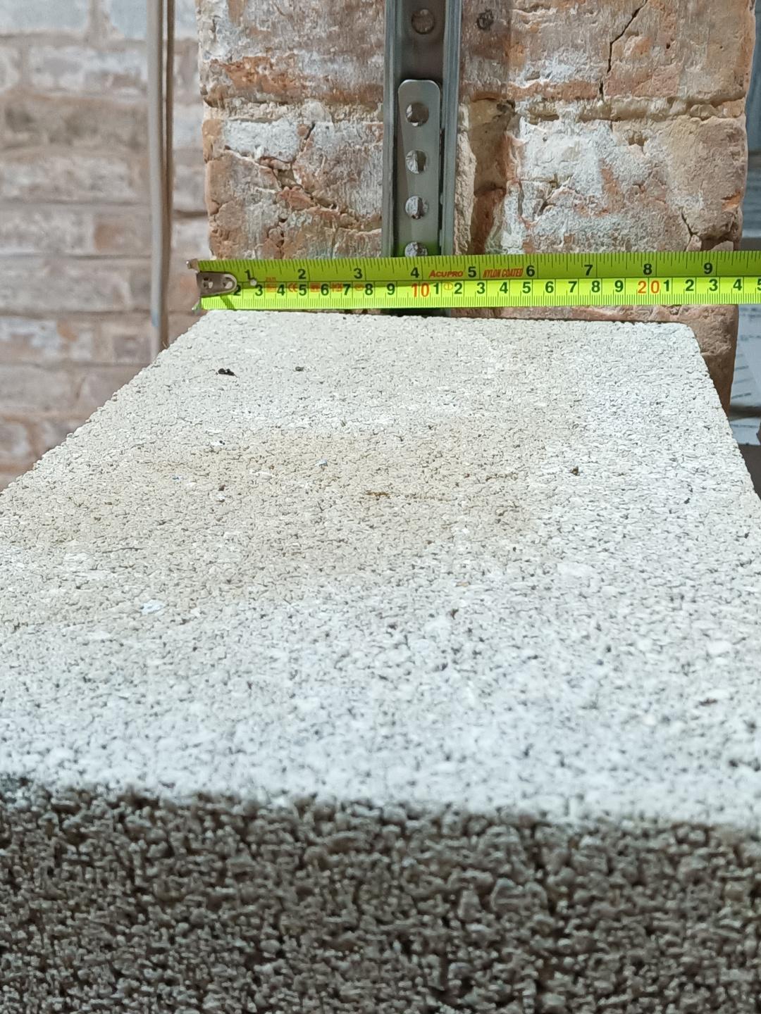

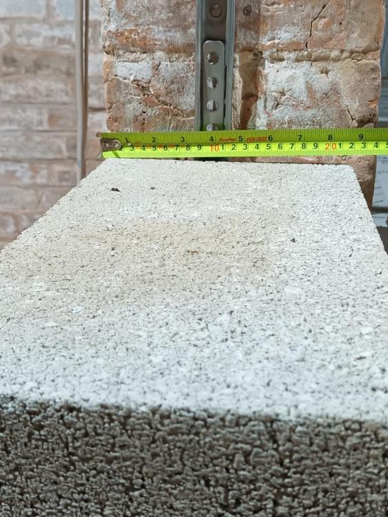

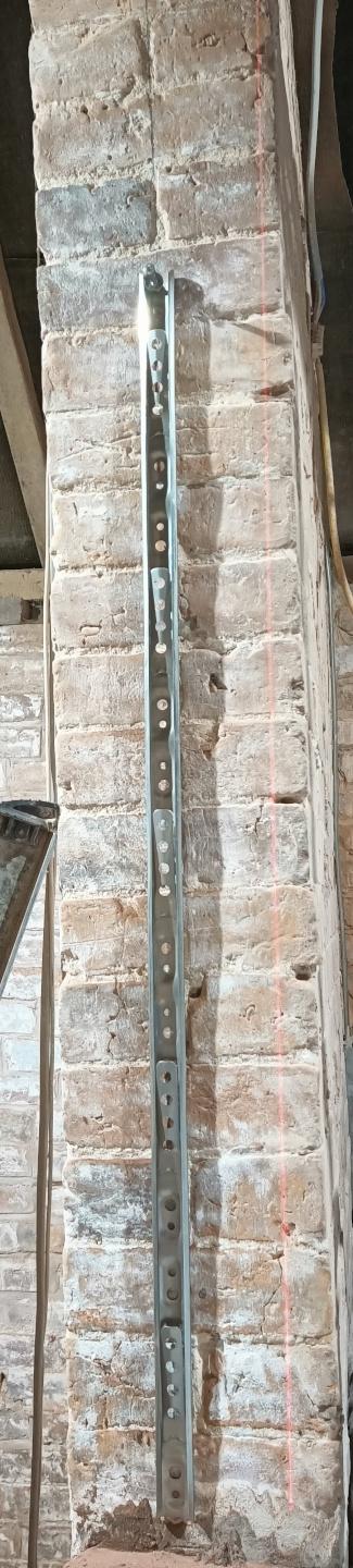

I've started to look at bricking up an internal opening this evening. Basically closing up a wide opening to doorway size. Couple of lintels to go over the doorway opening, and a tiny triangle of bricks above that to the apex. Marked a line down the centre of the existing bricks and screwed the top fixing of a crocodile in place. Let go of the crocodile after marking the lower fixing points and watched it swing away from centre. It's got quite a lean. Picture attached with a laser level on it to give an idea of the lean. Ancient existing bricks are 240mm wide. I'm planning to use dense concrete blocks on their side, so new bit will be 25mm shy of the existing width. I'm not sure what to brick to with this. Pick a side and follow the current lean? Half the lean and try to straighten out a little? Ignore the lean and go vertical? How would you do it?

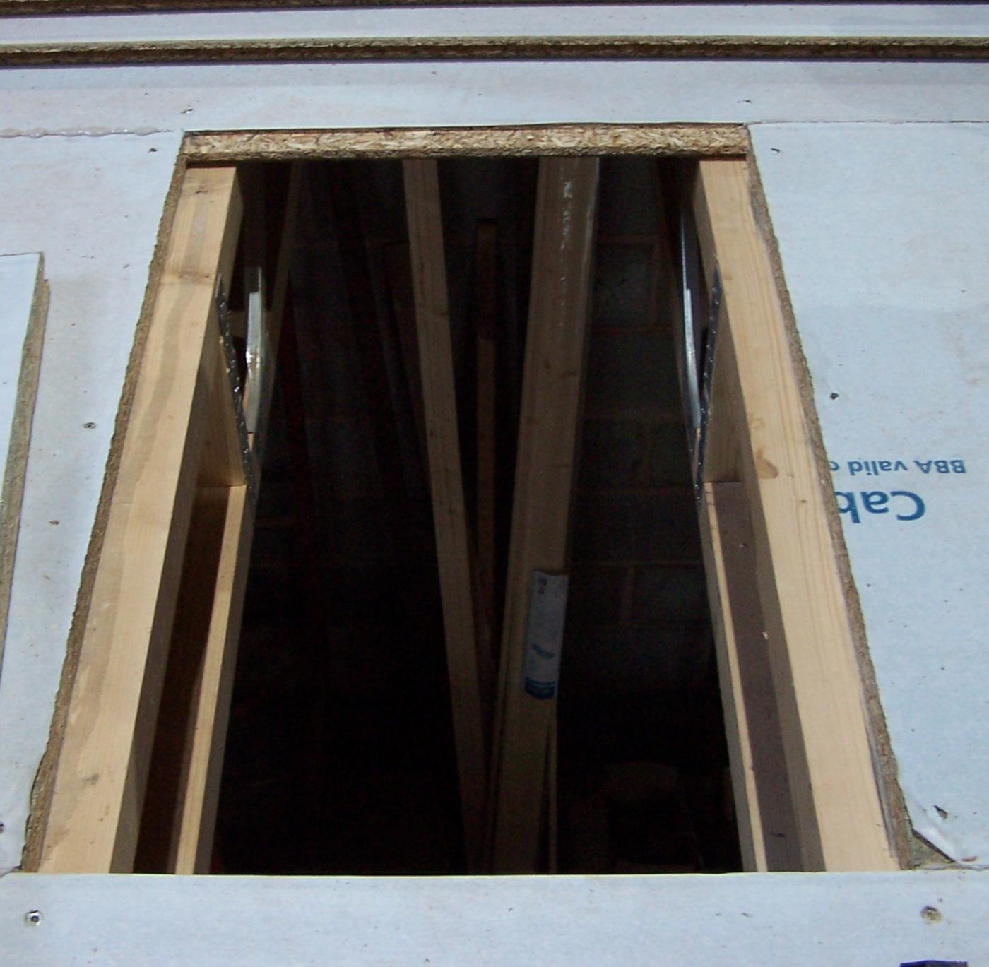

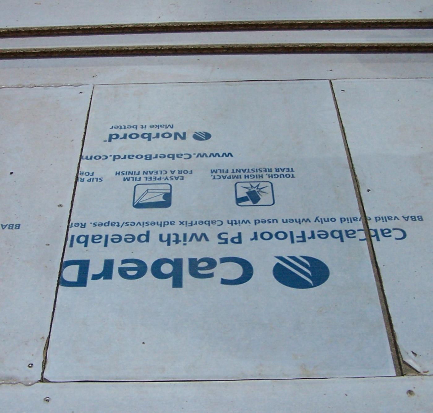

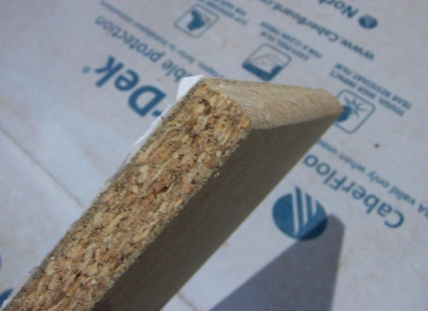

First part of flooring is in place. In case it helps anyone else in a future search the hatches are like this: And to aid lid movement I chamfered the front edge of the lid: -

That makes it clearer. Thank you. Started carrying the boards up the ladder to the first floor tonight. Will get to creating the first hatch soon. I'm favouring somewhere central for it. Any reasons not to have it centrally? -

Do you mean cut the lower half of the groove side off? I can't quite see how removing half of the tongue helps in lifting the board. I'm thinking that after the plaster board is on the ceiling I'm bound to realise I need to route something else under the floor. A hatch in each room should allow me to fish things through. -
I'm wanting to put an access hatch/opening in my P5 flooring in each room. As each board is going to be glued and screwed I'm wondering how best to implement the hatch. Do I cut out the hole before fitting, or omit some glue and cut a piece out later?
