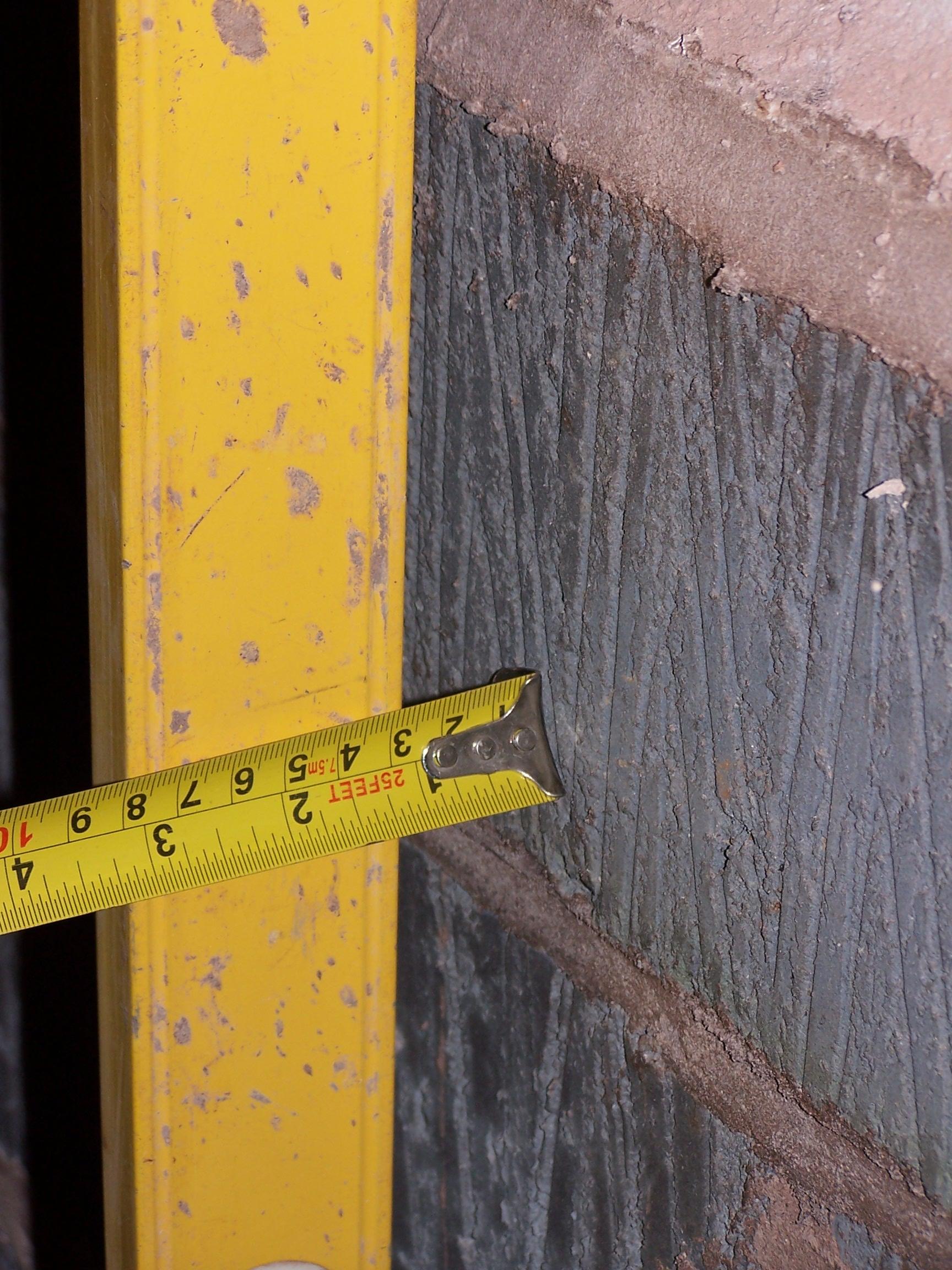

  4. For the win! The steel in railway lines is really hard stuff. I had read online, before I started drilling, that trying to work with anything other than carbide tipped tools would end with me spending time dressing/sharpening the tools. That was very true. I'm sharpening the larger bits after every hole. Do you think a bi-metal hole saw is up to inch thick hard steel?

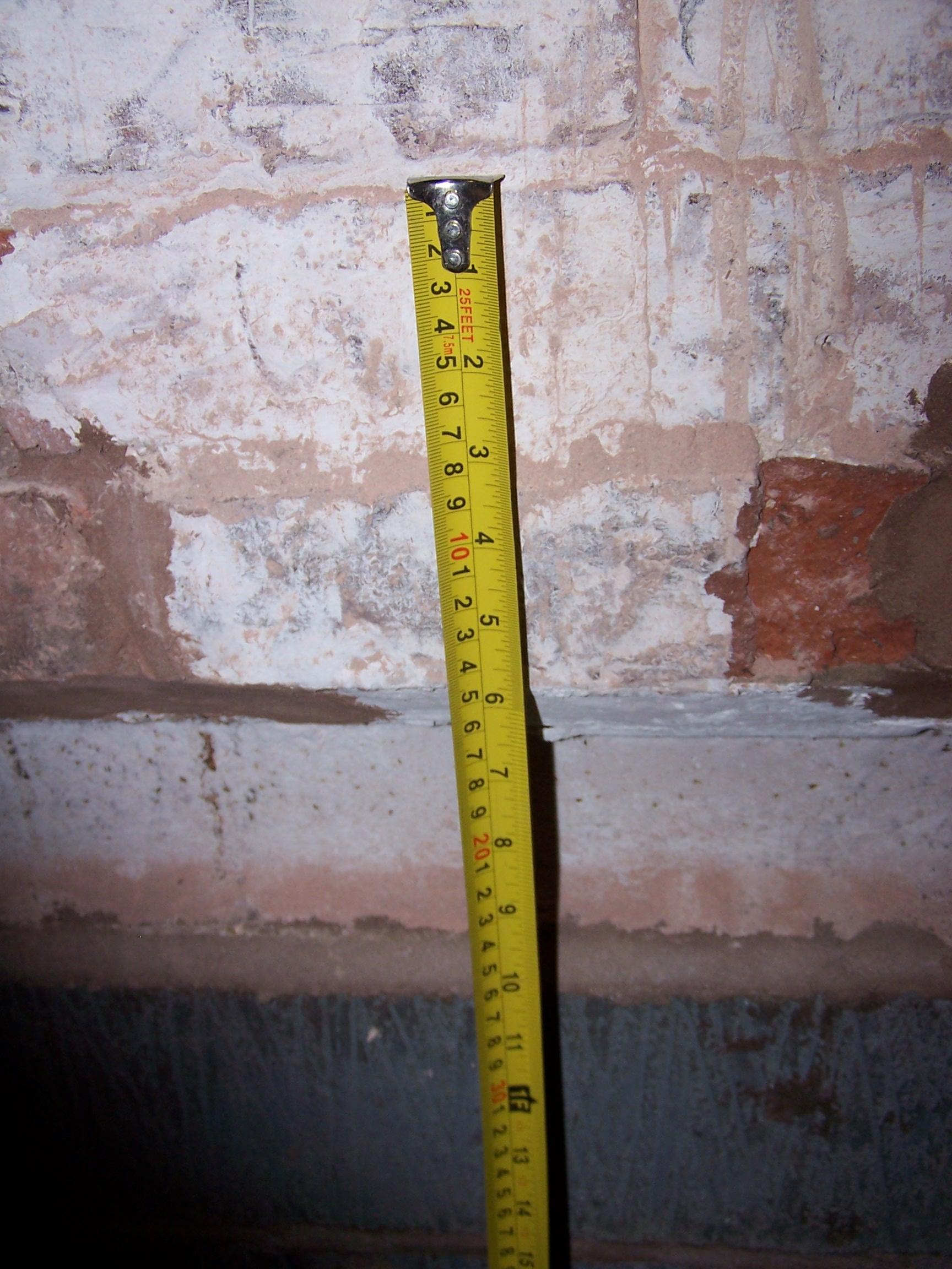

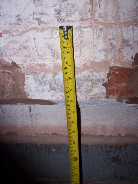

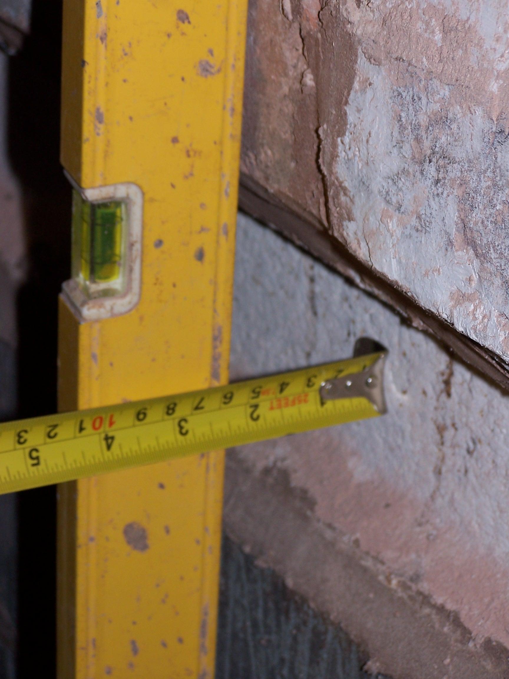

  5. I'm putting a ledger plate on either side of a 9 inch wall. A pair of old railway lines sits exactly where the holes need to be. I've drilled a few holes using cobalt bits 4->8->10->12mm, then switching to masonry for the centre. Then back to cobalt for the rest of the steel. The steel is an inch thick or thereabouts, amd It's buggeringly hard too. A mag drill base won't fit inside the web Any suggestions on how to drill these holes quickly? A hole The sandwich

  22. I'm going to have to start putting in joist hangers soon. Most of the walls where they need to go are new block, so just placing them in as the wall grows is nice and easy. I have one wall that runs across the building that used to be a large opening. Aeons ago when this thing was built a pair of old railway lines were probably the thing to use, so that's what is in place. I've blocked up under the opening with 215mm aircrete blocks which fit under the lines nicely. The brickwork above is some 235-240mm wide and overhangs the lines. Where i need to fit the hangers for 215-225mm joists leaves the hangers unsupported over the void in the sides of the lines. Attached pictures hopefully give a decent indication of what I've got to play with. So far I've come up with: Drill and bolt through with a timber wall plate either side with extra timber into the line void. Weld lumps of steel into the line void behind each hanger. Thin piece of timber into the void for the length of the line. There is a doorway above the line too, which will probably need saddle hangers if I don't go with a wall plate. Any other ideas on how to deal with this?
