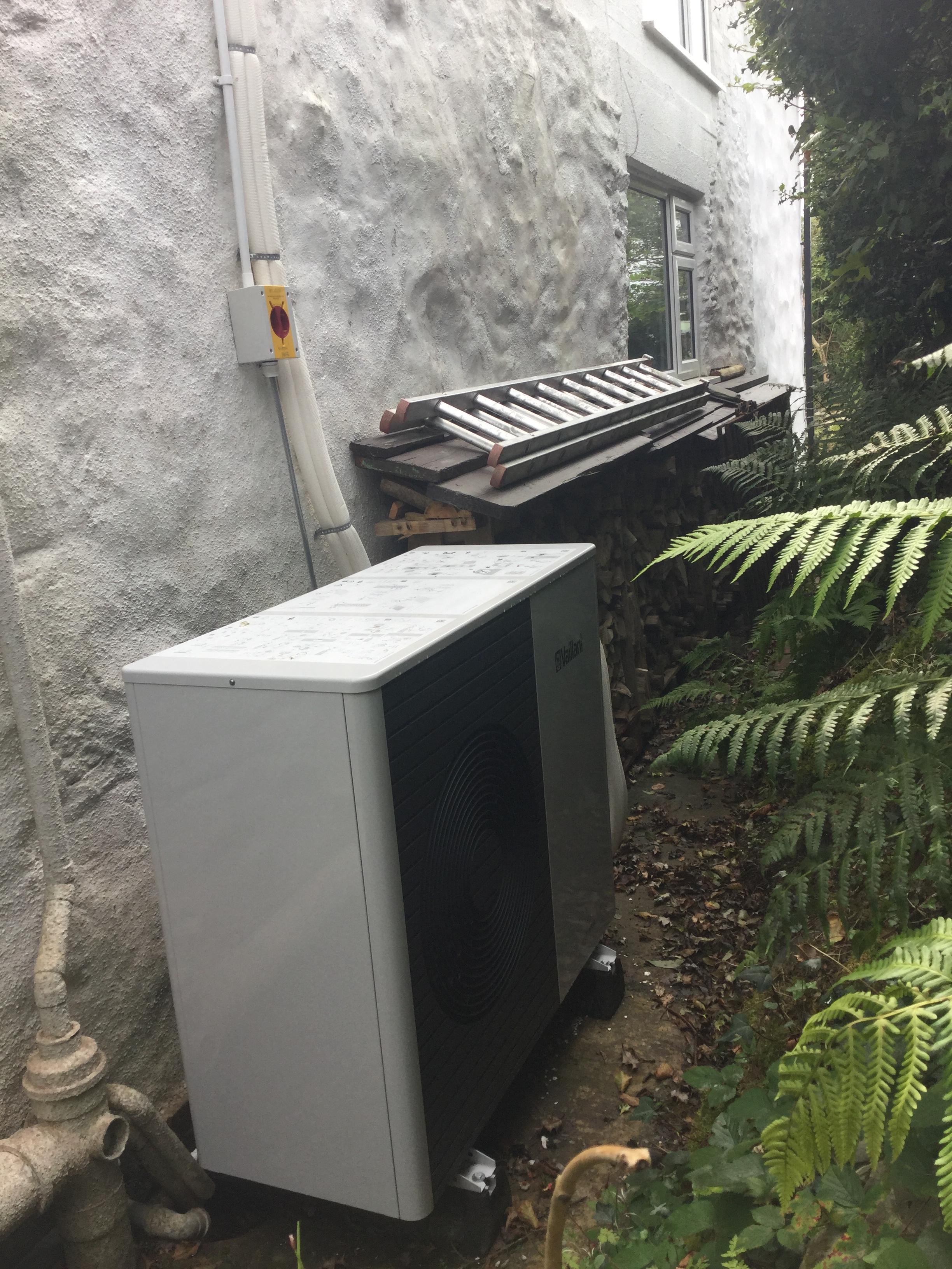

I have to say despite the issues, the vaillant people who've been on phone at tech dept, plus both engineers, couldn't have been more helpful: it is not their fault its been built somewhere else (De) & marketed there too by all accounts: the manual's clearly translated into english so sentences often don't make sense, adding confusion to a ridiculously complicated manual both engineers told me Id never get any sense out of/ not fit for purpose. Trouble is Ive also racked up 7hrs worth of calls, & over 5 hrs of 3 visits. Nearly 2 days' worth of my working days spent.. & Im back at sq1, actually worse with no properly HW. I'm yearning for my old mouse-ridden 25yr old gently-tinkling-sounding immersion tank with no rads at all! where is it? let me fish it out the ystwyth already!
Of course ProDave. Vaillant Arotherm Split. 7.5kW. Thanks for thoughts btw chaps- it is helpful to feel I'm not quite so alone on this/ someon'e thinking on my behalf maybe. Appreciated. Damn tricky feeling hands tied to voice my full opinion, to both installers & vaillant, having the damn thing foc. But if its causing me stress & sleep issues, lukewarm HW & rads cant function properly (unless left on overnight & therefore intrusively noisy in small hrs).. then its undoubtadly a problem with it, not me.
Thank you joe90. Spot on as usual. I even dared suggest to the snr engineer I think said missing info has been -deliberately- withheld too.. expecting an irritated lecture, instead I got agreement. This guys no1 engineer by all accounts, of vaillant UK. I went over & perused all the info I could have before, only having to take a chance it suggests, that the -outside- (looking in diagram form like only a fan) unit created noise. Like a big fan it said, as it is so. I go 5m away in garden etc & considered noise just like the diagram. I conclude its worth the chance > its installed. The noise around here, outside.. is not by comparison, a problem whatsoever. Once the pipework to boiler done, in my spare room, & then it emerges from the box clad in black polystyrene to fit.. my alarm bells go off "whats the black for?" "sound containment" the installer says. OMG. The start of it. But too late to re-site it. Extremely angry I am about this. Especially so having a UT room, away from beds, almost ideal to house both boiler & cylinder, just renovated/ fresh to re-configure WM & a new space now my worktop/ workspace moved into my new workshop (top of WM before!). Maddening. The only silver lining is the damn thing -can- live outside, of course in a weatherproof housing. So, as I hinted to the installer an hr ago on phone, I can only see re-placing it outside as any viable way ANYONE could possibly live with it.
I have said from the top Peter. The fan itself is not a problem. Making even a soundproof container for this unit is totally meaningless. We need not agree on how the system works. I just need to inform you of the two points at which the noise is being created. One outside, one inside. A compressor, and a pump. If the compressor feeds pipes that enter the building, & it is these pipes whereby the sound is being introduced is the problem & cannot be resolved by containing the compressor even in a titanium vacuum whatever; the sound still enters the house exactly the same way & emits its noise at the same point IN the house. It seems like you ate both just arguing for the sake of doing so bc you know I'm not as technically competant as you about knowing how such a system works so you'll flatten me like a fly. I don't need to be. It is agreed by 4 engineers its noisy. There's no debate about it. I'm just informing others of the missing info vaillant should have said (Ive just had my very installer call me, & totally agree wit this very point; 2 vaillant engineers too: but you don't??) to custiomers, so they can site the equipment accordingly. I'm not asking for you to explain how the system works in detail: its not needed for this.
Its not the point ProDave. My old immersion heater made a tad of noise, sure, but nothing to interrupt being in the room.. let alone/ heaven's above making enough noise at 4AM to wake me in the adjacent room. Every house Ive been in, in my entire life has had a boiler emmitting similar feint noises, never in a month of sundays any of it 'intrusive', 'highly irritating', let alone 'sleep disturbing'. I do have a very valid point. Both my installers agree. Both vaillant engineers agree. So much so they're elevating it to being disclosed in the future. Just like Daiiking & mitsubishi do. Its is simply hoodwinking ProDave, not letting customers in on noise these inherrantly will create (as PeterW alludes to/ someone else too, who said anything with a pump with motor in shouldn't be sited bang middle of house). If this noise was just contained to before 9pm & after 7.30 am its one thing (tho still far from liveable with). Mine goes on/off/on 4am, 6am.. you imagine being woken like so in your house by motors in your adjacent room? its simply 100% not acceptable, in any way whatsoever, or, just conjusive to be in a small house spare room at all: put it in a soundproof container.. maybe yes, but whose gonna fork out for making that?
Ok we agree then (we just call it different things/ it matters not) but I know the outside noise is catagorically coming from a heat compressor (when its on it says in the Live Indicator "heat compressor active"). This is what the engineers call it. The fan sucks in air > it is compressed > made into X > then, fed into house. Its irritating noise, most of it, is heard once its entered the house, via the pipes. 10% of its noise enters house directly no, but from the unit itself (not thru 2ft stone wall, but up & in thru window: your ears tell you so).
This is my main grumble with vaillant. The only info with noise-related xyz (diagram of a fan in a box, & ascociated dB figs) relates to the outside unit. Both engineers agree hands down I have a valid point: so much so its been fwd'd on up & may very well be included in a revamped pdf. Sound meters are totally n/a if there's no info to compare anything to. Him getting his meter out & saying 'fine' is meaningless. If it wakes me in the next room, its excessively noisy/ end of. The snr engineer agrees with my points on this, even with meter in his hand.
If the heat exchanger is in two parts, 6m apart.. then yes I agree. But if you are suggesting one unit is solely resonsible for the noise, then no.. as Ive said the noise is being created at two distinctly separate points. One outside, one inside. The heat compressor, and the pump.
Hi Peter- maybe pipes not perfect.. but far from my concern. I realise its a big fridge in reverse, but half of it afaik, the compressor I know as definite, is outside.

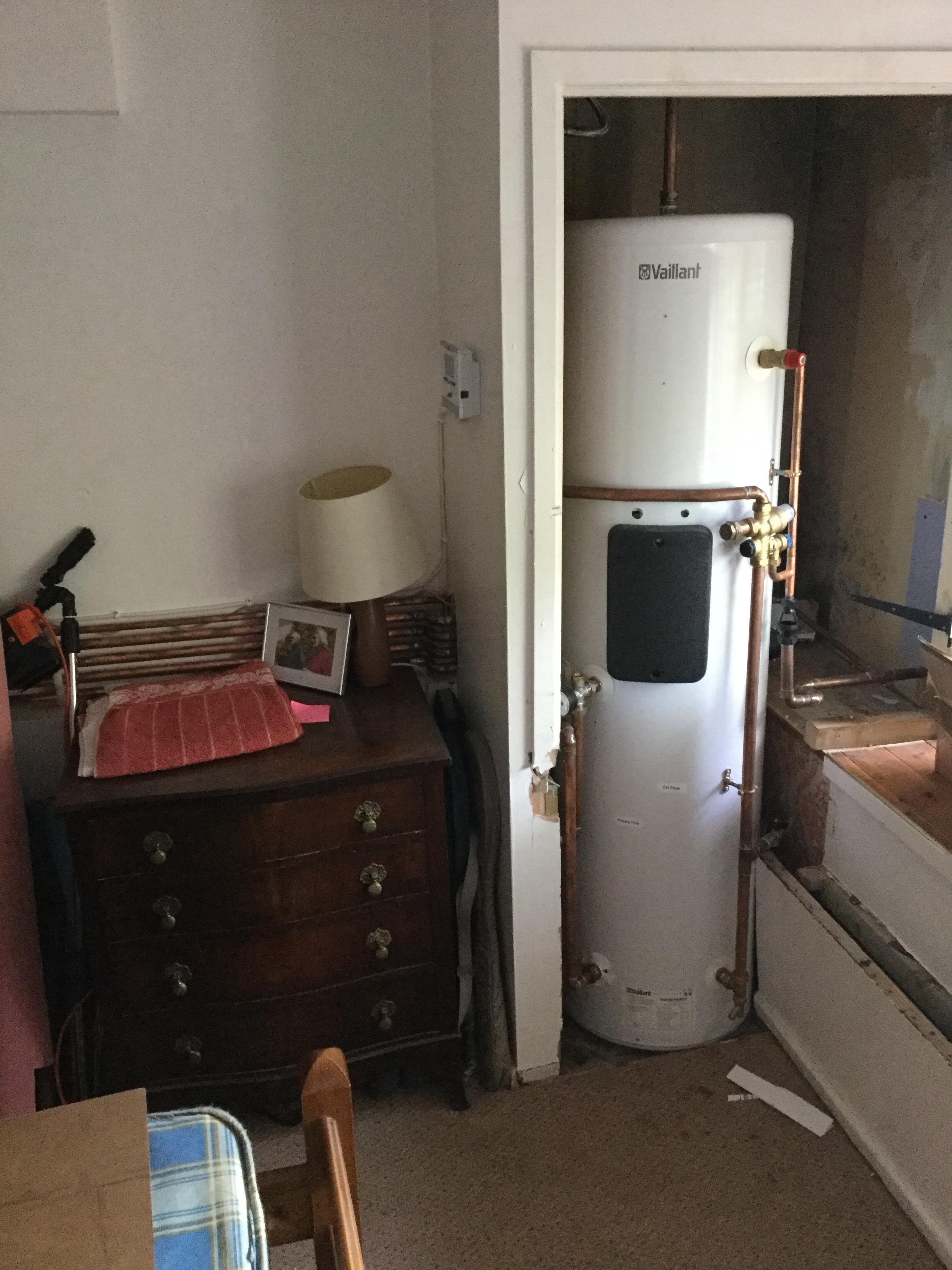

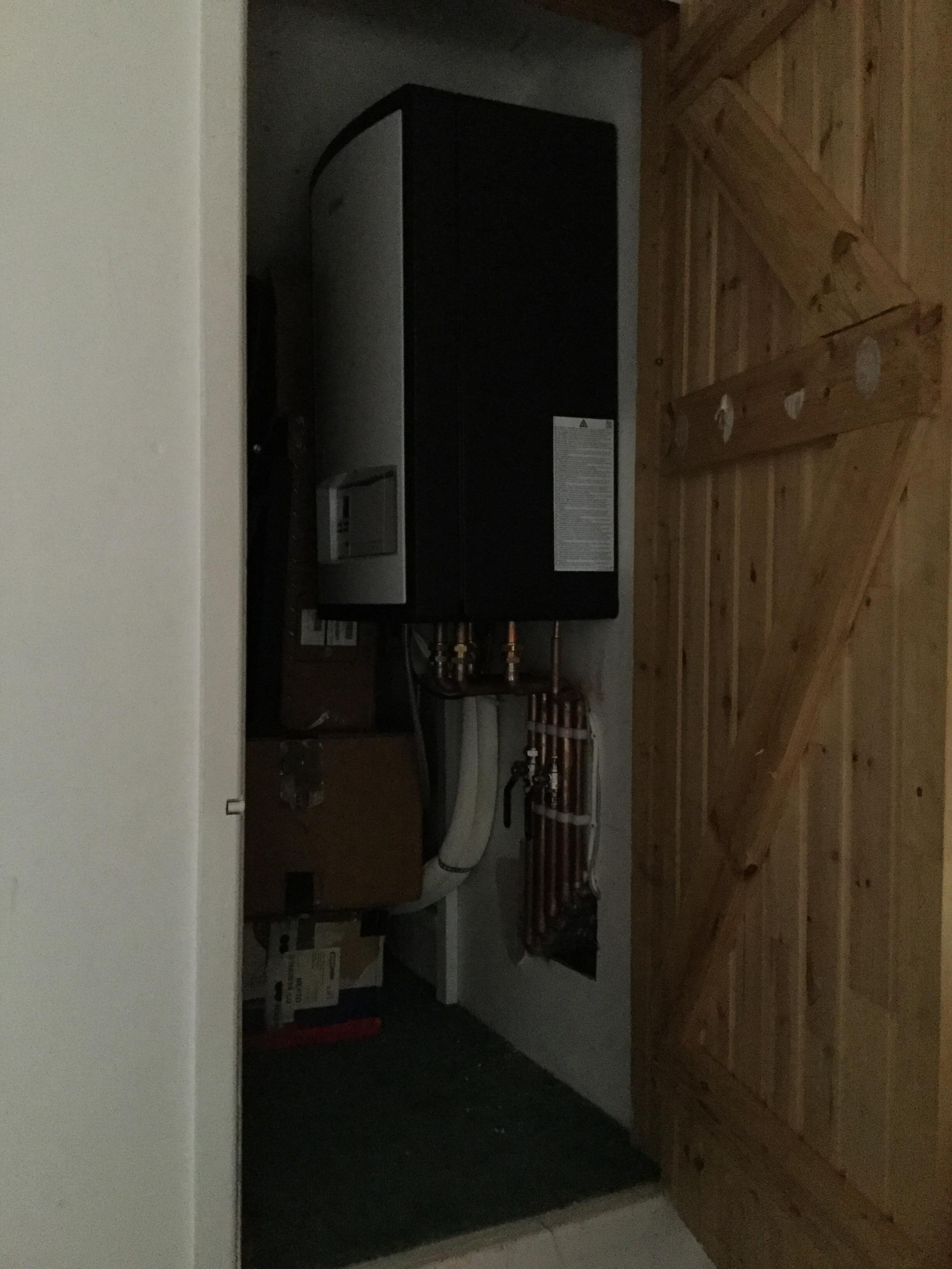

The 1st Unit is the main problem, Compressor noise coming into it, then within it.. and also its pump within it, then onwards to cylinder. Even pipes onwards the drone is heard. cylinder does not produce any noise, but motor noise is heard at it too eminating from the boiler pic1. the outside fan plus compressor unit: fan is aggreeable in noise terms (the only thing vaillants pdf tech info purports as producing any noise, ie a diagram of a fan in a box).. but its compressor tagged to its side is anything but agreeable: so much so its easily heard 20 m away on road outside.. and as a vibration device, produces 'pools' of noise patches all over inside and outside.
@ProDave hi there, uselful reply thanks. Firstly I'm in catch-22 land as its a govt grant thing. Secondly Ive had 3 engineer visits, 1st to change a part (error code ?) not giving me huge confidence, 2nd to go thru all settings to try to alieviate/ minimise the noises (only partly success: just put in a '10* set back temp' low enough so it keeps bloody quiet at night until my rad ons @ 7.30am; tho it woke at 6am 2 days ago), 3rd visit by snr engineer to go further into it to try & reduce compressor settings (useless 2 hrs- just as noisy as b4). The noises are from 2 places. From the compressor outside. And ftom the pump inside. The compressor feeds 2x flexi pipes > enetering the house. I get most of the intrusive noise it creates within the house @ the place where the pipes enter (wall) up to where they finish (boiler). So a 3m passage of noise. On top of this, I hear the compressor outside, through & in likely the windows upstairs. So a double whammy of compresor vibrate-droning here. The other noise (a higher pitched motor type, the pump afaict) starts in the boiler > then is carried onwards to the cylinder. The two noises (compressor & pump) 95% of the time coincide. I have reduced them to stopping at 9pm. But, the motor/ pump does some cycle on-off-on 1 hour thing on its own.. without the compressor too.. at infuriatingtimes like 6AM. Or 4AM. For a full 1 hour. This is not only loud enough to wake me (a heavy sleeper) but so repeatingly incessant, seemingly the cycle it does over 1 hr or so, as to be impossible to get back to sleep. Like having a car engine start/ stop on/ off on outside your window to deliberately prevent you from sleeping.
2 points to this. 1, having a clearer picture of how they work (2 months installed) I feel again the need to warn about them, or rather my vaillant one which is an utter disaster. 2, whether someone can help with a basic setting. -- As I mentioned before, noise inside (not from the nice purring fan outside), is bad enough not just to be intrusive but aggrevating & impossible to live with. Noise eminates from the heat compressor outside > fed inside > to boiler. Loud enough to hear chiefly inside, but also can hear it outside from within house too. Noise eminates too from the pump inside the boiler > fed along pipes to cylinder. Both are on continuosly when heating on, & also during HW periods. Also the pump alone, engages on/off/on/off intermittantly 3mins/3mins loud enough to not only be heard 2 rooms away, but also overnight so much so its wakes me up in the next room through wall) & infuriatingly so bc it does whatever its doing (not even the engineers know).. for min 1 hour: this is the worst, most intrusively interruptive noise Ive heard in my life, as bad as the worst hotel for eg. Not neccessarily the loudest, just the most disruptively annoying. I had managed to minimise the night noise intrusion, by setting the "set back temp" to 10*.. & ending the heat period at 9pm. Just so I could sleep. With the big caveat of not having any heat in house 1st thing AM (as I am forced to start the heat cycle coinciding with my alarm, 7.30). The added disadvantage of this, is unlike evening when I can ramp the temp up from say 18* daytime 'lukewarm' house setting to 21* by turning a knob, then 1 hr later noticing room warming & rads up to temp, because its had to be put to '10* set back temp' overnight, it takes twice the time to get rads up to speed. So, effectively useless if I want to leave house at 8.30 for eg: house still cold. But also, a few days ago the pump woke me 6AM for its infuriating on/off/on 3 mins awfulness. So I have no confidence going to bed it'll be silent overnight at all anymore. So I'm on tenterhooks sleeping = stress. In conclusion I know only now, that the system can only work, & is only designed to work thus: it has to be in heating mode 24 hrs a day, which includes overnight periods the rads will come on albeit less frequently than the 'heating periods' we all like (for eg 6.30 am-8.30 am and 6pm-9pm), in order for the rads to work properly. IE it -has- to be continuously in standby mode dipping in & out to feed the rads 24/7 including overnight just as the day (there is no extra 'night time' setting available). This might be fine if A) the boiler & cylinder are sited well away from beds, and B) you like warm bedrooms overnight, & C) one can afford to run the system 24/7 like so. But for me.. its not fine at all & a total disaster of a design. If I had a wife & child, child using the spare room the boiler & cylinder are in.. it'd be worse: this room (Im told where most go, replacing immersion heaters etc/ old systems) is totally useless even in the day, ruined by the intrusive noise of the equipment. -- I also have only warm-hot HW. It was hot & a great temp, but engineer came (refettling stupidly complicated system to try & reduce noise- to no effect) I think lowering the HW temp a bit. I am tearing my hair out with this pathetic designed system. Pathetic. German too. zoot

Sorry to harp on.. but more noise issues with my split ASHP. For some reason I'm noticing -alot- more outside compressor noise (the box outside) so much that I can hear it all around my house exterior in fact & very irritating too, 20m away its intrusive for eg, in one spot as its a vibration thing there are resonant frequency 'patches' where its really prominent. the fan is fine. Also some of this noise is being transmitted out & in through the windows (a floor above it) into my upstairs. So I have this damn compressor noise entering my house A) via pipes > boiler > transmitted along pipes > to cylinder, & now B) externally up & in through window. And a motor within the boiler noise too, totally separate/ often both in conjunction. Right now in kitchen I have an incessant background drone & its unliveable with. And the frequency of the damn thing firing up/ off/ on/ off will only ramp up when its cold.. its fairly mild now. Omfg.
