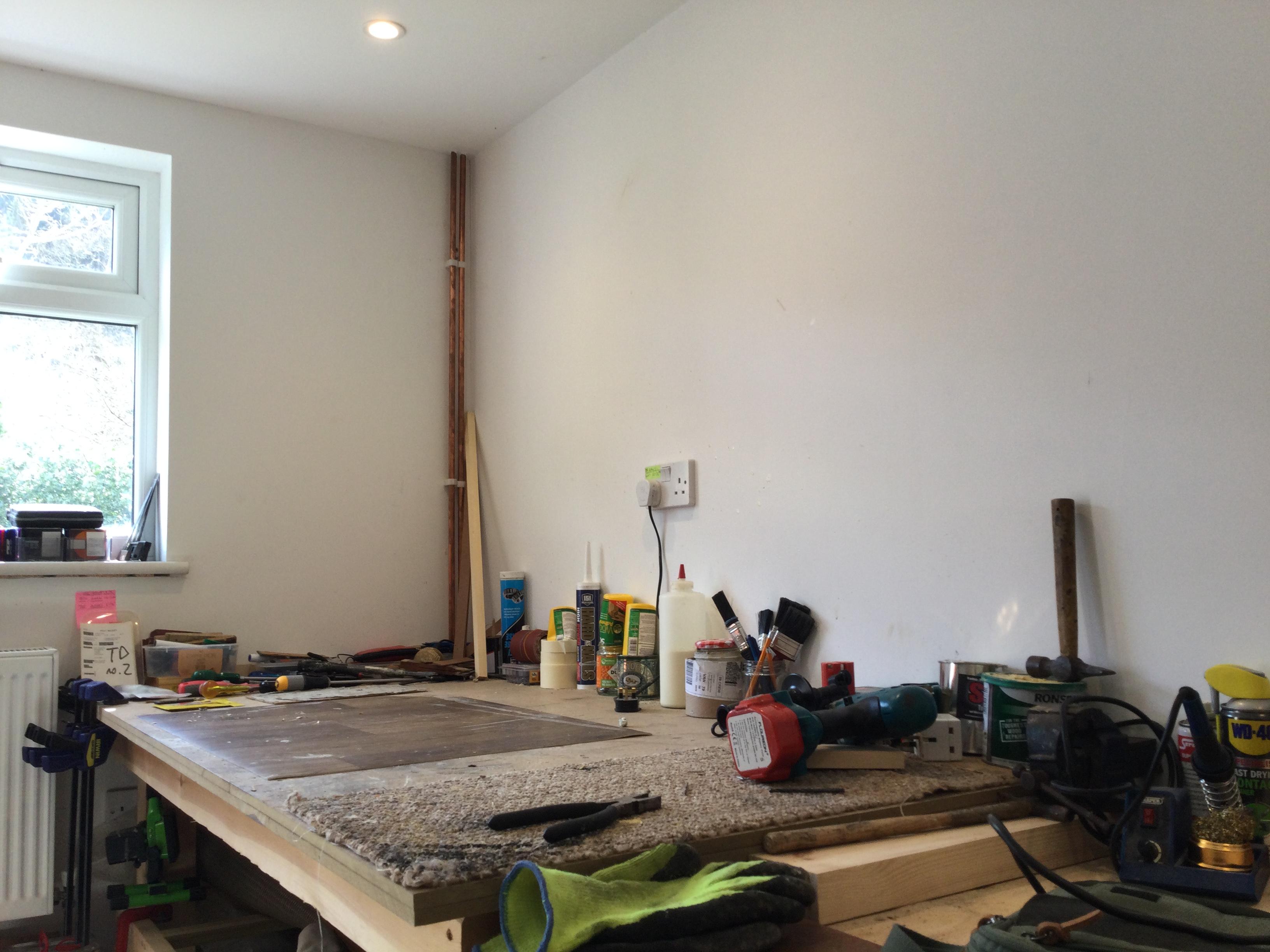

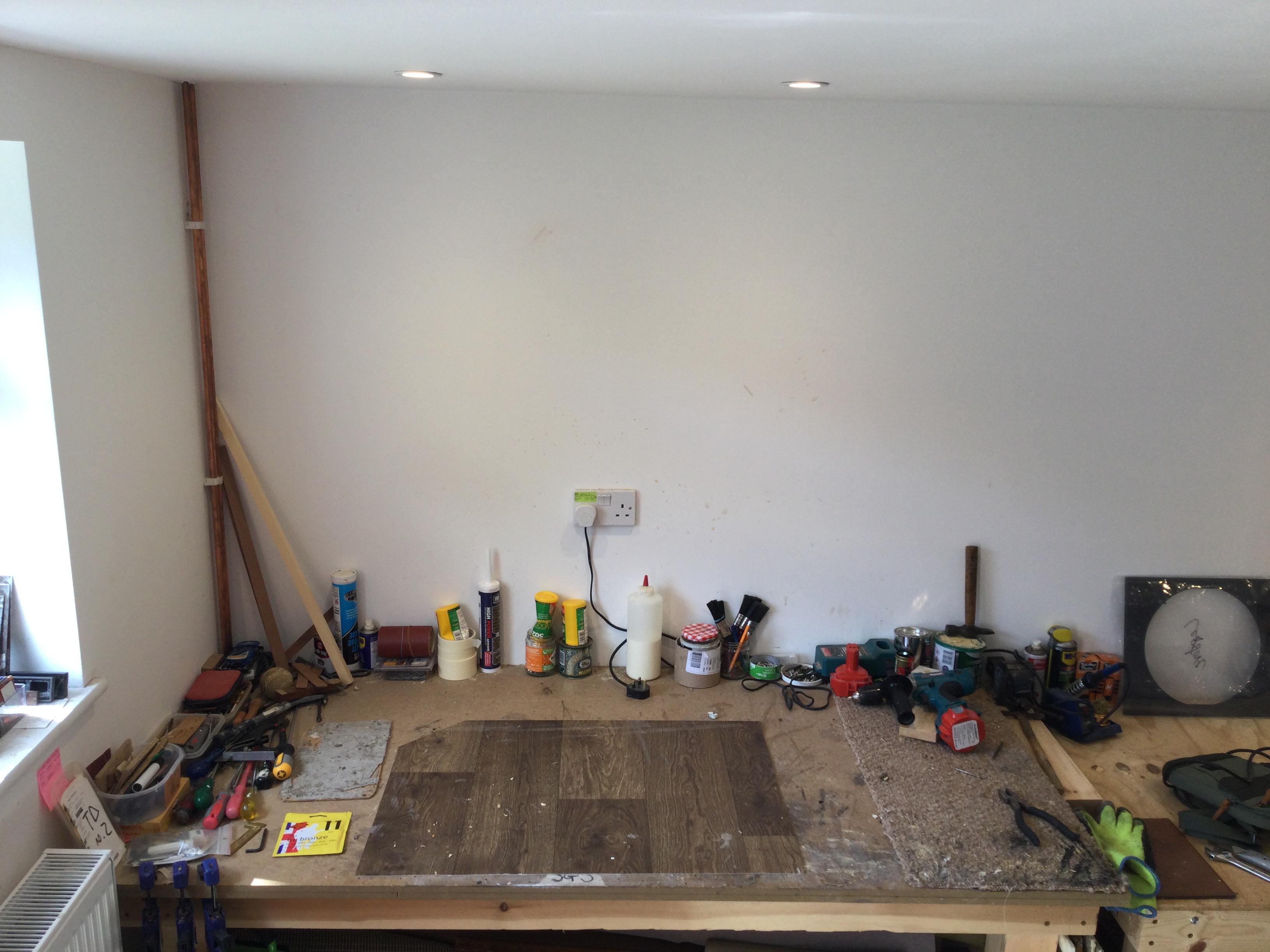

  20. Hmm.. ive made all my 26 copper pipe standoffs & painted the board now cut in two. The " im really nails" gun adhesive stuff or wtf its called Maybe.
  21. Not following sorry.. the prob i have is I can't access the back to put the standoffs in. So they need to be firmly fixed to the board, presumably with screws in them too ready/ which means filling them with something non flammable, then attatching all 13, without knocking one off, to then carefully screw each in. Unless Im not thinking right.
  22. Hi there Tennents.. hmm but bluetack might be flammable? Gives me more room to think tho 🤔 I need a heatproof'ish summink to shove in my 20mm copper standoffs to jam the screw in.. i think.
  23. Actually I would advocate a handsaw.. less dust surely & only 5 mins/ done. And my copper pipe stand-offs done. 20mm, most of an inch gap behind then. Forgive my idiocy.. but how can I get the board screwed to wall with the standoffs between? Surely I need to drill my 13 board holes & then glue my standoffs over the holes on the back or something.. then flip over/ offer up/ screw in -? Thanks, zh
  24. Hi there s.a.s.. don't think Ive had a reply from you before/ appreciated. So just goldscrews for eg, I mean nothing specific needed? Thanks, zoot.
