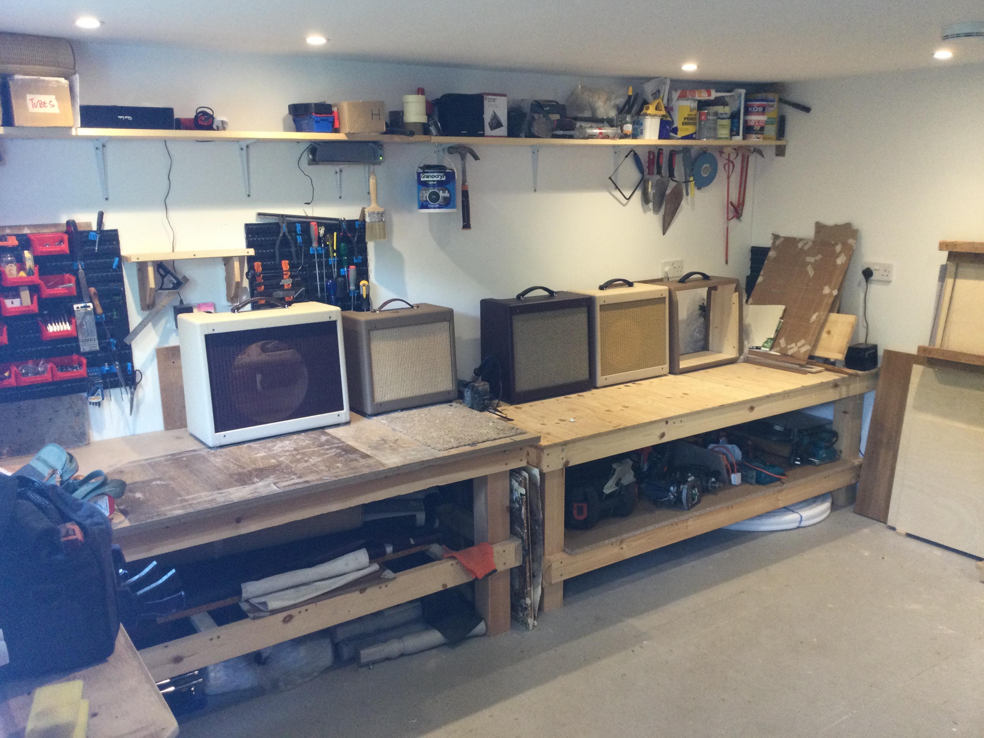

  7. Last photo showing, at least, this 1/2 of workshop complete. T'other 1/2 a jumble of stored xyz / will come back for ideas on this later / a future thread maybe. Thanks again- zoot.
