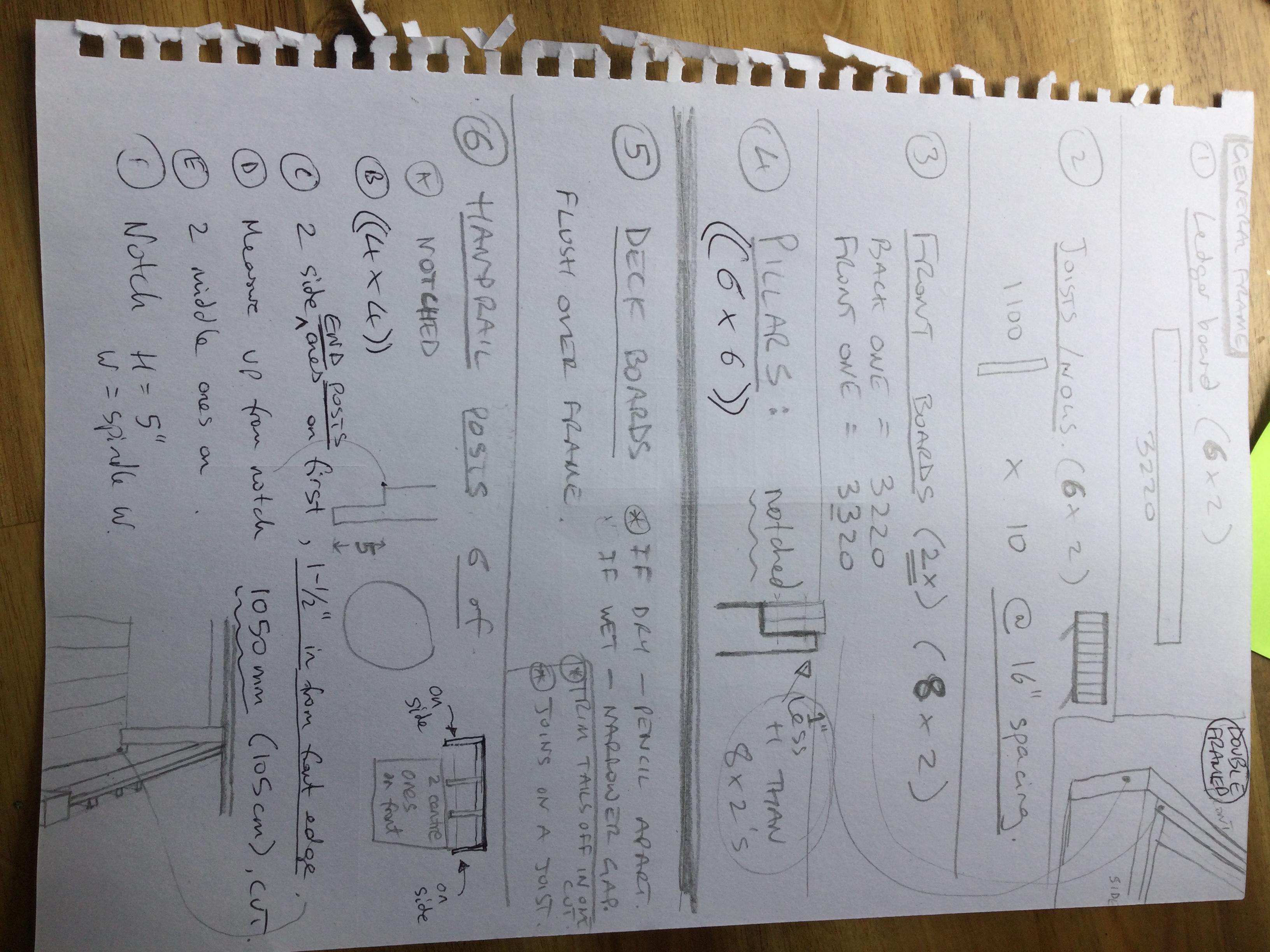

  2. Ahaha! Got it. Right so this is the ( main) reason to 20mm flat bit the render away.. to find the start of the block. Bingo. Unless I hit the block's mortar. Hmm.. would the doors frame, actually it's placcy cill ( which protrudes.. I'll ask about this later/ note to myself) likely be sitting upon a full block layer-? If very likely it is, then I have a good chance to aim into block. Ok prep a step forward. Maybe I could do this ledger board ok then. Fab help Peter. Thanks, zoot.
  3. Hi Peter. Thanks for this idea. I passed it by earlier/ didn't see it. I pretty much understand it. Mostly. Conduit.. is heavy guage metal pipe? So cutting this would need some chutzpa is my first concern. Im only partly on board though. Do these conduit bits hang on the studs prior to placing the ledger board over & on? Sort of like my standoff heat stove barrier? If so, the thing that I'd surely find trickiest (however this ledger board is fixed) is due to the wavey wall, getting it fixed on perfectly vertical. In order for the rest of the timbers to sit correctly, & the deck level, getting the first main board onto which it all attaches vertical (& level too).. seems really critical. I just don't see how I can do it, even measuring say 8x individual conduit bits for their individually deep places. It's gonna rock, its never gonna be vertical. However good I do this idea. Each wavey wall 'trench' you see.. is slightly different. Thanks Zoot.
  4. @Onoff great help there. Come to my rescue again! The ledger board's solidity, I'd assume dependent upon not hitting the block's mortar.. & not going all the way through (or the fischer gubbins will fall into void). And the 'pacific ocean' render: on the 1st wall face, thankfully the front of house, Mr. Render did a cracking job: subtle contouring (blends like a boss to adjacent old stone cttg shell). But he went a bit nuts on the 2nd & 3rd. 2nd = my balcony face. In retrospect I should've asked him to smooth a 6x2x4m ledger board area. But had no clue at this stage. Resulting in a very wavey 14" x 2" high "waves". Me, attatching a ledger board to this, well... not a hope in hell. Both of these 'tricky' aspects then, plus the legs holes idea (finally understood!!) fairly critical re placement & leveling/ plumbing.. makes this too tricky for me too. So it's sensible to get in my pro chap to do these two important jobs. Then I'm away. Thanks. Zoot And the

  7. Just to say I am doing as much as I can in prep (pic below). The ledger board being fundamental it seems, due to my wibbly wall is proving a tricky prospect/ 1st hurdle. I just don't know how to tackle attatching it really fully securely. Ideally obviously, this (6x2") x 3300mm section of wall should really be flat first. How to flatten it then. Either I removed the 'hills' somehow ( seems a b'stard of an idea), or I raise the dips & add render or whatever, to form a flat long rectangle ? Is this adding idea feasable? Thanks, Zoot.

  20. No I didn't trespass.. taken from a very convenient close side road. Anyhow SO obviously a holiday house. I did snooping only yr honour. @joe90 Dims (firm) are: L 3320mm x W 1250mm These are what I have PP for; well, what I have PP for is more/ steps too/ like this..
  21. Well on my PP drawings it had the steps up, so I am guessing a bit right now @ L 3200mm.
  22. I'm sure it will. I think I might have put in for even 1300mm, being tentative thinking I'm never likely to get PP for it.
  23. I have this underside photo eg, giving me idea of the longwise beams A to D. But it seems to have no beam A.. but instead 2 side vertical struts fixed to the wall, up @ balcony level.
  24. I have Joe90's idea of beam A here. And some form of a frame here A,B,C,D.. but this doesn't follow the photo eg. Tbh Im stuck at the first fence! As how could this frame be supported, so it needs 2 pillars before B, C, D.. maybe.
