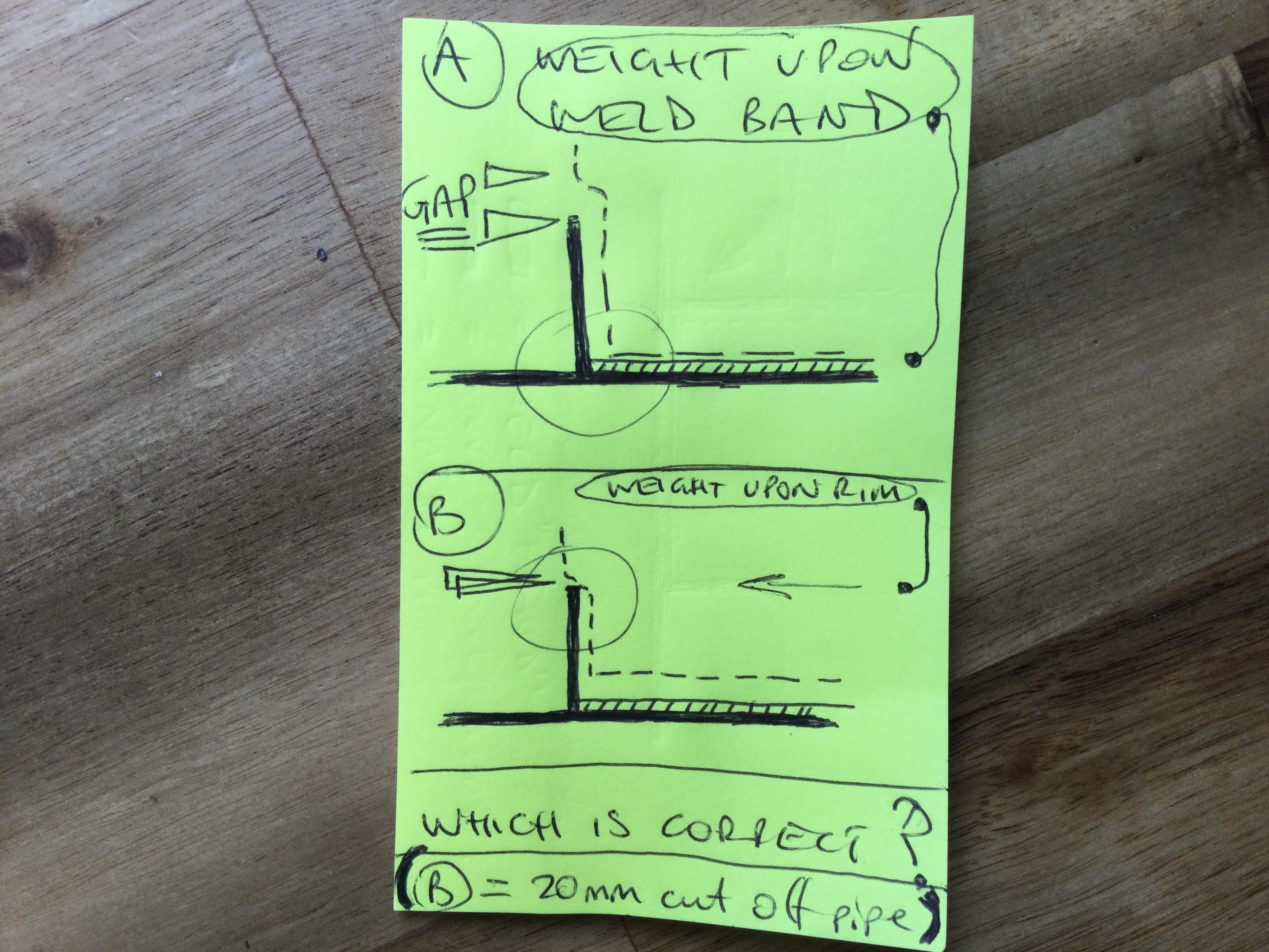

  1. Ok I need to simplify. Step by step Q's. This job looks simple in principle.... but it is not, with the 4 sections I have. Q no.1. If I simply offer the single enamel length, into the stove collar, it hits a band of weld ( stove makers' collar join to stove top). It rocks L to R I'd say a full 8" at the top. So if I let go, the weight of it is resting on this weld join. Is this correct? zh.

  6. Hi dpm. Ive tested it upside down, to see if the female larger end will fit into my stove collar... but no, its a bit to wide. Now your idea of cutting though, tallies with what I can think is the only way my enamel pipe ( male end) can sit inside the stove collar & its weight resting evenly upon the top lip of the stove collar. But I don't know if this is the way these two sections are meant to join. I only know that obviously one slots inside the other. If you enlarge my sketch, the length of the male end, & the length of the stove collar... are good for explaining what I mean/ one is a little longer than the other. Ideally I need them the other way round: the collar longer than the pipe... so... it sits evenly, resting upon the top of the collar. Surely this is the optimal way these two should join. But I don't know tbh. Cut an inch off the enamel male end? Does anyone know what I'm actually trying to explain? I bet not. Thanks, zoot.

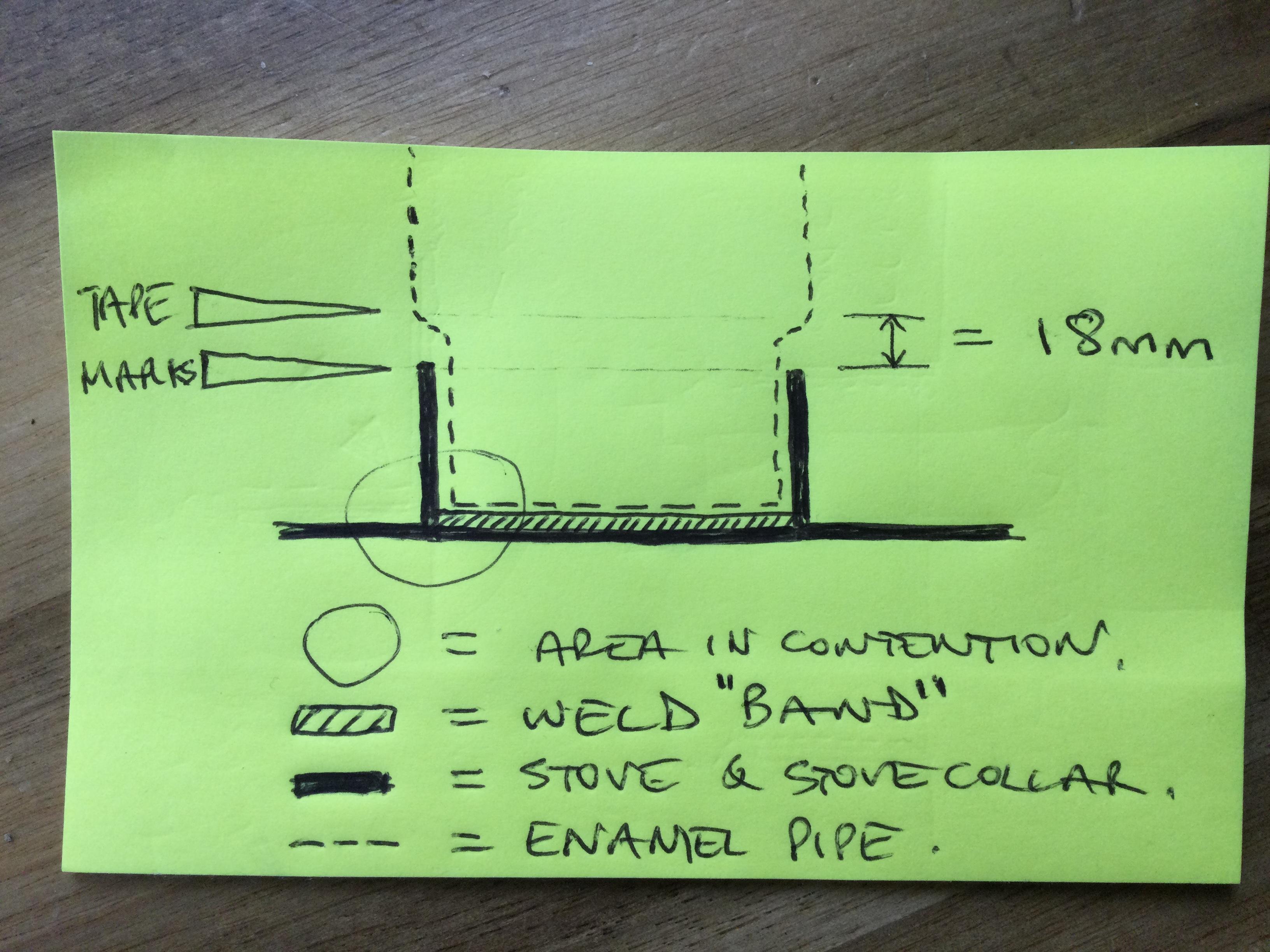

  7. I have some standard stuff, a tub of Koss fire cement. Does the male end of the enamel pipe, need to " rest " on the lip of the stove hole collar section? One thing I notice, is this male end is 1" longer than my stove hole collar which as expected is welded on, & the whole pipe sits unevenly upon the thick ring of the weld. So, my pipe doesn't rest on it's lip. It's a facet of the stove being very 'handmade' that both the hole seems a tad too wide, and, the welded on collar section isn't high enough for the pipe to sit neatly resting on its highest edge. But I bet what I am trying to say here isn't comprehensible. ButI can't explain it any better. Zoot.
  8. Hi Peter. Yes it has the shaped 'male' lower end, I sort of tried to draw this narrowing of it at A). But it's just either slightly too narrow (the dip in/ shaped end almost dips in a bit ott)... or of course, this is fine but my stove hole is judt slightly too big/ too "safely made". Im just in no position to know which it might be, nor whether either is in fact problematic at all. As I have no reference to look at. It could be that each is as should be, & the cement makes it a 'tight fit'. --- But point B)... there is no narrowing of the adaptor, no shaping 'dip' inwards, just the whole section of it that slides into the enamel pipe top, is similarly "loose" a fit. By a few mm's. It's this join that concerns me, as it seems the seal between the two seems to be made simply by the weight of the adaptor/ twinwall/ hat (this whole formed section all banded together well) just resting on ( albeit within) the enamel pipe. If any tiny rocking here... smoke will surely escape into the room. If I put 3mm rope around, it will disintegrate after a while, & I have no way of telling if it has done so. Because I cannot see it. Zoot

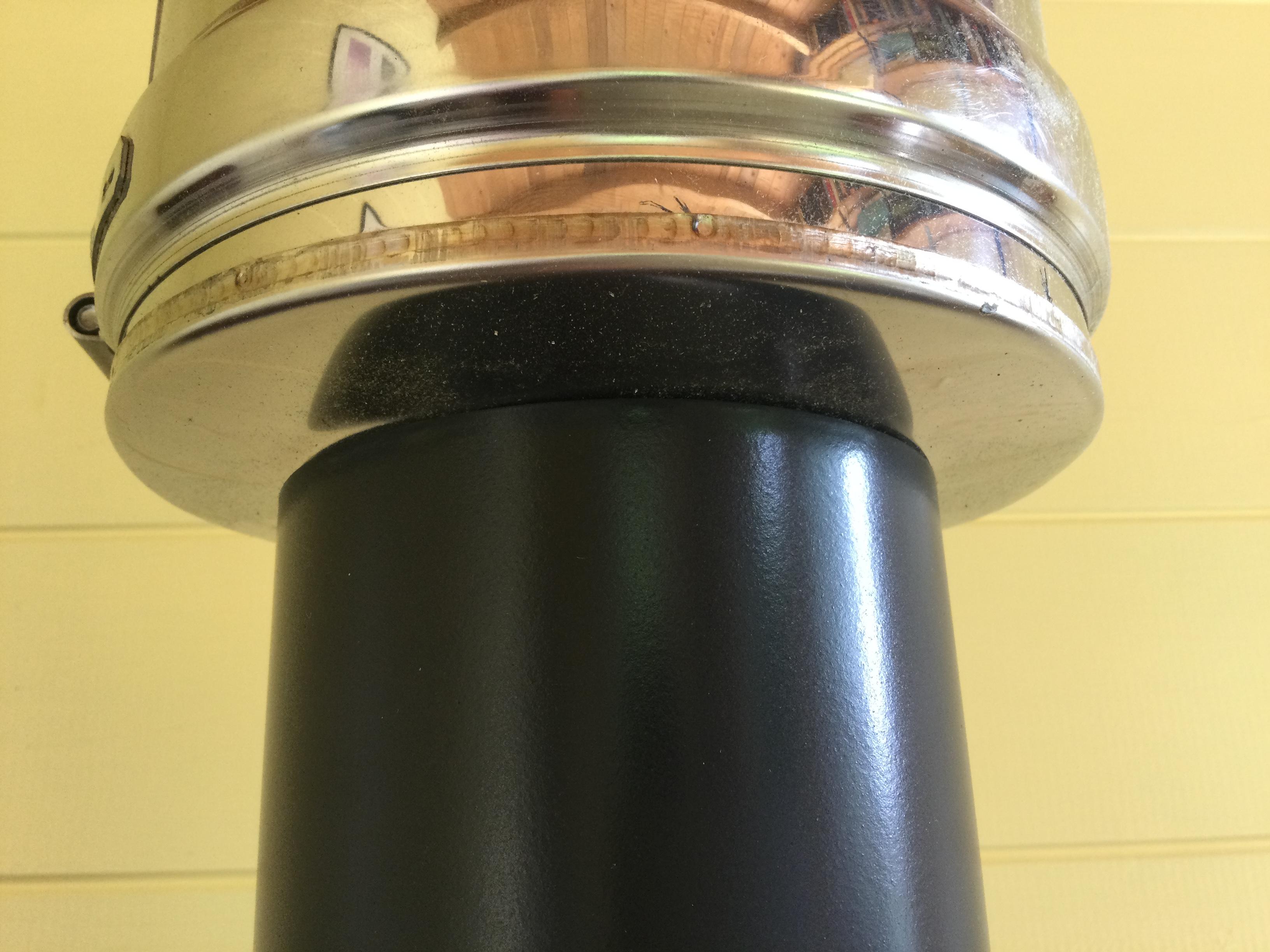

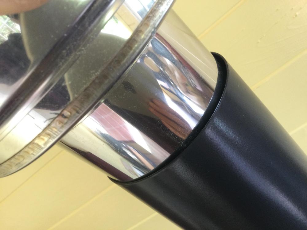

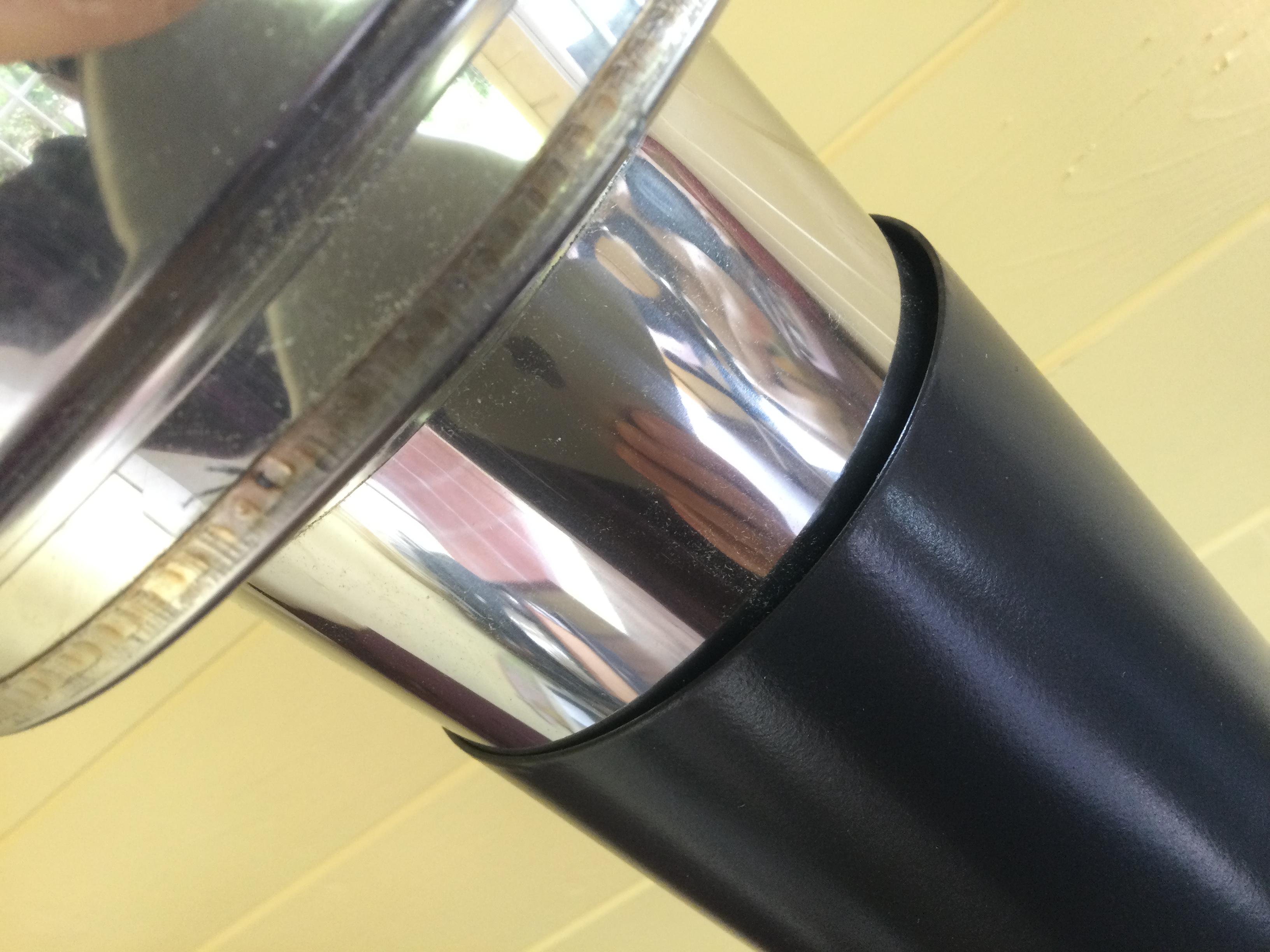

  10. @PeterW Just to reitterate. I bought a single flue diameter 4", 1m length, going into the stove ( fits, but loosely, a 4mm gap here). Then an adaptor to twin wall. Then a 1m twin wall. Hat. It seems the single length is too narrow at the (lower end) male end. And it seems either it's other female end (higher end) is too wide.. .. or the adaptor's ( into which its top end fits around) lower male end is too narrow. But I just don't know what to expect/ what is normal/ whether these fitting together are all fine, or totally not fine at all. Zoot

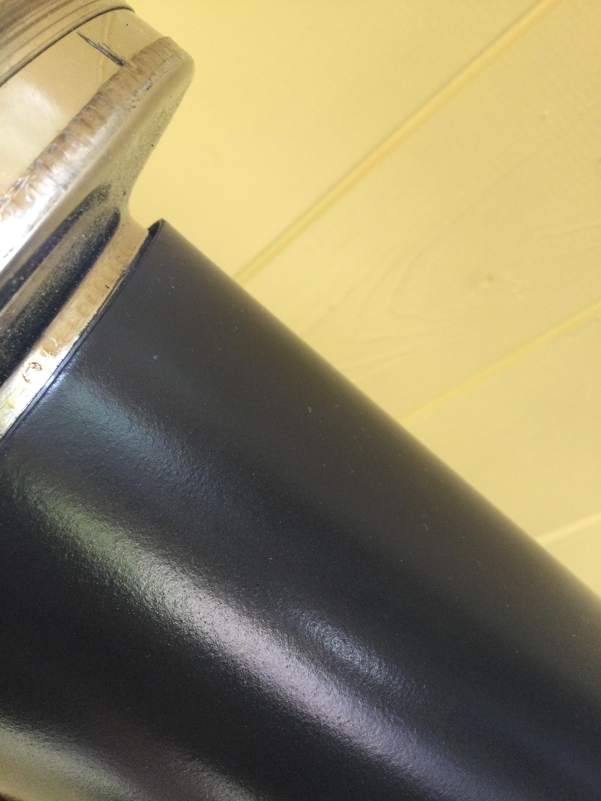

  11. Hi Peter, it's not at all this seems the problem. Ive got another 4mm gap ( 2mm all around the adaptor's downward male end) here. There is no band tightening these two, because the outer layer here is the very solid single enamel flue. So, how I join these two.. I really don't know tbh. The only thing I can think of to do, is add a wadge of cement around the adaptor, like a ring around the uppermost part of the downward end... then just sit the heavy twinwall sections onto the single & let gravity do the seal aided maybe by the cement, but not very well surely, & will just crack & fall out soon. But I cannot see. The three silver twin bits, adaptor/ 1m/ hat, do join together fine with supplied two bands. A photo I don't think can help as the single just covers over the adaptor, outside of it. I spent ages on call after call to get certainty these 4 bits would fit together, buying all from the same place, costing me a fair bit more to source from one supplier. Hmm. Zoot.
