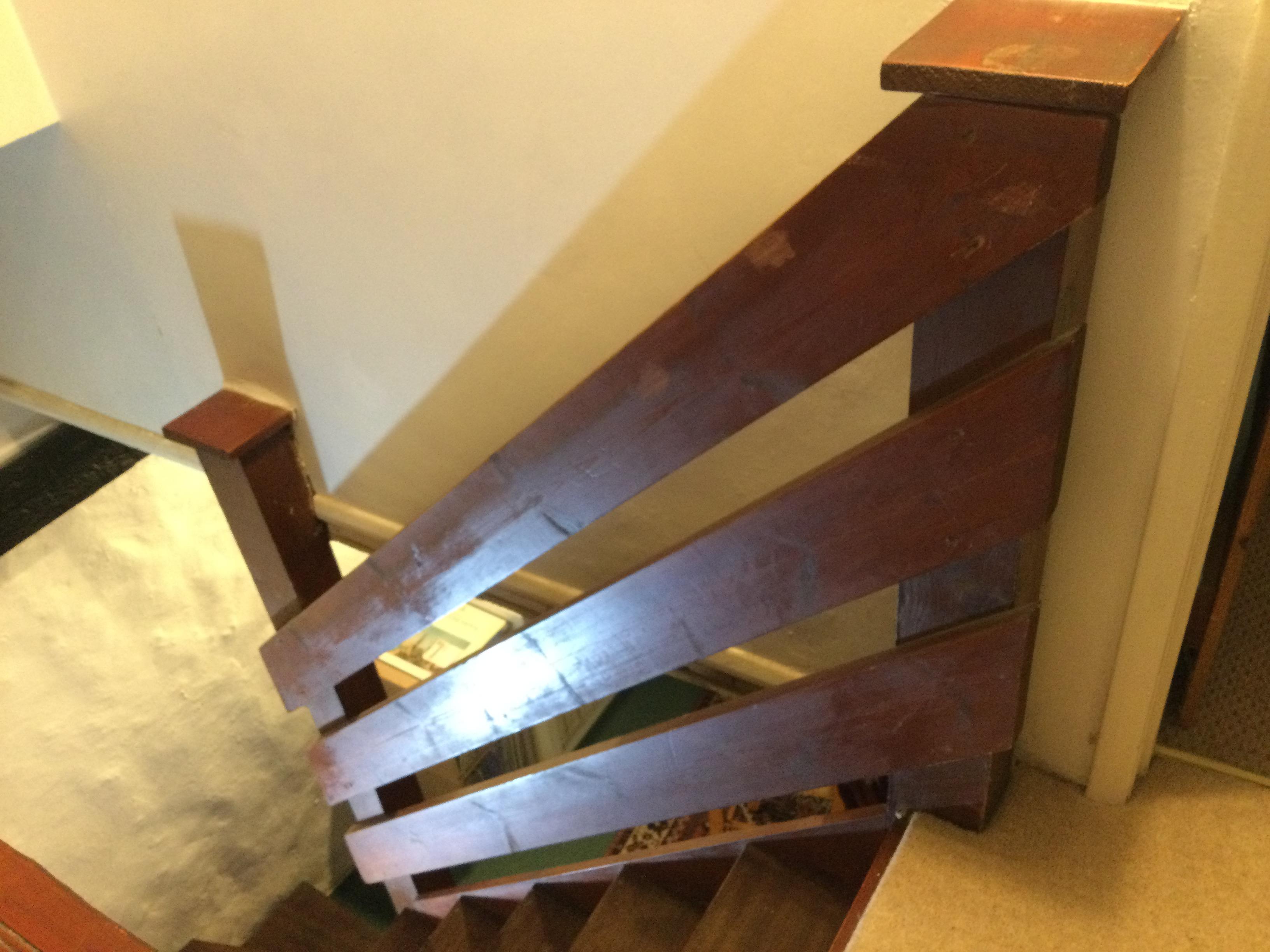

  1. Lord knows what farmer giles' plan was here. It seems to be joined.. but is it/ could it be supportIng the ceiling at all?

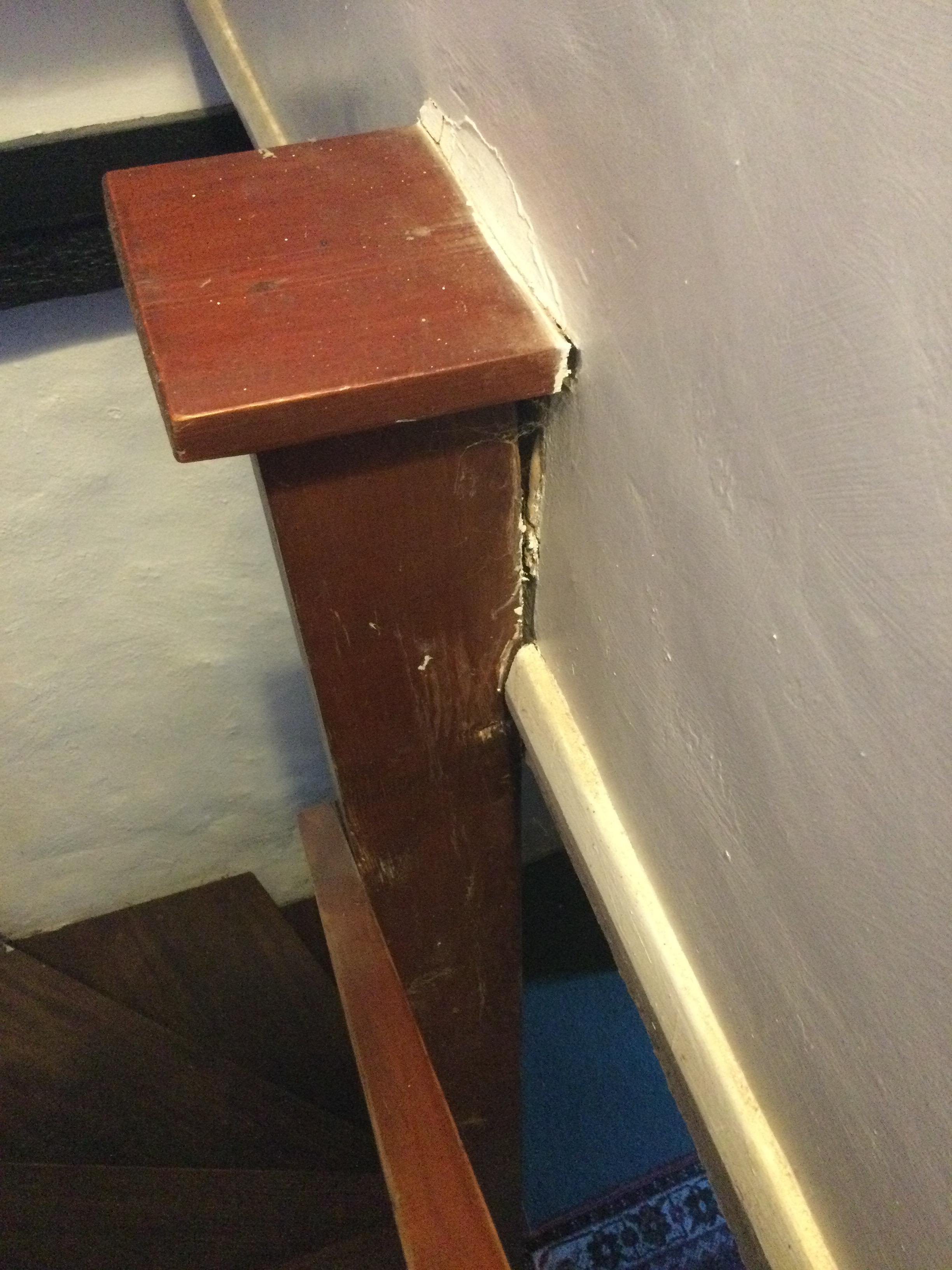

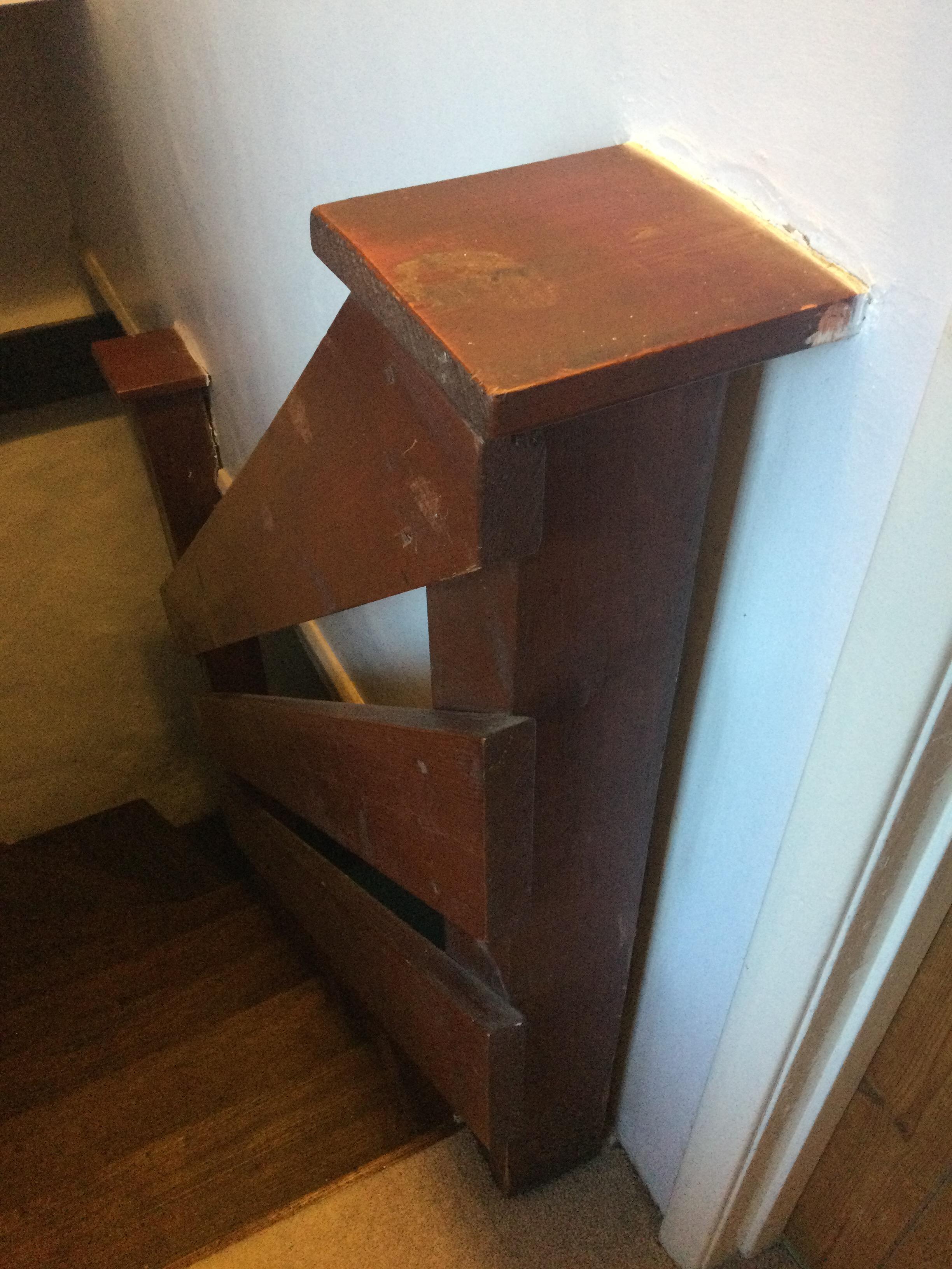

  3. Hi Onoff. Have been trawling similar sites for these type of replacement bits, these look good: limited here but should be ok. Its really the revamp plan. If you can see my post pic2 above: the main tall one going from ground up & joining in an awkward way, to some bad architrave & fixing (no idea how or why.. ceiling support-? ) to the side here. Its 1st what to do about this post. I think your referring to the 'centre post' being the upper shorter one? I think this might need just a new nicer cap: simplest bit of the job. Pic1 above. Thanks, zoot

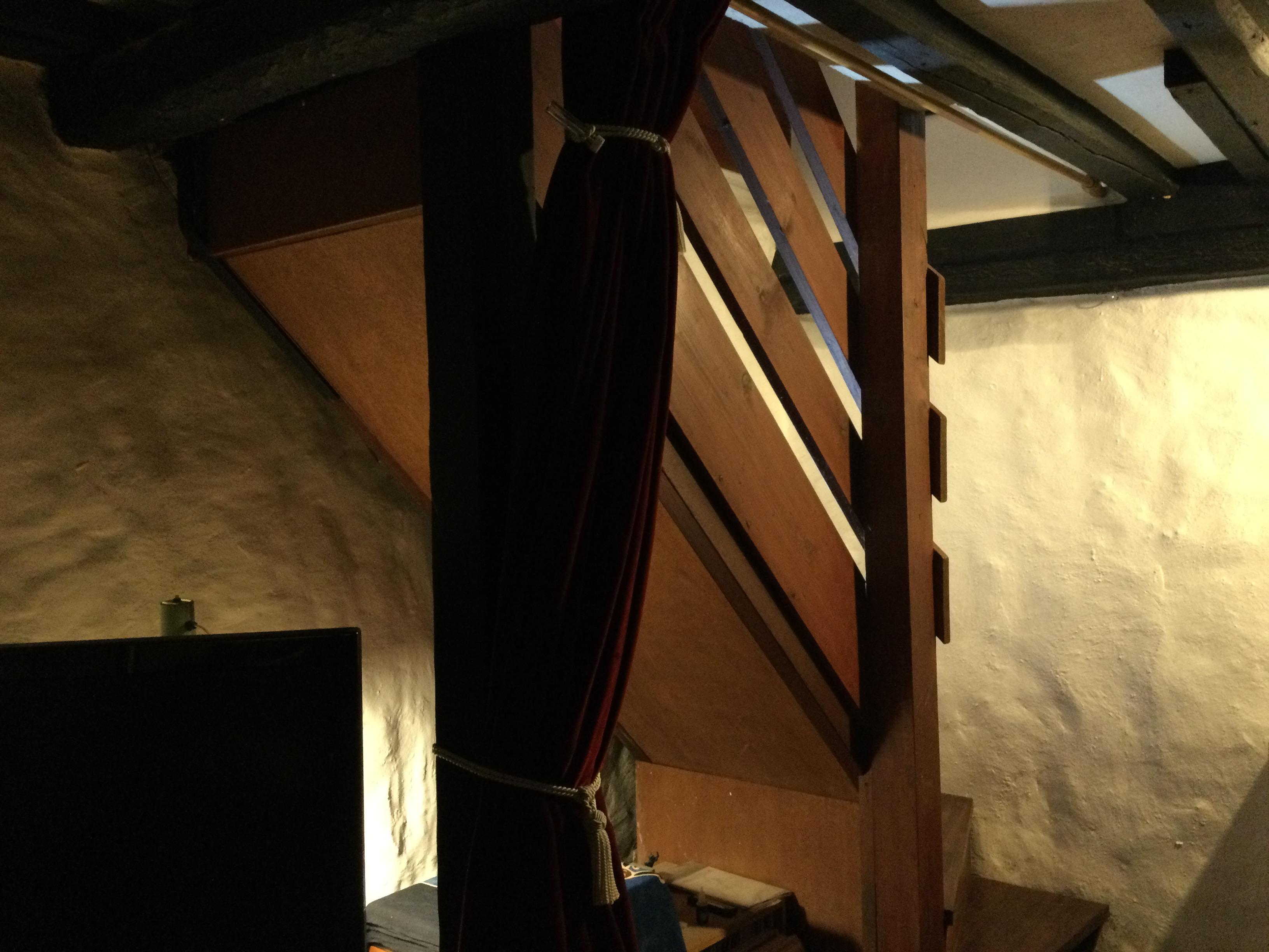

  4. I knew someone would say this! ( my ^ pics make it look far better than it is.. my f'arty lighting i think ). The hardboard on back & on vertical step bits are badly fitted , rattle. Huge step gaps to inny outy old wall (but not much I can do here). It really is just cheapest way done. tatty too like this ( especially pic 2) where it seems to join with ceiling for eg..

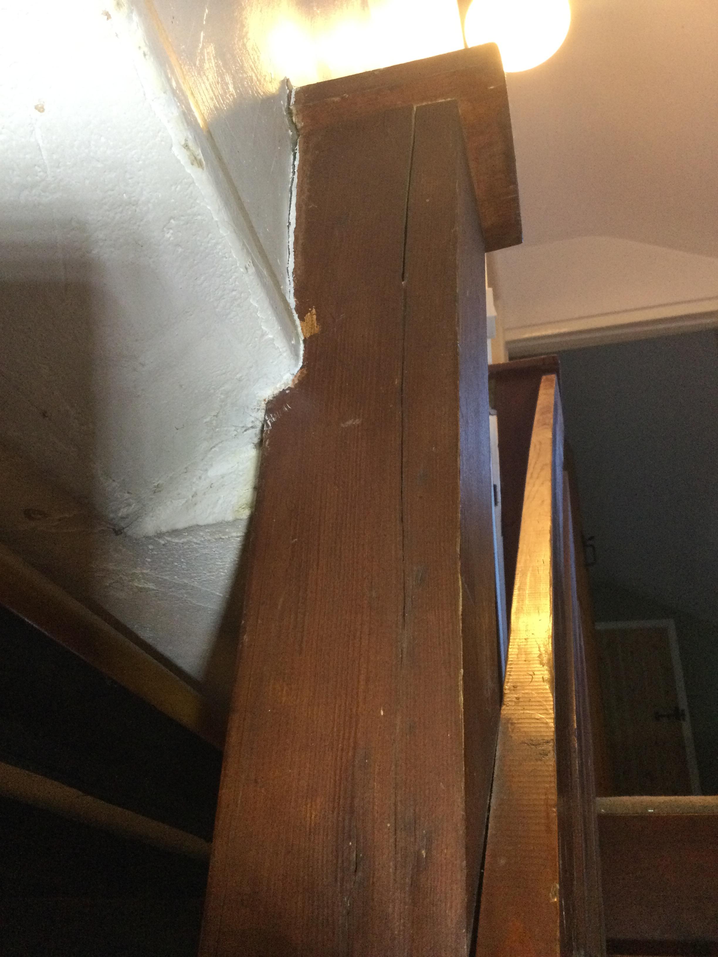

  5. I wonder if @PeterW or @Onoff might lend an opinion? Be grateful if so as usual. Not a big job, timber more my area too. I was wondering thus: remove 3x diagonals, & replace with upright spindles + bannister top. The post is hampering plans though as it seems to be fixed to the ceiling ( supporting it at all?). Thanks, zoot.

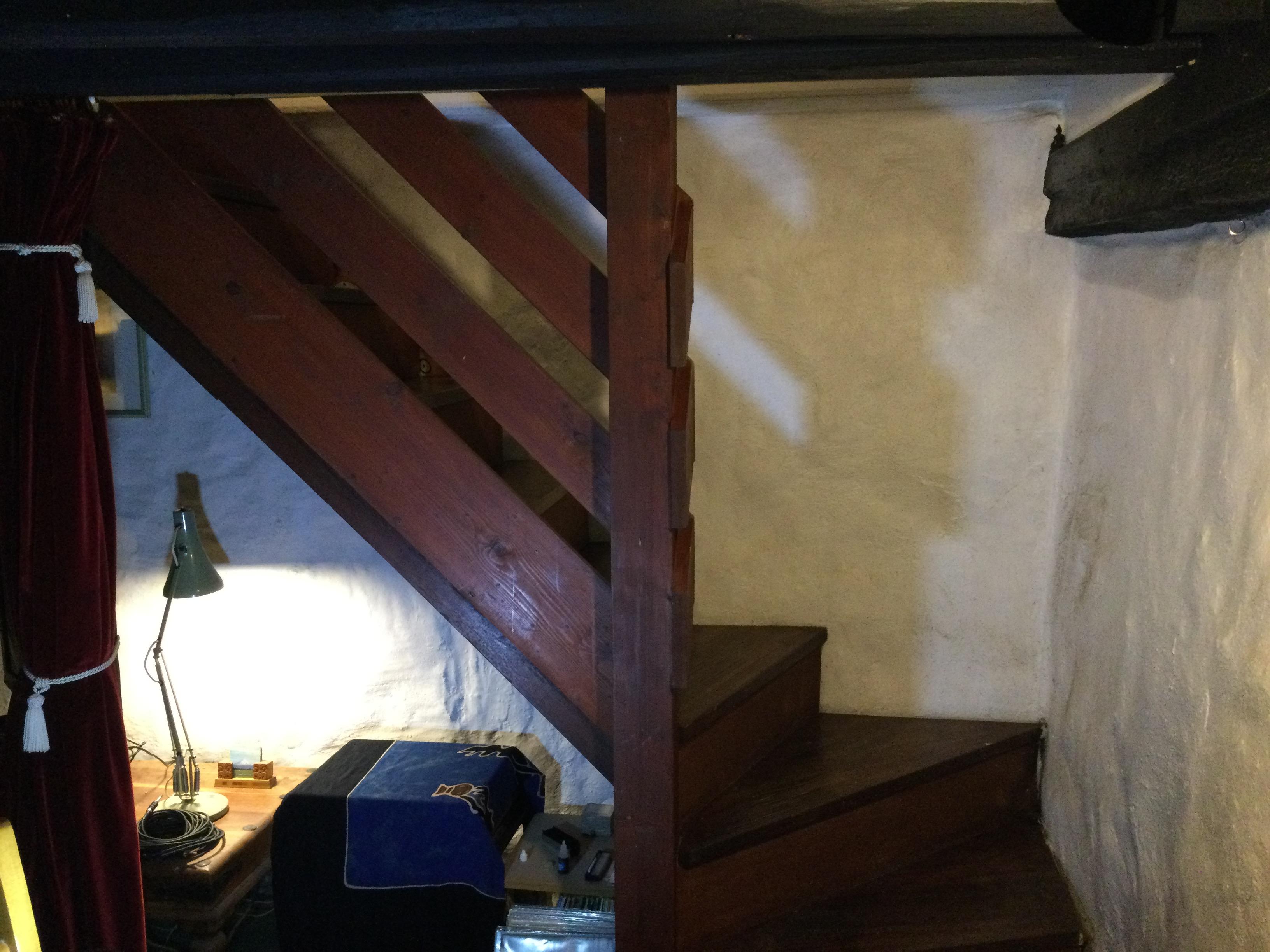

  6. Hello over on this section of BH. As some know I bought a neglected small stone cottage 5 yrs ago, Im gradually renovating ( & an extention built on). The staircase was pretty ''agriculturally built" by an amateur builder 20 yrs ago it seems. I think a good plan is to revamp it, leaving steps & basic structure. The side diagonals & 2 posts are unsightly I think, as is the hardboard back. This is the main room, & staircase midpoint opposite front door: so would be great to get such a central feature looking good. Steps seem hardwood, solid enough. I wonder if any of you could lend ideas as to how I could best revamp it? Few pics below. Thanks for reading, Zoot.

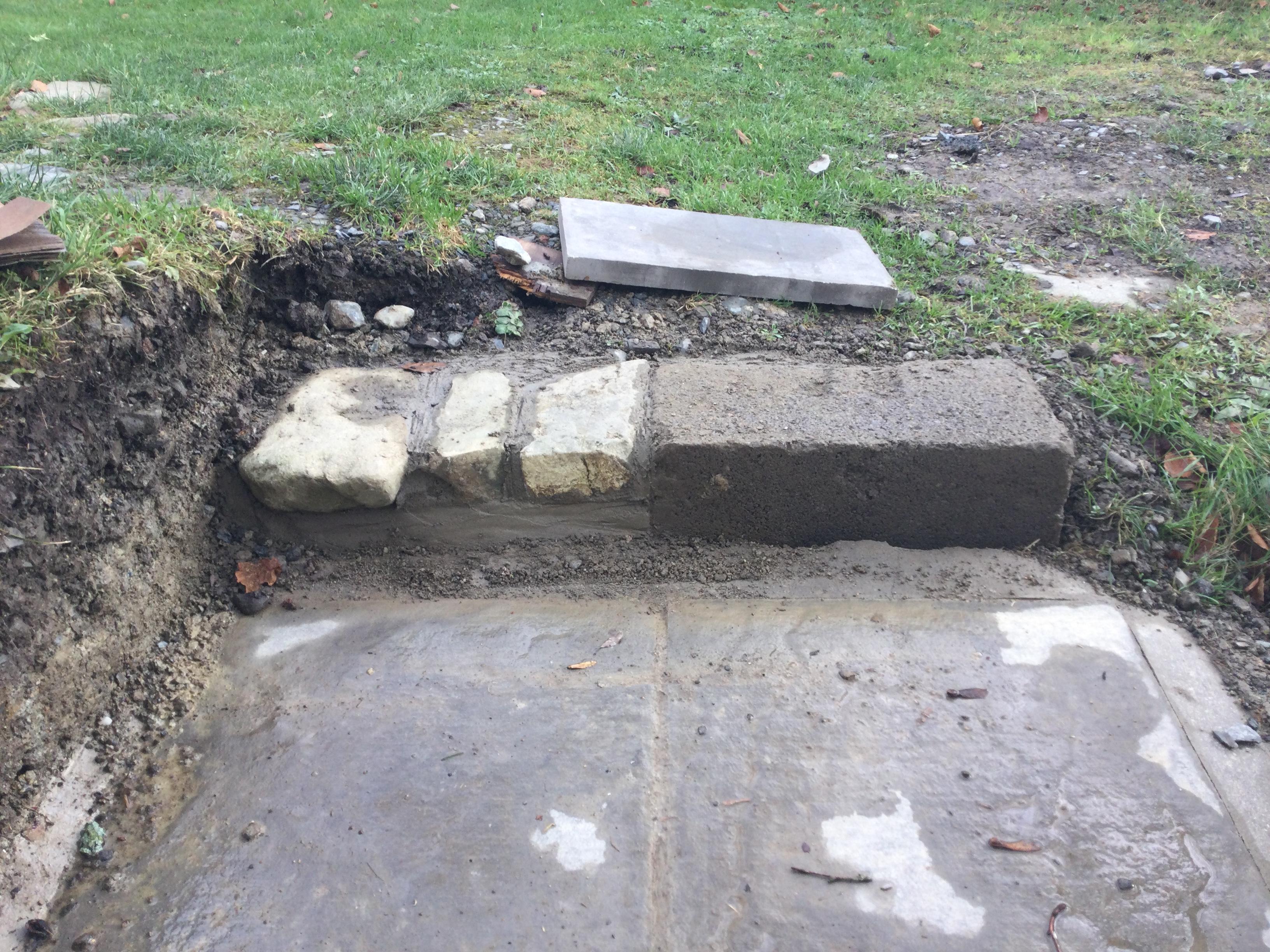

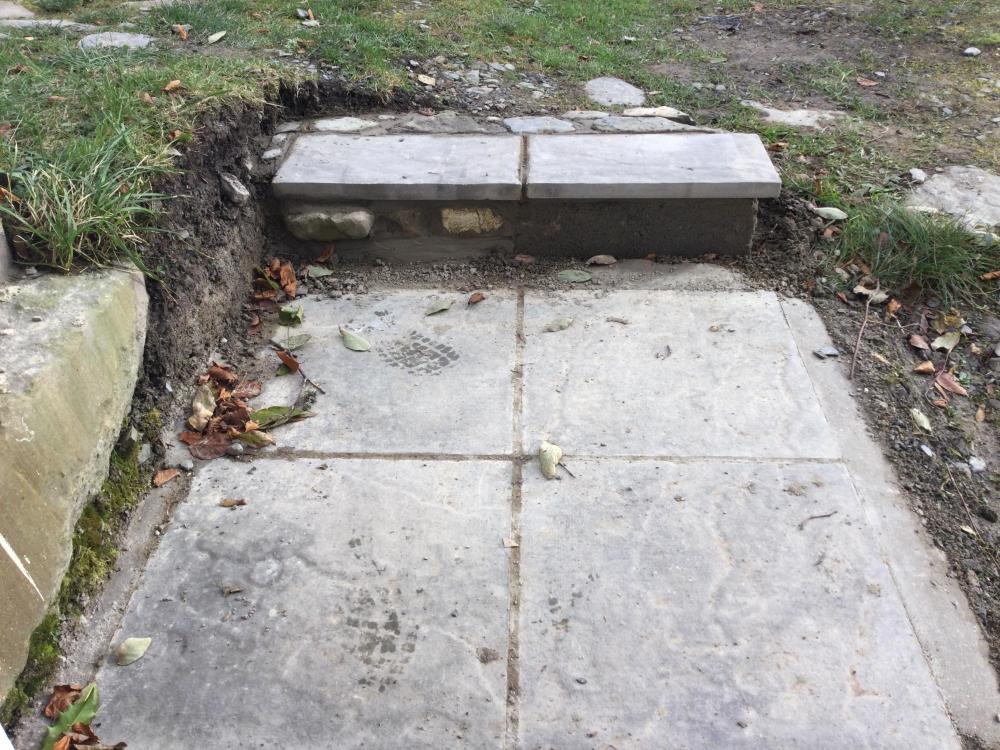

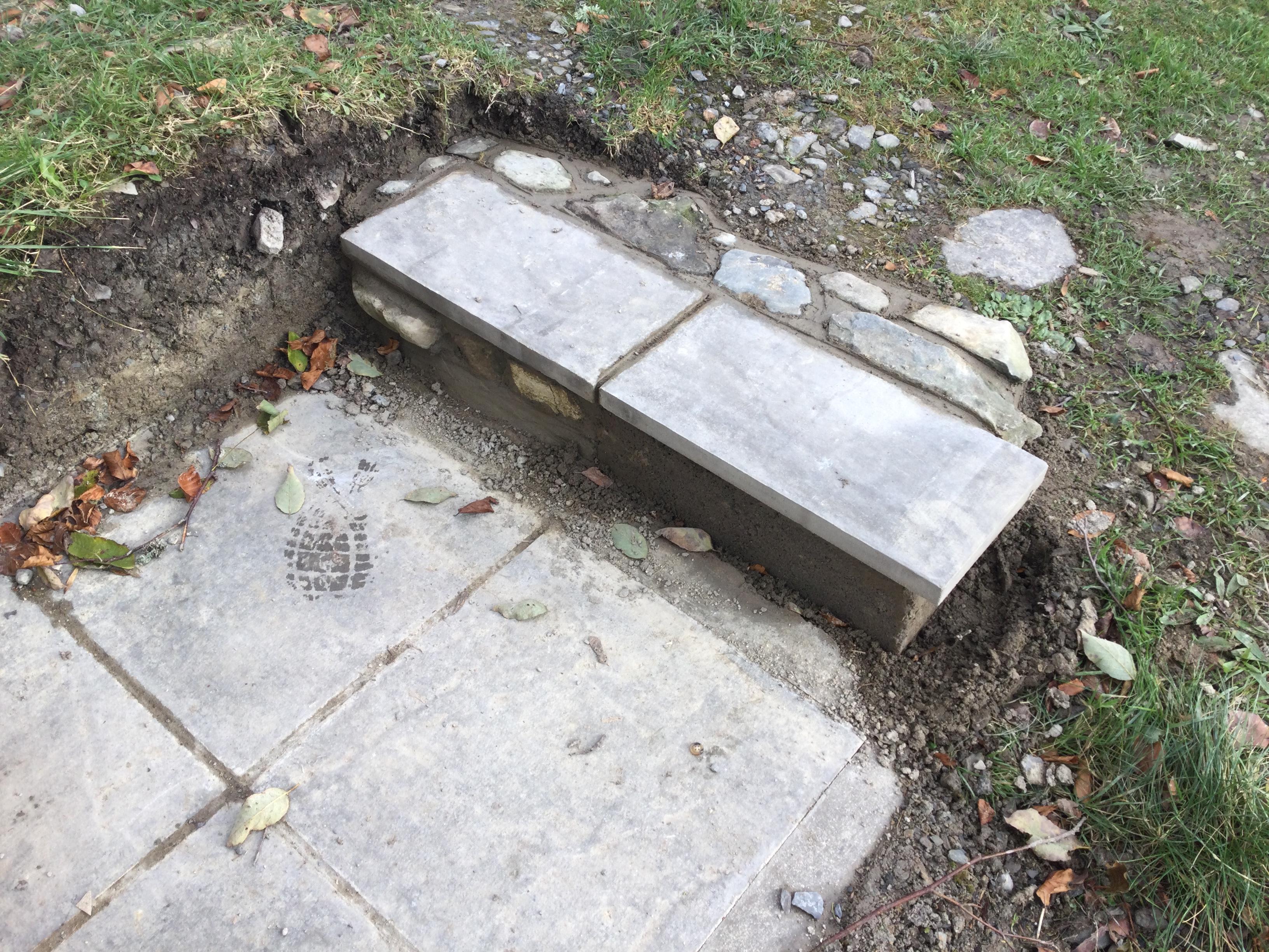

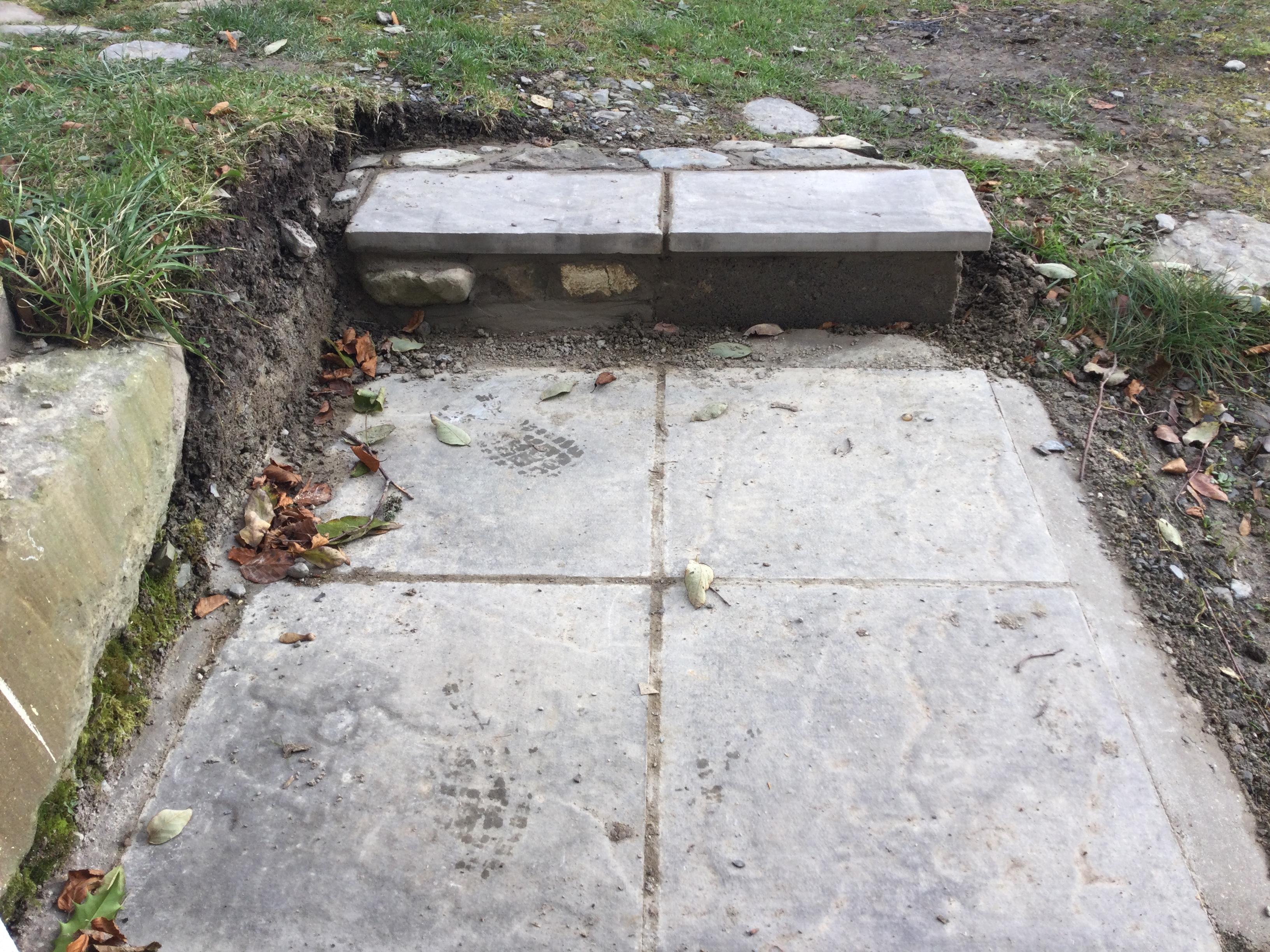

  7. Sort of mostly done then, yesterday did the top step. Temp went down to zero last night tho. Should i have covered it? I think I can tidy up bits in time, like the underpin coin bit, when i have a bit of mortar left etc. Thanks zoot.

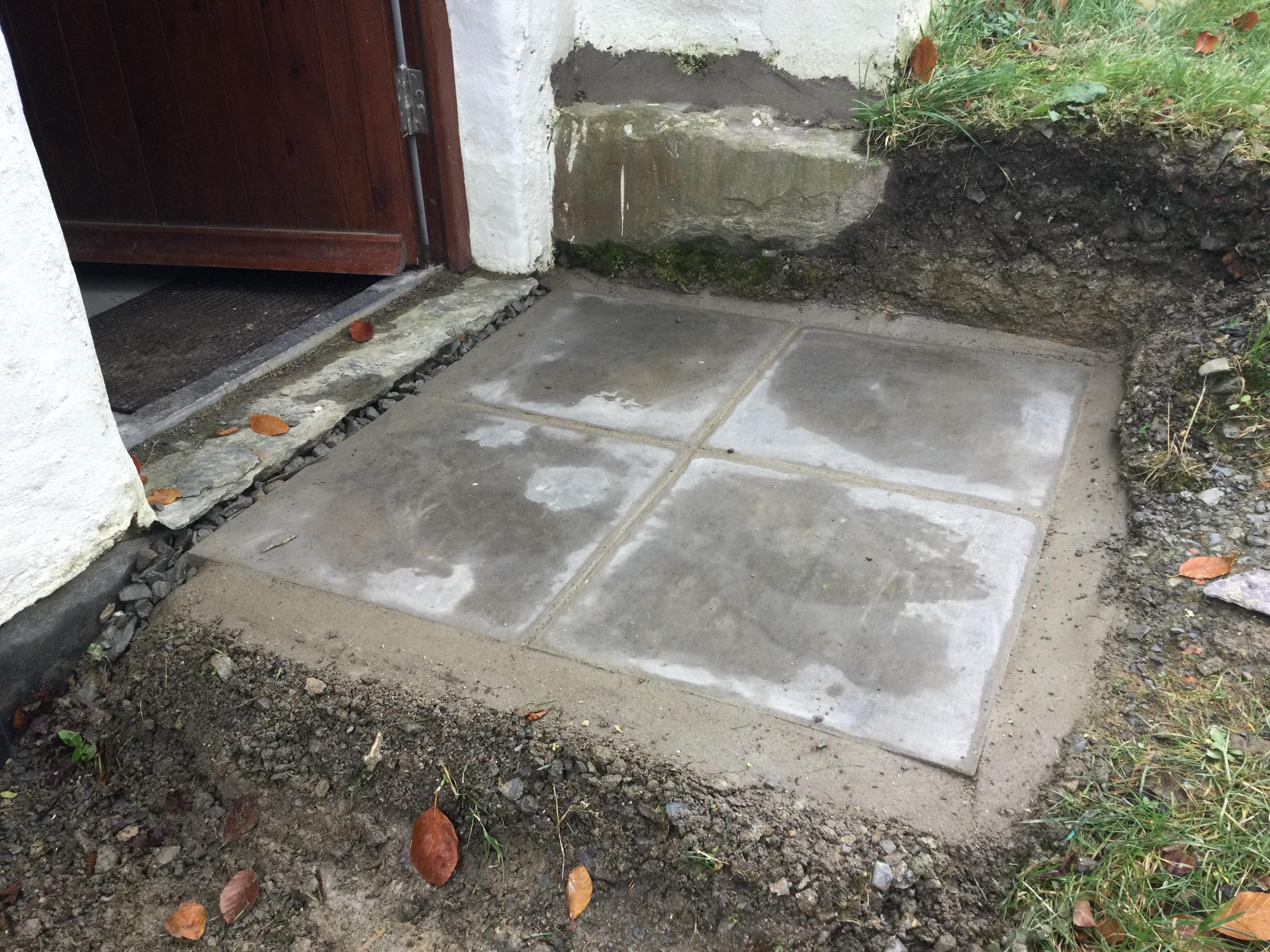

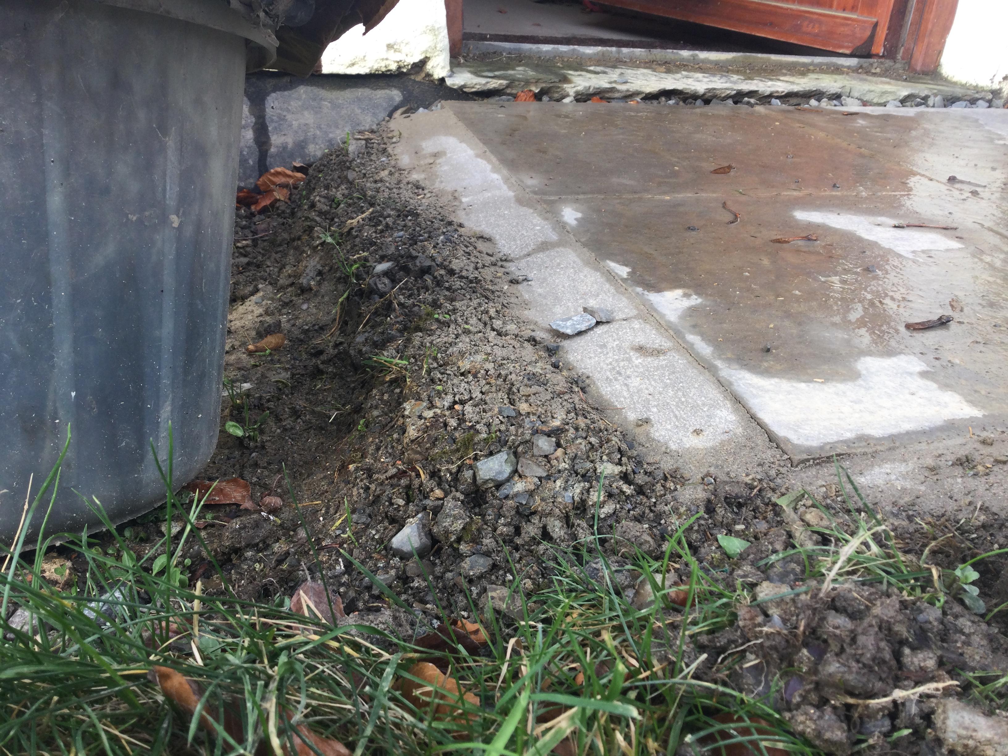

  8. I do have a weak point: the side of my 'patio' is just earth, & surely will erode away.. the closest slab corner, is slumping a fraction/ mortar cracked around here a little. So underneath solidity on this side, this corner especially, isn't great..
  9. Just done this far, but really sort of winging it/ not much of a clue.. decided the LHS needed solid something instead of clay, so whacked these stones in y'day 3.5:1 mix no idea if ok. So ontop will go my two half-slabs. Then slate flattish bits behind to deepen step: 2 full slabs ontop here I thought not in character really. Zh

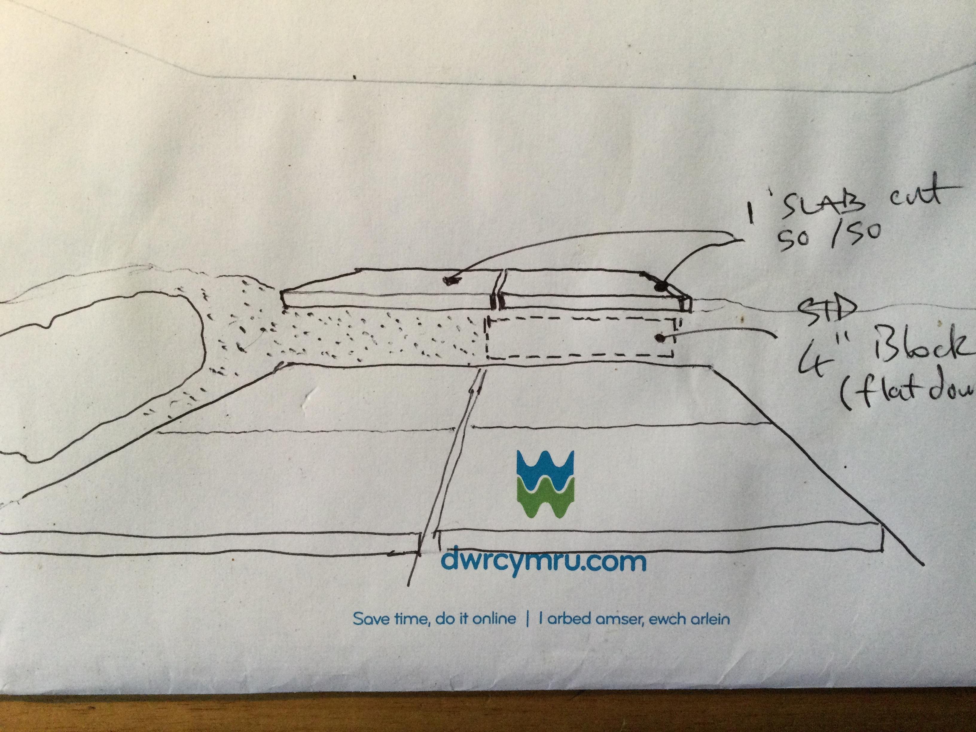

  12. I tend to agree now too perhaps. Last small job. Mark just got my step down to do first: Is this plan any good? I need to build up the ground you see under the RHS step, as it slopes right down this side, so maybe skim off ground level with my 4 slabs this RHS, then put a block down ( presume the same sandcastle mix bed ). LHS step ground underneath seems well compacted enough. Slab ' halves ' on, then stone bits mortared in behind to the deepen steps to maybe 12"... lastly cover the bare block visible side & front with mortar & slate bits. Steps w each = 450. Block w = 440. Thanks, zooter.
  13. Hi Onoff. Thanks fir this I wondered how shuttering works.. so Id need to drill into my stone coin to get rawlplugs in to fix the ply sheet? I can hear the welsh miner ancestors ( my builders' in fact, so small a community it is, & deep links go back) complaining.. hmm. I might go Joe90/ markc's idea & see if Ican live with it, then if not come back to this idea. Id prefer on paper your idea. Cheers. An Onoff sketch gets me all revved up/ where's me spade?! Step down ti do 1st. This the finishing job. Thx zh

  17. Anyone know how long it takes to access ' Facebook marketplace' once you've created a new acc? Tried googling, but answer not apparant at all. Maybe someone will know. Would save me £25 buying it on there. Thanks, zoot.
  18. Ive seen similar bigger ridged black ones like this in our forest protruding 10 ft out, I wonder why they cant be just cut down to a ft or so, IE why not just cut this right back so its not seen? Lovely wee brook that but for the pipe.
  19. Hi Onoff, useful extra pics/ info thanks.. I didn't see any of this. Yup this looks good to me, should be simple enough to do the flue.. relatively speaking. Just the roof insulation (1" celotex) to be very careful o, or as Proadave suggests 45* angled out the back & up. Joined facebook to try get it on this marketplace ( never seen before/ thought it was a social media thing).. but get a mssg " not allowed to access marketplace". Bloomin annoying. Yup a decent hearth, 2 sheet metal panels behind (maybe some heatproof lining for the backs of). Welsh slate.. yes ideally, but a piece this size bloody costly. Will hsve to be a cheaper option Im afraid.
