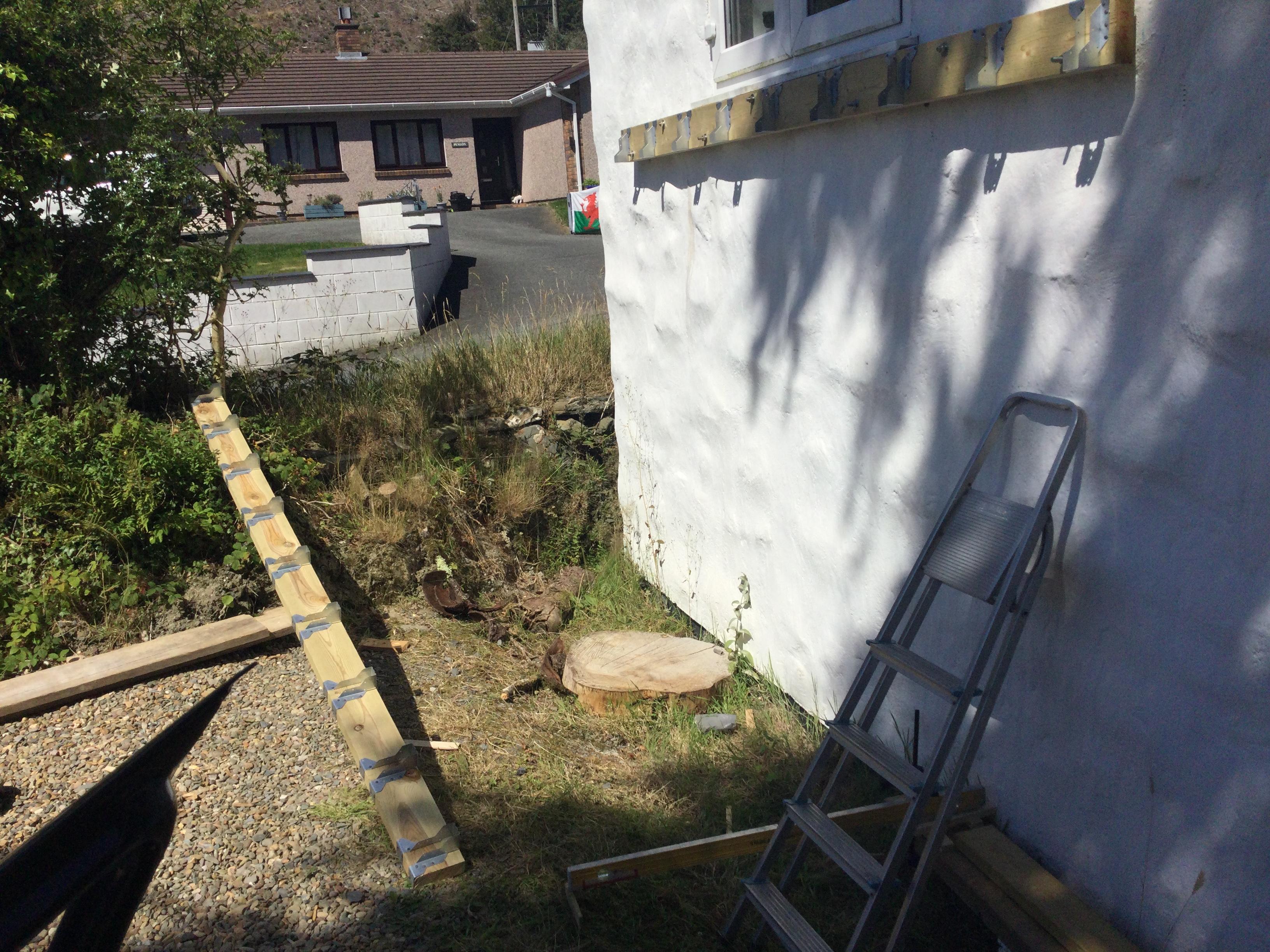

  6. @joe90 can you help. I need to wait hours between putting the resin in, stud no.1, until this set... to then lift up timber onto it, put resin in hole 2. What do I do with the resin tube, once hole 1 filled? Do I immediately remove the nozzle & put cap on tube? Or leave nozzle on, & switch nozzles later? IE How are you to use two nozzles with this stuff? thx zoot

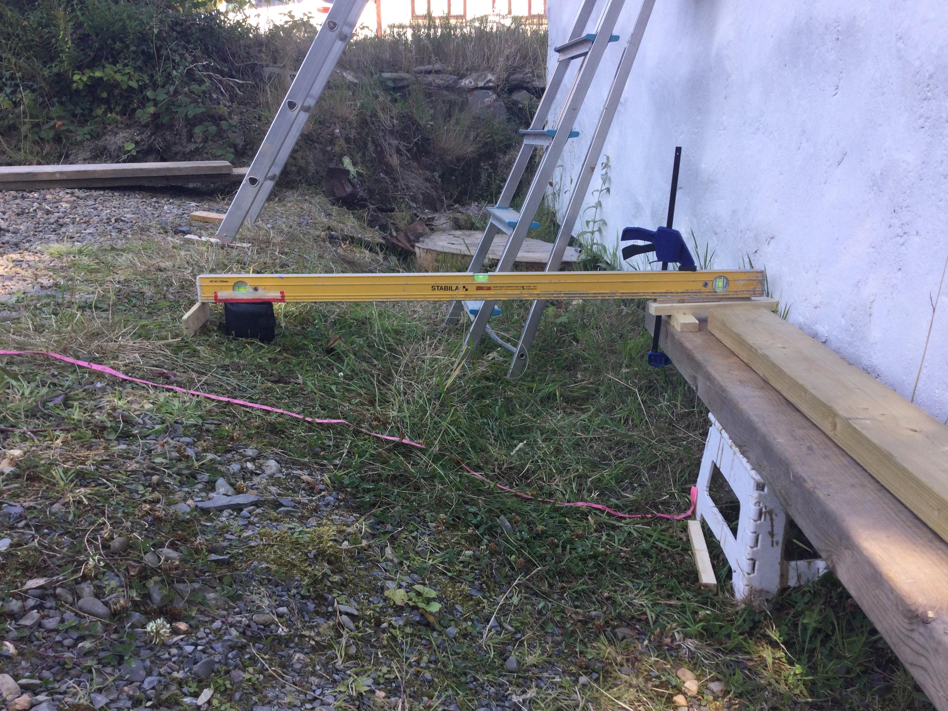

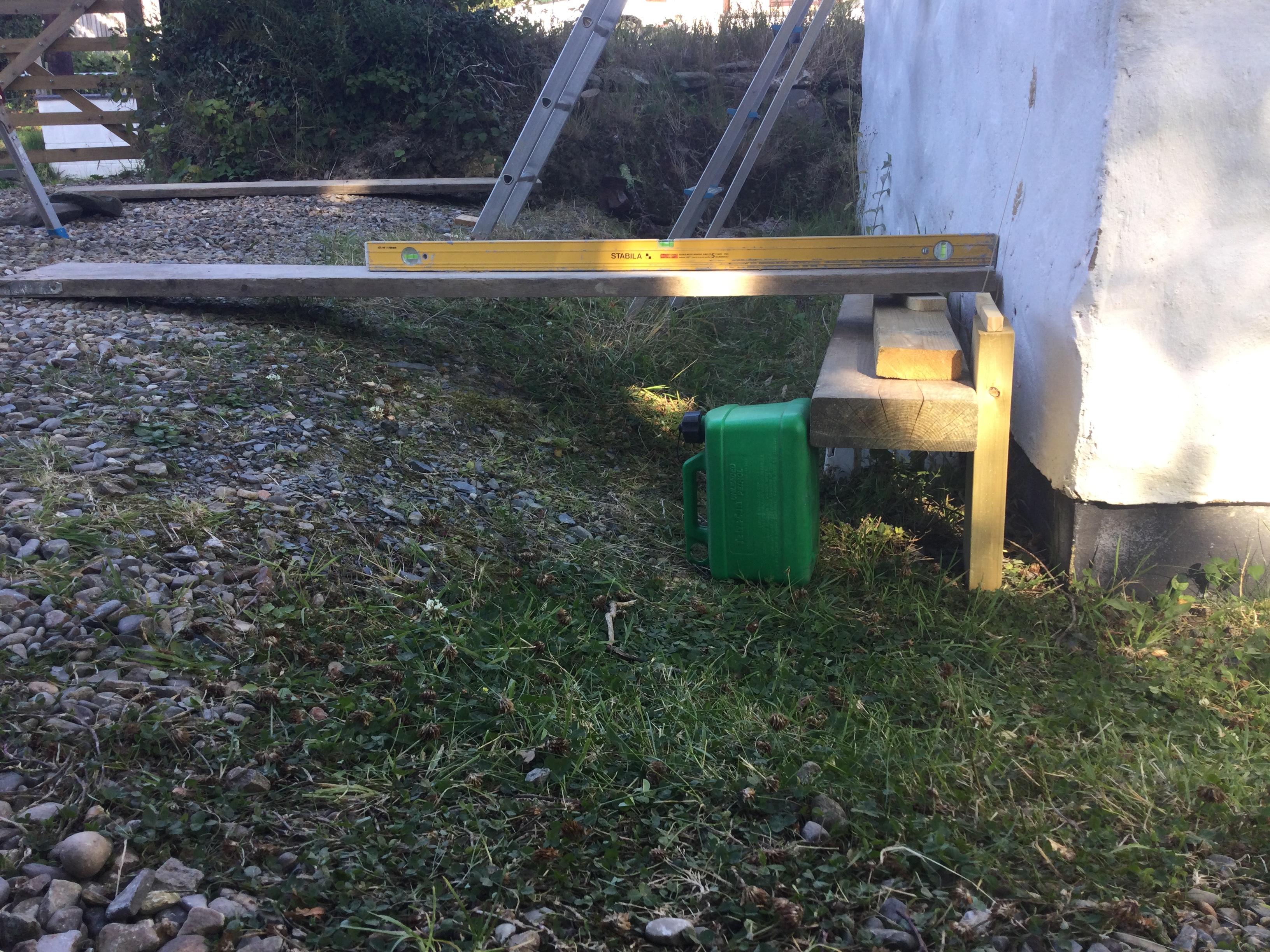

  10. Chaps, I think I'm set to fill my outer two holes & set the 200mm rods in with the fischer stuff. What I need to know is how the rod can be centred, in the resin-filled hole, in order for it to set properly. Surely it'll sink down, being sticking out from the wall. Or the front extended 12mm's weight, will cause the front to dip down. My concrete pads job, this was vertical rod.. so whatever I did to centre it within the resin filled hole, was made much easier. Thanks, zh
  11. Hi Onoff. Made a start on ledger board. Drilled 7 holes in it 1st, wedged/ offered it up, marked my two outer holes on wall. Drilled in my 80mm with 14mm bit. I've enlarged the flat wood bit render area.. to just squeeze in.. the smaller flat washer in the pic here. 22mm width. Can you remind me. Was this washer intended for here, in the box of goodies? If notI need to replace what this was going to be for. Or maybe a late addition, for my tube " press onto it " idea? When I mean here: to reiterrate: I think I definitely need something for tube to " press " against, not for it to press onto the block as the face is uneven & crumbling (a sharpish tube.. will cut in Im sure of it). Thanks, zh

  15. Of course!! Christ I'll get me coat.. Thanks Marvin. But still.. why the dickens wouldn't the bubble be centred simoly flipping it upside-down though?! Lord knows. But its doing my head in.

  20. Someone help me out here, wtf is going on.. My level bubble as expected, centred 1st pic.. then I just turn level upside down, & bubble way off. Both flat edges clean, no spot of mortar the cause. Level in ok general condition. Eh?! Frying my noggin.
