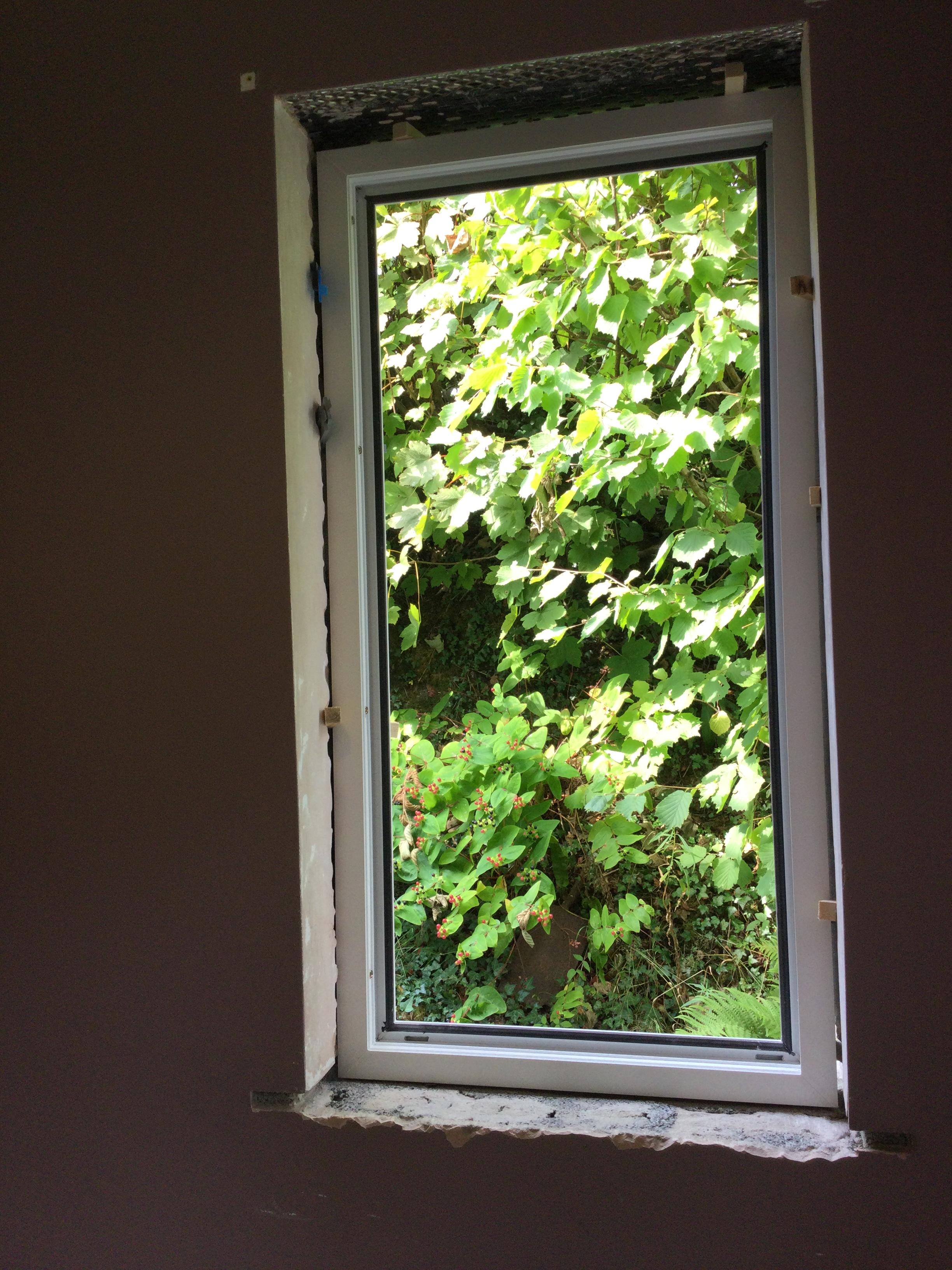

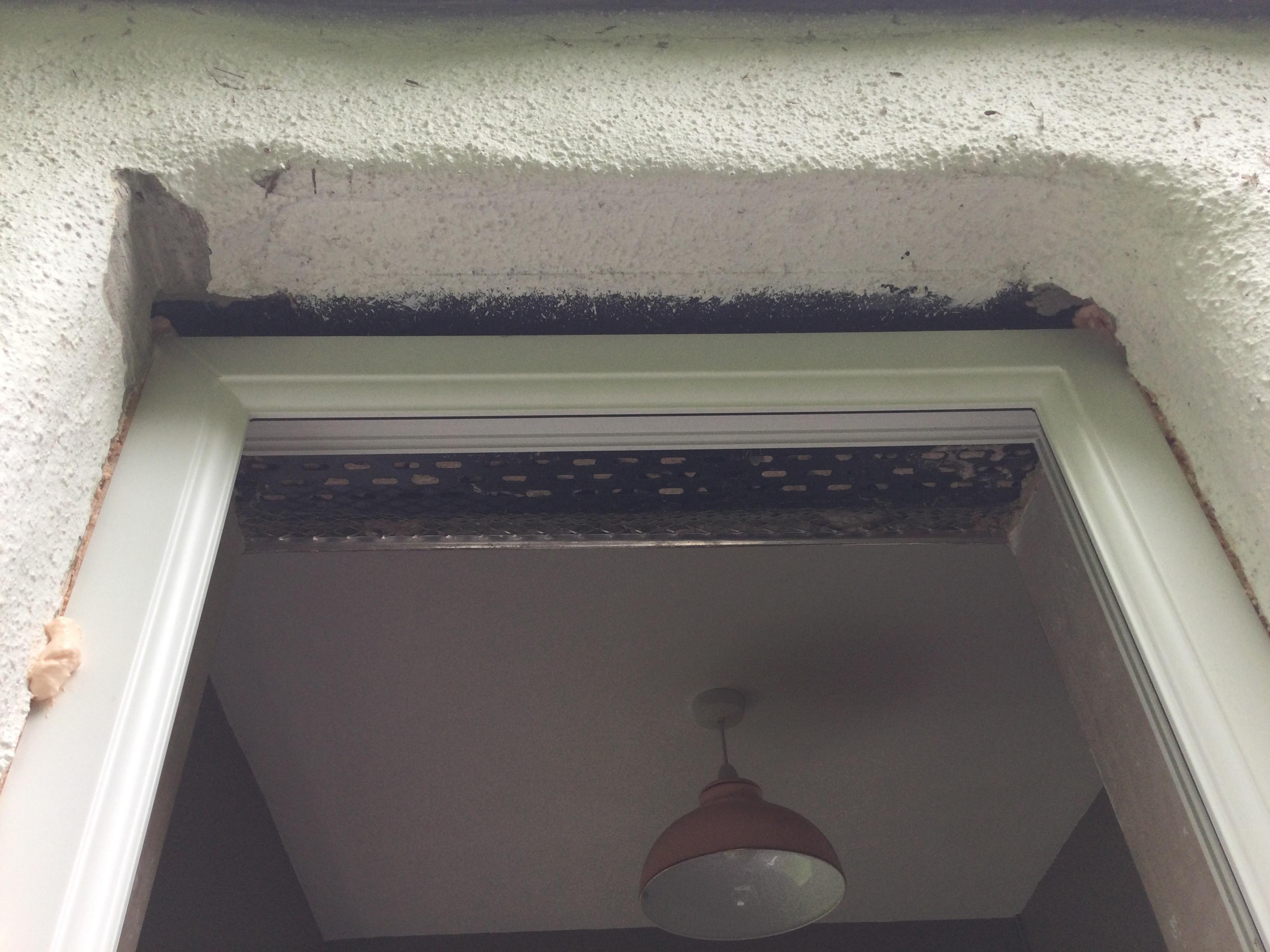

  1. Great thanks, got all that stuff. This window is located as I call it down 'my back passage' tucked away not seen, sheltered.. ie doesn't need to be perfect. And use the same ( render or mortar/ whatever it is!) to fill my gap above frame too? Thanks, zoot

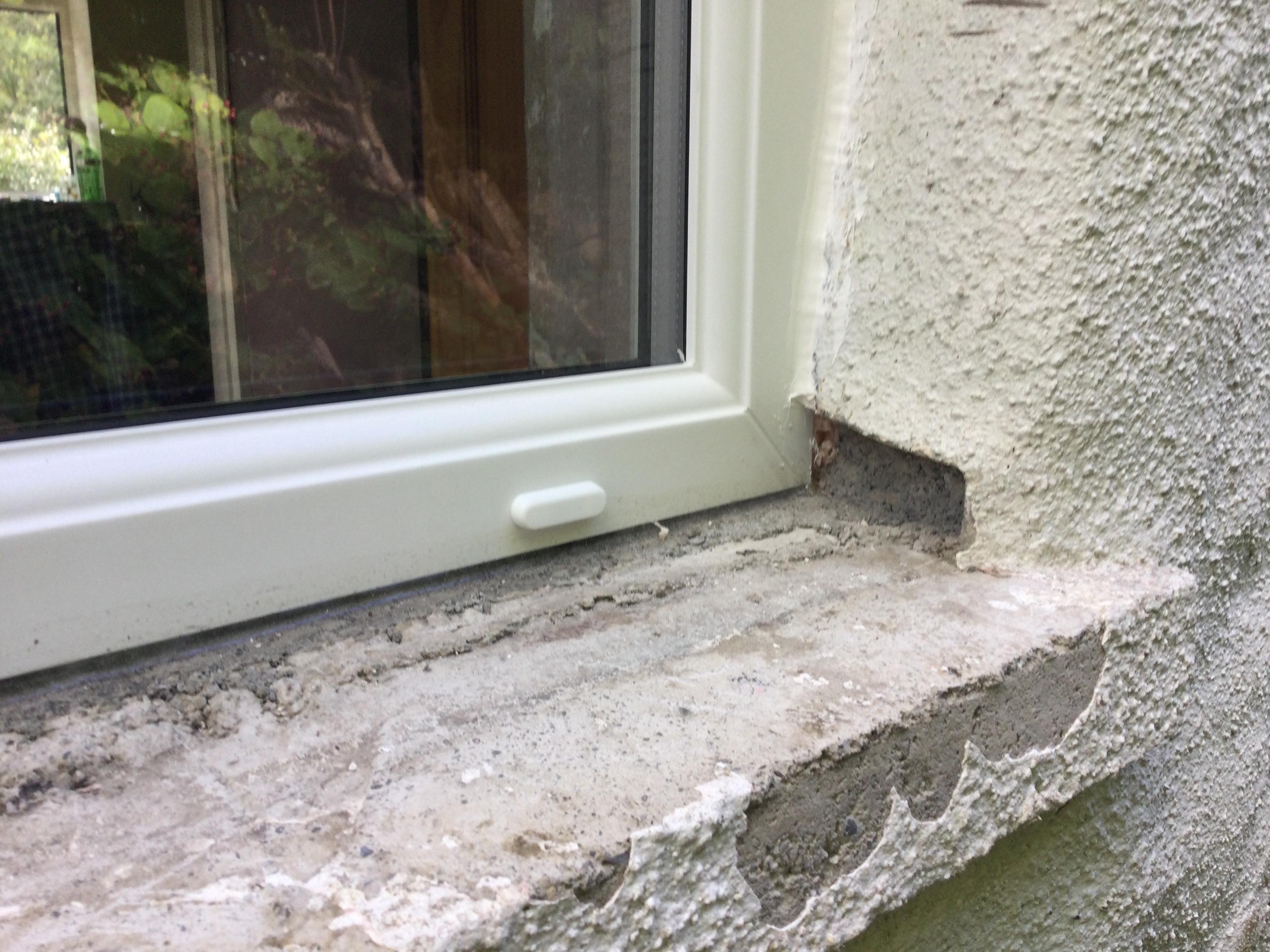

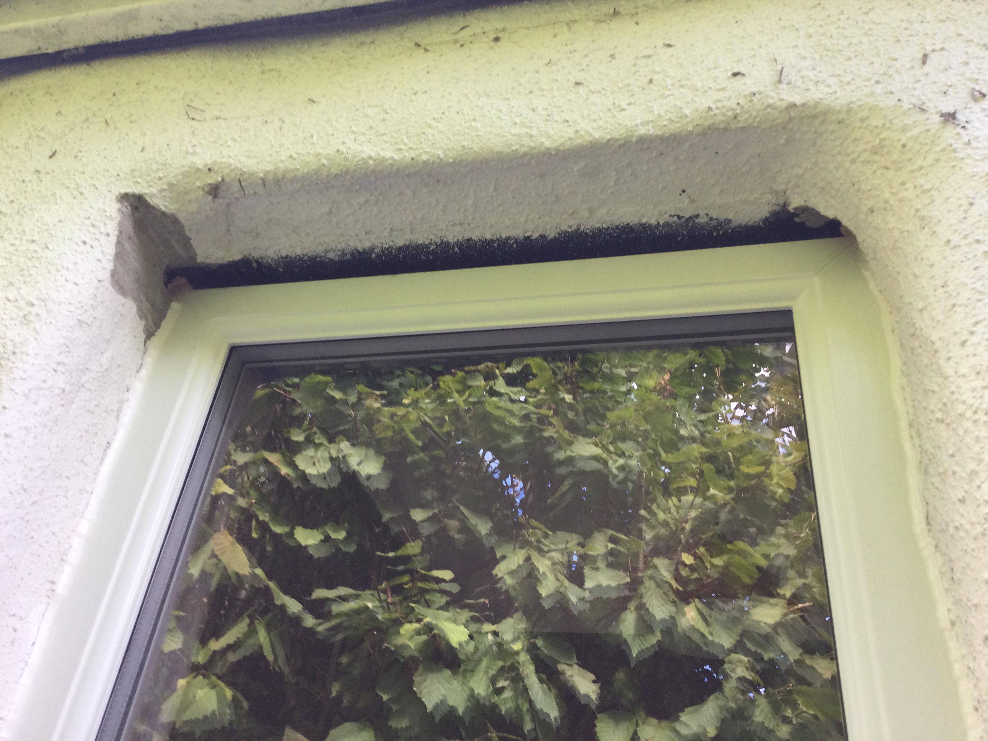

  2. Onoff what do I do here, I have two gaps far left & right, where old wood cill edges were, & rendered around. Pic1. And what to fill this outside top gap with? 600x16mm. The other side will be pb glued onto the lintel grate thing/ easy as not needing to be weatherproofed.. but this outside does. Pic2. Thanks, Zoot
  3. Nope. That was the only old wood frame SG window in the house, all white upvc DG now. Just 3 more DG units to replace mind, but done before/ no need to ask again. Thanks, zh

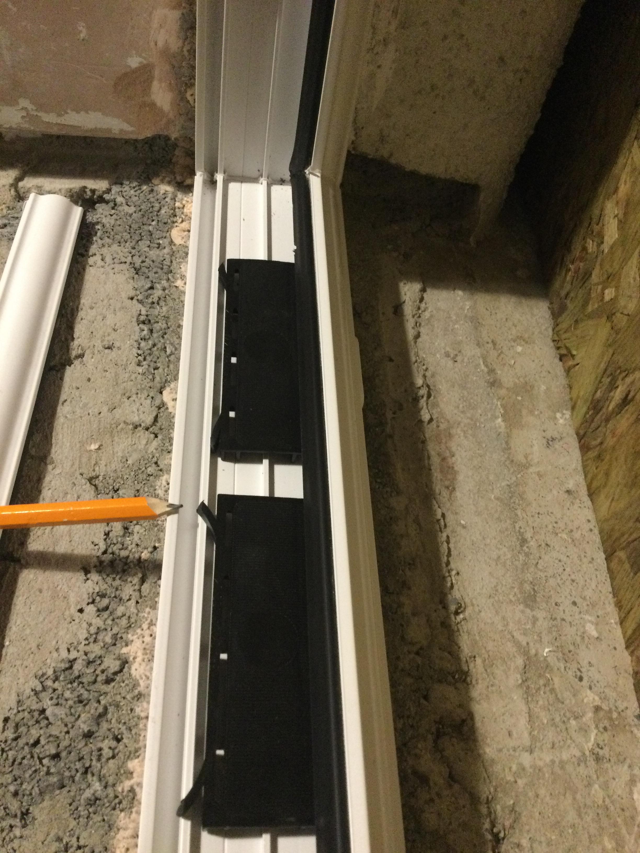

  4. Figured it out- they must go other way in fact/ legs at back just need forcing in. Well they're in now anyway. Glass in/ beads on.. b'stards to get on mind you! I can relax with weather seriously closing in tmrw now. Nick of time. Very satisfying. Both recent jobs have been. Huge thanks again y'all. Within 5 pages too! This build lark is damn good for self-confidence & contentedness combined. Very rewarding. Zh
  5. joe90, last Q really.. I have these whatnots included, presumably seat jobs the frame sits on/ understood. But have I got this right? They have wee 'legs' -my pencil points to one- which unless squeezed in & slipped behind the ridge ( the Top whatnot is pressed in like so )... the bead can't be pushed in place, these two legs are in the way. The black Lower whatnot here, isn't pressed in. No instructions with it. Youtube clips just show someone placing on two whatnots.. no ultra hard pressing in of any legs afaict. The whatnot won't go t'other way round/ legs twds the back.. cos then more of overlaps the bead recess, bead wouldn't go in.

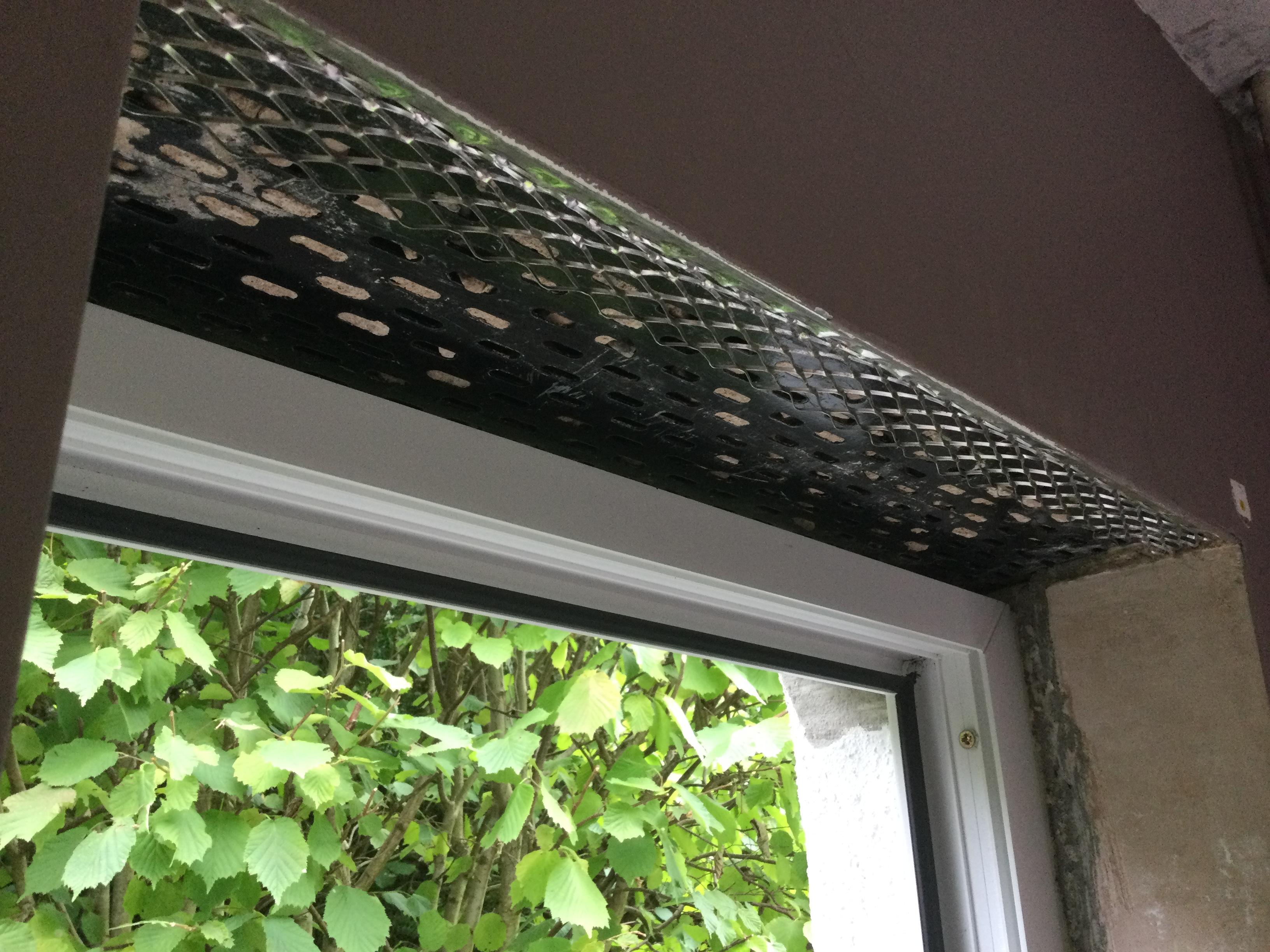

  8. Yup got them here. Good progress so far- foamed in, trimmed off foam & wood wedges ( placcy ones pulled out). I'm fine to crack on & complete this job.. apart from needing advice on the top. Here, above old frame, was 15mm of plaster- I needed to hack this off. This leaves me a slatted metal lintel grate thing ( cavity above), & a strip of metal plastering "edging" stuff to work around. Ive left myself 16mm H gap frame top to the black metal grate thing. I was thinking: snip off a good cm of the silver mesh edging stuff, cut a bit of plasterboard to fit, soudal plasterboard adhesive glue it up onto grate thing. Fill 3mm gap with foam. Then tidy up the front edge: fill pb gap to mesh with a bit of foam/ skim with a fine mix of something & grade it / tether it to the metal edge bead. I don't have skills to re-plaster this area, so pb is my only way , I think. Then lastly fill the outside area above frame: anything just to weather- seal it, I guess. thNks, zh

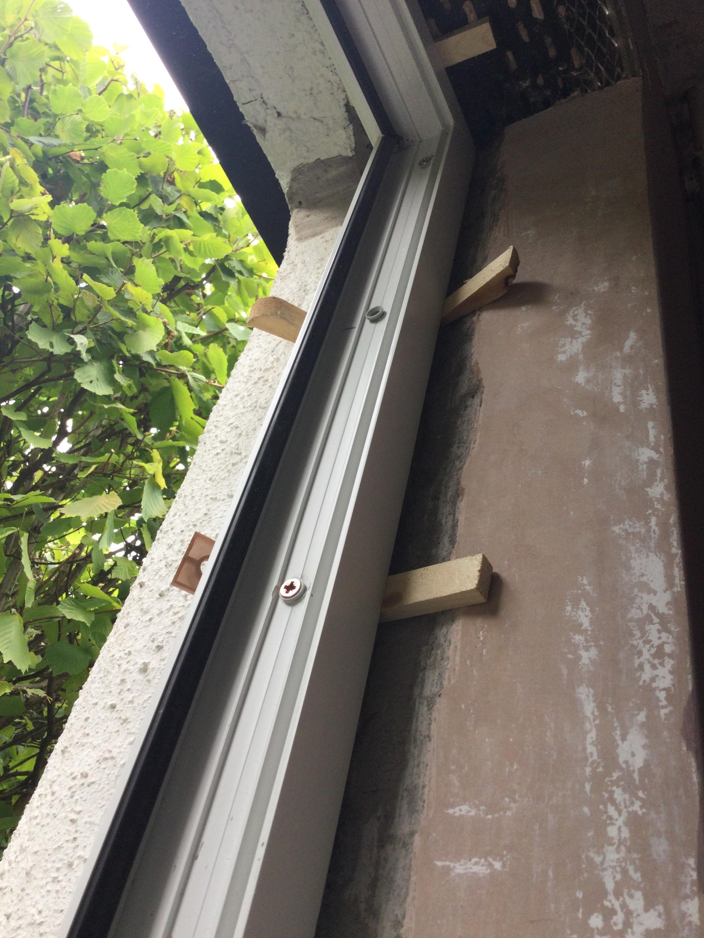

  13. @Onoff or @joe90 can you just lend advice: my wedges, here all rather sticky-outy, & plastic ones too.. ..do I foam onto them as is/ leave them be? Or do I remove them before foaming? (Frame fixings in, frame solid). Thanks, zh
  14. Hi Peter, always more confident proceeding with a PW reply! Frame fixings fine/ good recommendation. Had a few teething issues, going thru block a few times/ spinning screw.. but got 8 in now. Can't go into lintel/ metal something here, & presumably best not go downward into my concrete, bc of water ingress? If ok to crack on, could you remind me, my wedges.. (all sticky-outy: the reveal plaster I had to really dig into, leaving them going in at acute angles, rather than flat): do I now remove them, or must I leave them as is & foam/ work around them later, after foam hardens around them? Thanks, zoot
