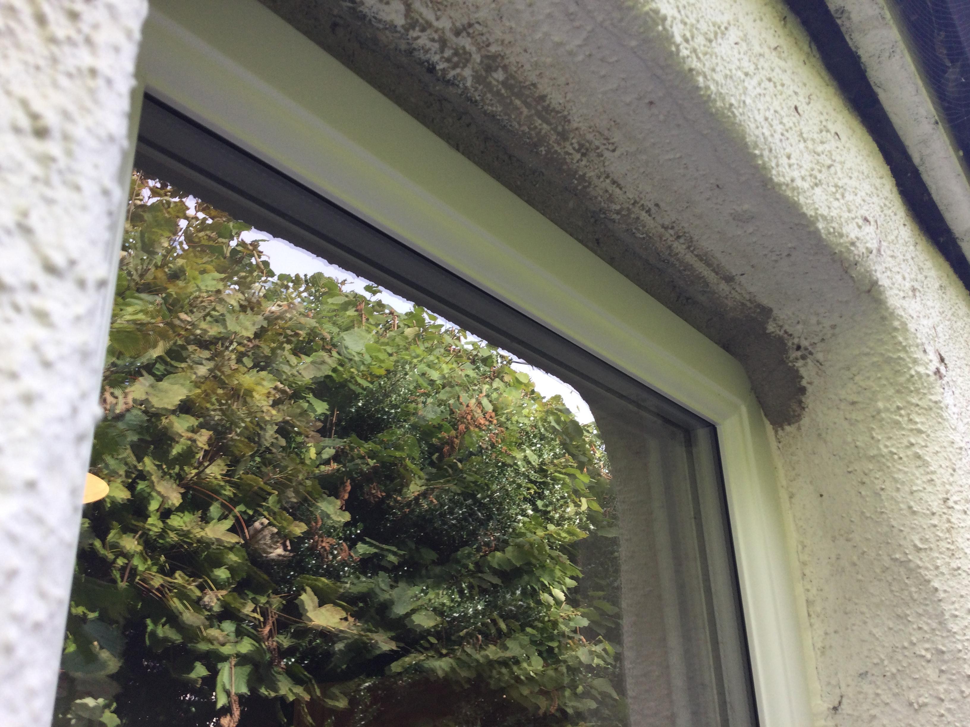

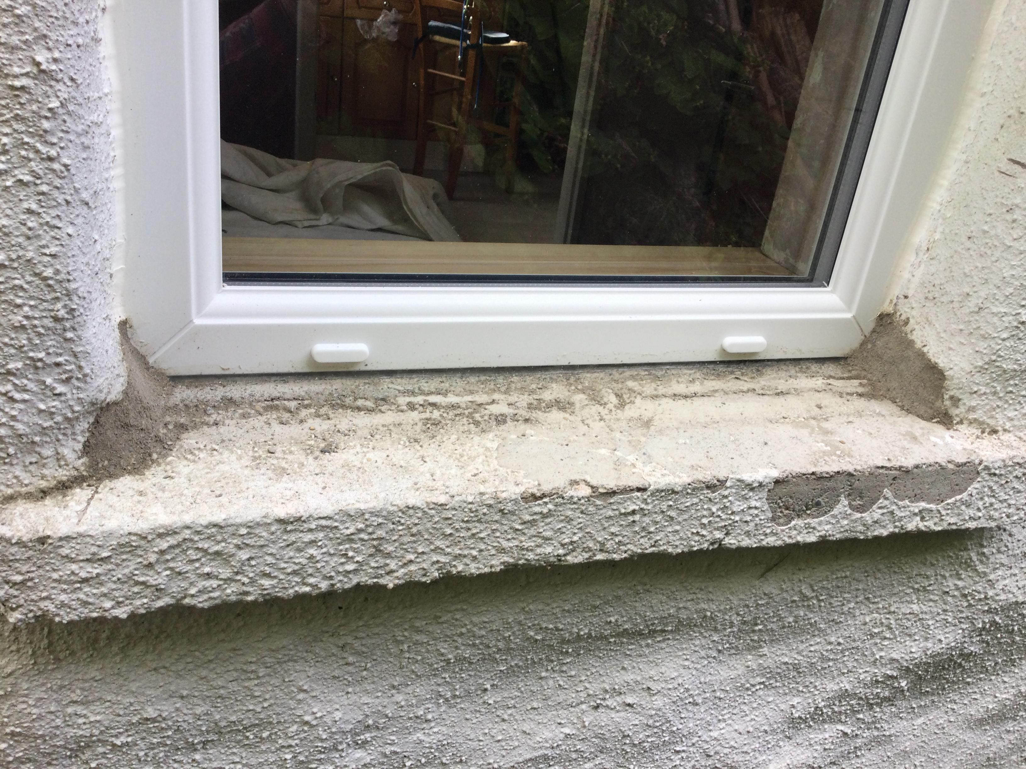

Onoff what do I do here, I have two gaps far left & right, where old wood cill edges were, & rendered around. Pic1. And what to fill this outside top gap with? 600x16mm. The other side will be pb glued onto the lintel grate thing/ easy as not needing to be weatherproofed.. but this outside does. Pic2. Thanks, Zoot

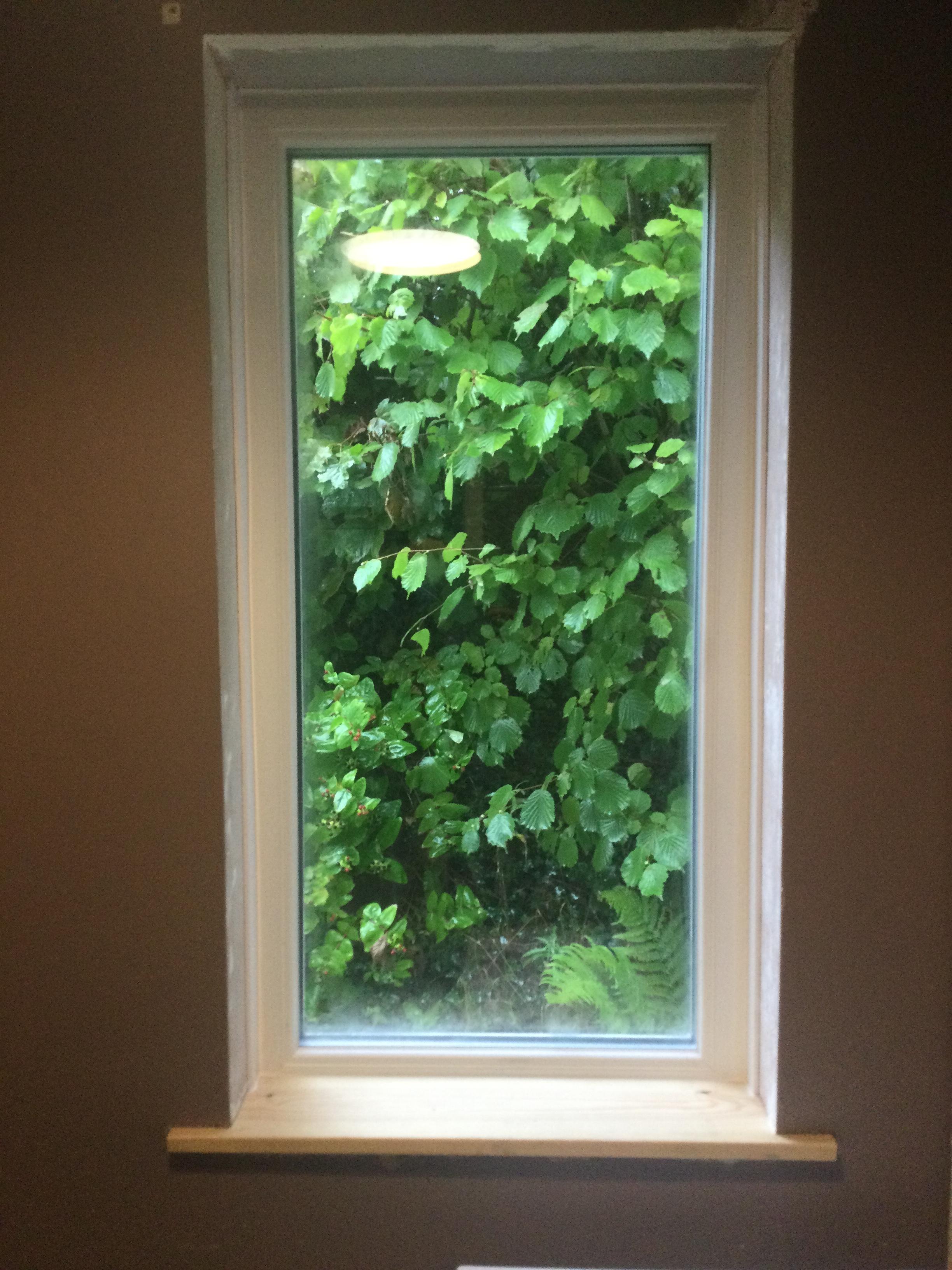

Figured it out- they must go other way in fact/ legs at back just need forcing in. Well they're in now anyway. Glass in/ beads on.. b'stards to get on mind you! I can relax with weather seriously closing in tmrw now. Nick of time. Very satisfying. Both recent jobs have been. Huge thanks again y'all. Within 5 pages too! This build lark is damn good for self-confidence & contentedness combined. Very rewarding. Zh

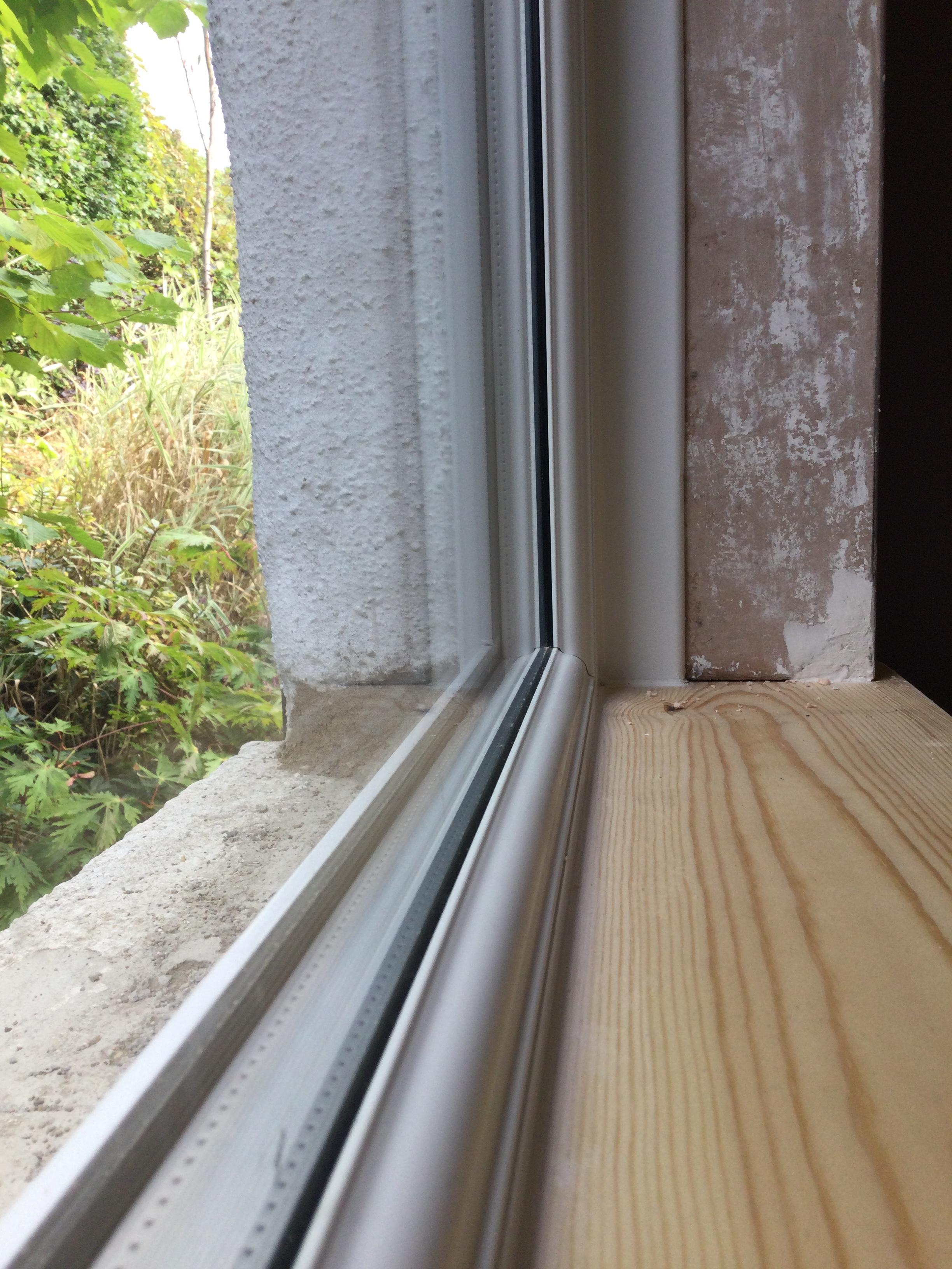

joe90, last Q really.. I have these whatnots included, presumably seat jobs the frame sits on/ understood. But have I got this right? They have wee 'legs' -my pencil points to one- which unless squeezed in & slipped behind the ridge ( the Top whatnot is pressed in like so )... the bead can't be pushed in place, these two legs are in the way. The black Lower whatnot here, isn't pressed in. No instructions with it. Youtube clips just show someone placing on two whatnots.. no ultra hard pressing in of any legs afaict. The whatnot won't go t'other way round/ legs twds the back.. cos then more of overlaps the bead recess, bead wouldn't go in.

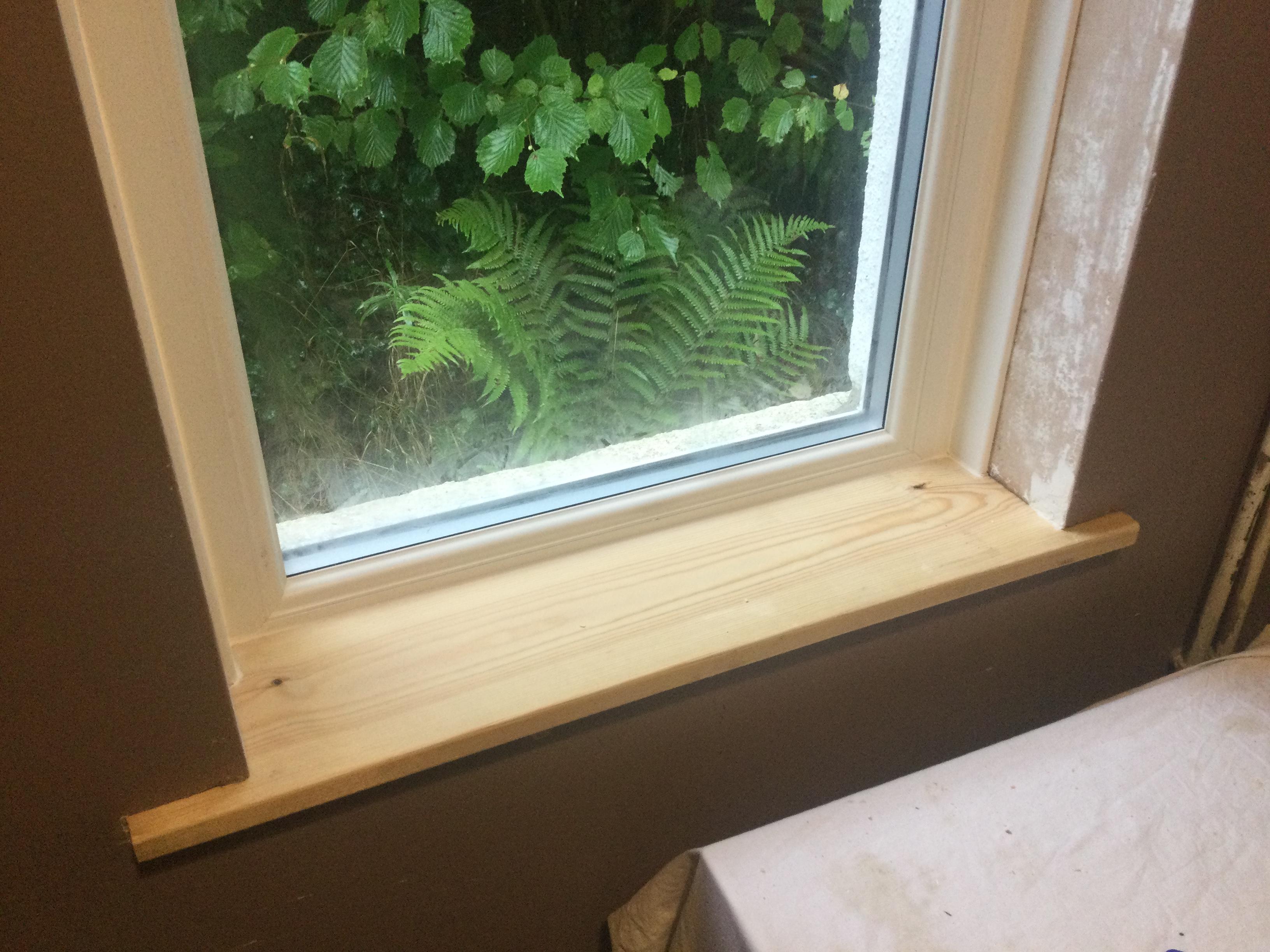

Yup got them here. Good progress so far- foamed in, trimmed off foam & wood wedges ( placcy ones pulled out). I'm fine to crack on & complete this job.. apart from needing advice on the top. Here, above old frame, was 15mm of plaster- I needed to hack this off. This leaves me a slatted metal lintel grate thing ( cavity above), & a strip of metal plastering "edging" stuff to work around. Ive left myself 16mm H gap frame top to the black metal grate thing. I was thinking: snip off a good cm of the silver mesh edging stuff, cut a bit of plasterboard to fit, soudal plasterboard adhesive glue it up onto grate thing. Fill 3mm gap with foam. Then tidy up the front edge: fill pb gap to mesh with a bit of foam/ skim with a fine mix of something & grade it / tether it to the metal edge bead. I don't have skills to re-plaster this area, so pb is my only way , I think. Then lastly fill the outside area above frame: anything just to weather- seal it, I guess. thNks, zh

No the glass came separately. There were some black odd looking rectangles came with it though. The added strips idea: won't work as I have wonky contoured thickass render. I've left a 6mm gap between outside frame, & a useful render outline of where the old frame sat: I was planning to fill with a big bead of silicone something ( that sika white stuff ?). Then, to get weatherproof, I need a big bead of something for frame to sit on between it & my concrete addition. Lastly the top: a bit fiddly but should remain dry until sorted/ sheltered. Thanks for the steps- really useful, I'm all at sea until such a plan is made clear. Zoot
