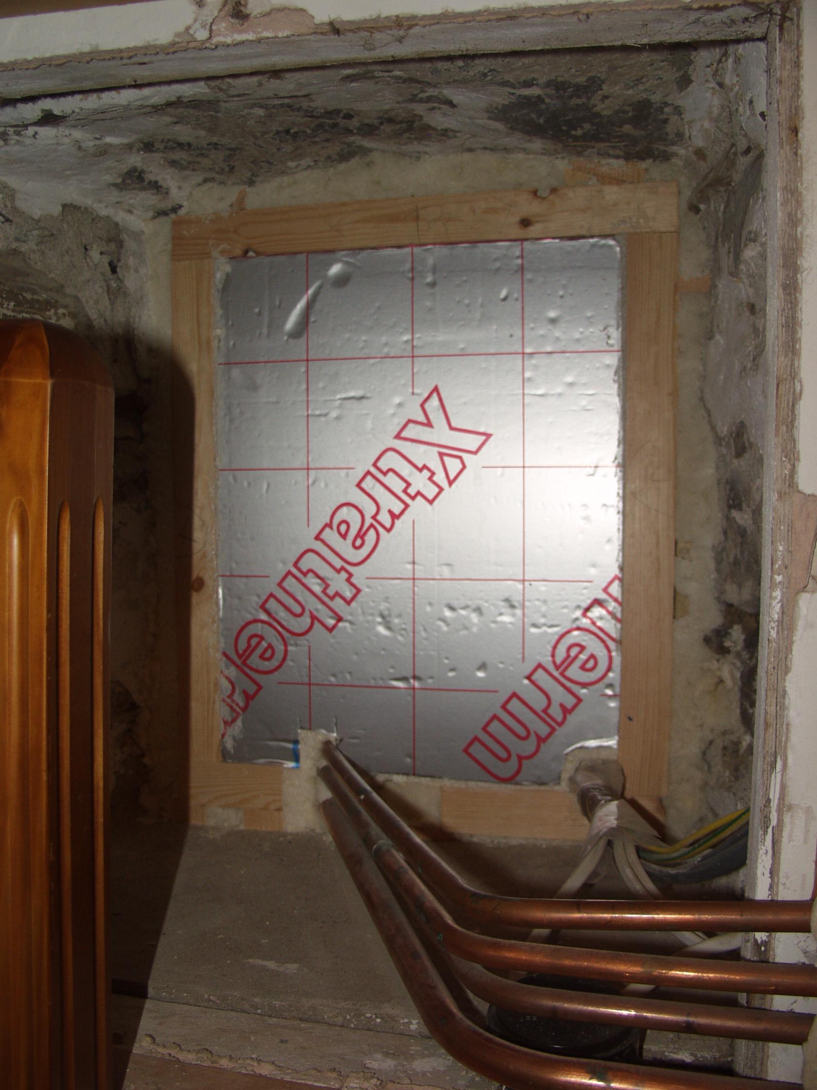

You think 7x 1" pir between wood frames, with brown fluff back on a pB backside.. won't be sufficiently insulated? me 'ole is wxh 20" x 20". Wall thickness 30". Its these pipes/ cables onoff.. they just prevent me coming forward any further than 6x 1" pir's as I need a frame to finish this side. If you look at the myriad of pipes etc its a real nightmare to block up the further fwd I come. So that's 3x 50mm thick pir -

I had this very idea sketched out, but PeterW said no need for block.. just wood frame/ 3 or 4x 50mm of pir/ wood frame. A helluva lot easier for me than doing blockwork, especially around these very tricky pipe/ cable interruptions.. even if I do this I -still- would have gaps around pipes & cables to foam-fill, I couldn't mortar these surely esp around copper pipes. Ok What I'll do is get in loft, & pB the frame backside. Later. I can check the brown fluff's spread properly, & set mice bait maybe once up. -

Only doing 2 pics here, start/ finish as I understand Im on a topic detour. Foam demon slain, I pulled up braaan fluff up to frame behind (wedged & foamed in/ v. solid), then pir in the frame.. before my proper 6x 1" pir sheets. gonna be tricky doing frame to finish due to wires front rhs. -
